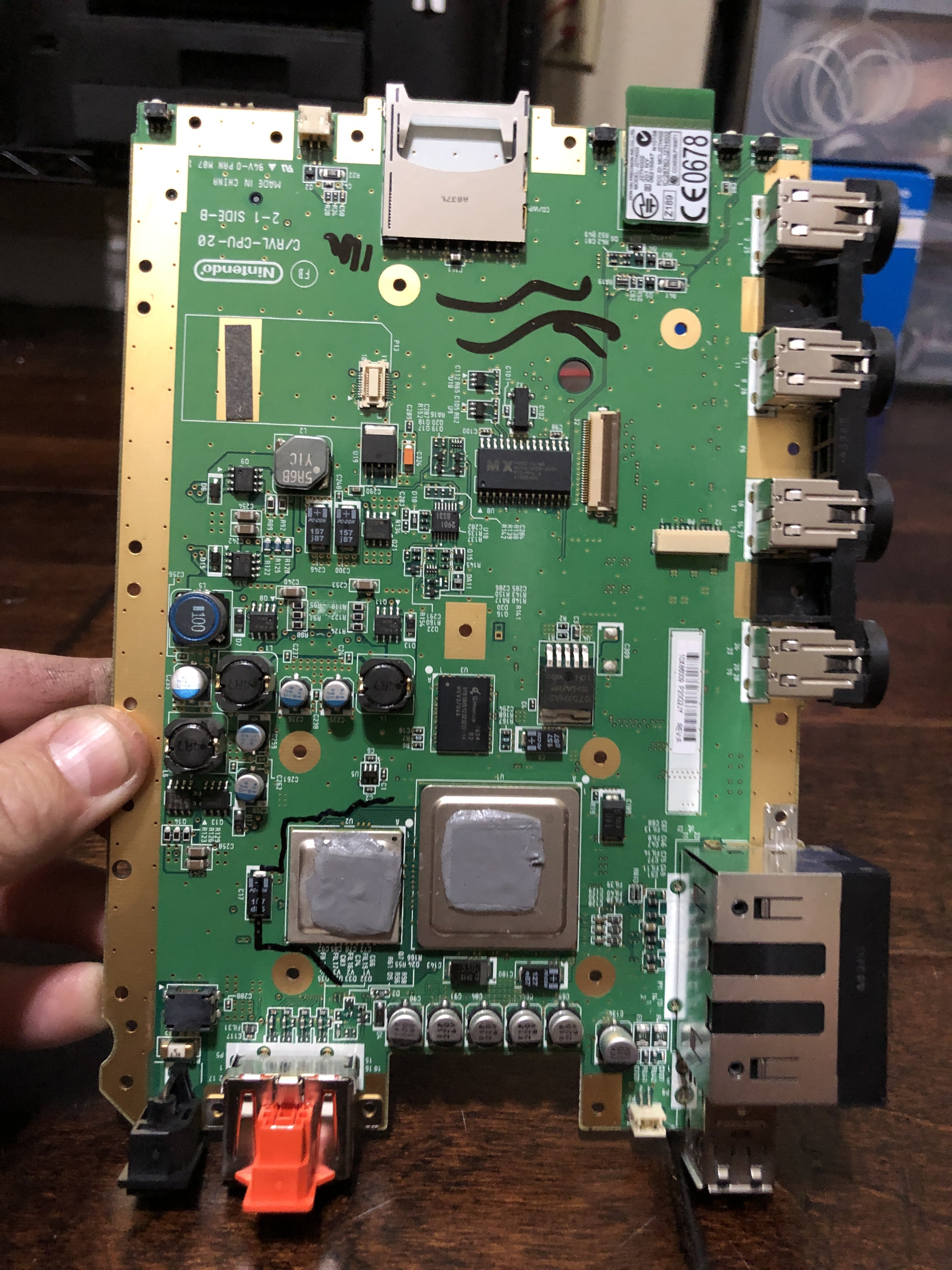

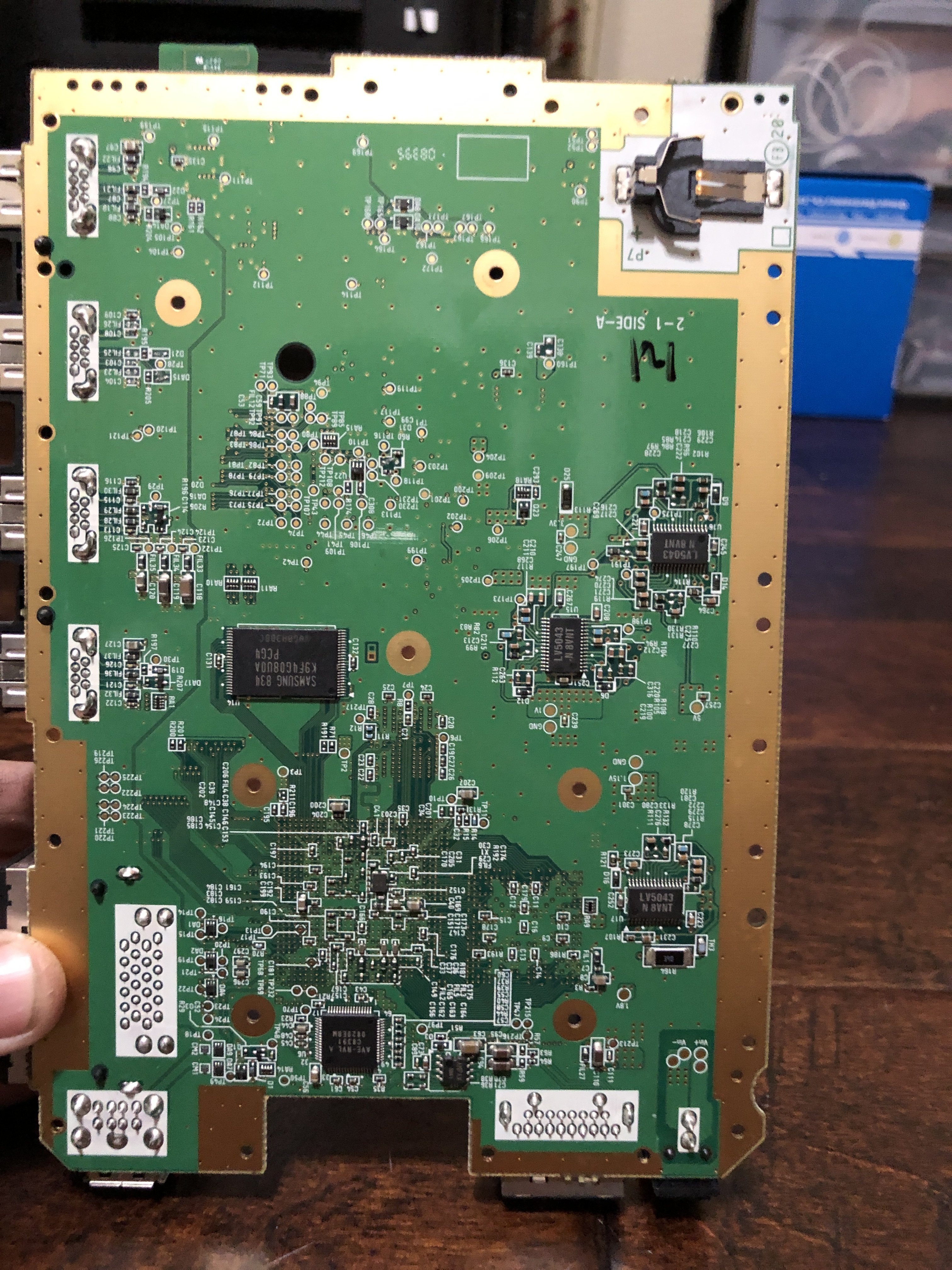

. I don't want to make a portable Wii per se, I want to shrink my Wii and maintain the GameCube controller ports so that I can still use them to play GC games through Nintendont (no need for any other Wii stuff like Bluetooth or anything).
