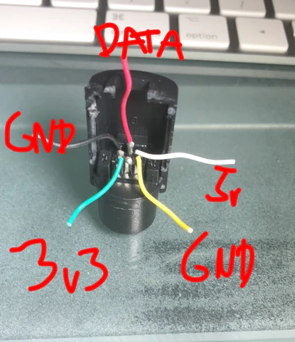

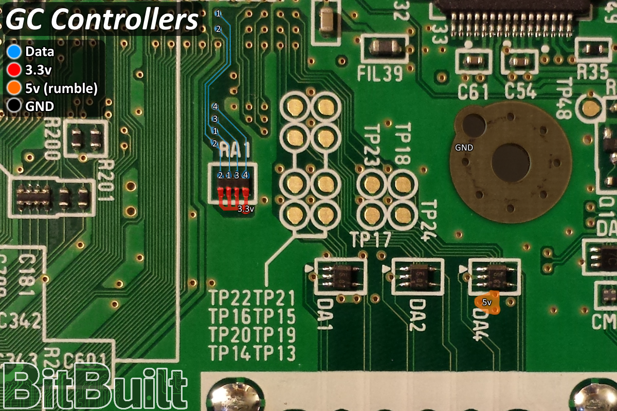

Also I'm a little confused on how to wire up the gamecube controller to my wii on my gamecube controller there is a red wire a black wire a white wire and a yellow wire which points on the motherboard would I wire each of these to ?
Perfect thank you so much I now know literally everything to build my wii portable!Yup! Just check out the Definitive Trimming Guide, it has the pinout for that section of the board.
Oh also just one more question is there a way to remove rumble from the controller because I don't really want rumble?Yup! Just check out the Definitive Trimming Guide, it has the pinout for that section of the board.
If I want to remove the rumble pack to slim down the controller can I just like jam a flat head screwdriver in there to get it off or do I need to desolder it?Rumble doesn't work without 5v, so you can disable rumble by just not connecting the 5v wire. All the GC controller needs to work is the 3.3v supply wire, the 3.3v data wire, and one ground wire.
