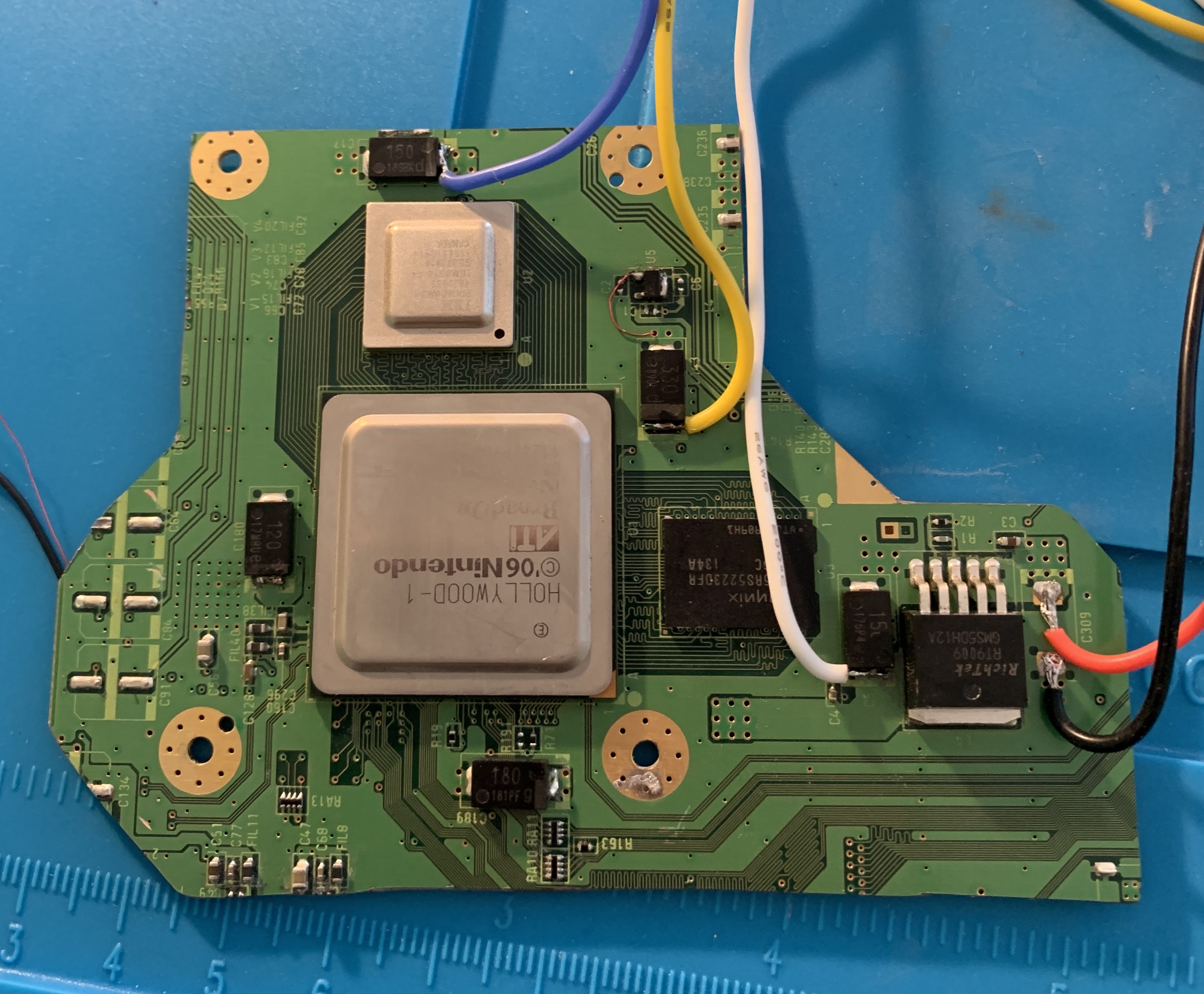

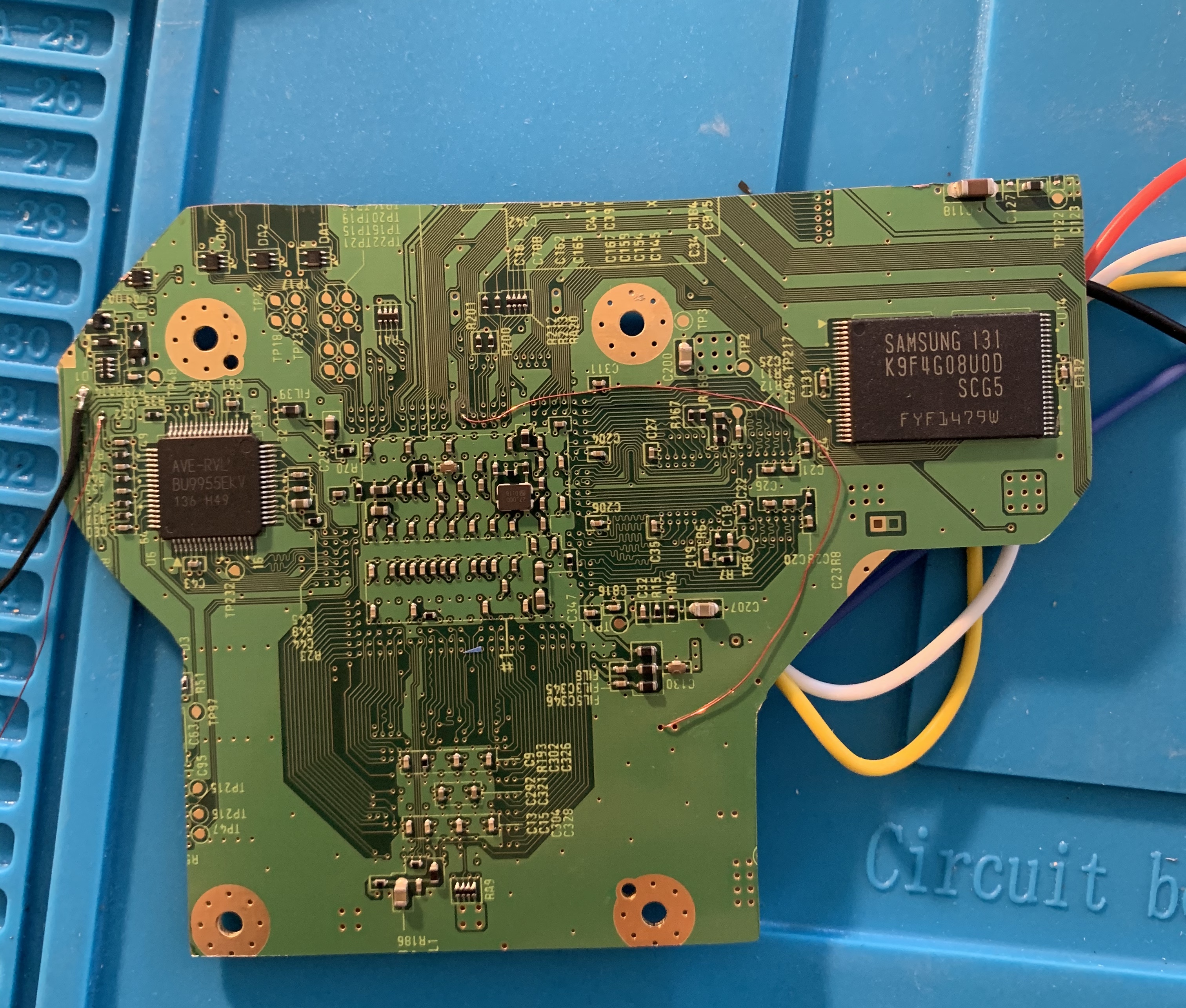

I trimmed my third motherboard. This time I did the U10 relocation before trimming and verified that it boots and composite video works. After trim, I measured the resistance and didn't see any short (1.0V: 214 Ohm, 1.15V: 57 Ohm, 1.18V: 37 Ohm, 3.3V: 16 kOhm). But I am getting no video on the composite. The LCD shows a blue waiting-for-AV-signal screen. What could I be doing wrong? Thanks.

If you do not remove the LDO you cannot wire 1.8v from the pms, you can remove this wire.
Thanks. Are you saying that I don't need to wire up 1.8 V?
Are you saying that I should sand more even though I'm not getting short on the voltage pads? I was afraid that I might make things worse by sanding more.
Thanks to Gman, I got the composite video to come on. The TL;DR version is that I used 26AWG to connect the PMS to the Wii. Once I replace the wires with 22AWG, the composite video started working.

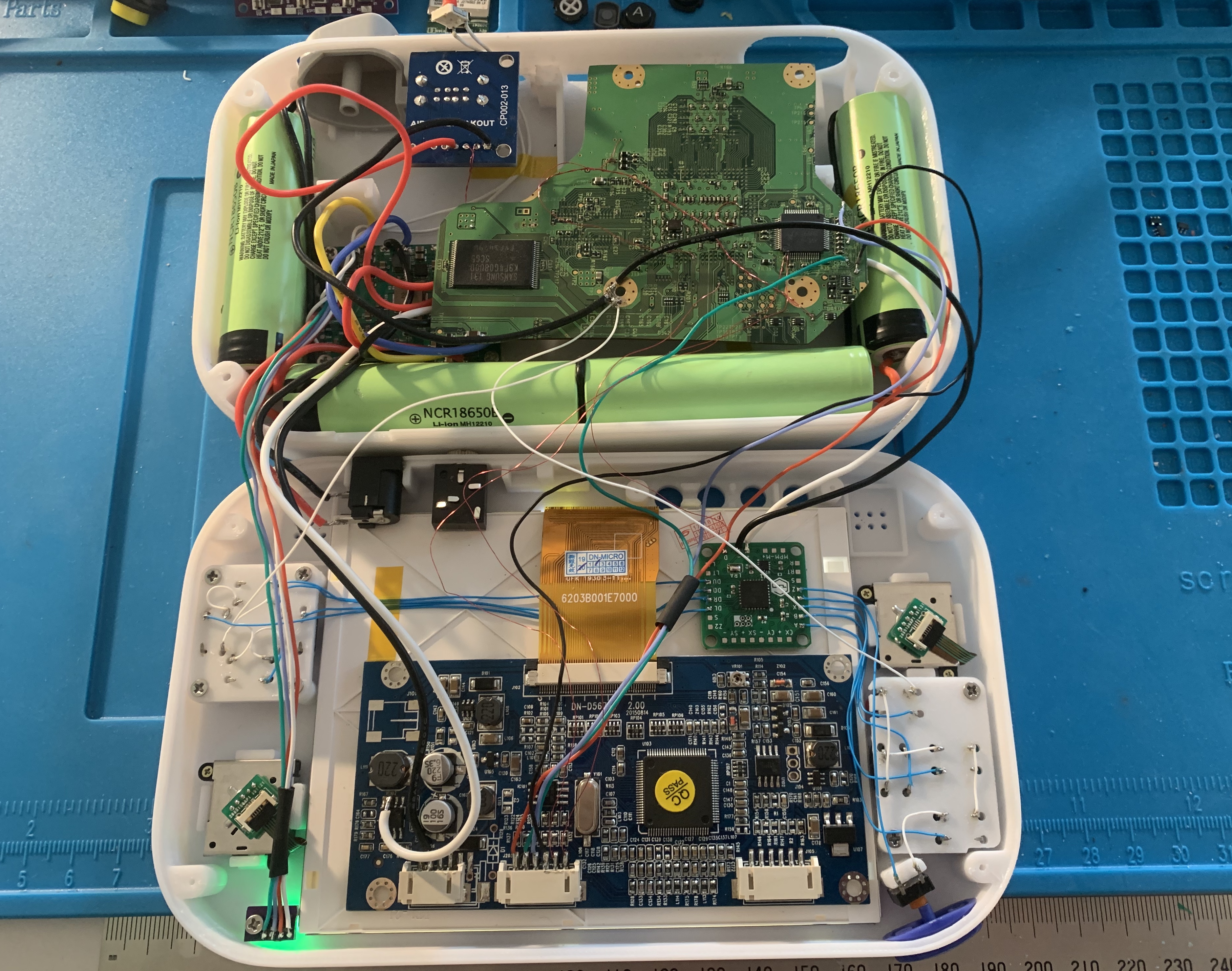

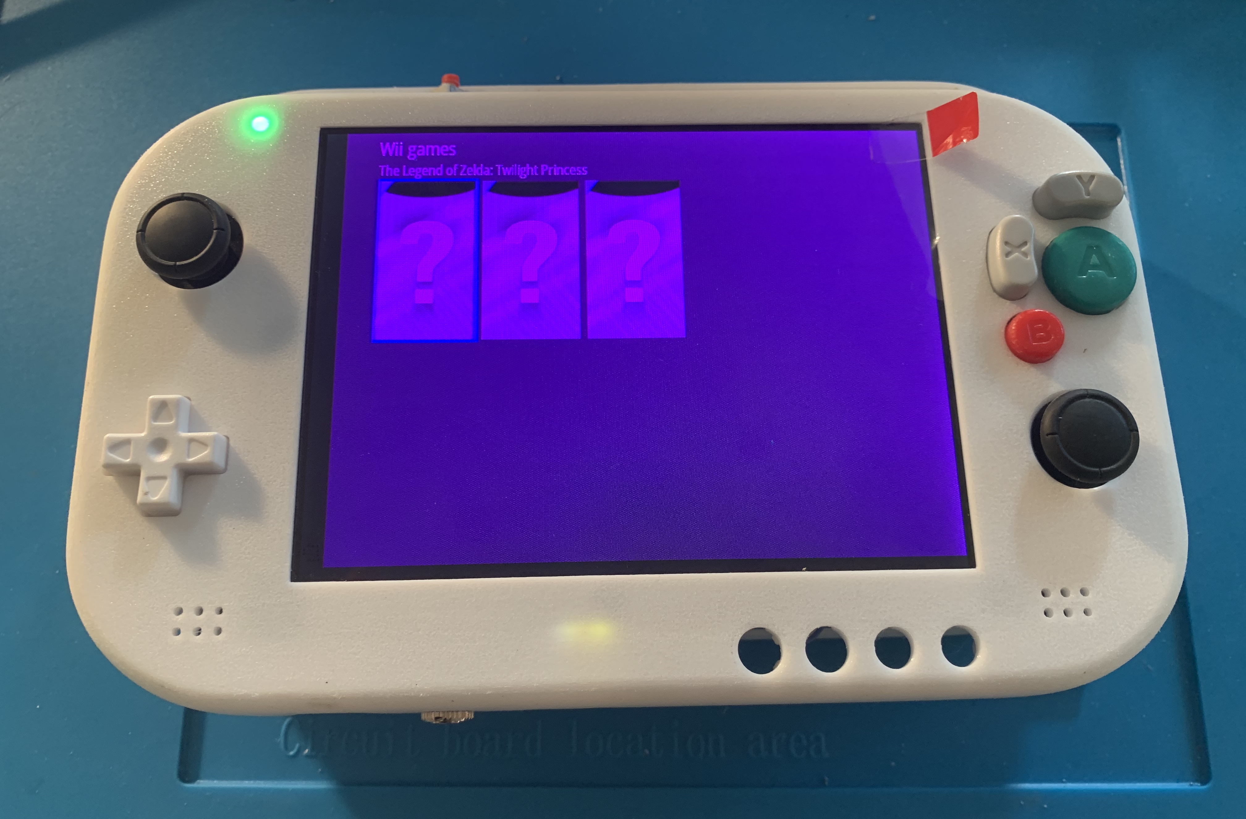

Thanks to Gman and others from this forum, I've made some good progress in the last few days. So far I'm able to get the WiiVision to boot from the USB drive and the A/B/X/Y and D-pad are all working. Native VGA is working also but the color is off. Since a picture is worth a thousand words, I'm attaching a couple of photos (please pardon the messy wiring).
Here are some questions that I still have and I'm not able to find from this forum or YouTube videos. Any guidance would be appreciated.
1. How to install the fan from the cooling kit that I bought from the BitBuilt store? Do I just superglue the metal side of the fan to the case?
2. Where do I wire the four buttons (two gray and the + and -) on the front to?
3. How do I wire up the potentiameter from the shoulder buttons to the GC+ 2.0?
4. Is the Joycon joystick click wired up to anything?
Thanks,
Tron

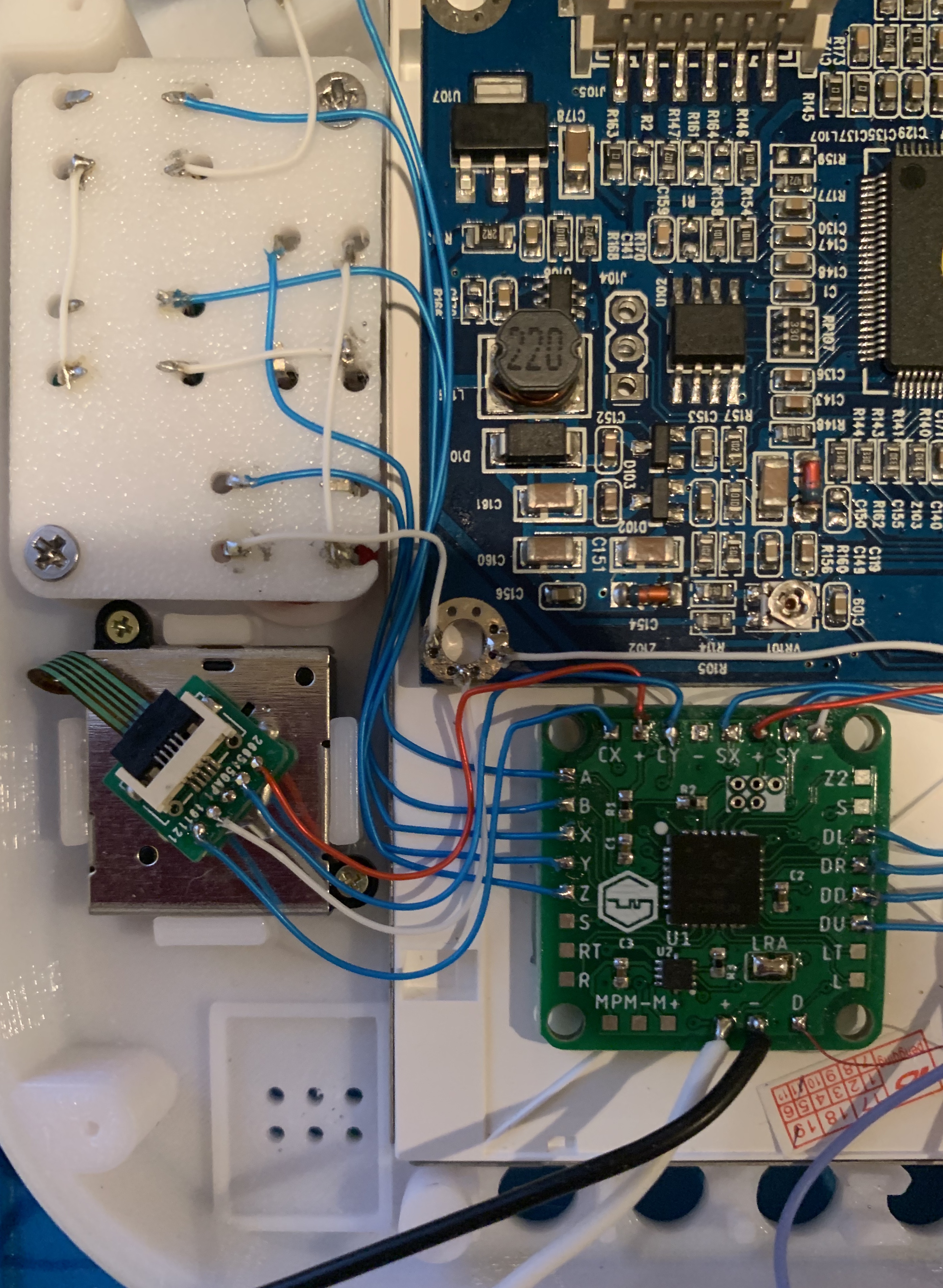

Can someone tell me if I wired up the joycon breakout board correctly to the GC+? I'm not able to trigger the BBLoader selection wheel/menu when I move the joycon joystick around after booting into BBLoader. Thanks.
It looks like you’ve got the c stick grounded to your screen instead of the gc+ board. I’d check with a multimeter if you’re getting 3.3 volts from the c stick and check the x and y axis move around the stick to see if the voltage is changing. If it’s still not working try the gc+ on a known working wii or the switch adaptor hooked up to dolphin. I’ve had problems with the c stick in the bbloader menu. The issue went away by pressing the reset button. Hope this helps.
