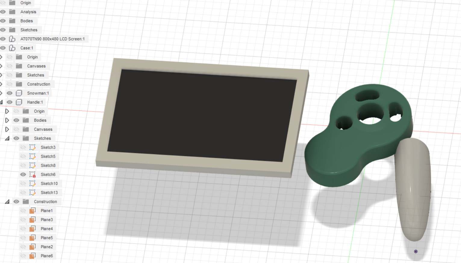

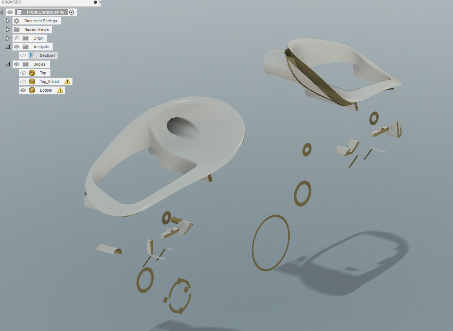

Case model progress so far:
  • Right hand controller 'snowman' shape for thumb buttons and C stick

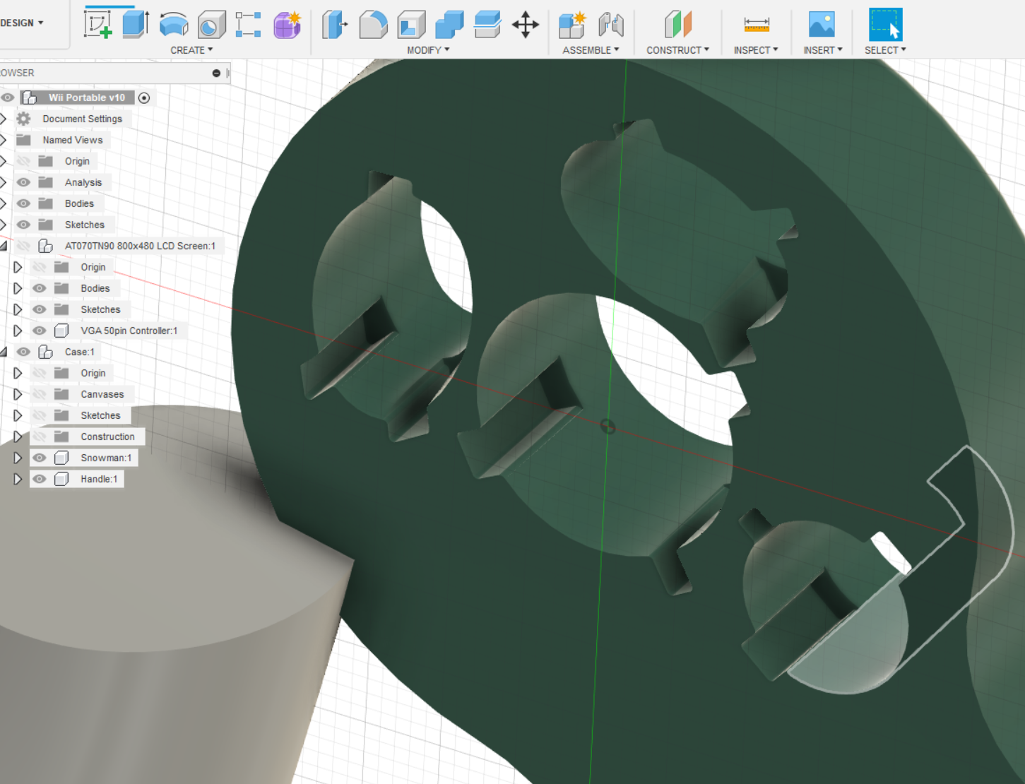

  • PCB layer button holes / tab slots that loft up into the controller face button cutouts
  • Experimenting with lofts and rails to get the shape/look (and hopefully feel of the controller in my palm)

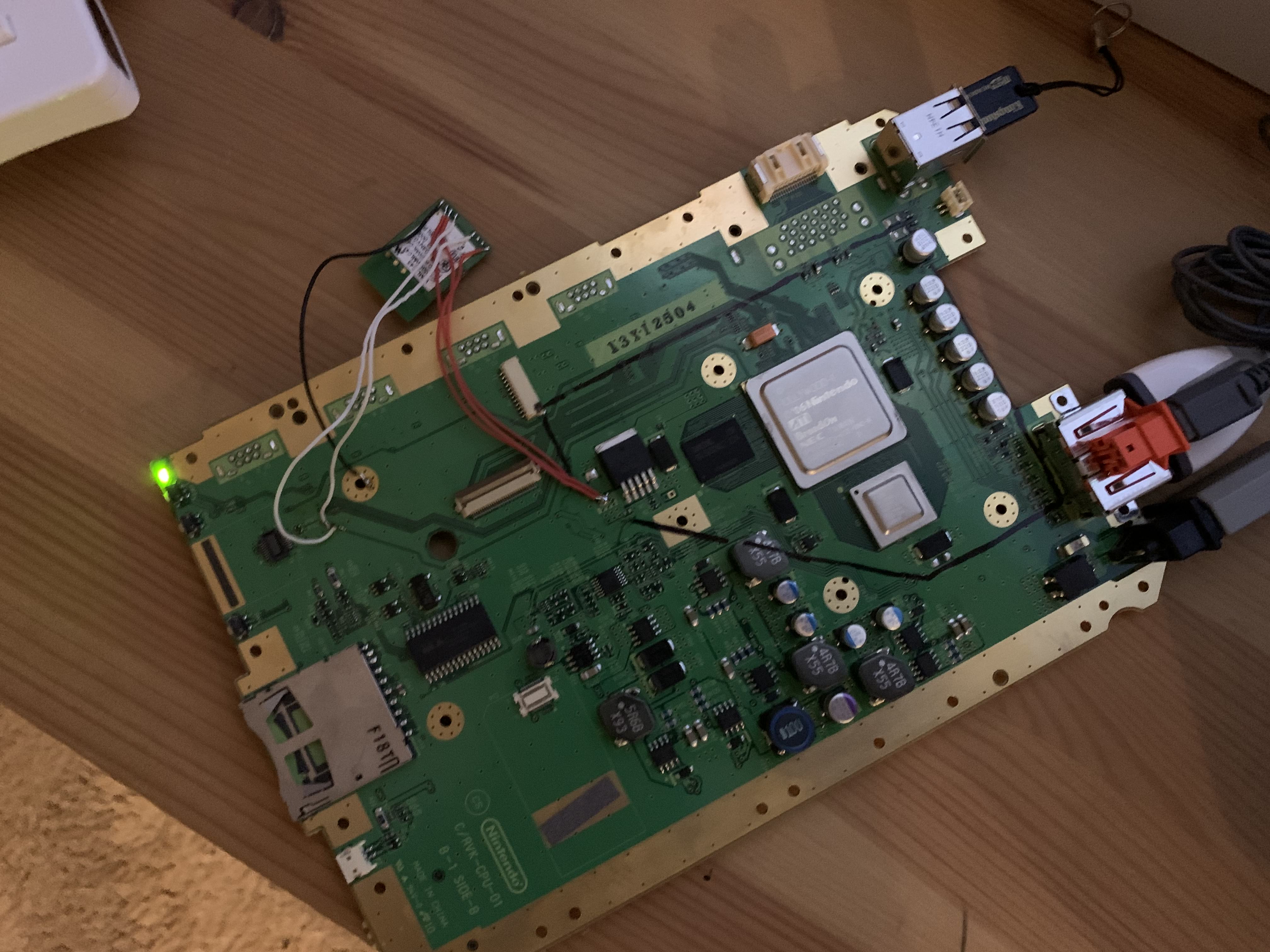

Shuck successful after installing RVLoader and a couple of games to test.

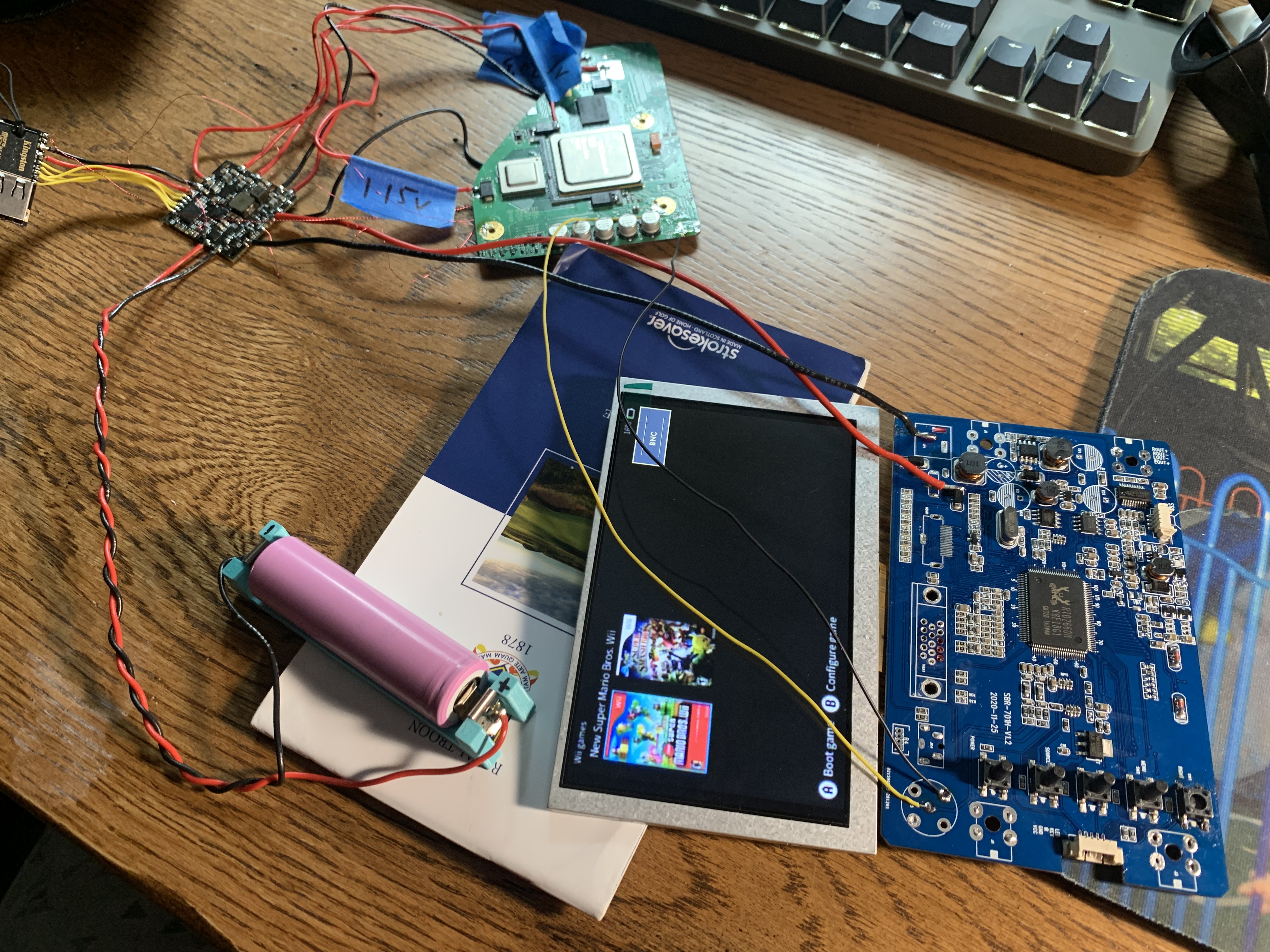

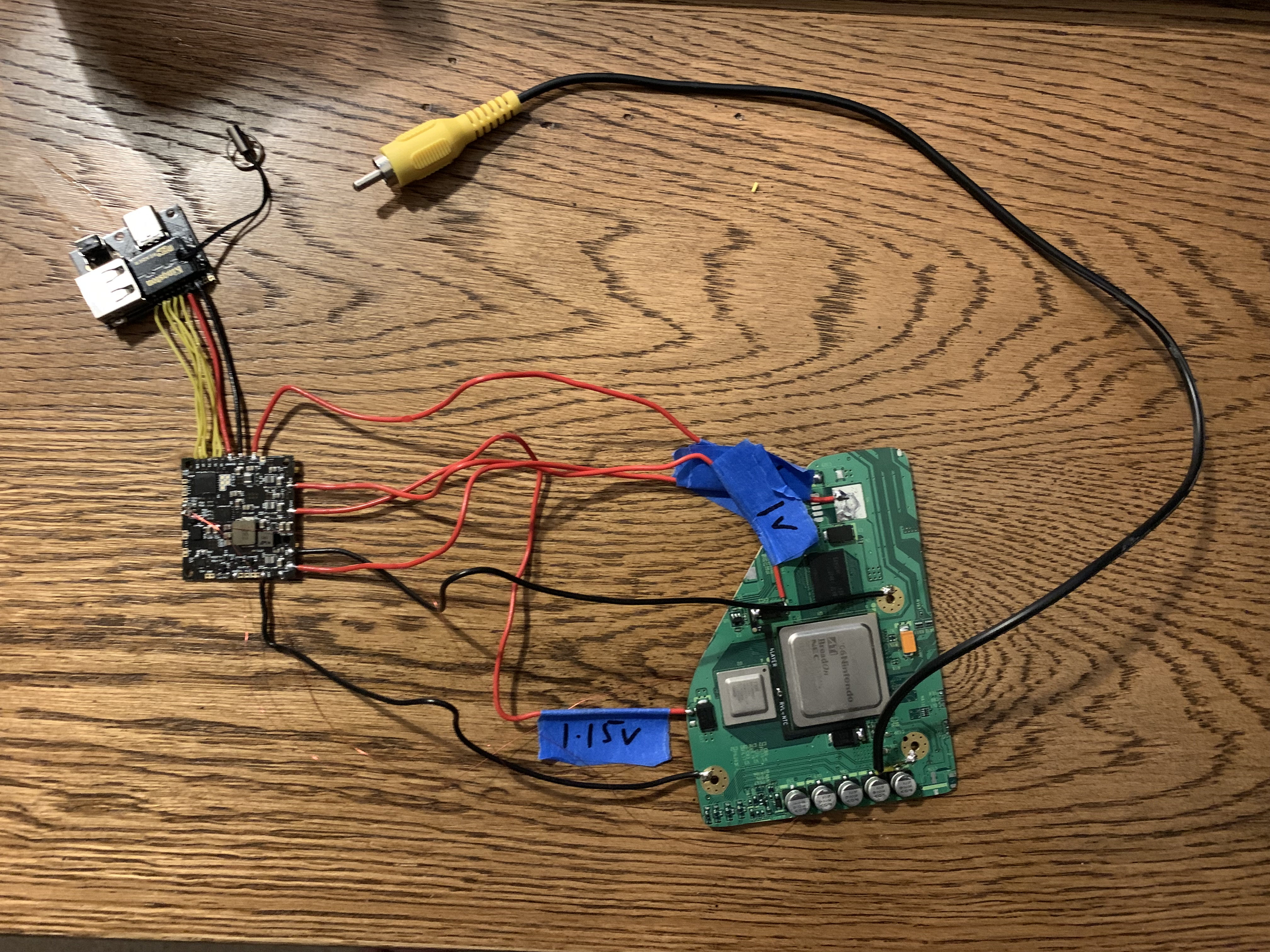

Figured I would practice scratching and soldering some traces and seeing if I could get the bluetooth module relocated successfully. It worked!
I will be trimming the board and wiring together a test bench with my 4layer components when my magnet wire arrives. Still got a long way to go modelling the case and spent the past week wrapping my head around the mesh import / conversion process and messing with the surface modelling tools that Fusion 360 has to offer. I elected to ditch the parametric re-model of the GC controller. Thanks to @Wesk's controller scans and @LightPulsar's awesome mesh cleanup , the hard part will just be the union between my case design and integrating all my other components.
Trim resistances were a little lower than I expected, 3v3 was in the 4k ballpark. Discovered I can't just plug in USB-C to power up so will snag a couple of 18650s or if I'm feeling impatient borrow a benchtop power supply from work. Surprisingly fun soldering this all together - magnet wire was not as finicky as I was expecting but it helps having a usb microscope and plenty of flux (snagged a wee bottle of circuitworks CW3220 from amazon and the stuff is great!). I fully expect soldering in the tight space of a portable to be a PITA though...

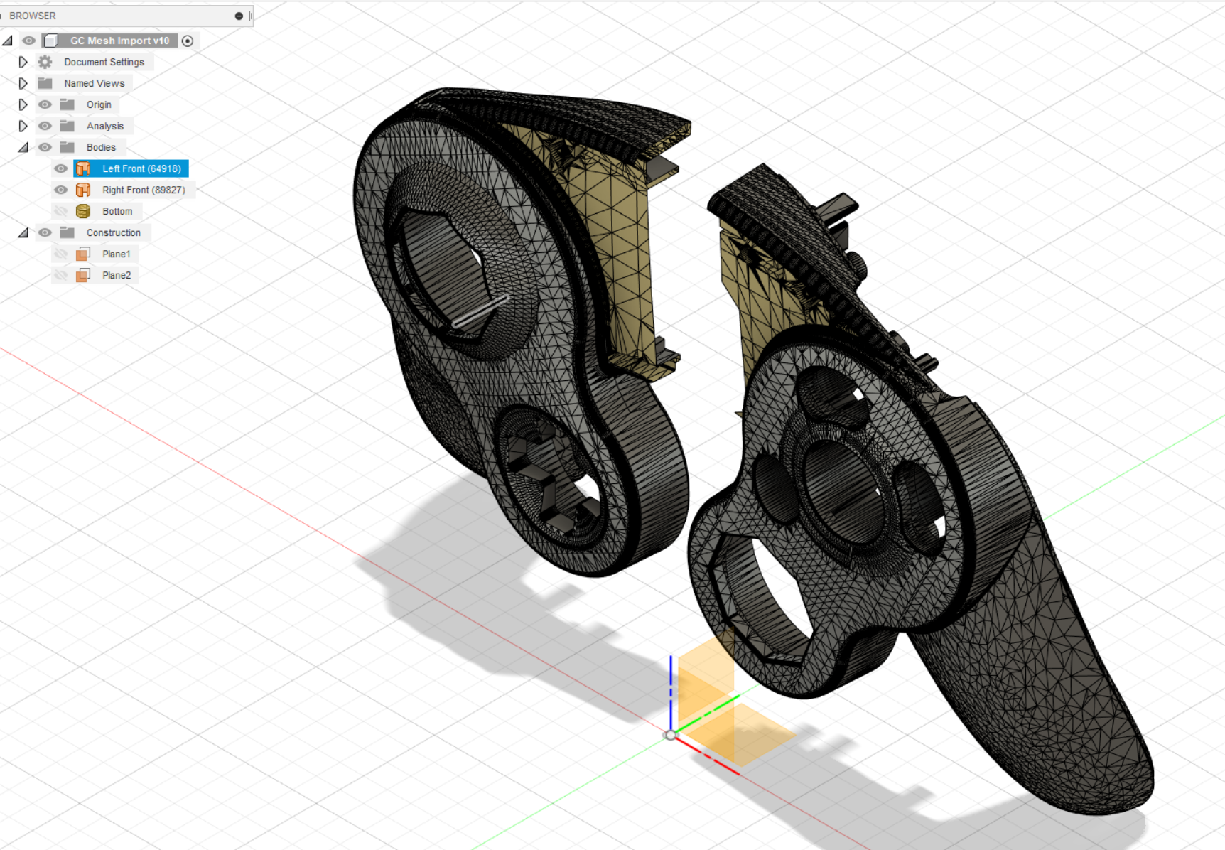

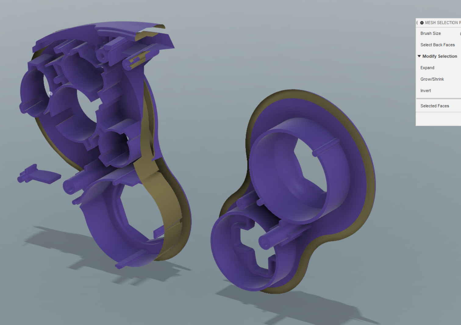

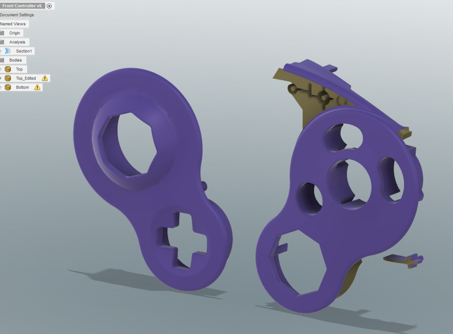

Been taking things slowly over the past few days / couple weeks. Painstaking mesh trimming work to integrate just the parts of the GC controller I want (including OG PCB and button/trigger mounting locations) and tossing the rest.
My 18650s finally came in and somehow my trim miraculously booted on 1st attempt! Me being a dummy though accidentally repaired the my wiimote to my other wii so I can't switch composite to VGA until I get some working controls wired up :facepalm:

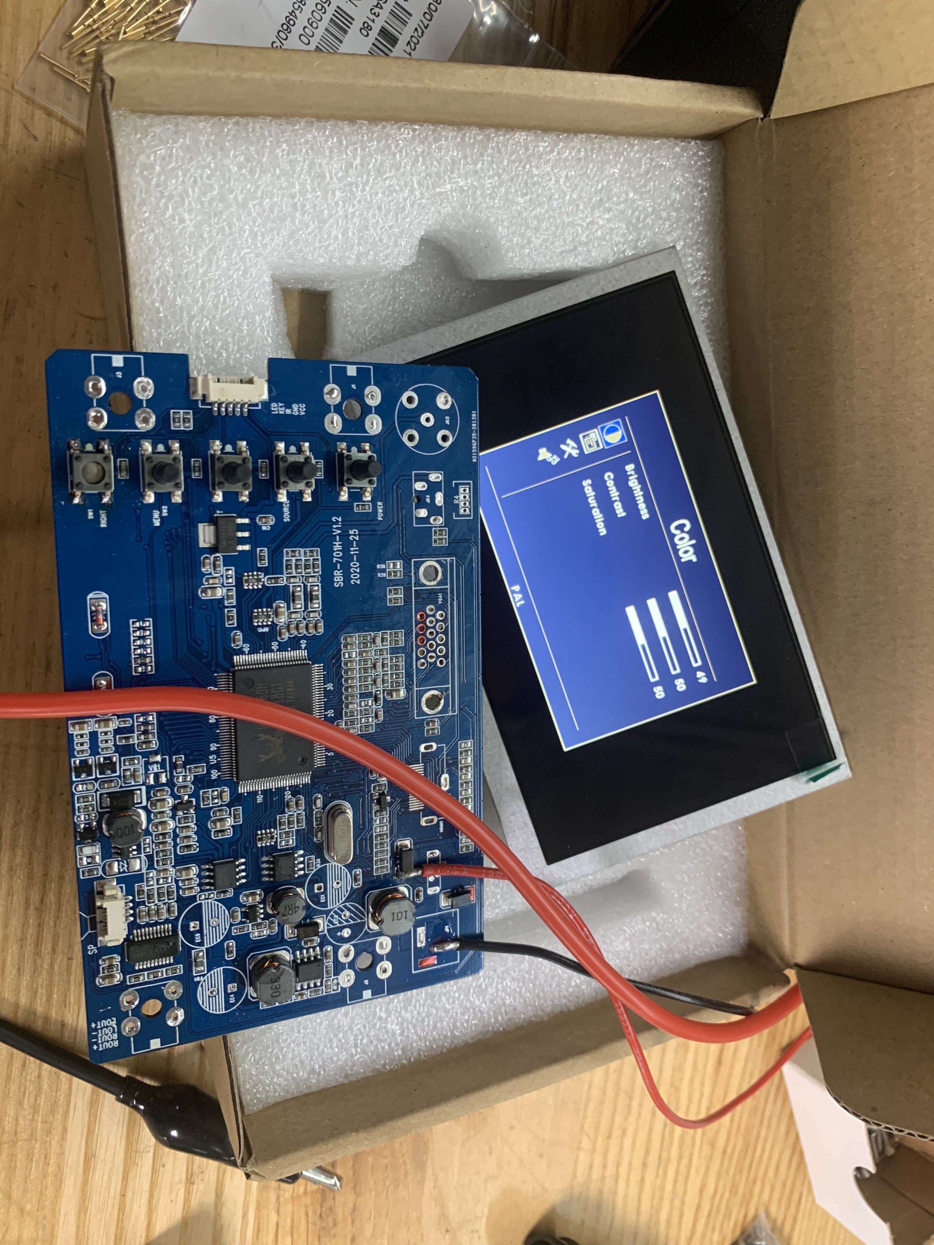

Thinking I will likely need a hot air rework station to properly attack my LCD driver board. @RoseDagger kindly shared his trim of a similar eyoyo board which was mighty helpful. Although I think mine may be a slightly newer rev (SBR-701H-1.2 2020-11-25 according to the silkscreen).
I'm not sure if you're aware but there is a full STEP Model of a GC controller on the CGCC discord, was posted about a week ago and is extremely accurate.
Can be found here: CGCC Discord GC STEP
Thanks Wesk. That link seems to just keep taking me to the discord web browser login. I will see if I can find those steps, but tbh I have found it a pretty good exercise for familiarizing myself with the mesh editing tools of Fusion 360. If I mess them up royally then I can always fall back on the updated steps. Although, my plan is to take the trimmed mesh bodies, convert them to surface reps and teach myself how to surface model to get the case design I have been imagining.

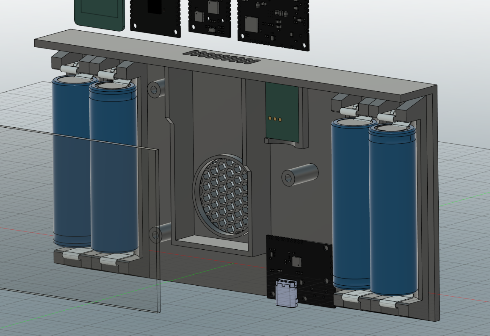

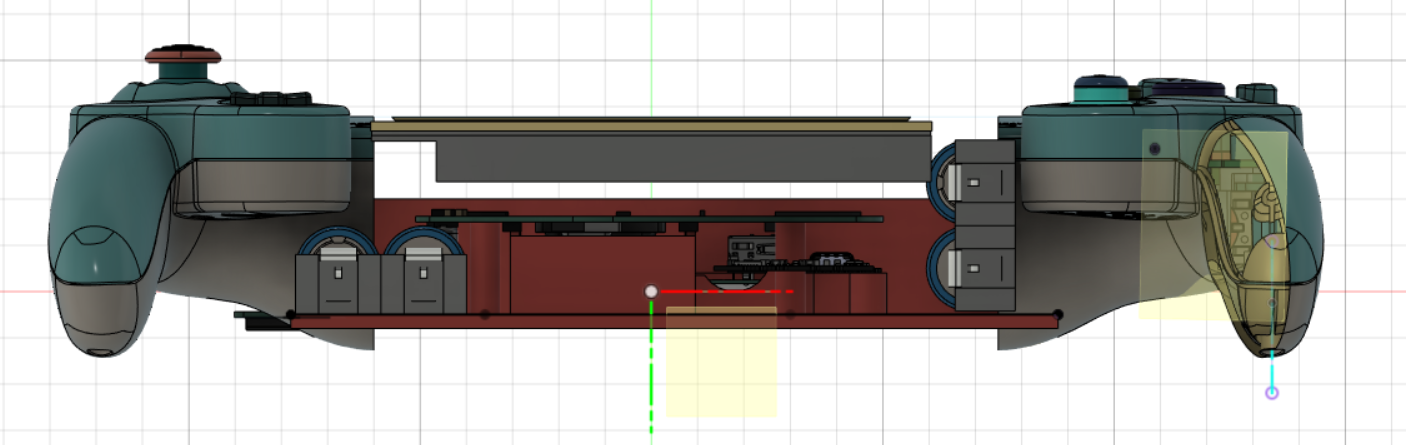

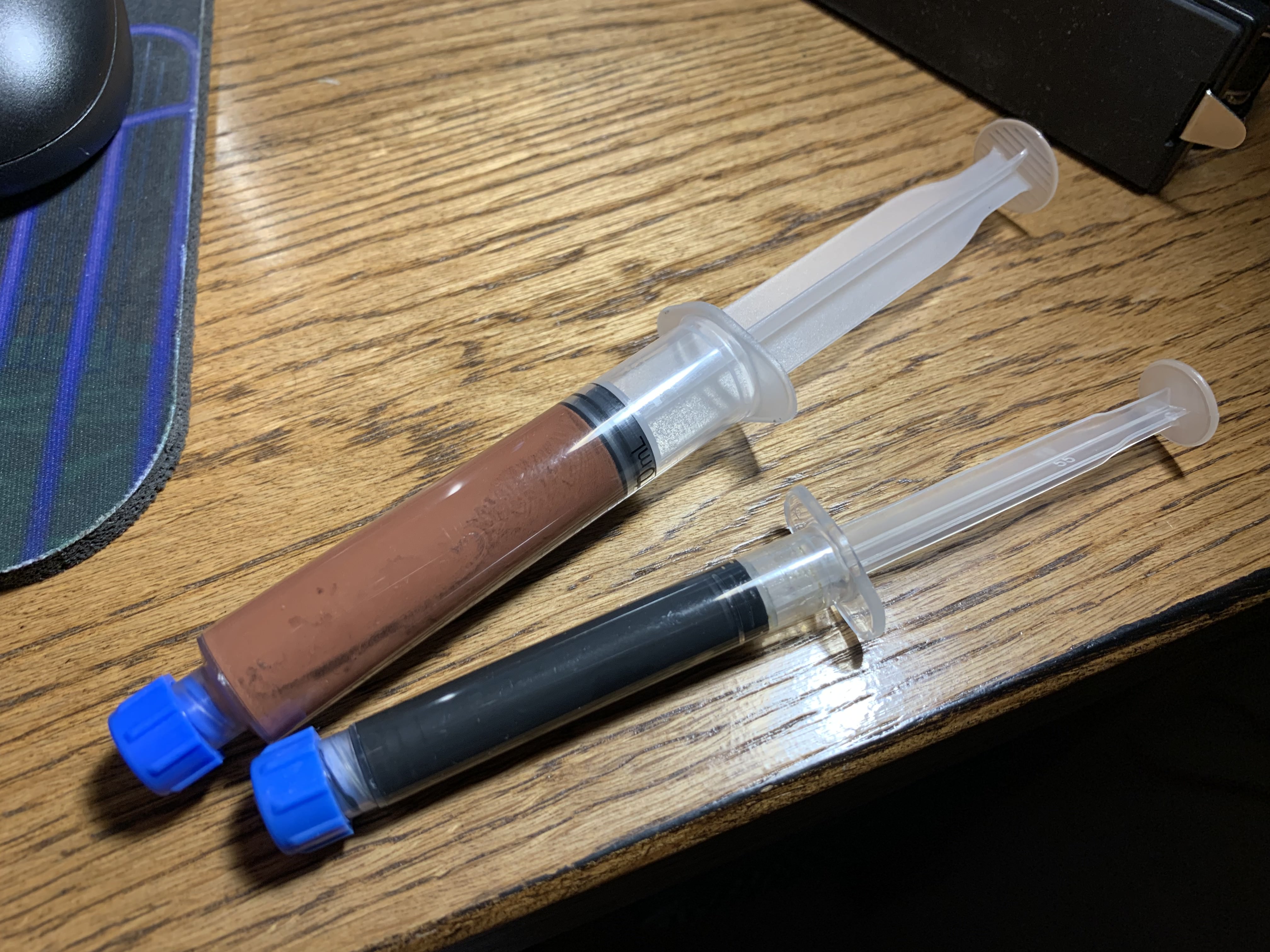

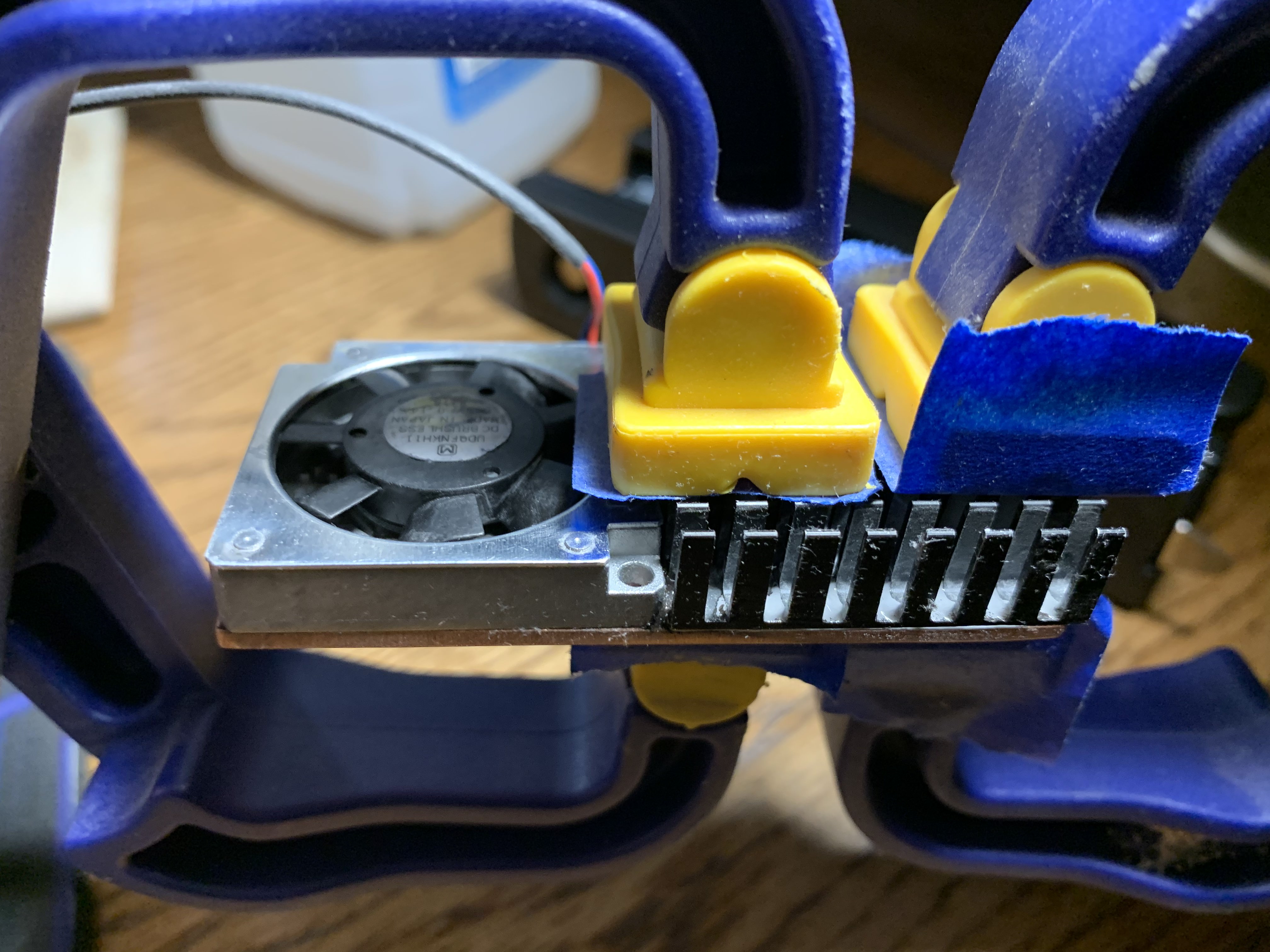

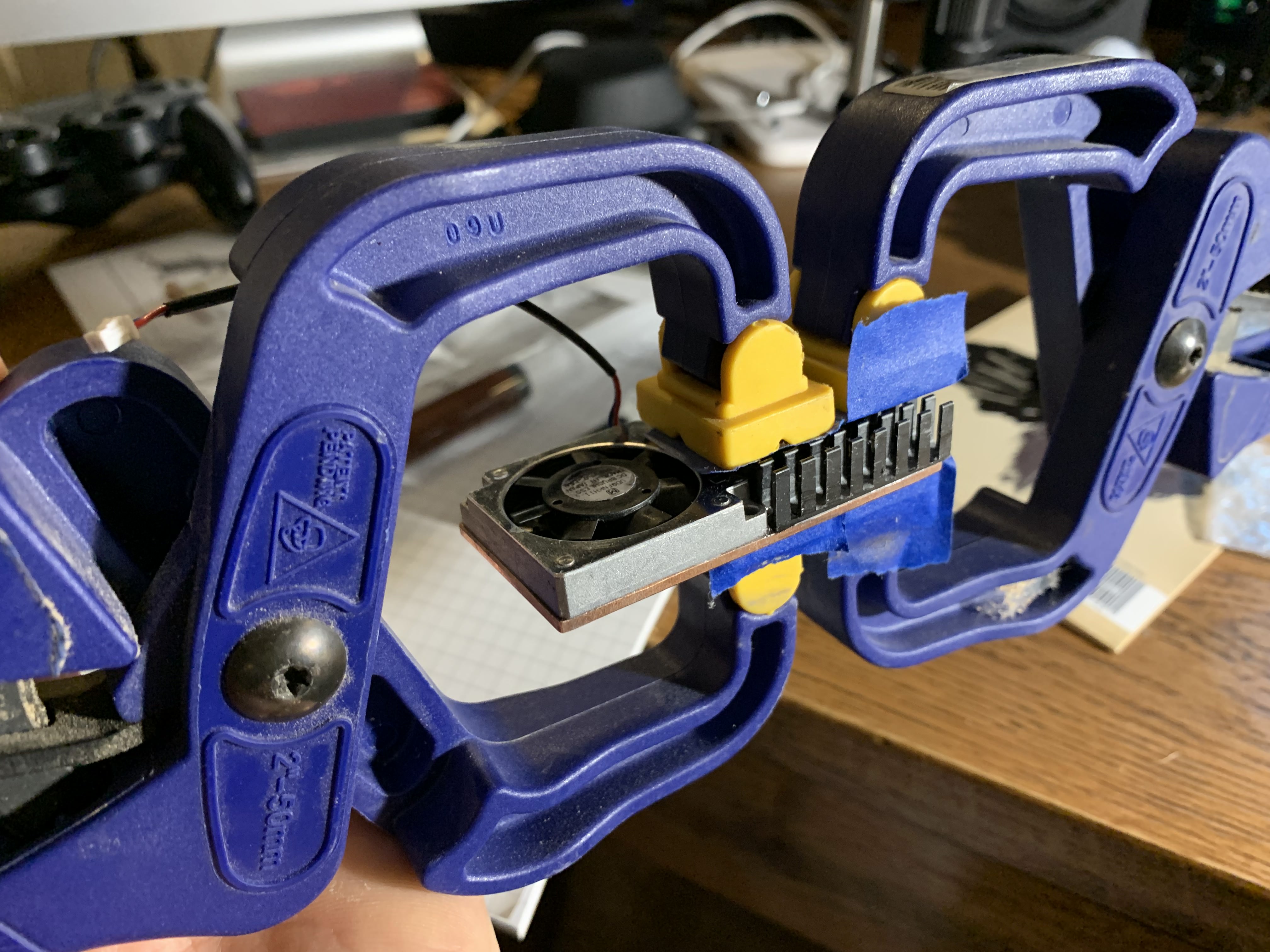

In the mean time, I found a moment at work to lap the heatsink, fan and copper plate - luckily we have a material lab with a nice water disc polisher. I sandwiched them all together with thermal paste and Tech Ingredient's thermal epoxy around the edges to hold it all together.

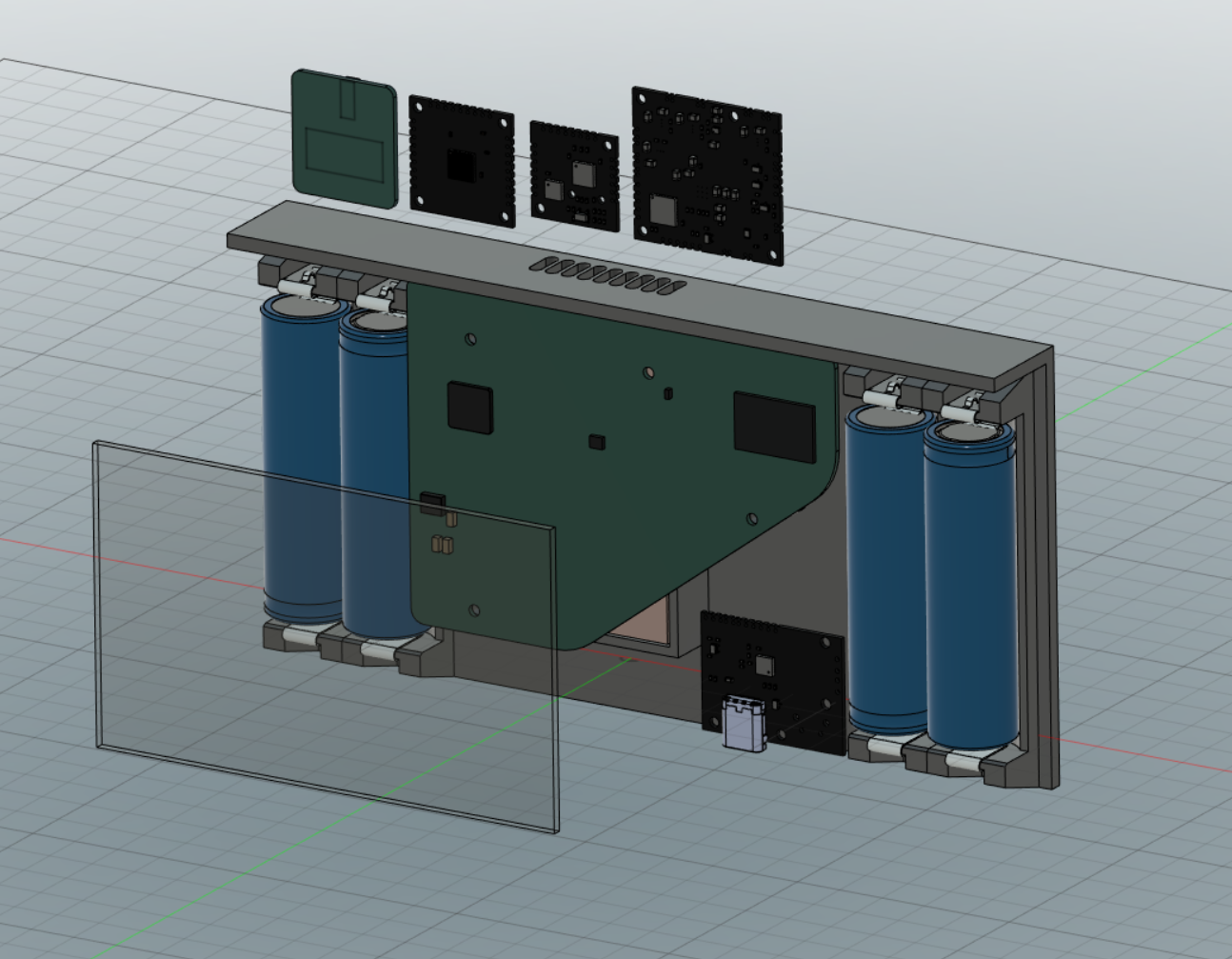

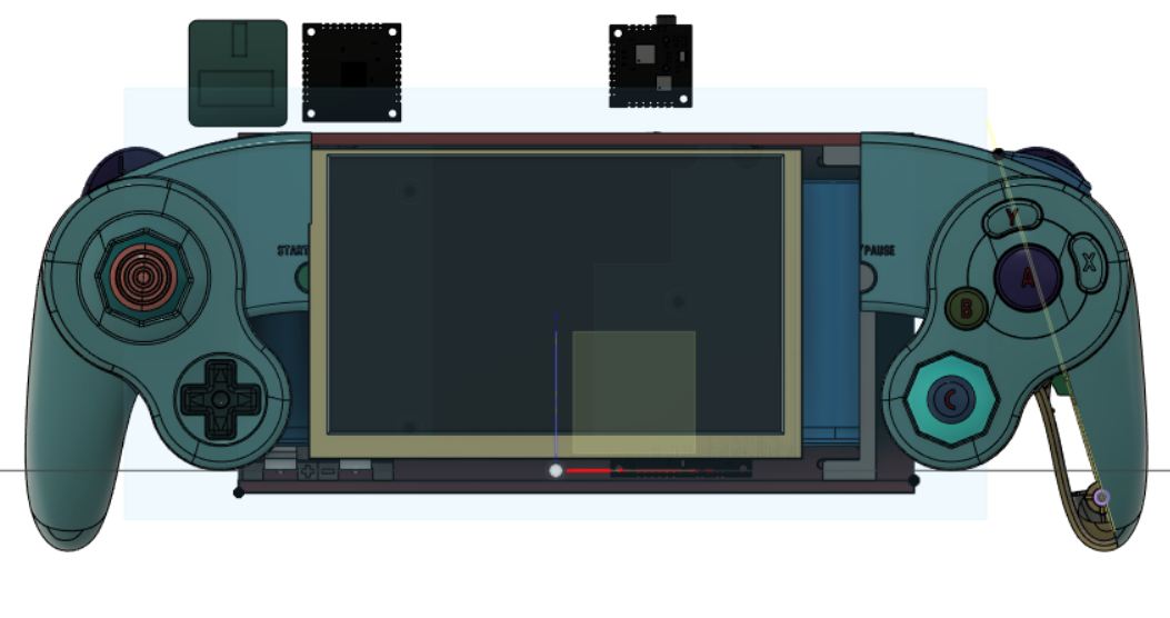

I left my case design off at a point where I may have to compromise on the total qty of batteries or the overall thickness of the portable - really wanted 4 x 18650s but might go to three to reduce the overall width if it ends up being a chunky boi. I don't want the case to dominate the screen. Most of the GC controller handles and face will be chopped off leaving mainly the face button snowman and the shoulder button geometry.
Finally back at it! Hot work station at work reallly helped with the LCD board paring down.
LCD screen a success!
