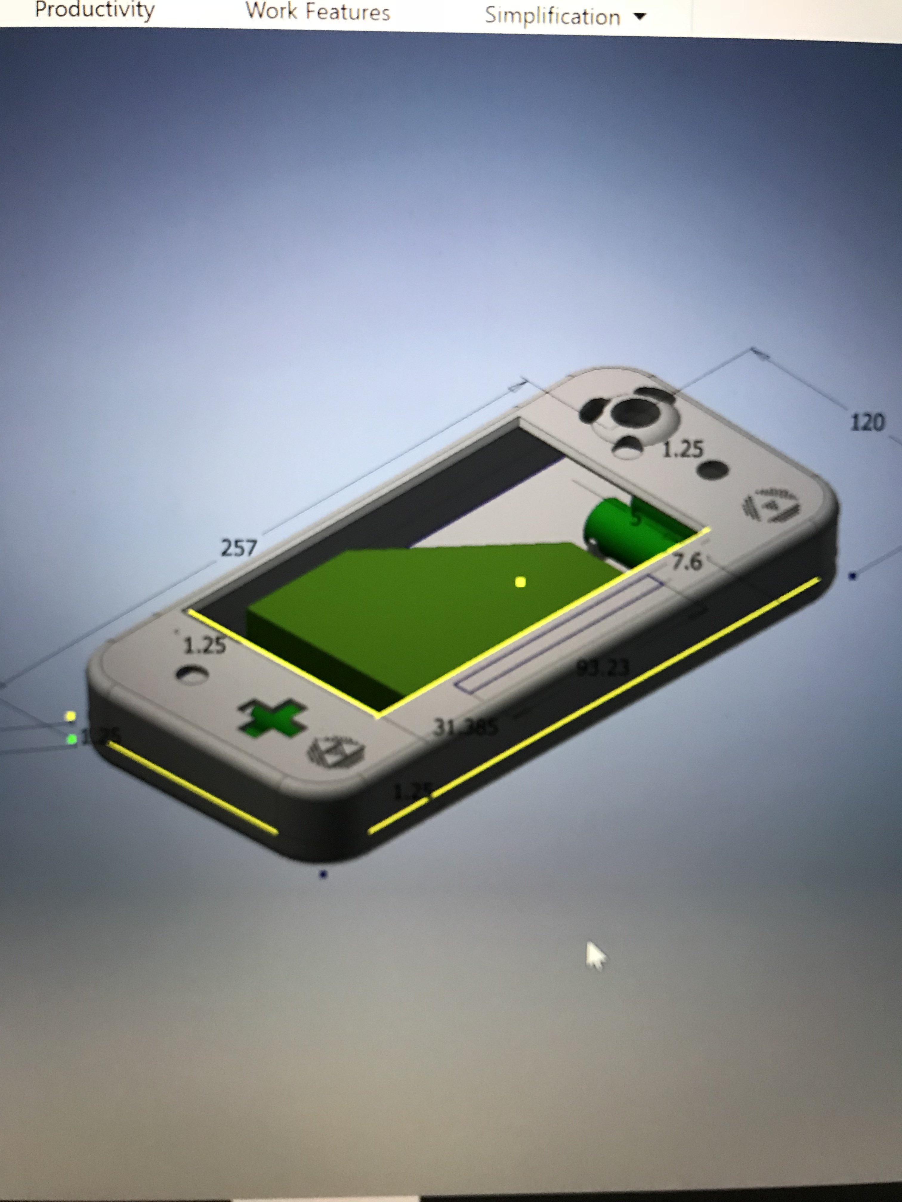

I worked on it a little bit last night and here’s where I’m at. Obviously I’ve got lots to do still, shoulder buttons, fan airflow, etc. etc. but it’s coming along!

I don't know much about 3d printing but don't you want the top of the case to be flat so that it prints easier? I would imagine having the bump for the ABXY buttons and/or the raised speaker grill would cause issues.

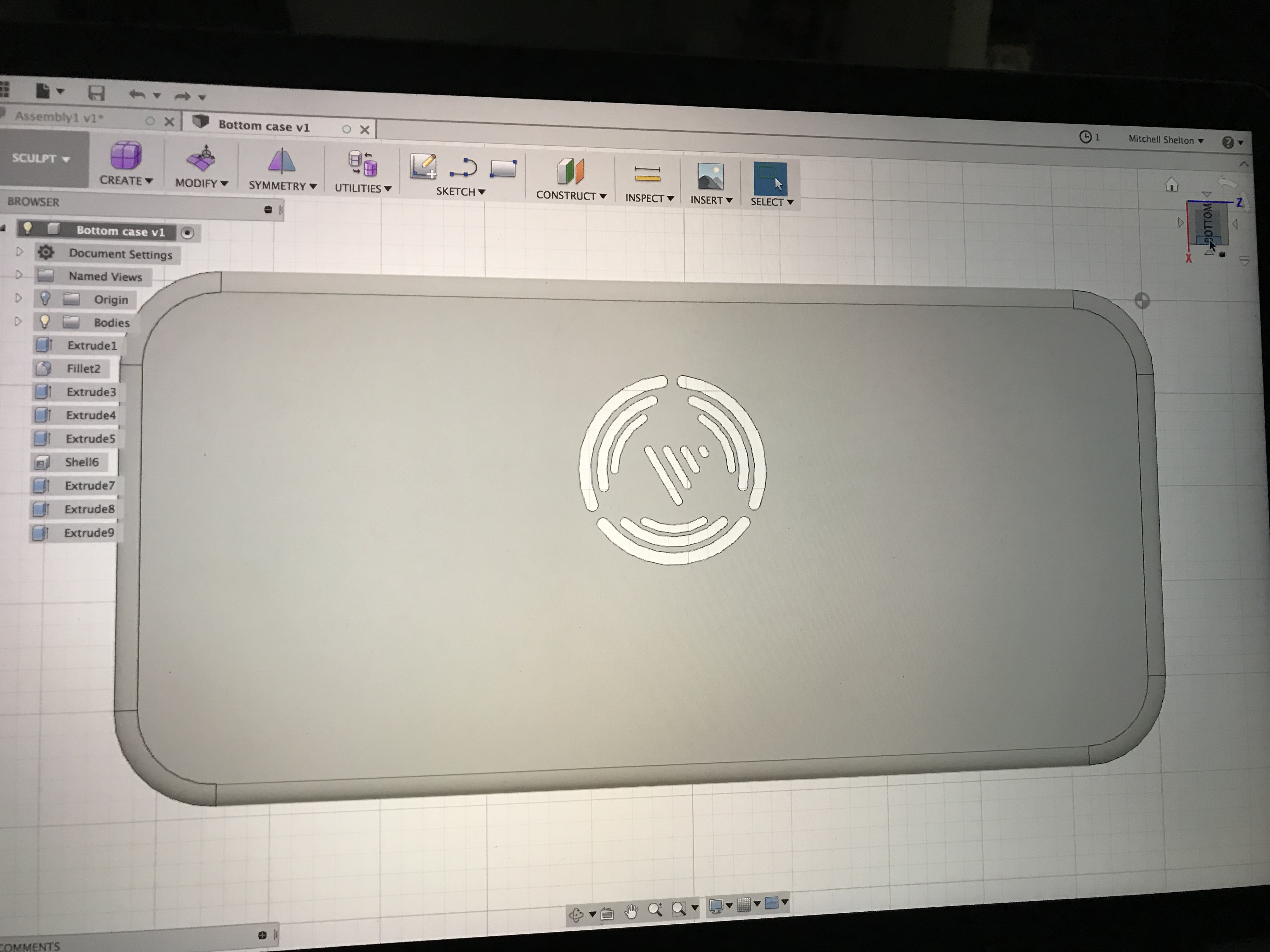

A 3d printer may also have trouble printing those tiny speaker grill holes. I remember ginger had a problem with this in his. I love your case though...
For a hobby or entry-professional 3d printer, a speaker grill like on the original GBA (not SP) or on the original DMG will print much better than small round holes. You could still put the triforce inside it, but just keep it more like long slits rather than small holes.

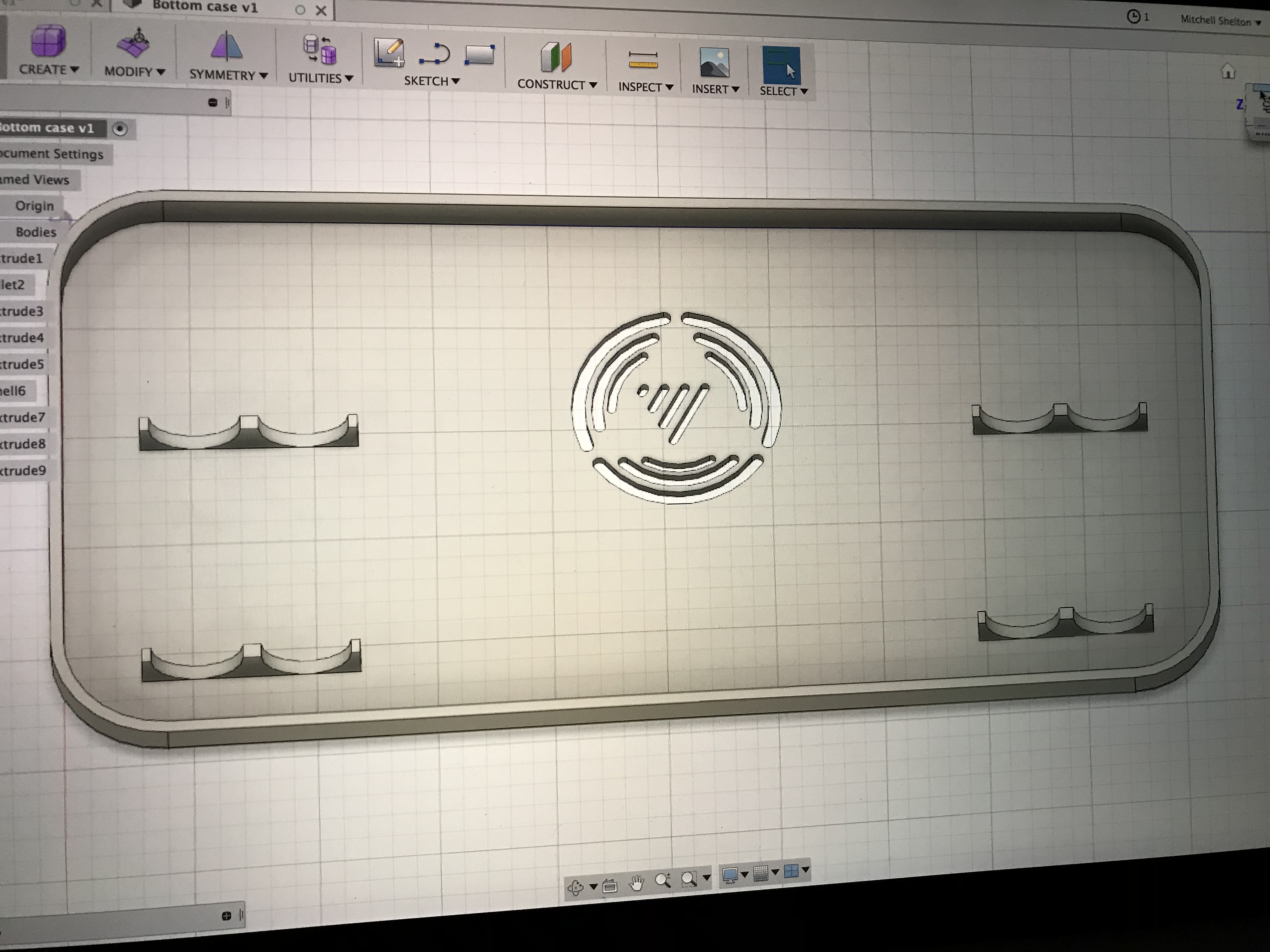

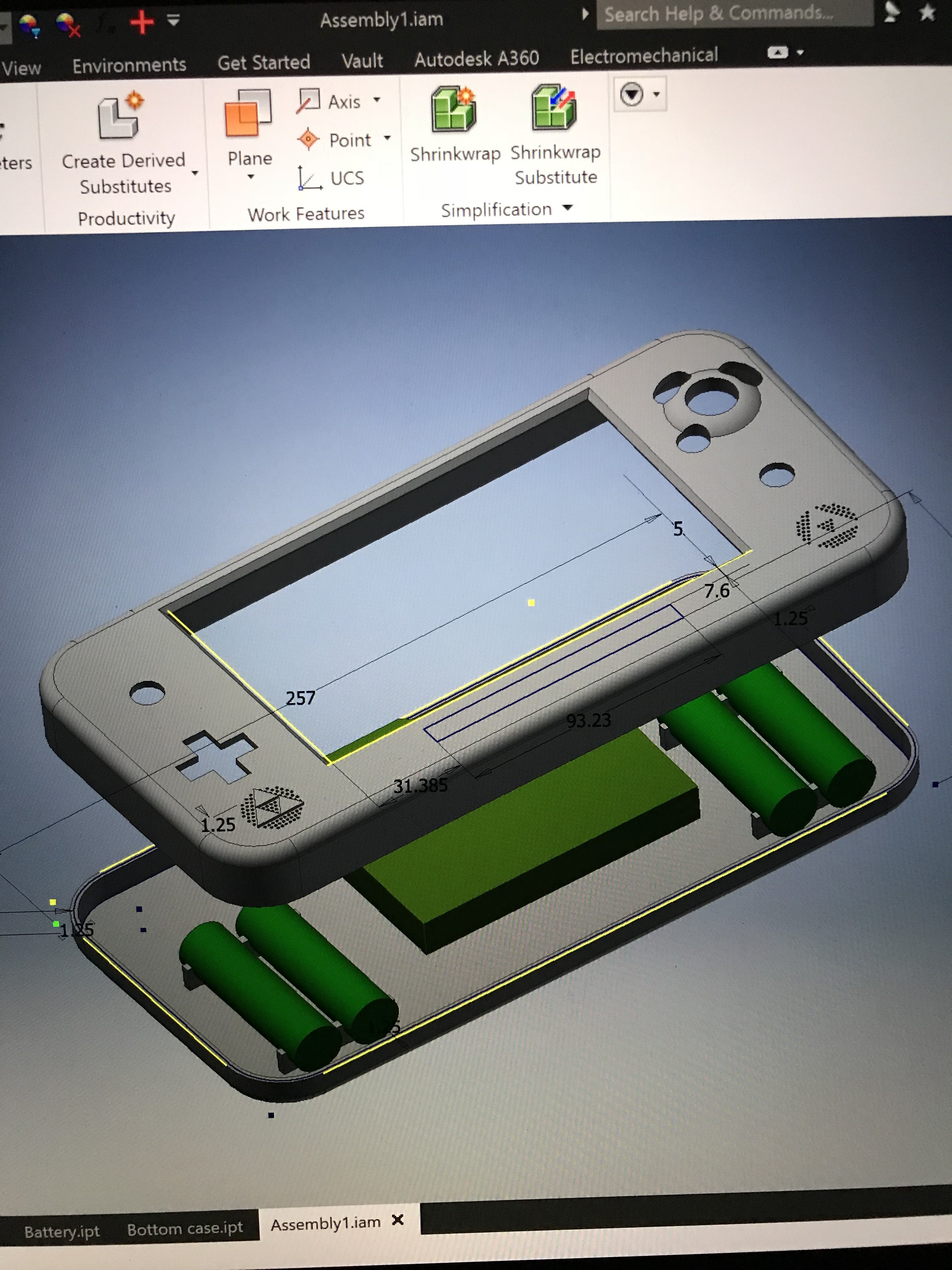

About the speaker holes and 3D printing stuff, my university has two professional printers (one $45,000 and one $120,000) and it would be them printing it for me rather than me myself. So I’ll be sure to talk to them about the designs and everything to make sure it’s possible to get them printed with their equipment.
Here’s another quick design update:
