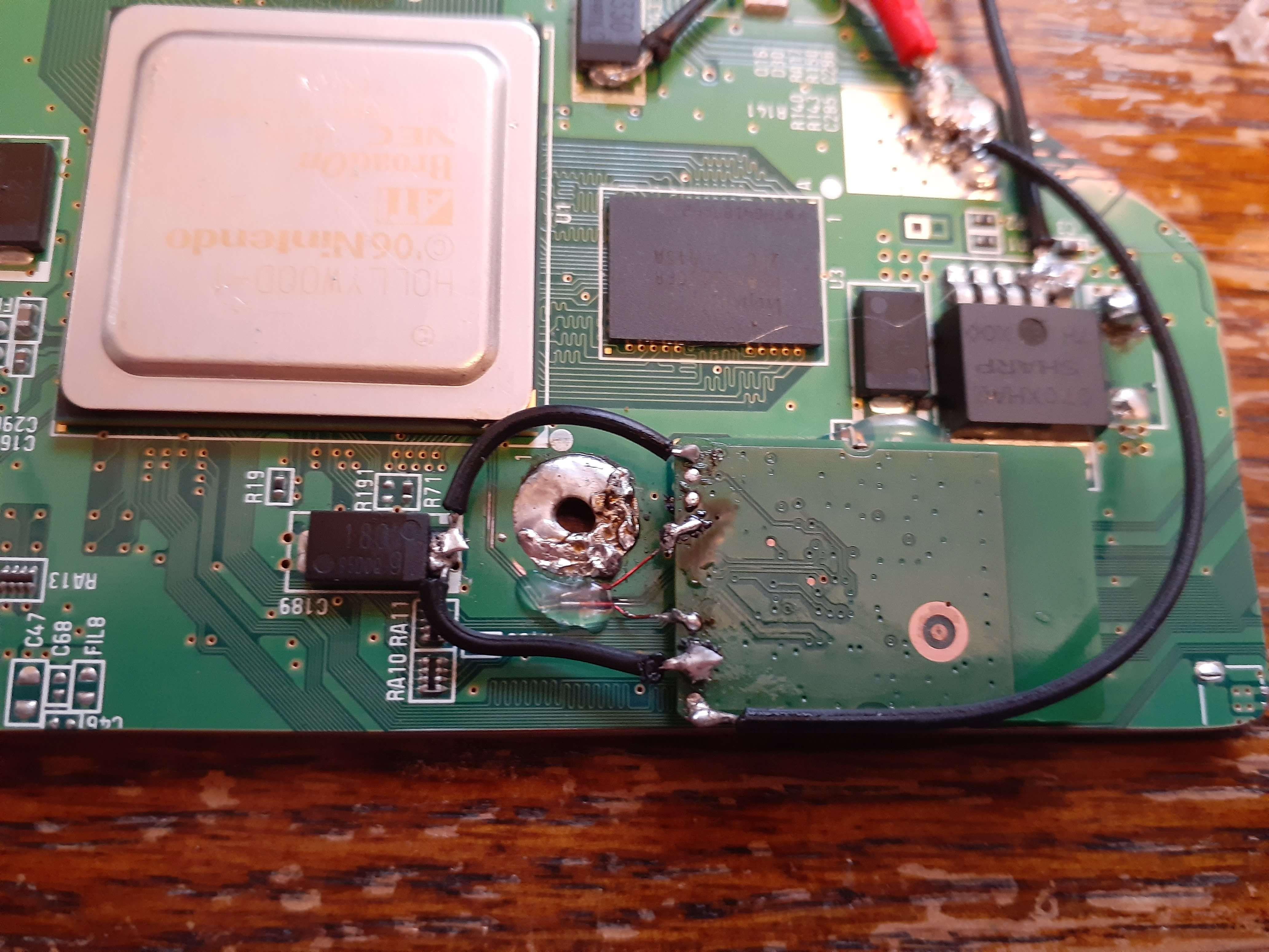

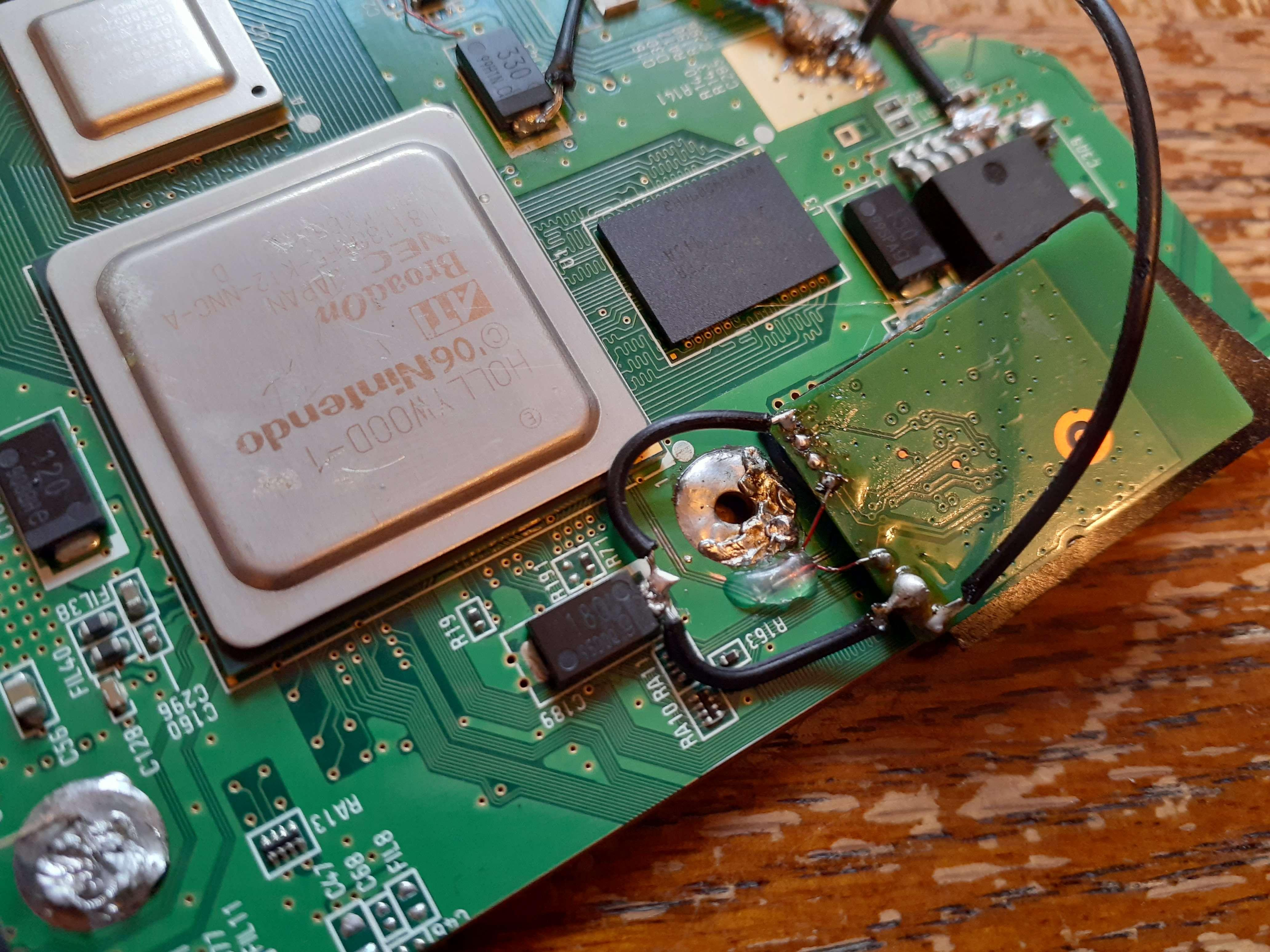

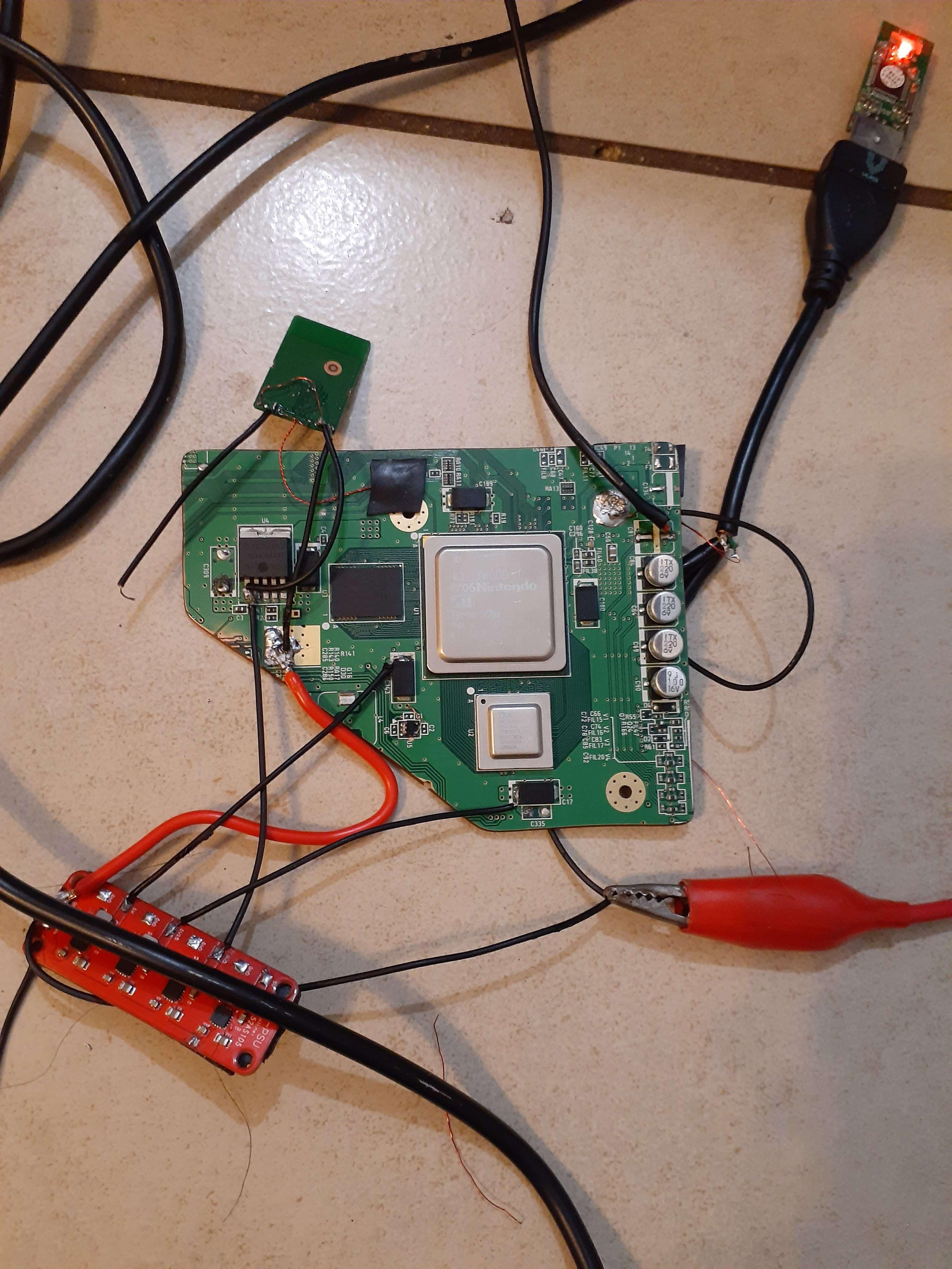

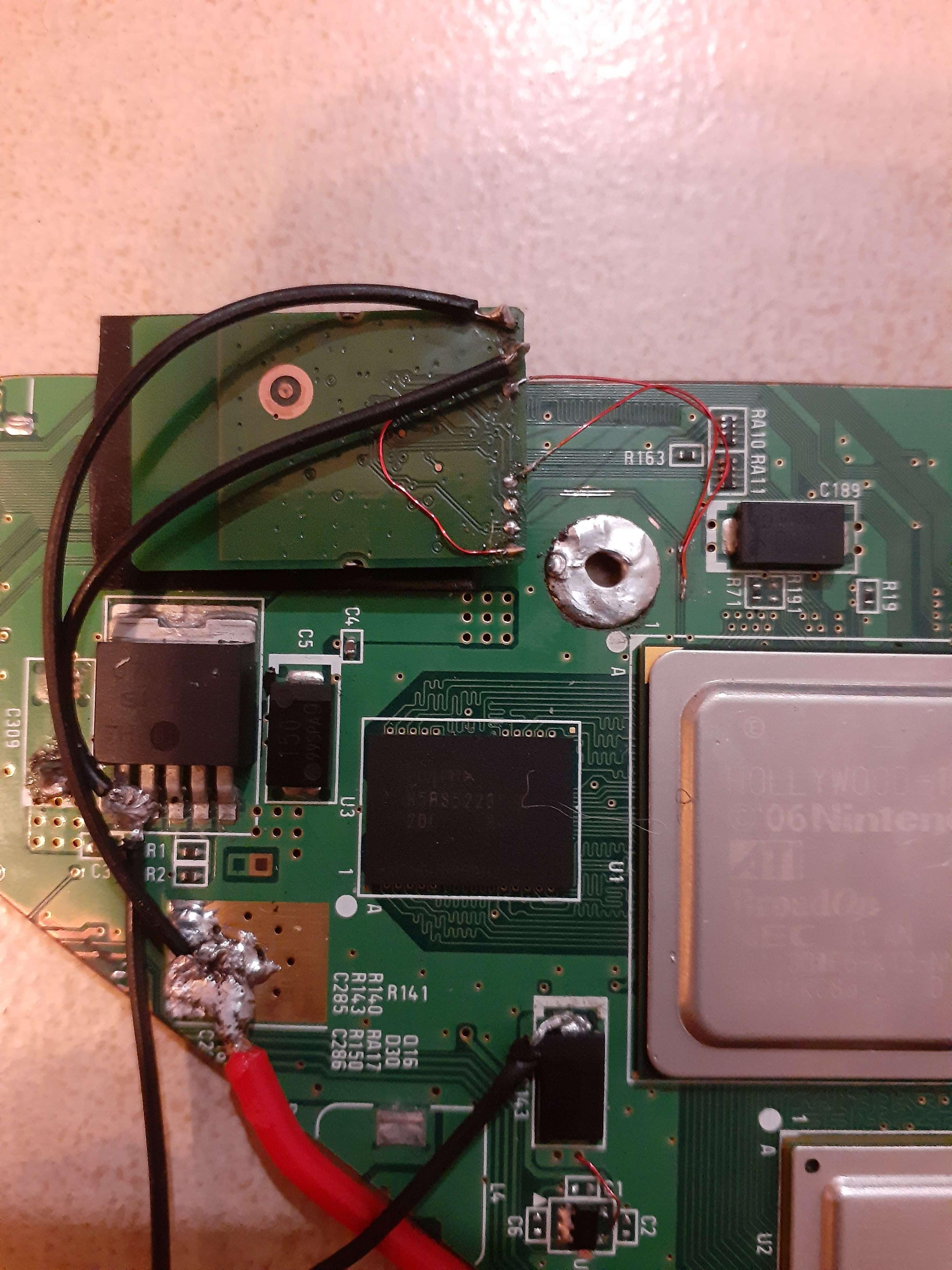

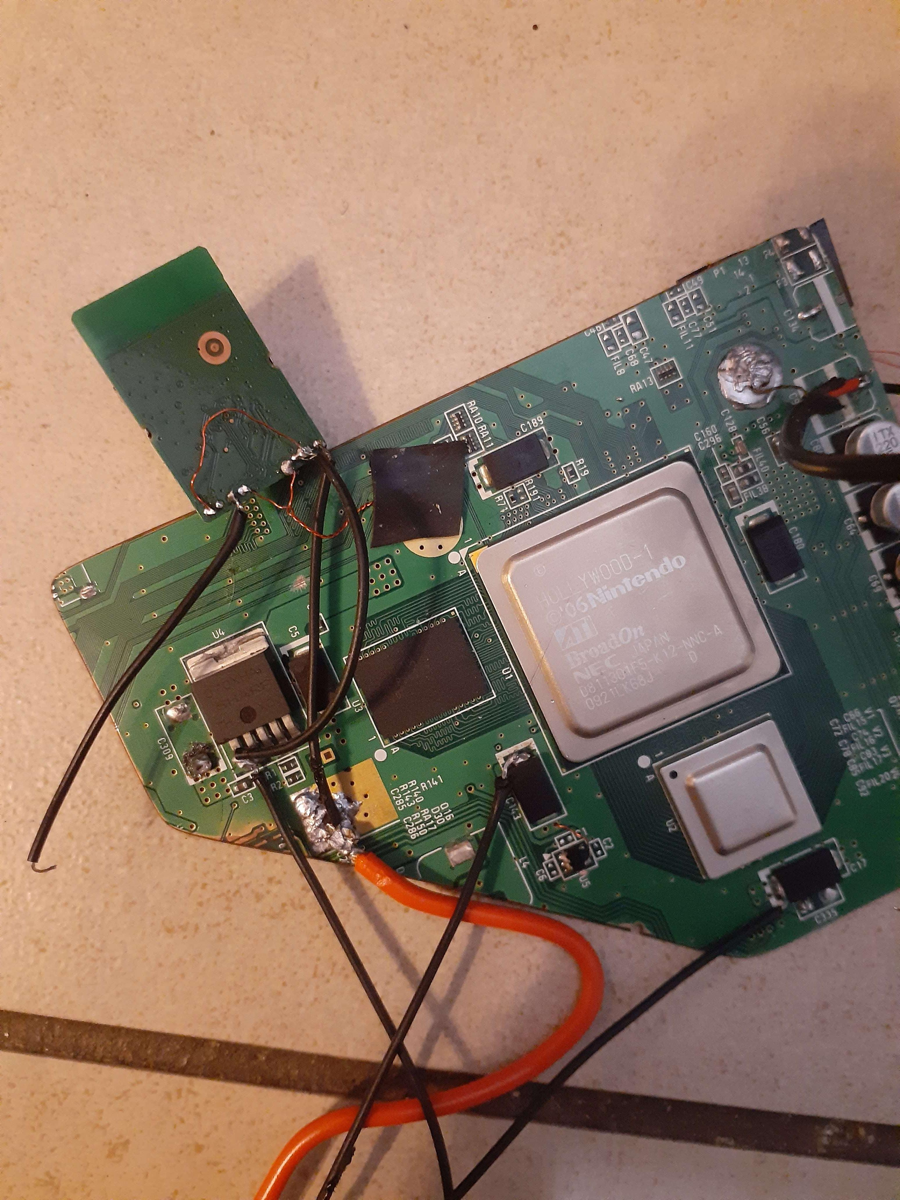

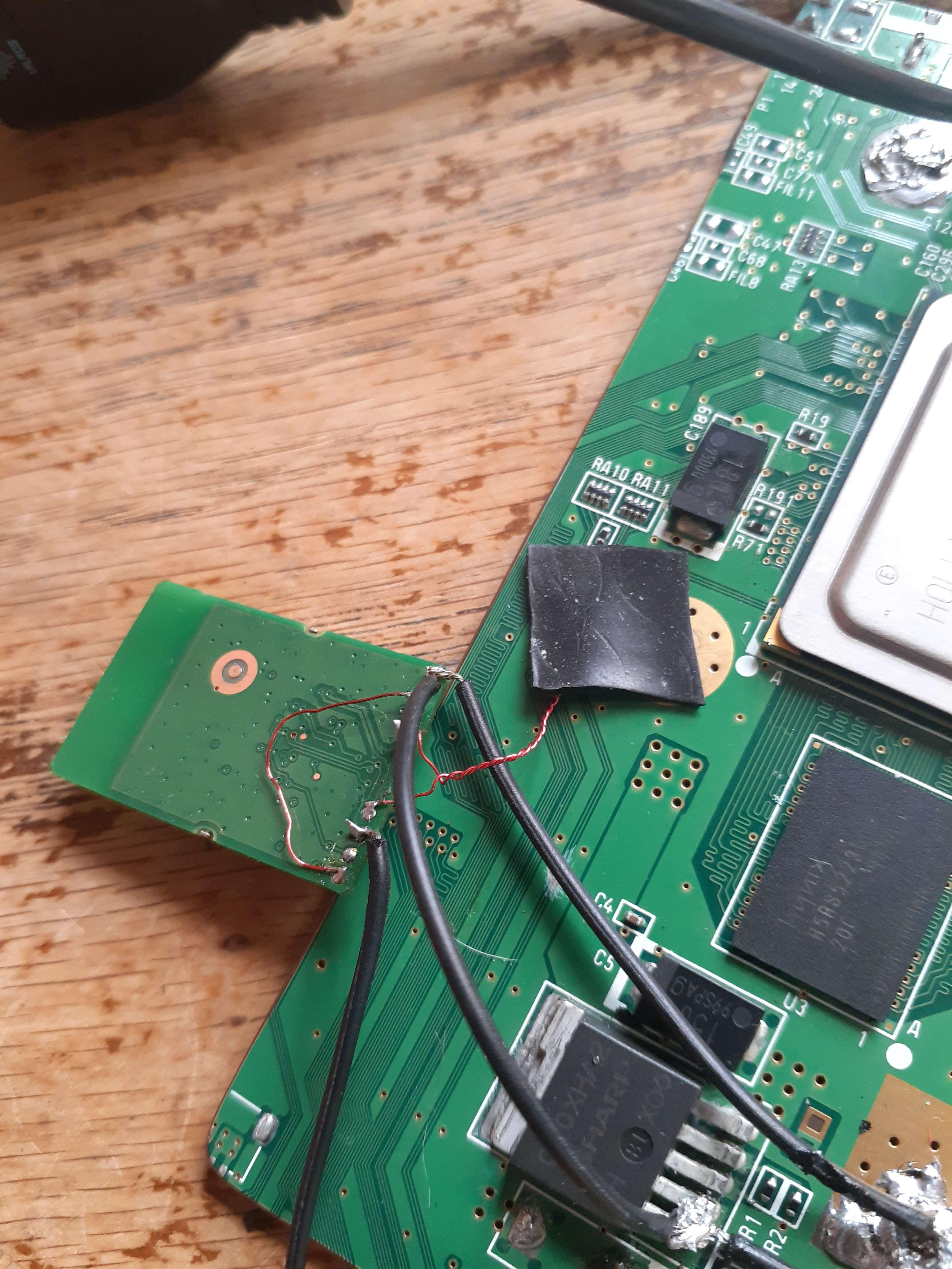

Hey all, noob here! I got my 2nd trimmed wii functioning and displaying RVLoader on my TV. The next part of the process was relocating the BT module to play Wii games. I followed the BT relocation guide, and then went to check if my Wiimote would connect (It was previously synced). But it didn't. I then booted into priiloader and attempted to launch the Wii menu from there (holding reset for a few seconds will boot into wii menu via priiloader on my untrimmed wii), but shorting reset to ground on the trimmed wii didn't boot me into the wii menu. (only priiloader, which I can't navigate)I attempted to solder to the traces 4 times, each time with a different method, and none worked... I Double checked continuity on all of these relocations and all checked out (no short to ground, or each other, and both have continuity when I probed the traces. I have also used 2 BT modules but nothing changed. I don't have any Gamecube controllers so I think my console might be bricked?
Images (of different relocation attempts, newest to oldest, don't roast my soldering too hard!):
Your relocations all look fine to me. The Wii itself might indeed be scuffed
