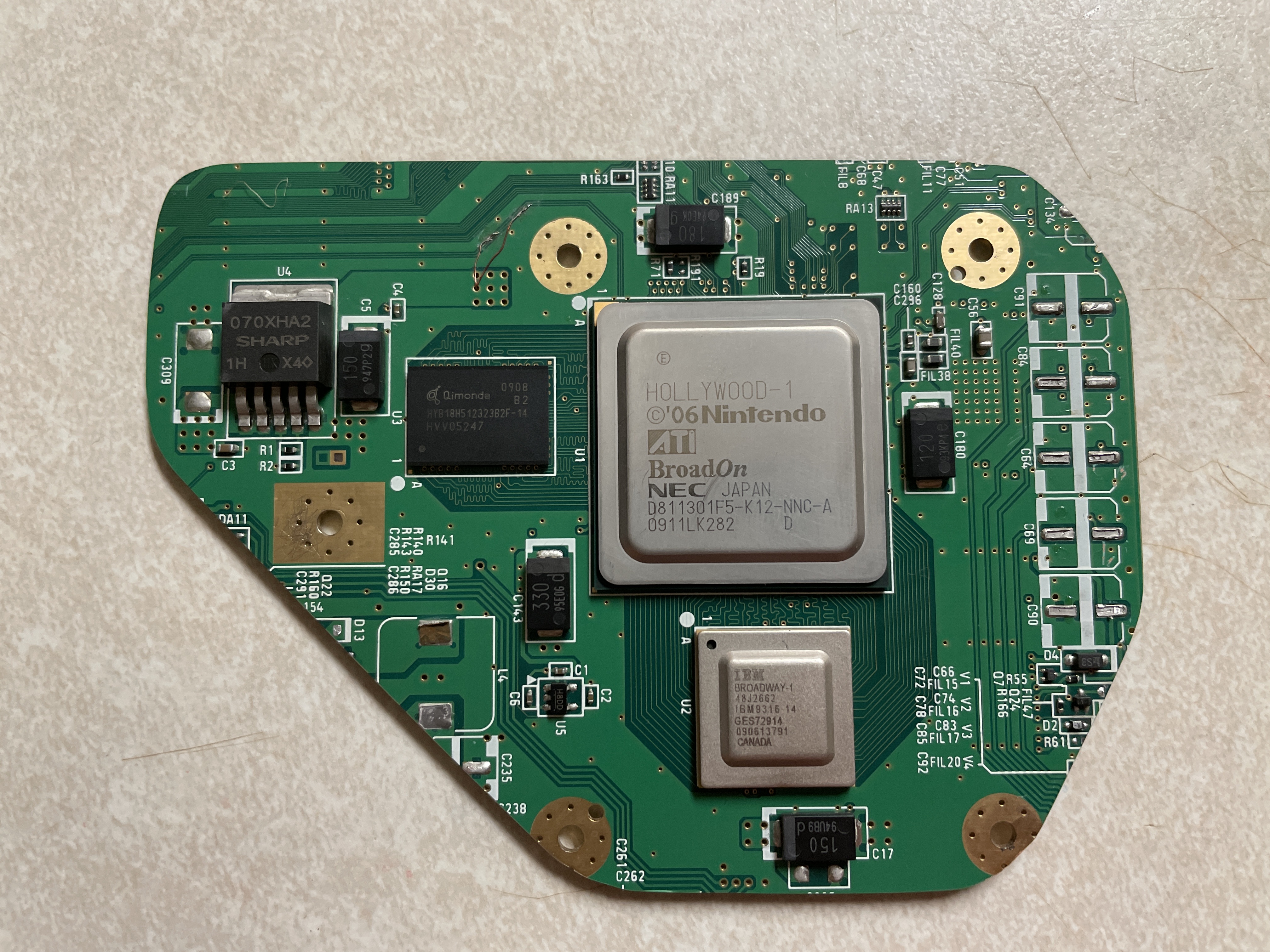

So it’s been a while since I last trimmed a wii and I don’t know if I’ve trimmed to much this time. All my resistance read ok but when I check in continuity mode I get a short on 1.8v to ground and 1.15v to ground. Any help is appreciated thank in advance.
Most multimeters will beep for "continuity" at resistances up to 50 ohms. The 1.15v and 1.8v lines normally have less than 50 ohms resistance to ground, so unless the measured resistance is single digits you should be fine
