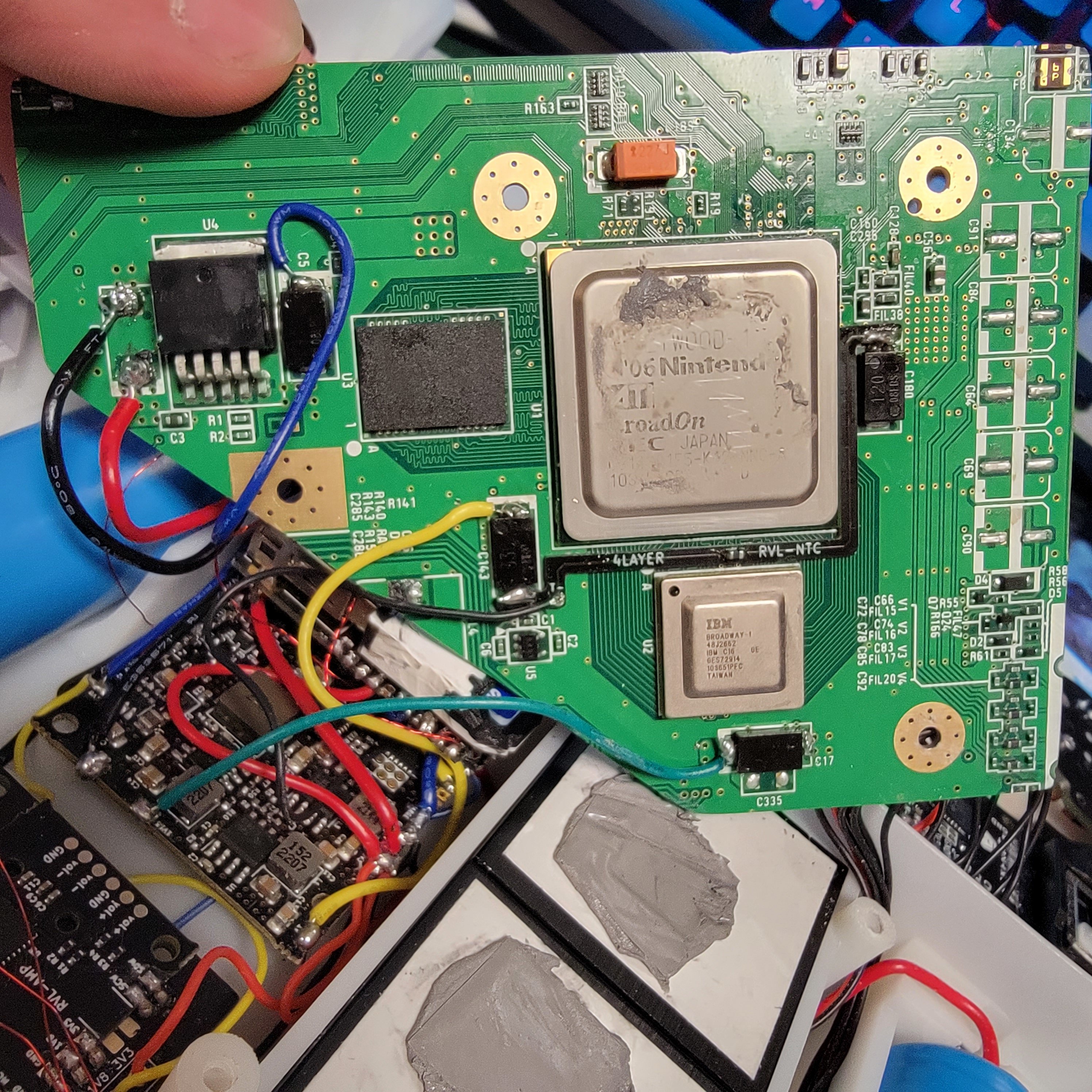

Pictures of everything (your wii, the rest of the portable, wiring etc) are needed to help you out here. As you mentioned, continuity isn't what matters, it's resistance. As long as you're getting appropriate resistances on the 1v15 and 1v8 lines, you're good there. As for the Wii turning on and then immediately off, is it actually booting, or is it just the screen coming on and off? The screen will turn on and then off if it's not receiving a signal, so it's not exactly an indicator of if the Wii is actually booting. If you're not getting any video output from VGA, I'd try composite, just to see if it's a VGA wiring issue before anything else. But again, pics of everything might point out something obvious.

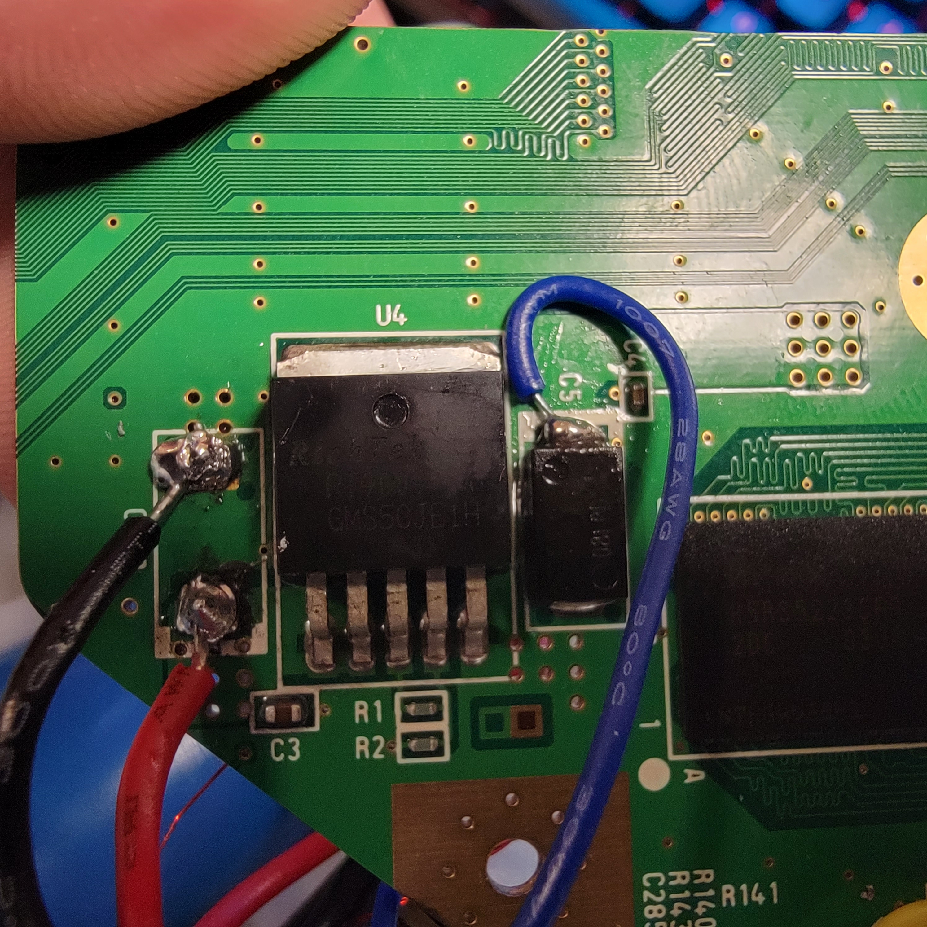

So I don't have any pictures of what it was like before I disconnected everything, and now the wii is if I had just trimmed and sanded it. The whole of the system just shuts off if the voltage lines are connected to the Wii with nothing else connected (ie no video, no U10, no SCW/SDW, no USB).
When the wii isn't connected however everything works as it should, the PMS Lite is outputting proper voltage to everything its supposed to be outputting.

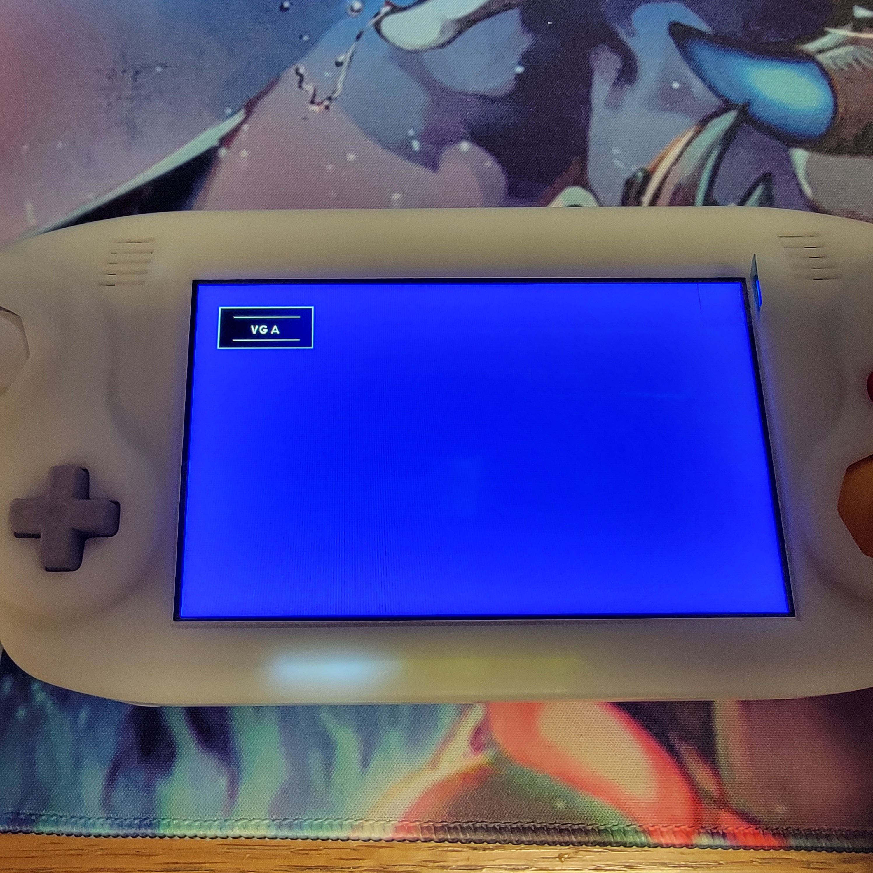

Alright, well, idk what's up with my trimmed wii, even after charging and re-doing all of my VGA lines, still can't get the display to work. I even bought a new driver board to see if that was the issue, but to no avail.
CPU and GPU get sort of hot, but nothing crazy.
Voltages are as follows:
Both batteries = 4.06v
1v = 0.99v (not sure if this being .01v less than what it's supposed to be is an issue)
1.15v = 1.15-1.19v
1.8v = 1.82-184v
3.3v = 3.31-3.35v
U10 and Mode pin are the same as the 3.3v line.

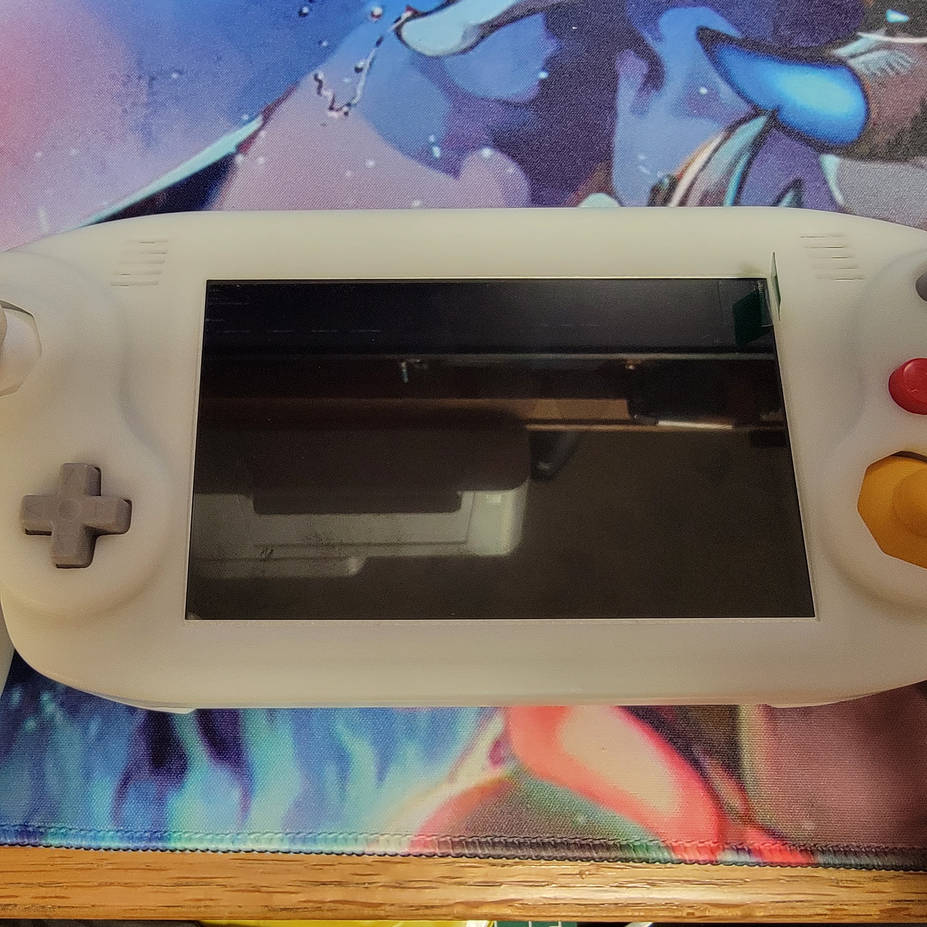

Tried composite video, all I get is a greyed out screen (which is different from the normal display of VGA [which ends up just being blue with "VGA" in the top left])

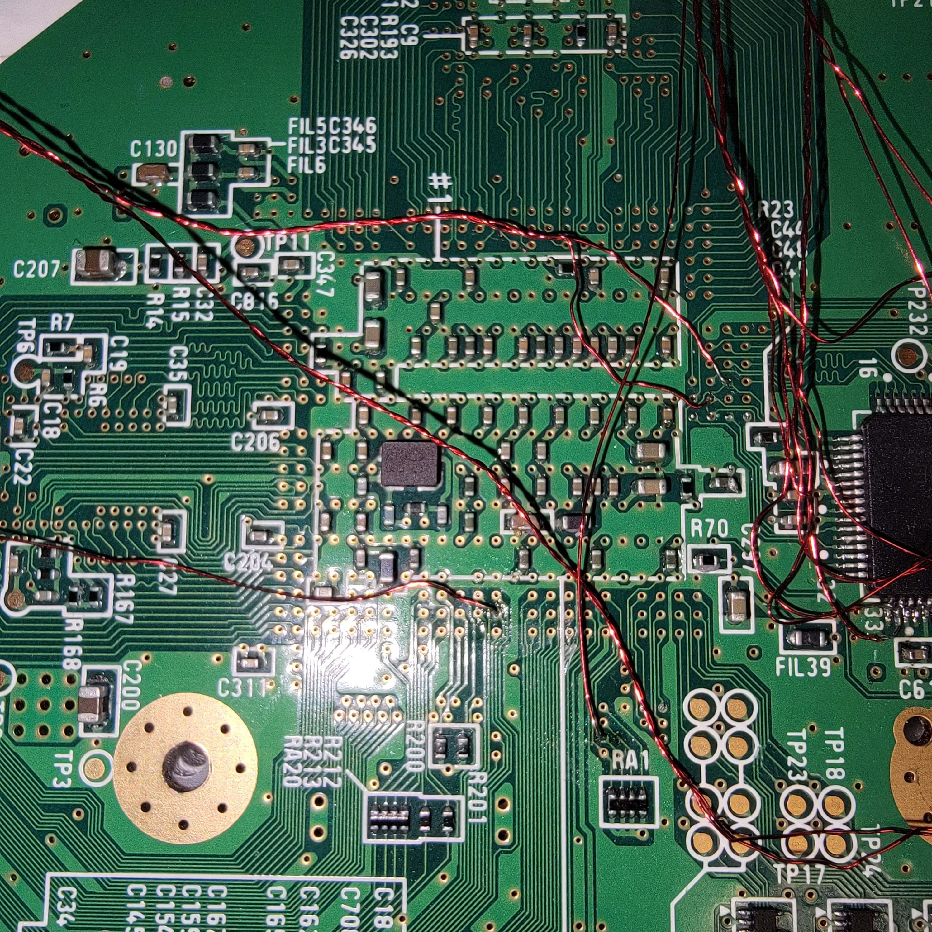

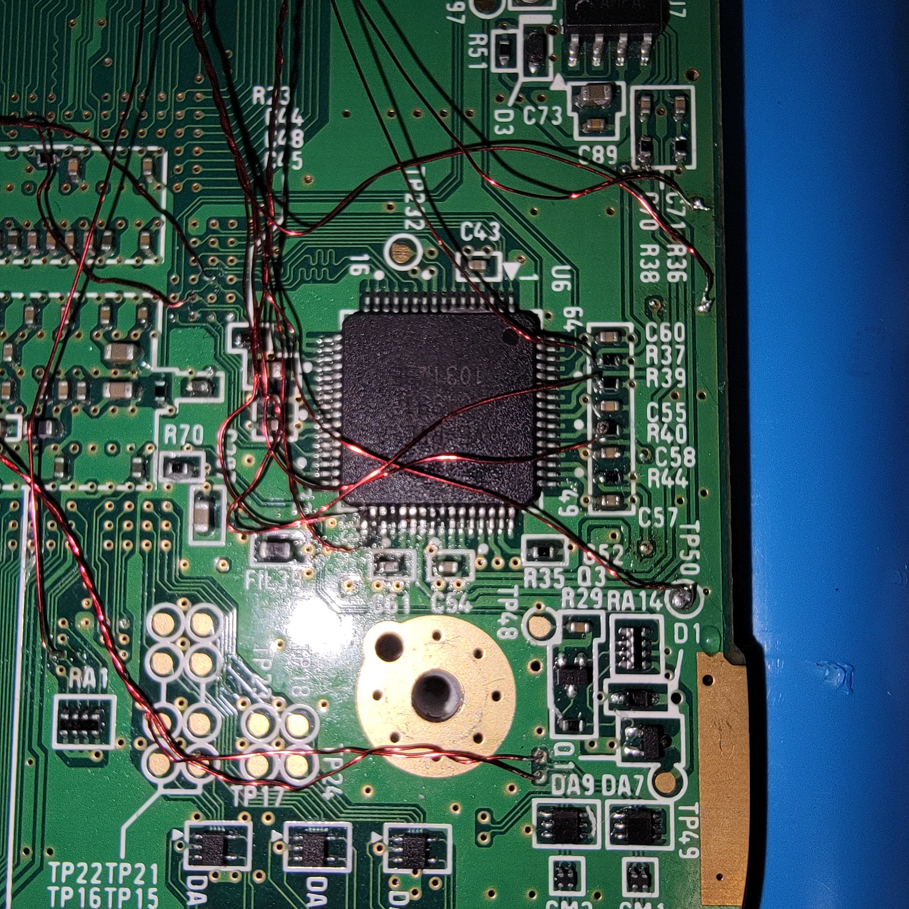

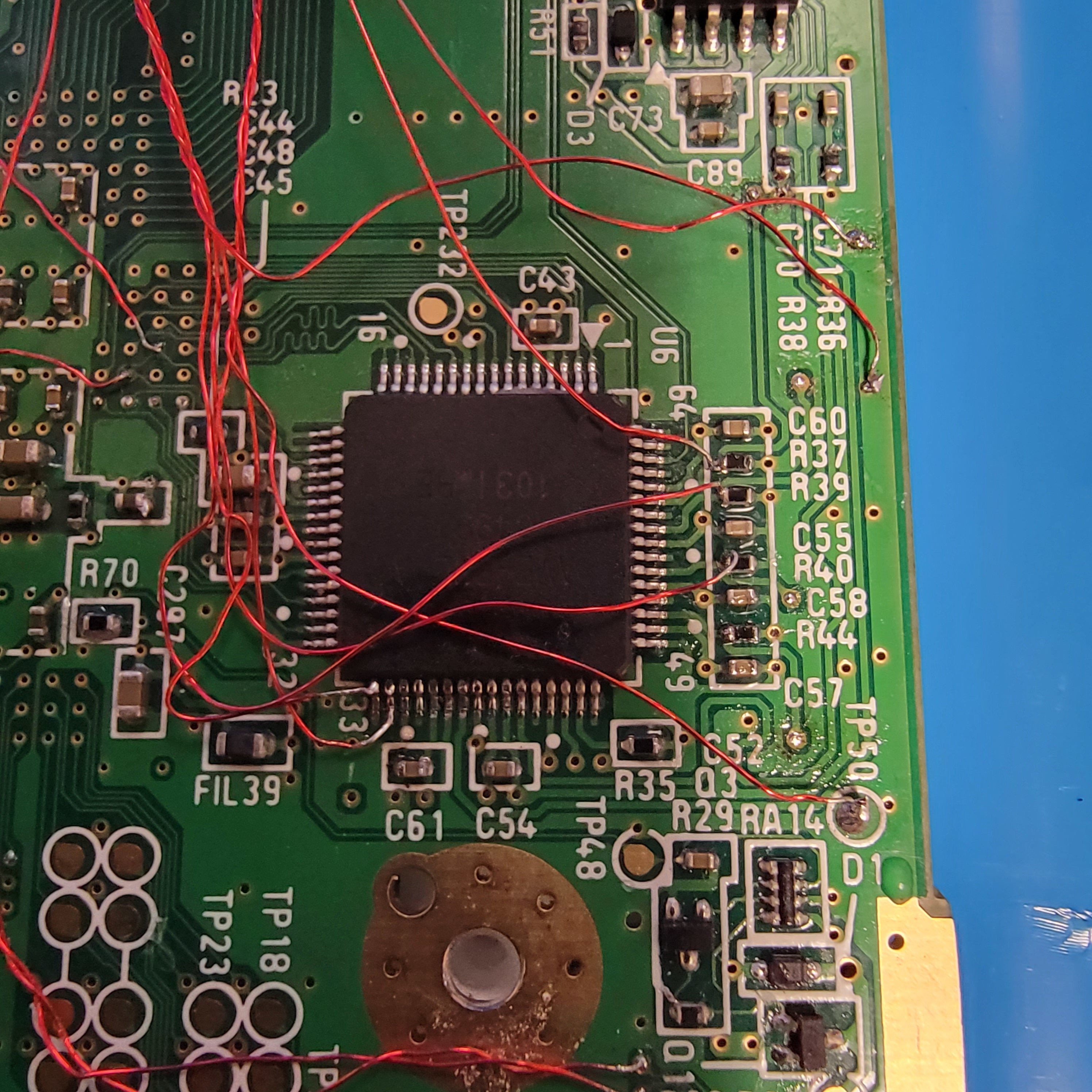

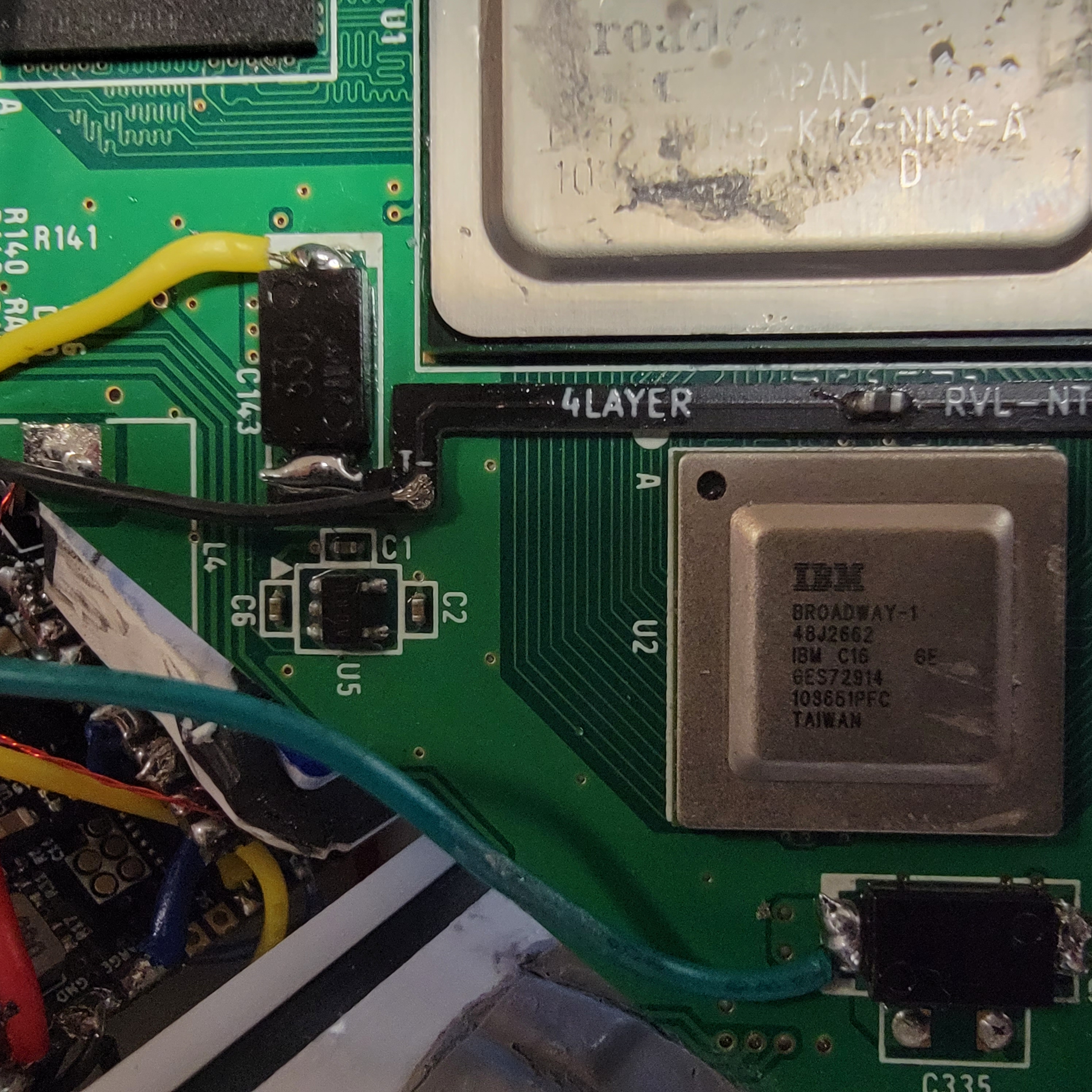

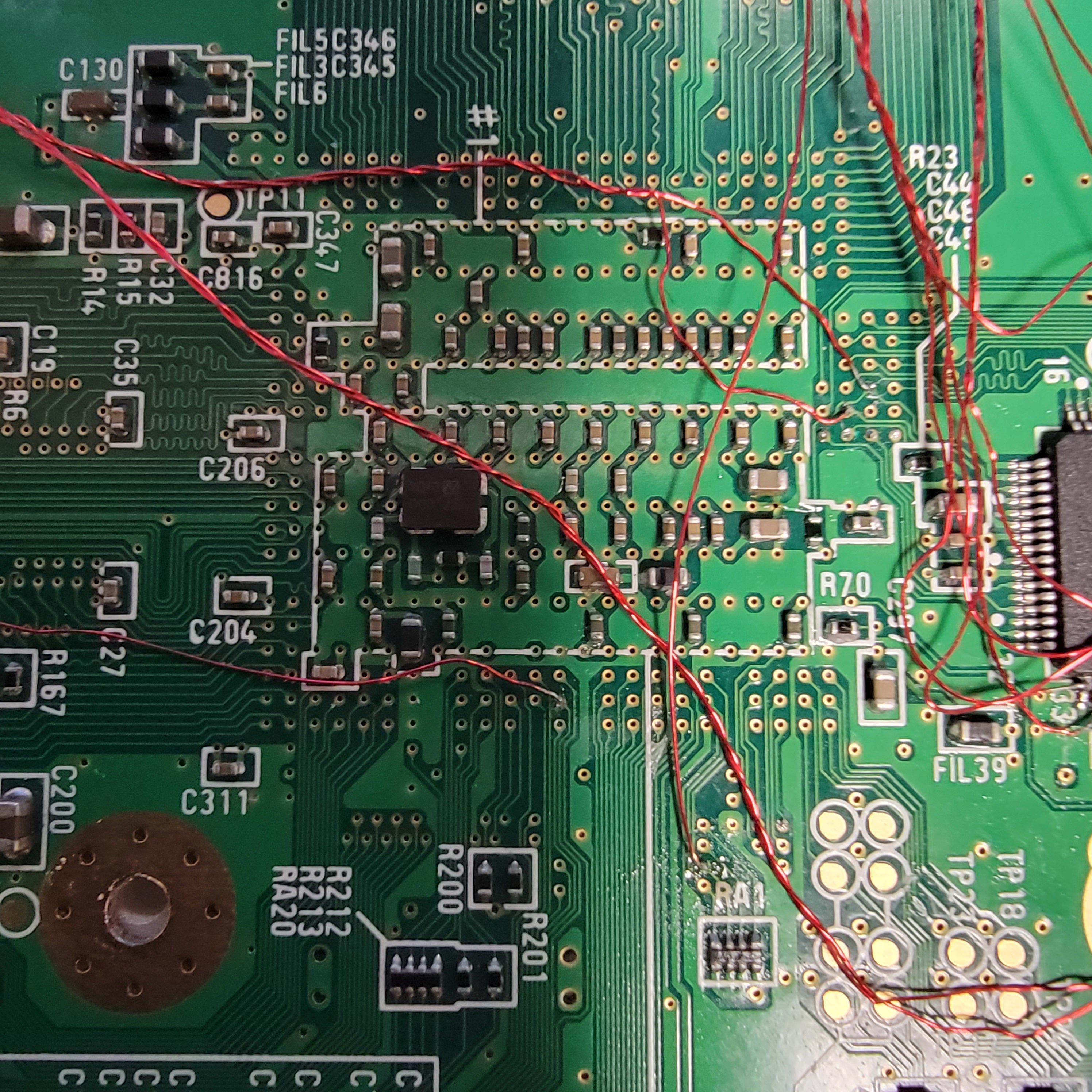

Pictures for the above post.
Maybe I'm missing something, but idk.
Should be noted that I soldered to TP47 for getting the Mode pin to have 3.3v, idk if thats an issue.
My display will turn on for about 5 seconds then it turns off (presumably because I don't have signal)
Originally had VGA lines for R, G, B, soldered to pins next to C58, C60, and C89 respectively, wanted to try a different point in case for some reason those pins were an issue.

Did you disconnect 3.3v from mode when testing composite? Composite output is disabled when mode is shorted to 3.3v
Did you manually switch the screen to AV1 / AV2 when testing composite? That screen doesn't auto source iirc. I also don't remember if both of those composite lines work, so make sure to try both.
I did manually swap the screen over to AV1 when testing composite, but I will try testing AV2 in case the other one doesn't work.
Unfortunately AV2 provides the same result as the AV1 channel (greyed icon in the top left reading AV2, and black screen) Though just like AV1, the display does not turn off like VGA does.
Looking back through your photos, I don't see any wire between the mode via (or tp47) to 3v3, unless it's just out of shot. Mode needs to be wired to 3v3 for the wii to output VGA. For composite, just leave it floating.
Did you have it wired up when testing VGA?
Ya, so TP47 is just out of the shot, and I've verified that the mode pin is at 3.3v when the system is powered on.
Idk whats up with this one, probably something really dumb that I messed up on accident and it just doesn't want to display anymore.
