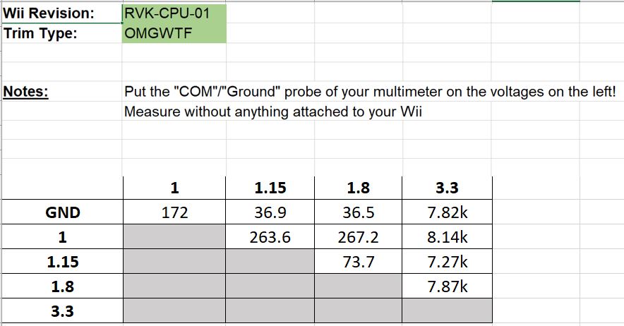

These are my resistance values. when I tested on the points other than ground, they seem to be pretty low as you can see. Did I not sand enough, or is there another issue present.
I'm not sure, but the resistances between rails are definitely much lower than they should be.

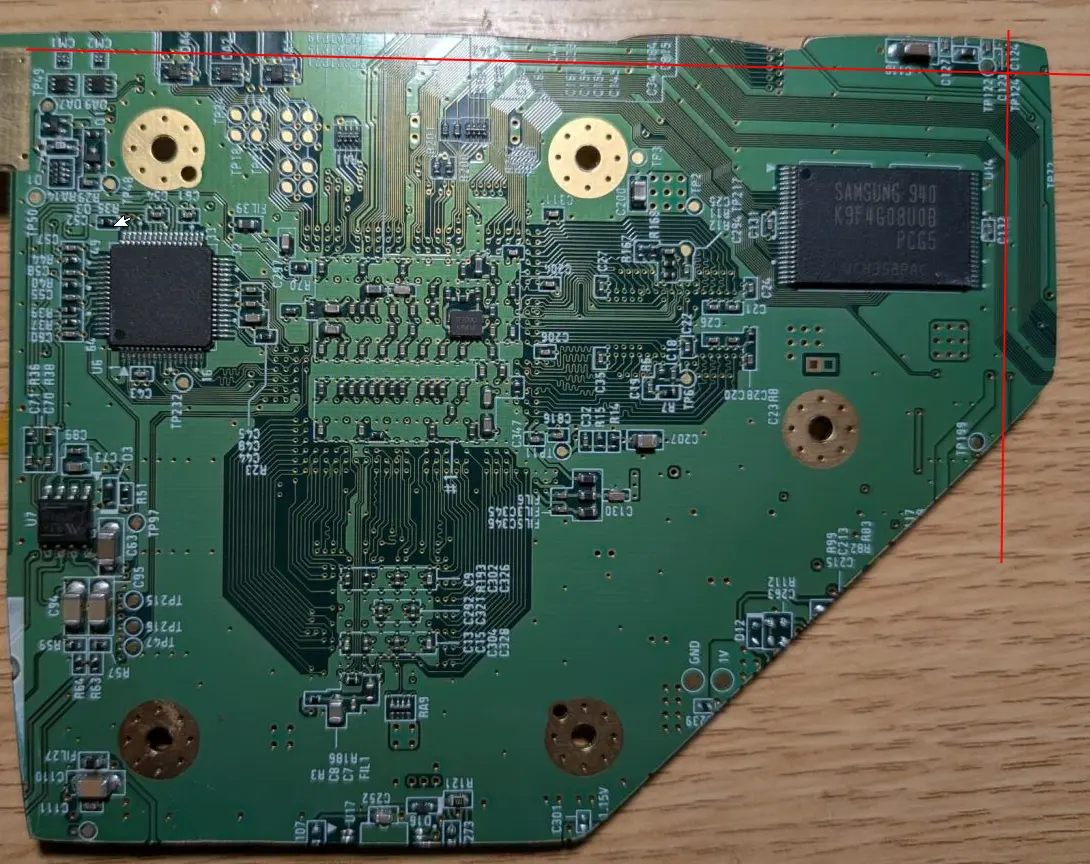

How low can i go on the ragged side? I am already pretty close to the trim lines here https://bitbuilt.net/forums/threads/the-definitive-wii-trimming-guide.198/. How much is it safe to sand down?
About this close
That set of traces that comes out the side of the NAND chip are the important ones. You can go up to the thick GND stripe separating it from the next set of traces if you need the space.
