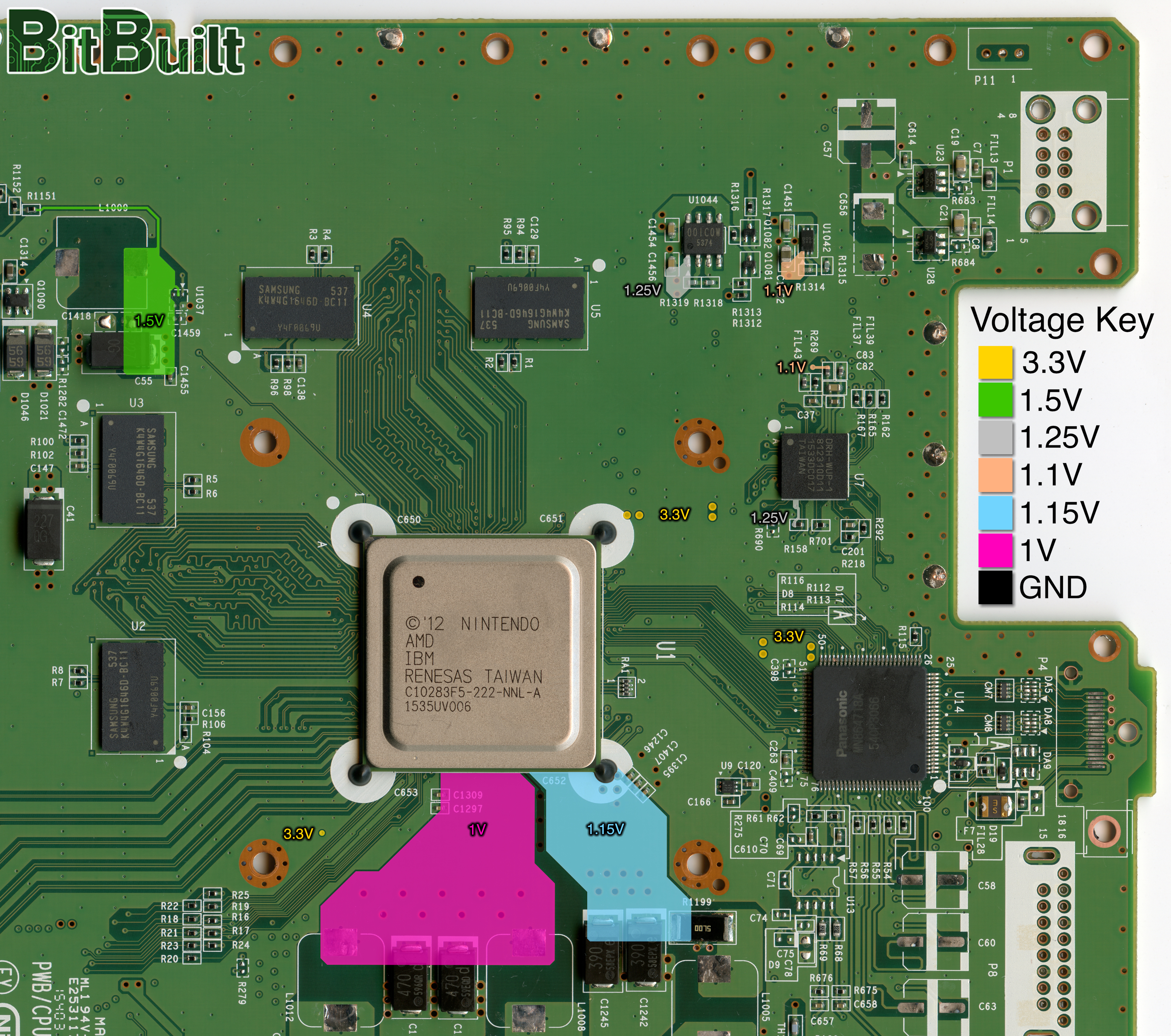

Someone tried to do undevolting o B1X Wii U? I gave a brief research and I believe that the one responsible for controlling the 1v voltage is the U1024 (Rohm BD9171FUT-GE2)But I can't find information about it, but it has a substitute with a compatible pin LV5065VB It has a datasheet. But I still can't find answers. Would anyone know how to do that?
undervolting is usually done by trial and error, slowly turning down the voltage with buck converters by like 0.1v tops and testing with a long play session/stress test. however, even if it appears to be working it could still break later on. Don’t try undervolting unless you know what you are doing and have some spare boards in case it burns out!

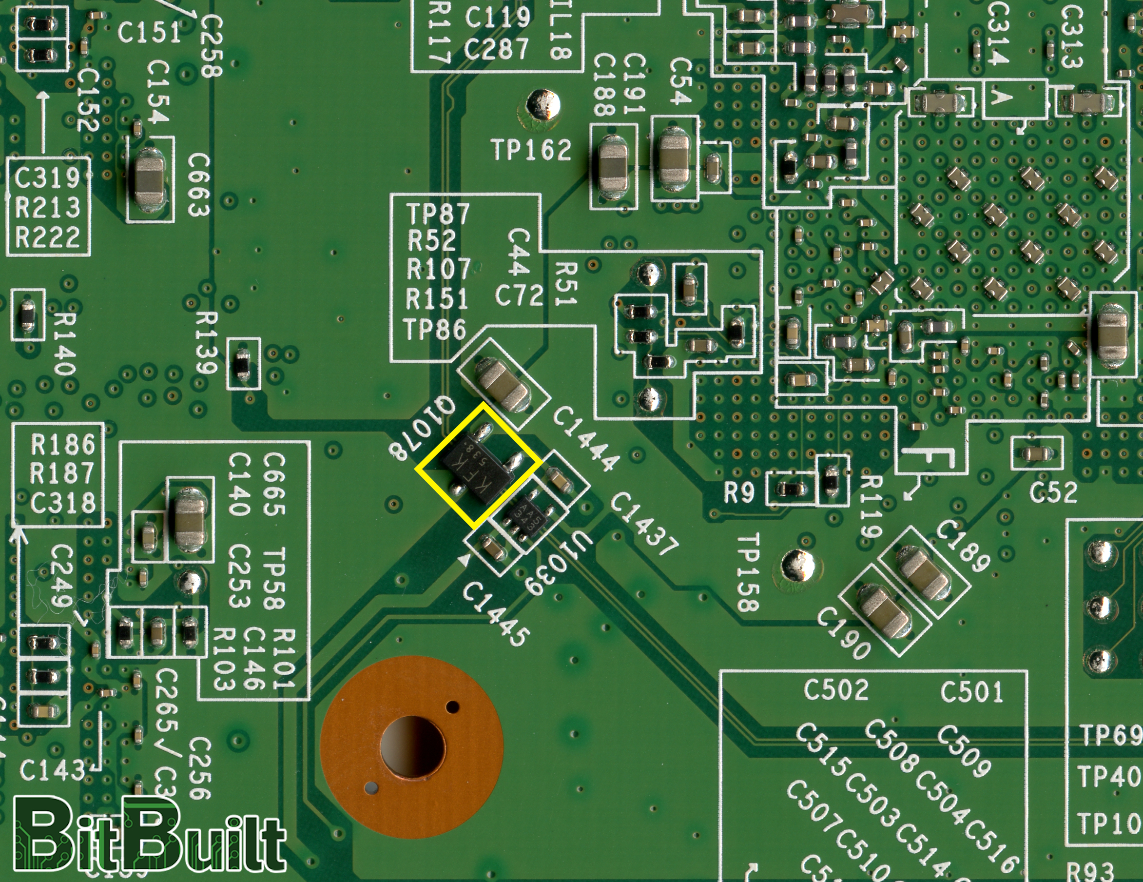

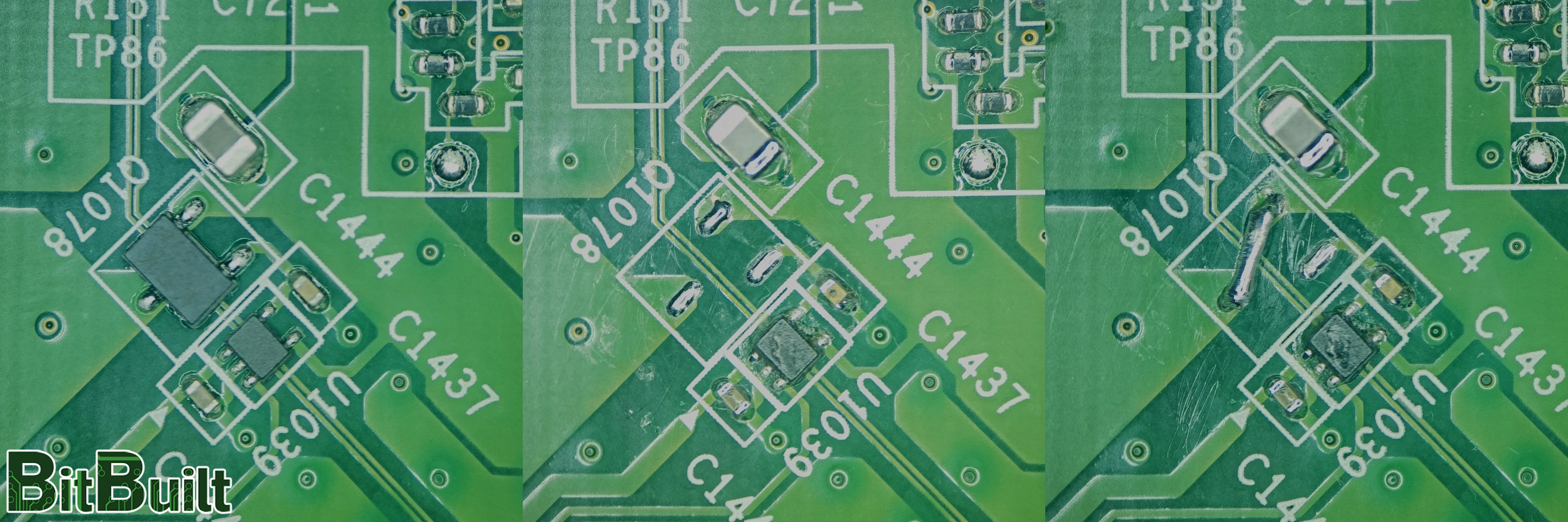

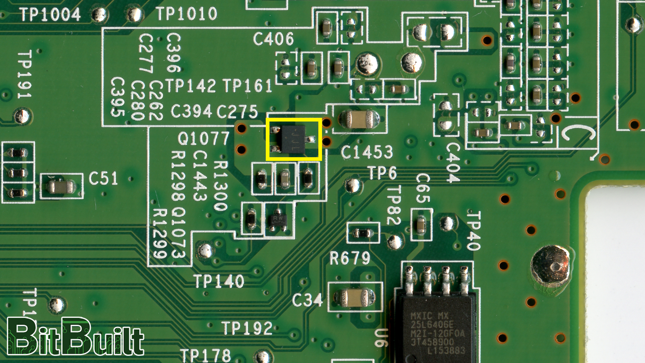

I already bypassed the Q1077 and 1078. So what should I do to force regulators to be activated (or circumvent the flashing red light error)?
Hey, this thread is the trimming guide, you should take this up on the WiiU RND in future. Since I am already responding, I notice you previously asked about undervolting, did you attempt that at all and are you currently undervolting? I would suggest you at least don't undervolt during testing.
