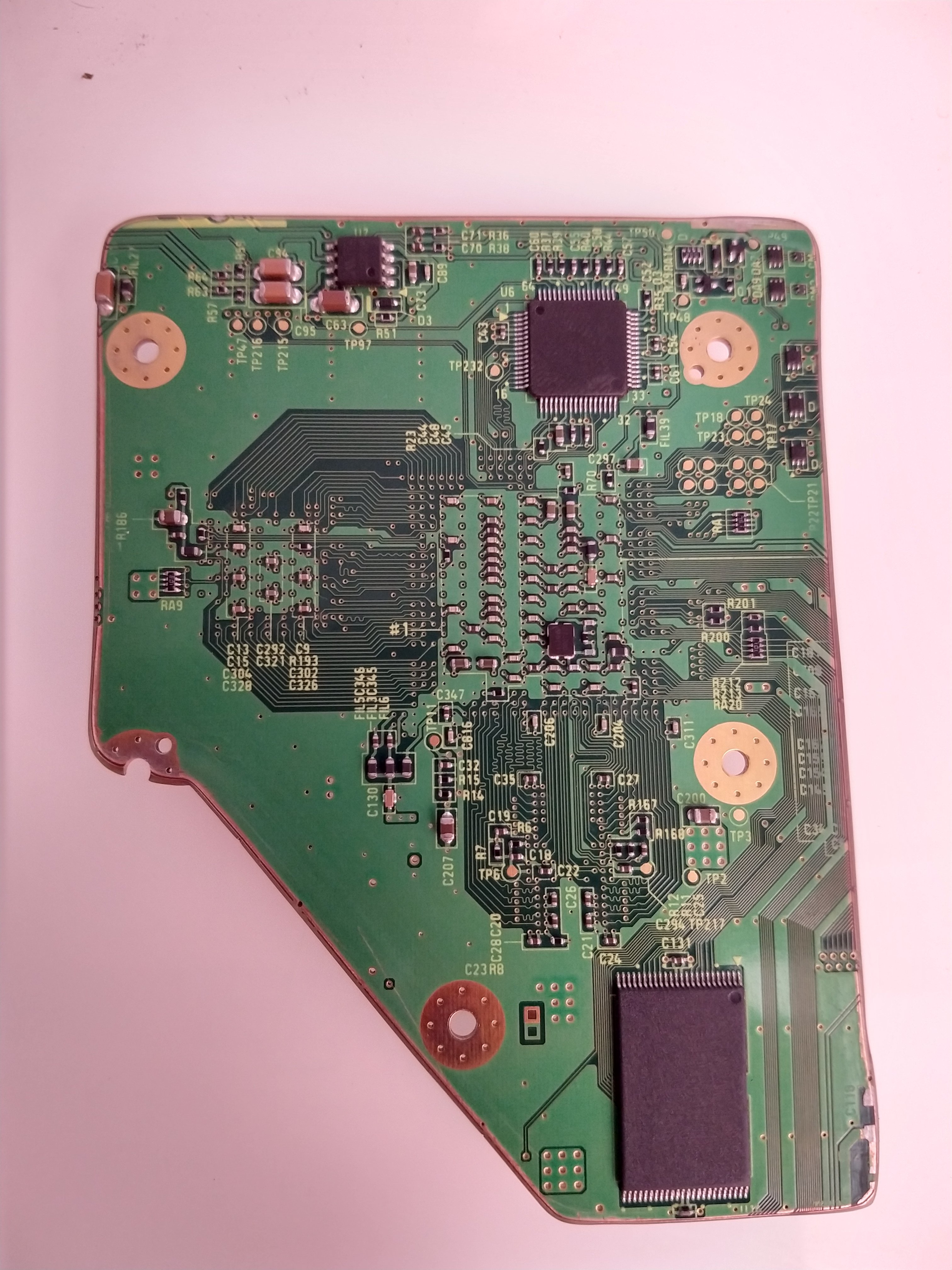

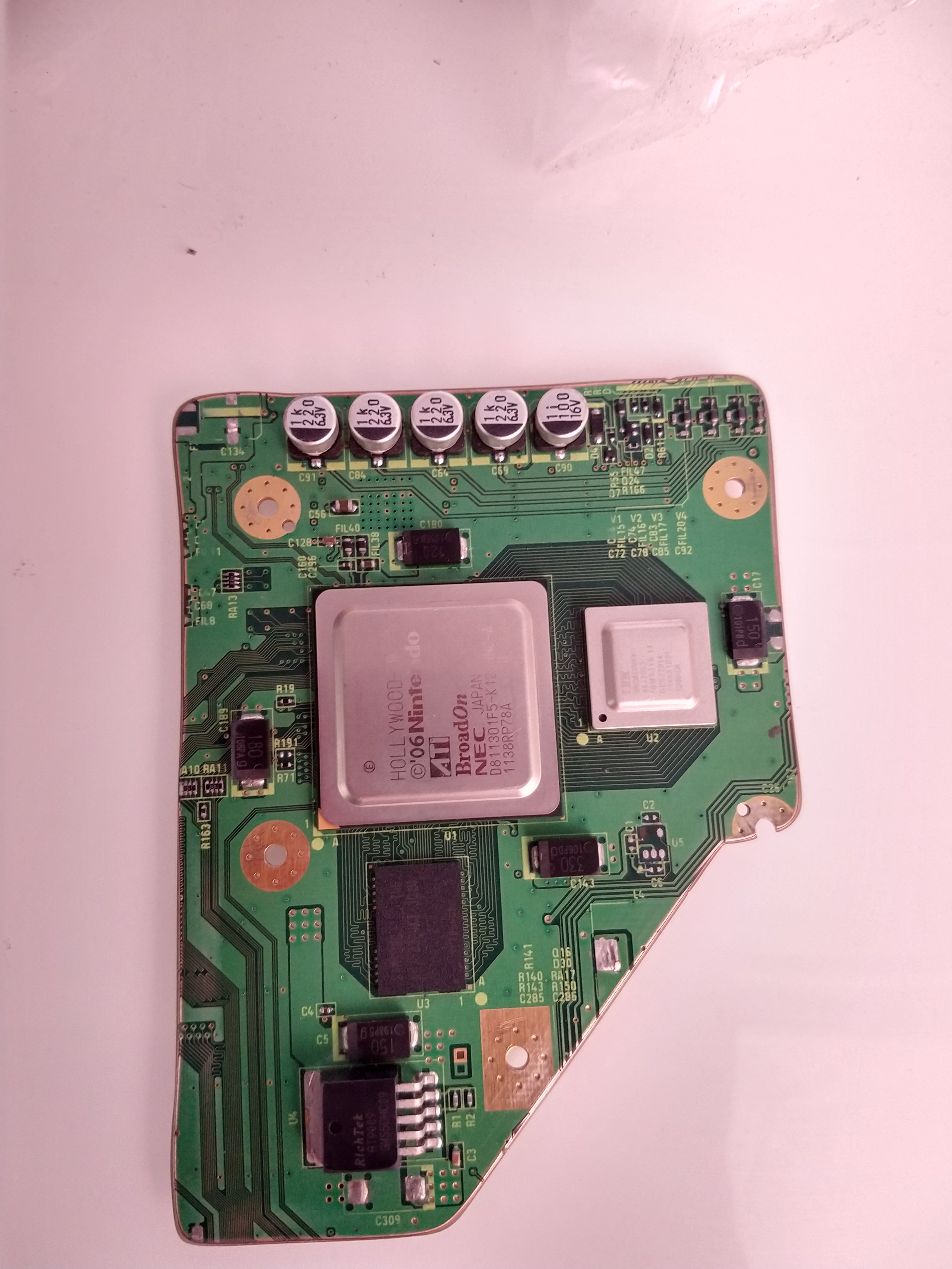

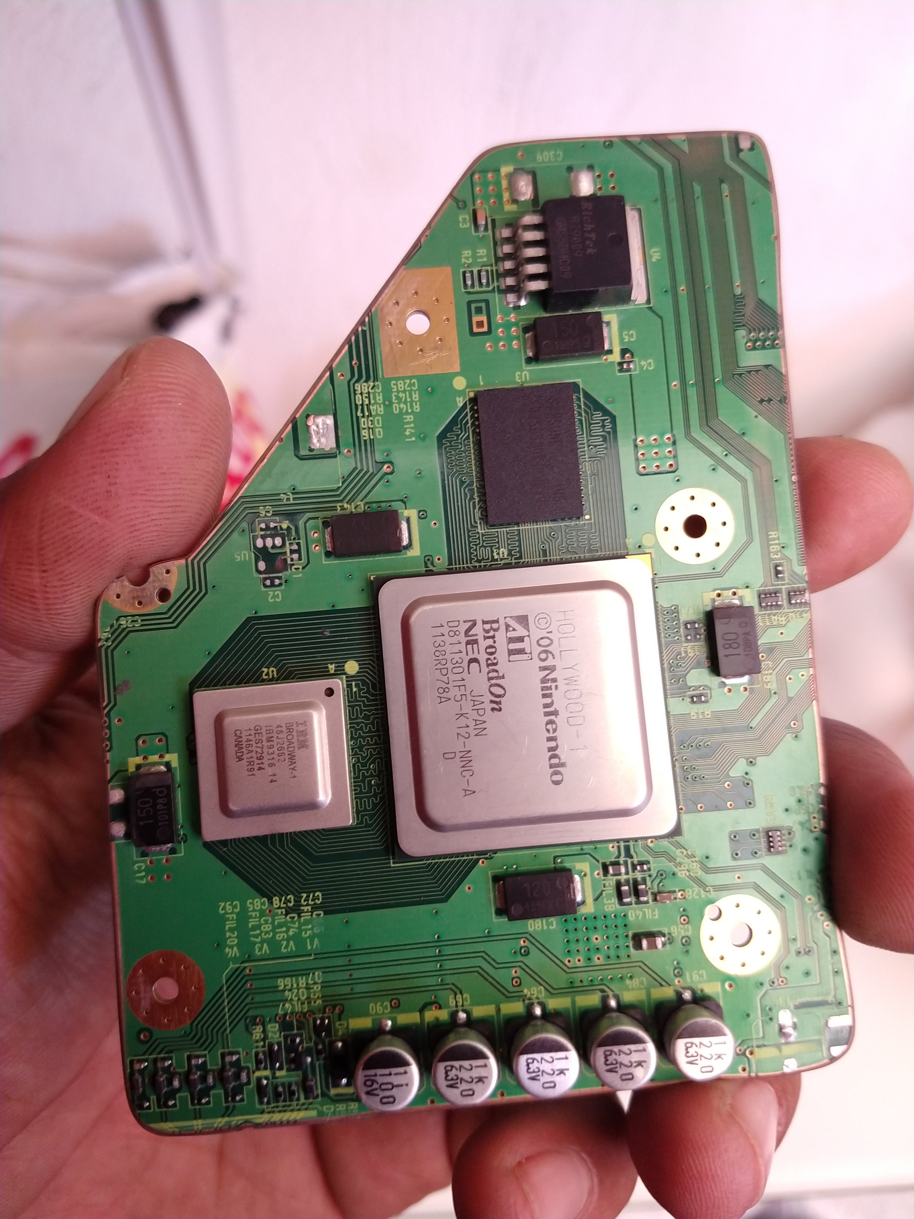

I cut outside the lines, sanded well, but removed the u5 before checking continuity!. now at all voltage points I have continuity to ground... it's my first Wii, and besides losing my u5 I don't have another console to make measurements, help  !!!! I don't now where is the problema, or i need sold u10 and
check?

Hi guys!
I cut outside the lines, sanded well, but removed the u5 before checking continuity!. now at all voltage points I have continuity to ground... it's my first Wii, and besides losing my u5 I don't have another console to make measurements, help  !!!! I don't now where is the problema, or i need sold u10 andView attachment 26299 check?
Did you have the Cpu and Gpu covered in tape to prevent metaldust getting under them? If not that might be your problem.

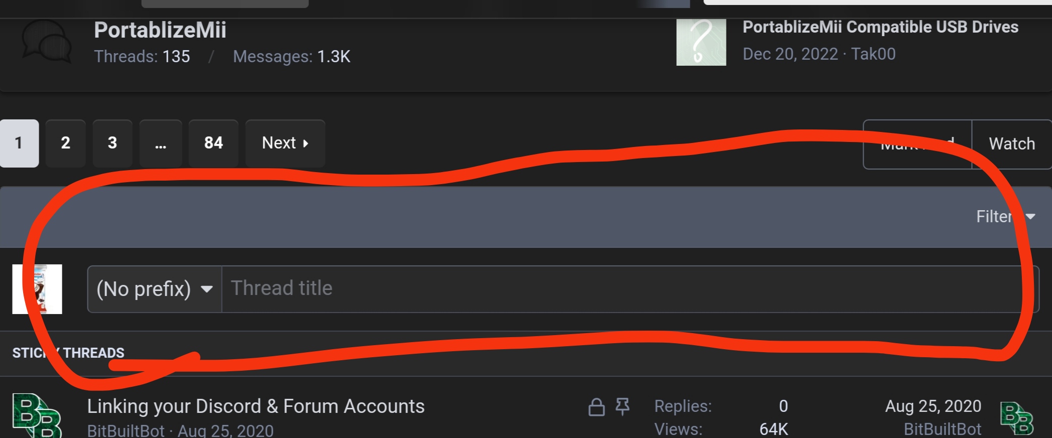

Also please create your own thread instead of using someones else.
Oh no! What can i do ?
Sorry it's My first question and don't know create a thread, thanks Explosive T
