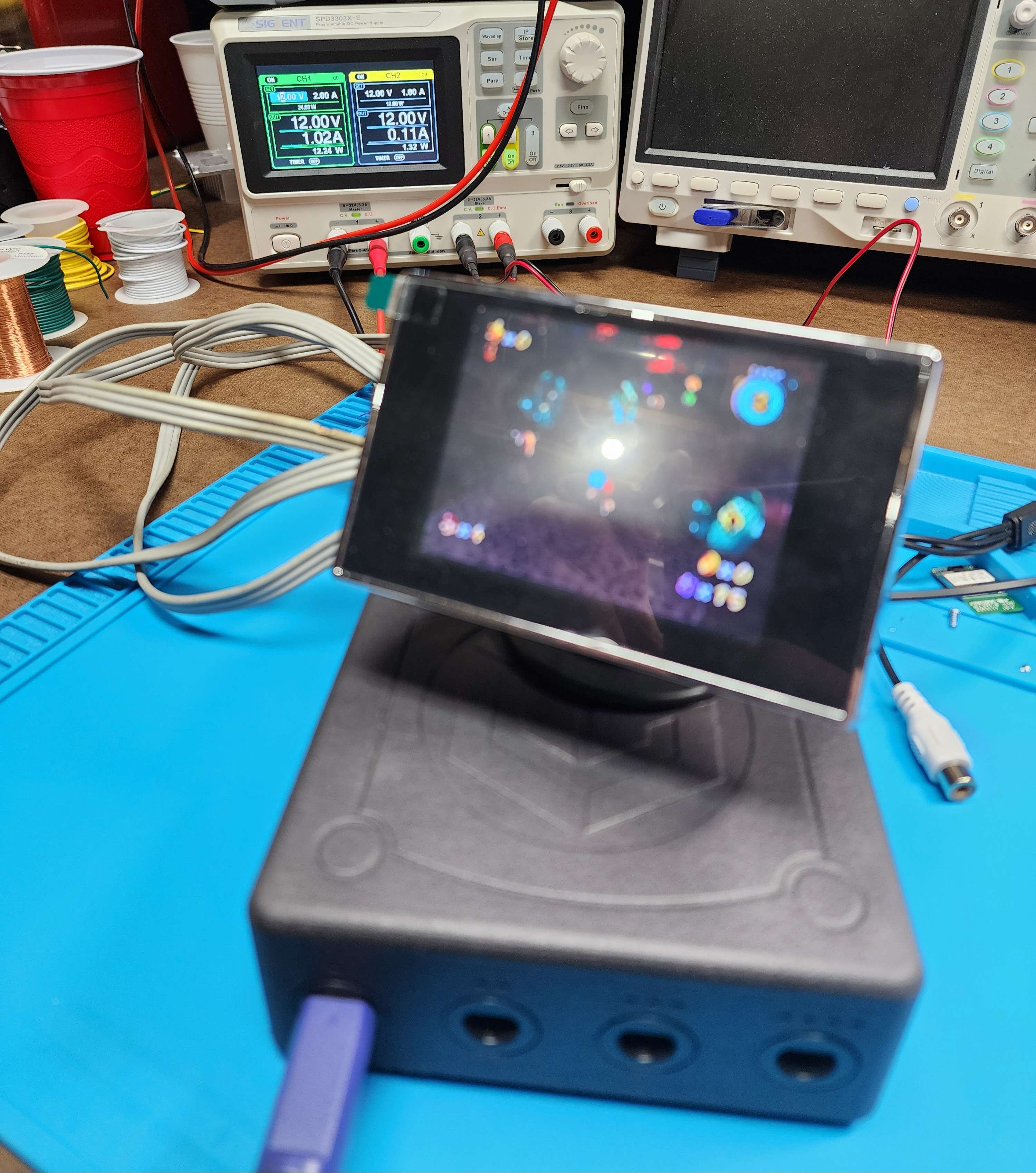

I like to use a 12V 2A supply for my Micros; even though it's not necessary, I'm comfortable with having more headroom. Here's my Noldendo (powered by an original RVL-PSU) playing Mario Galaxy:
