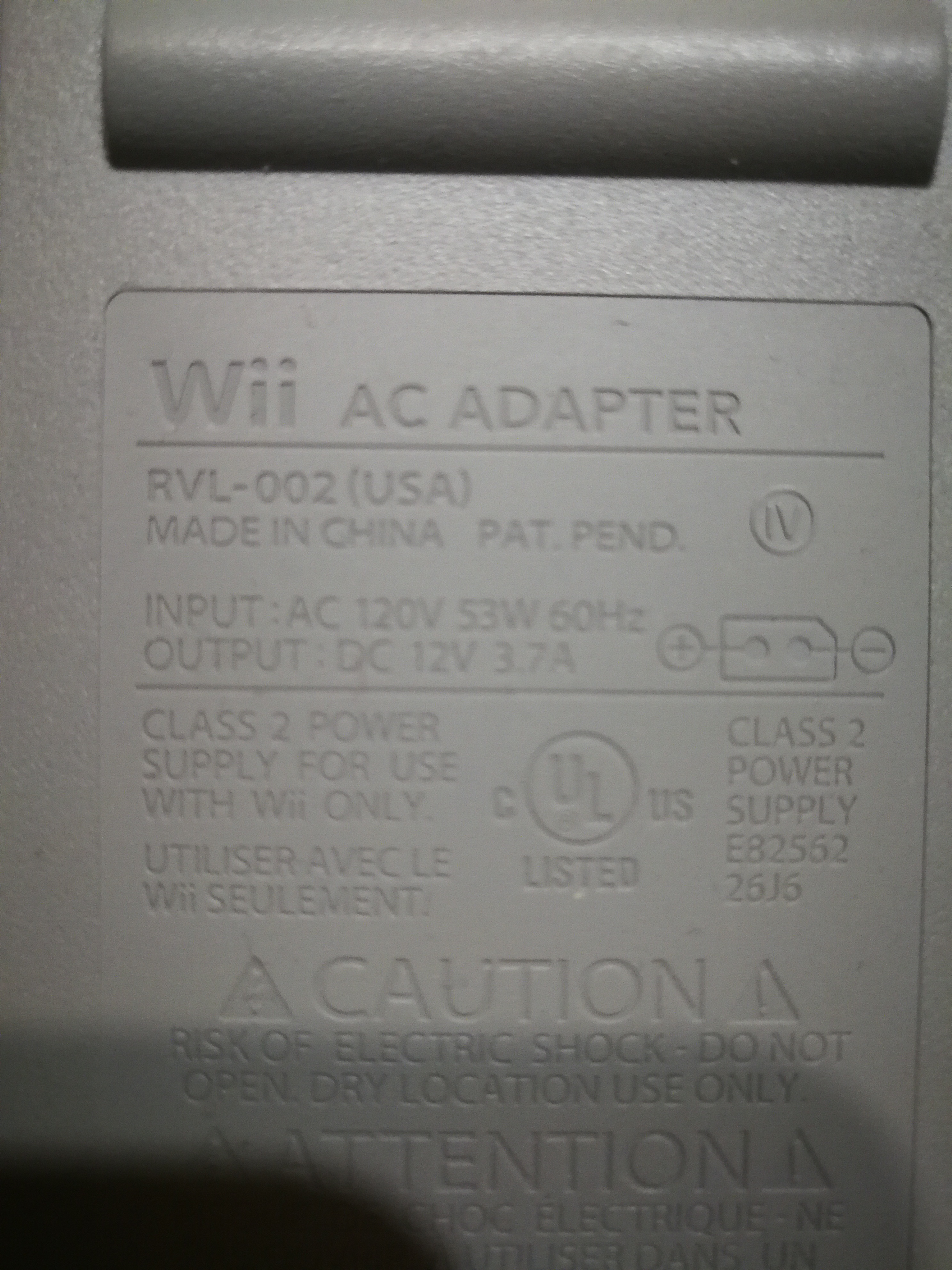

I'm intending of using the Wii AC to DC charger. The Wii outputs 12V which is ideal for this board, but 3.7A instead of your 3.07A. If I use that charger is it possible to still make it function? And will my portable Wii function with only 2 batteries (the 18650)? Or do I need a 2s2p or 4s to get a minimum of 4 hours of battery life?
The charging current can go up to 3.072A, yes but this is at a lower voltage stepped down for the battery (which is all handled by the charging IC). 12V*3A is plenty of power to play with, it will work. This is only meant for a 1 series battery set up but you can put more in parallel.
