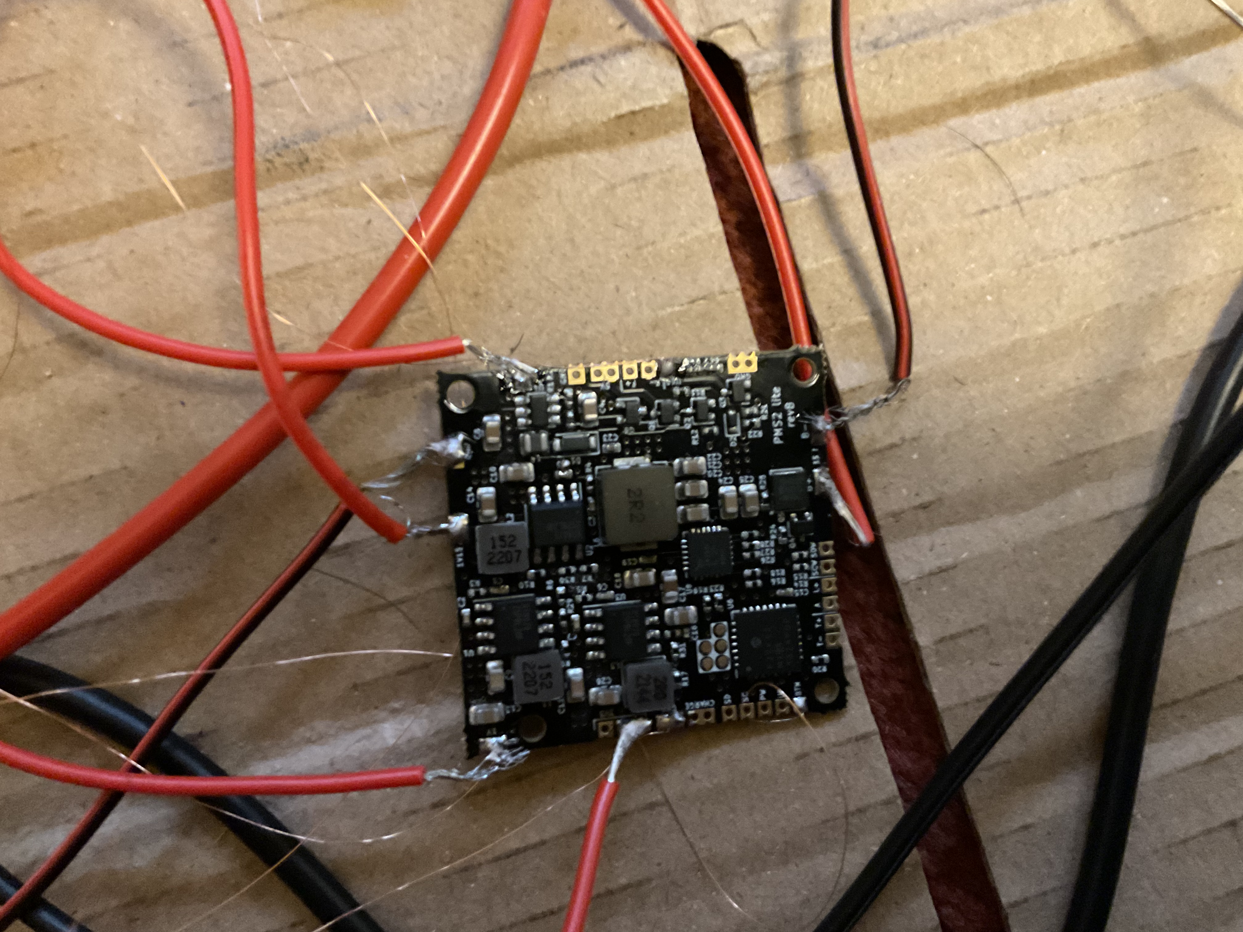

yeah, sure. Here they are:
The wires are probably a bit longer than they should be, so a little messy, but I know everything goes in the right place and power is getting to the board. Also, I'm pretty sure U10 is working. I have also tried straight from AVE-RVL and still nothing

Well I can tell you that all of those solder joints are painful to look at, and verily asking for transient shorts and poor conductivity. Way too much exposed wire, and the joints are visibly cold formed. You need to up your iron's temperature, and ideally also grab some brand name tacky non-rosin based flux.
In the photos you provided you have the composite wire soldered to the wrong side of the capacitor footprint, but you said you tried connecting closer to the AVE and still no luck? Do the CPU and GPU get warm after a short time?
Ok, I will try to do that and fix some of those joints. The cpu and gpu do get warm after the power is on for a few seconds.

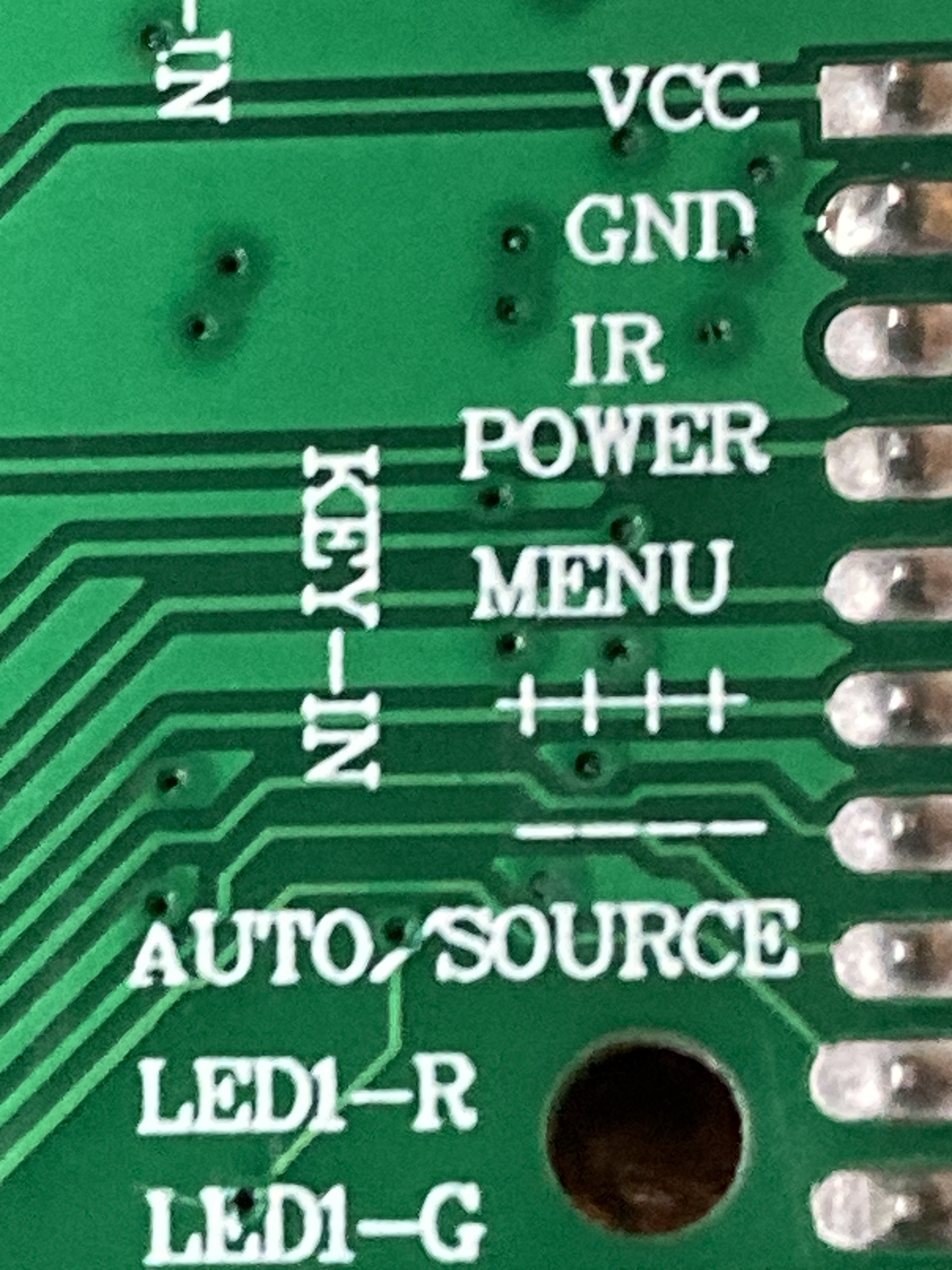

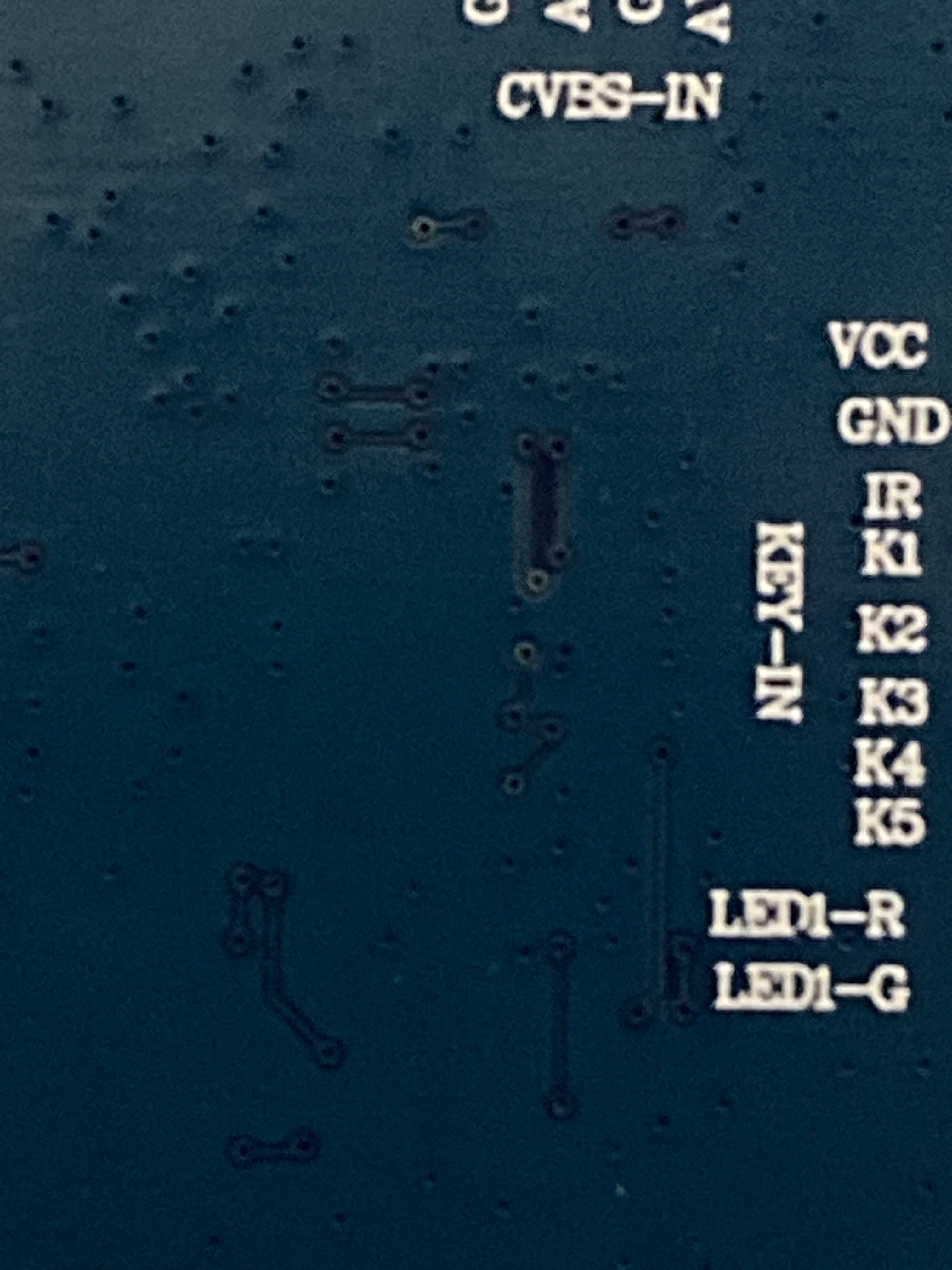

I have the new screen driver board, are the key inputs the same as the old one or different? Because they are labelled differently, but they have the same number

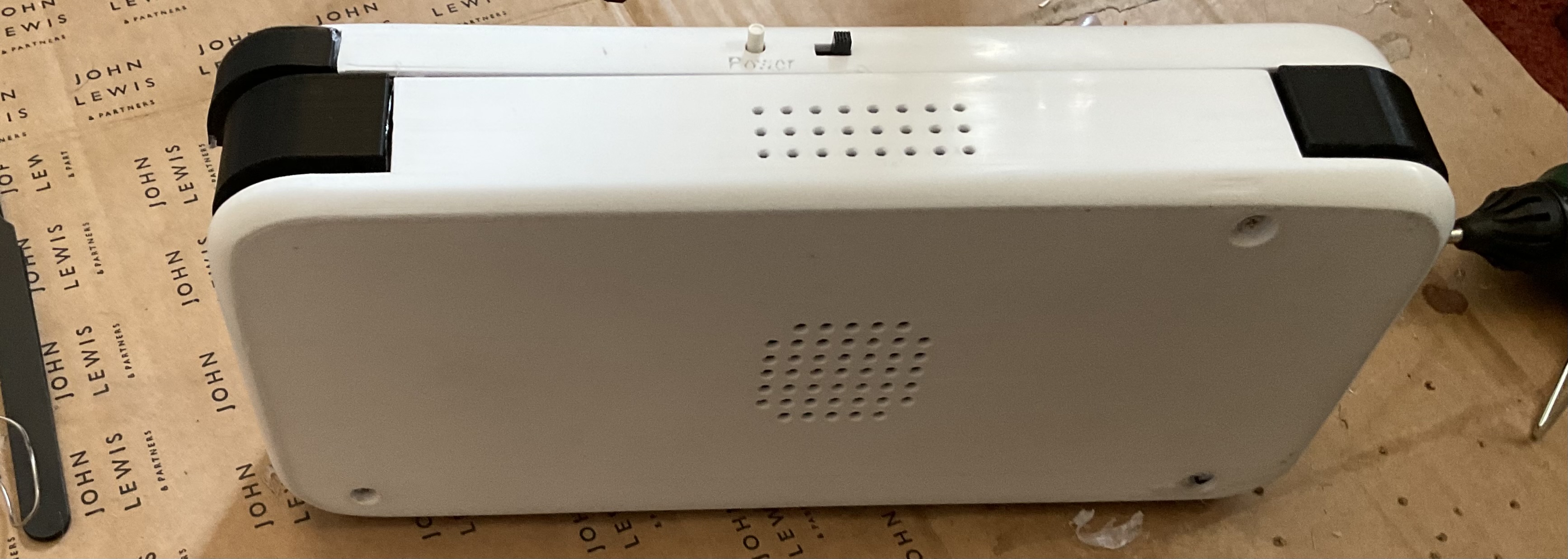

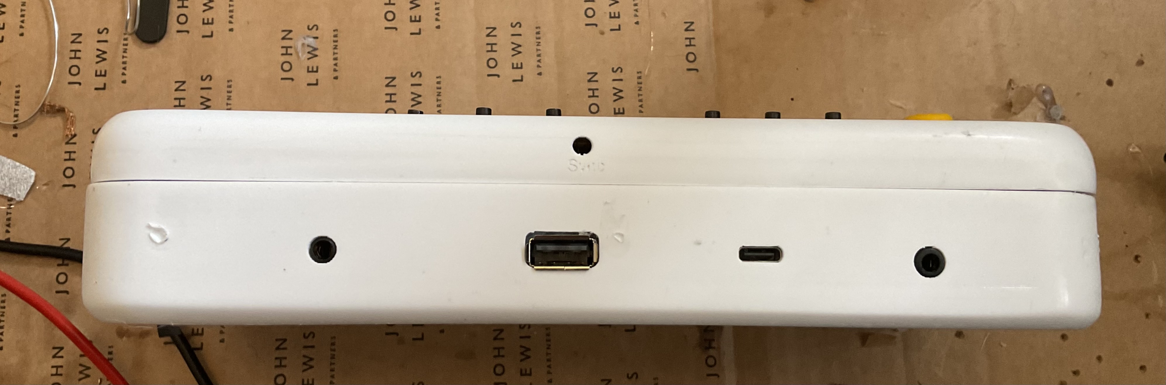

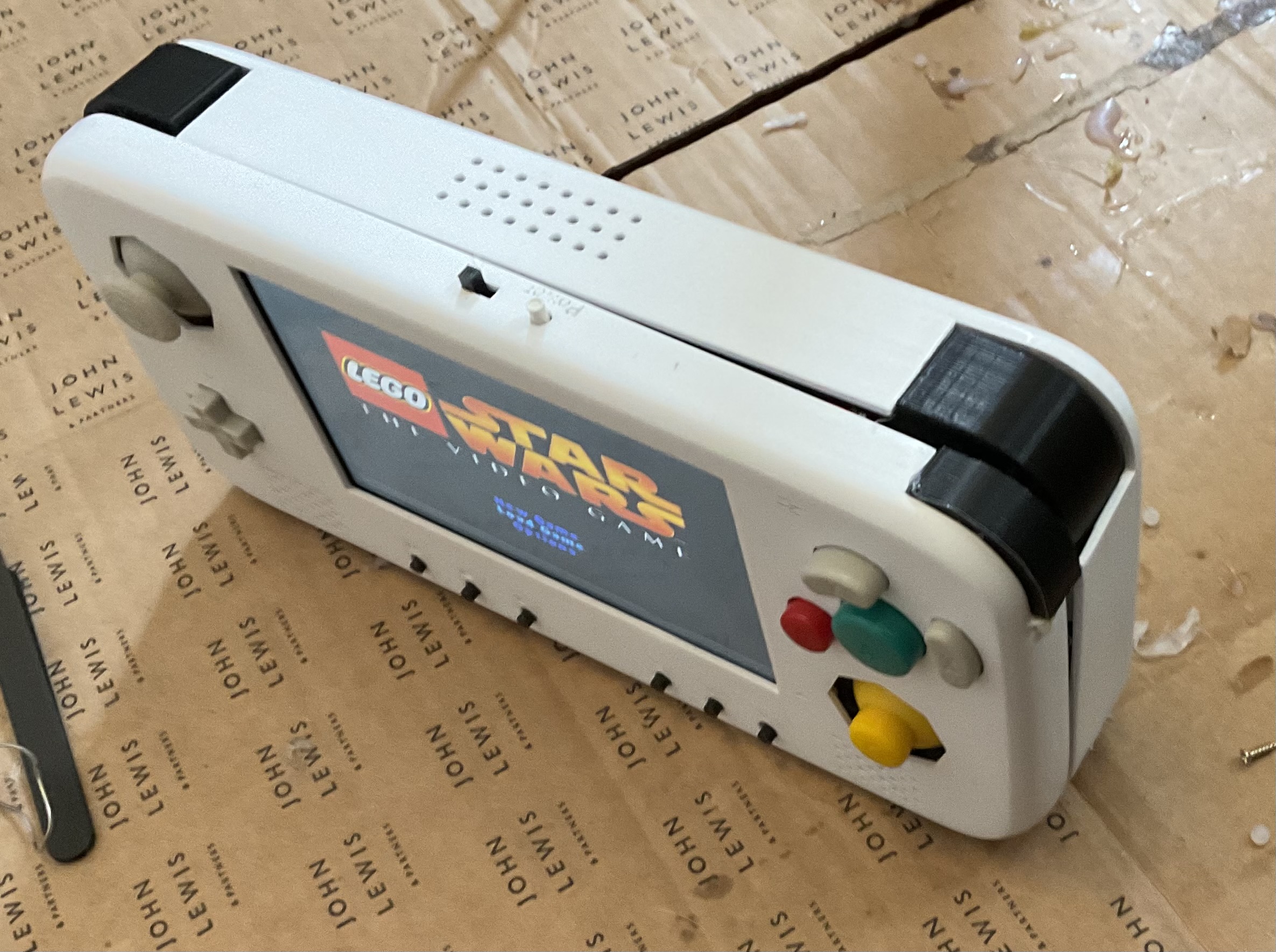

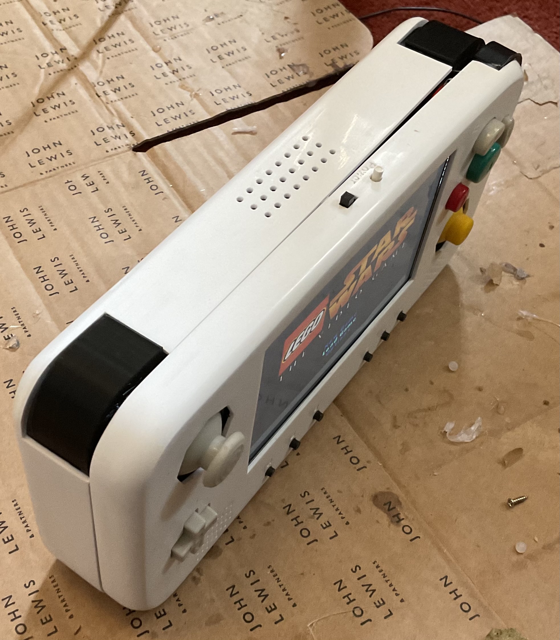

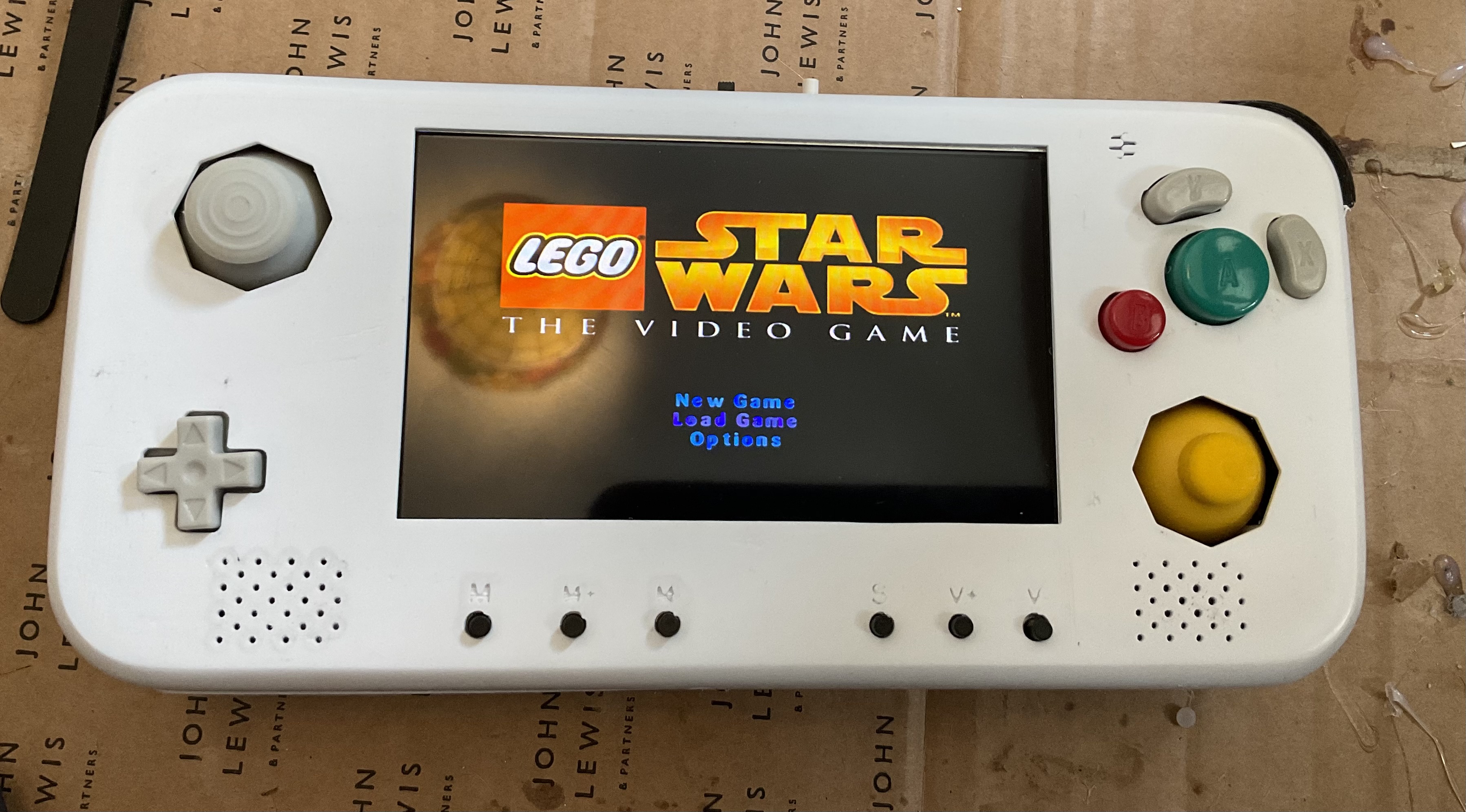

It’s done! Thanks to everyone who helped me along the way, it is so much appreciated! It is VERY rough around the edges and quite obviously a first portable, but I am still proud of it. In the end I skipped out on Bluetooth because I couldn’t get it to work. I may try again in the future, but for now it is left out. In the top right corner, it bulges a little bit due to a design flaw on my part that would need a new case print to fix. Other than that, it’s all done. Thanks especially to Stitches, Crazygadget and Viilmo. P.S. Sorry for the not great images.

Grats my dude! You've done an amazing job for a first project
