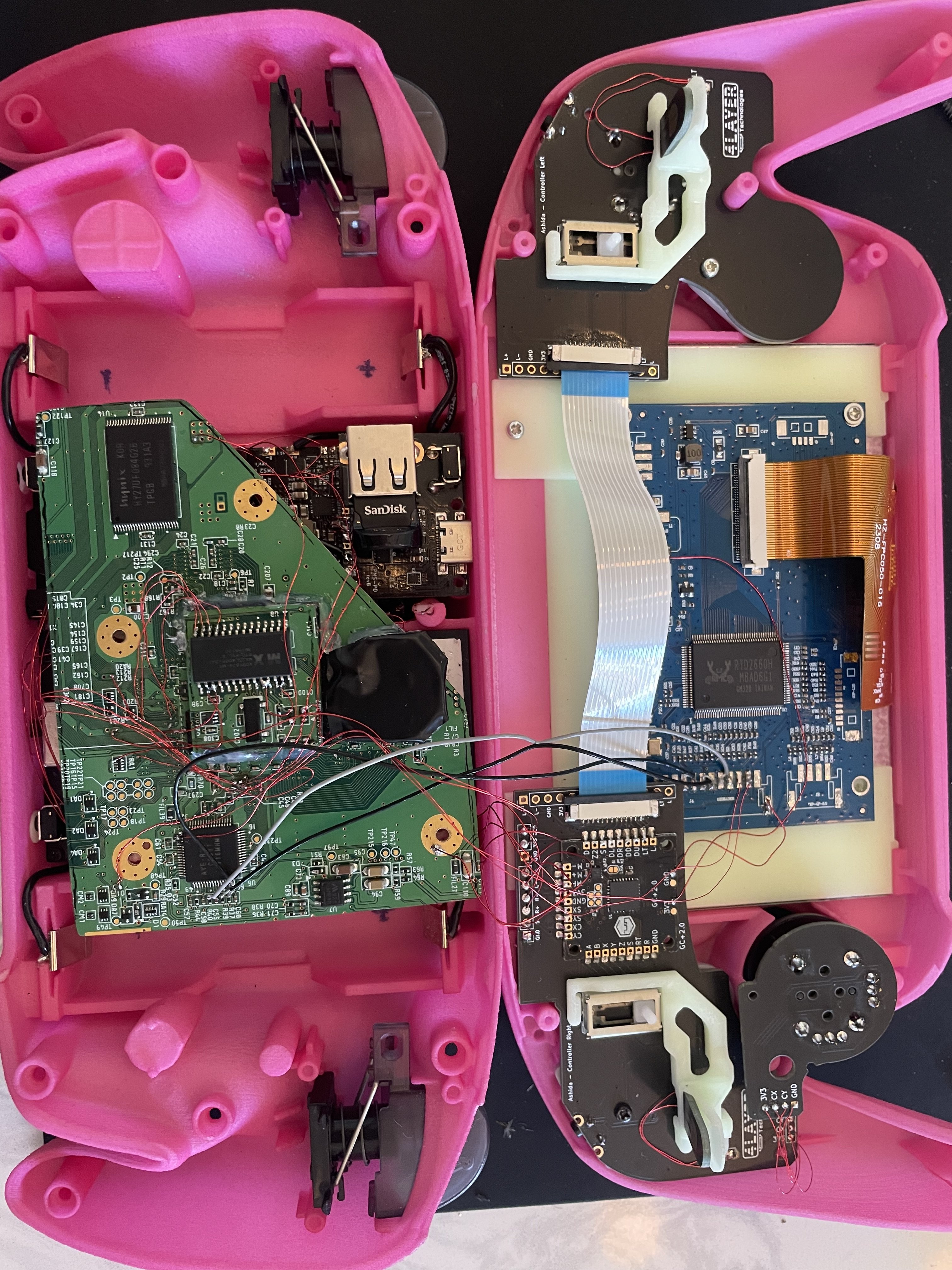

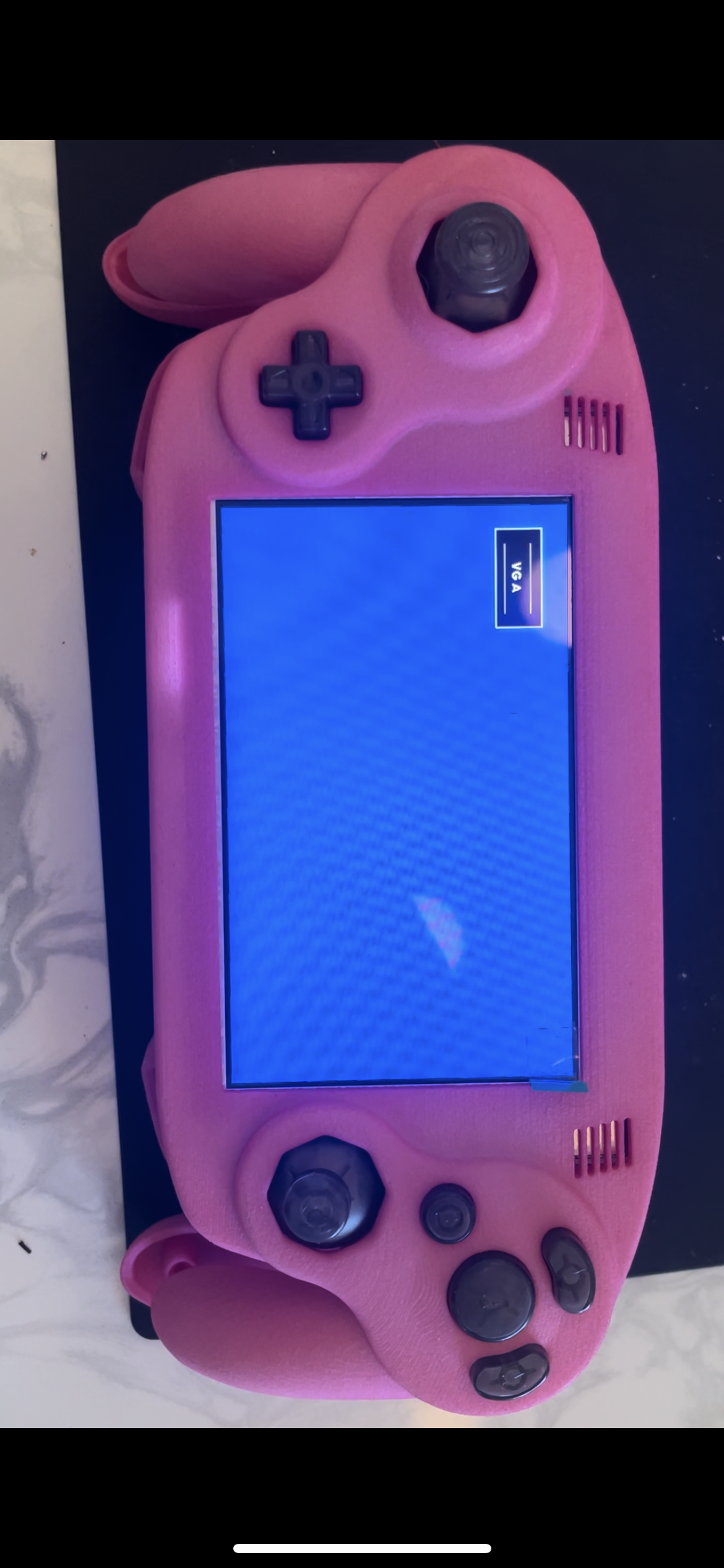

I just finished putting together my first Ashida to find that it doesn't work. When I turn it with one battery inside on the screen turns blue and says VGA for a second, then it turns black and nothing happens. I heard some small crackling sounds, almost like something is sparking so I'm pretty worried.
I tested the Wii trim before I wired it in and it booted fine. None of the voltage lines are completely shorted together, but the resistances between them are definitely smaller than the trim resistances alone.
Accidentally posted before adding photos. Thanks in advance for any advice !

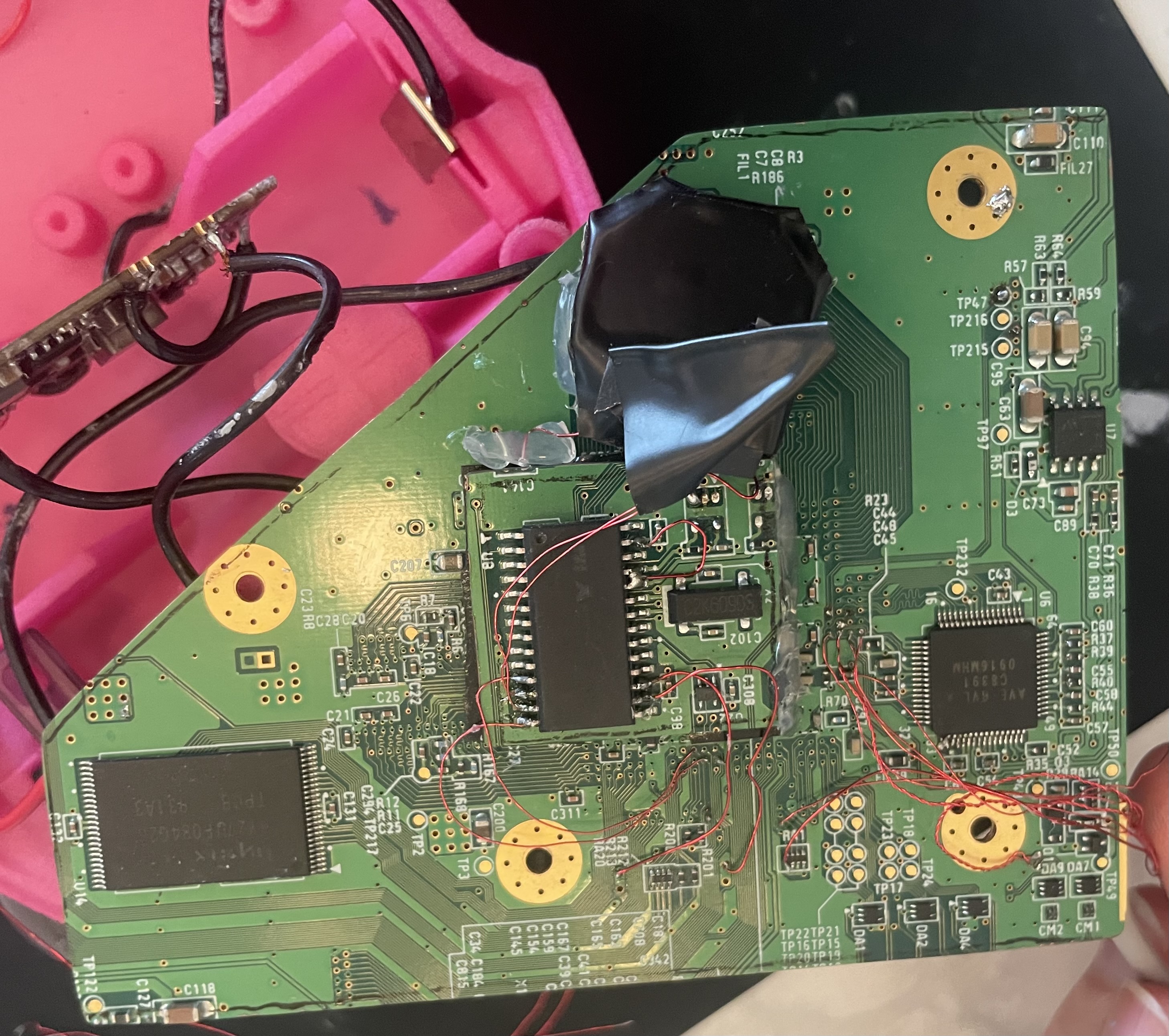

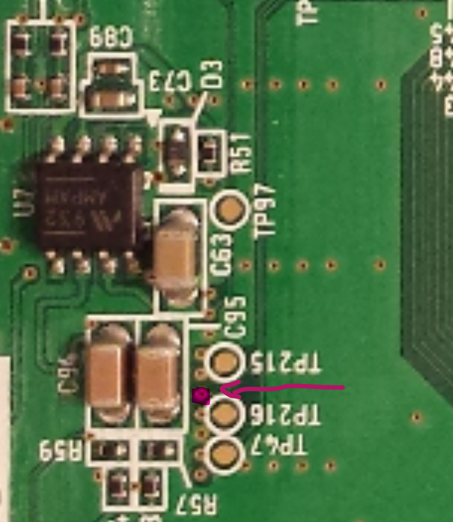

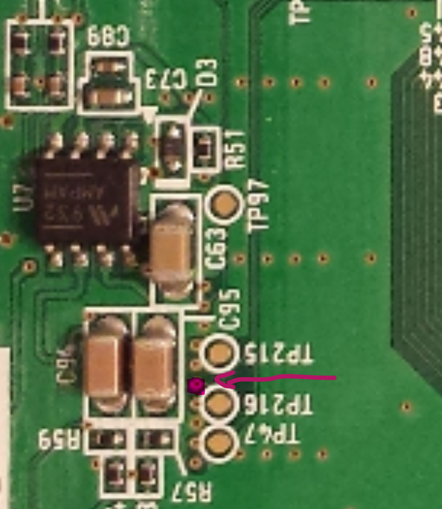

I had a hard time soldering to the mode via, so I moved the mode wire to this via which I believe is the same, but might not be...

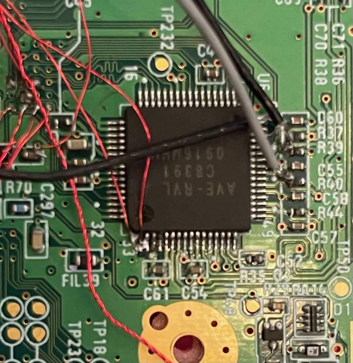

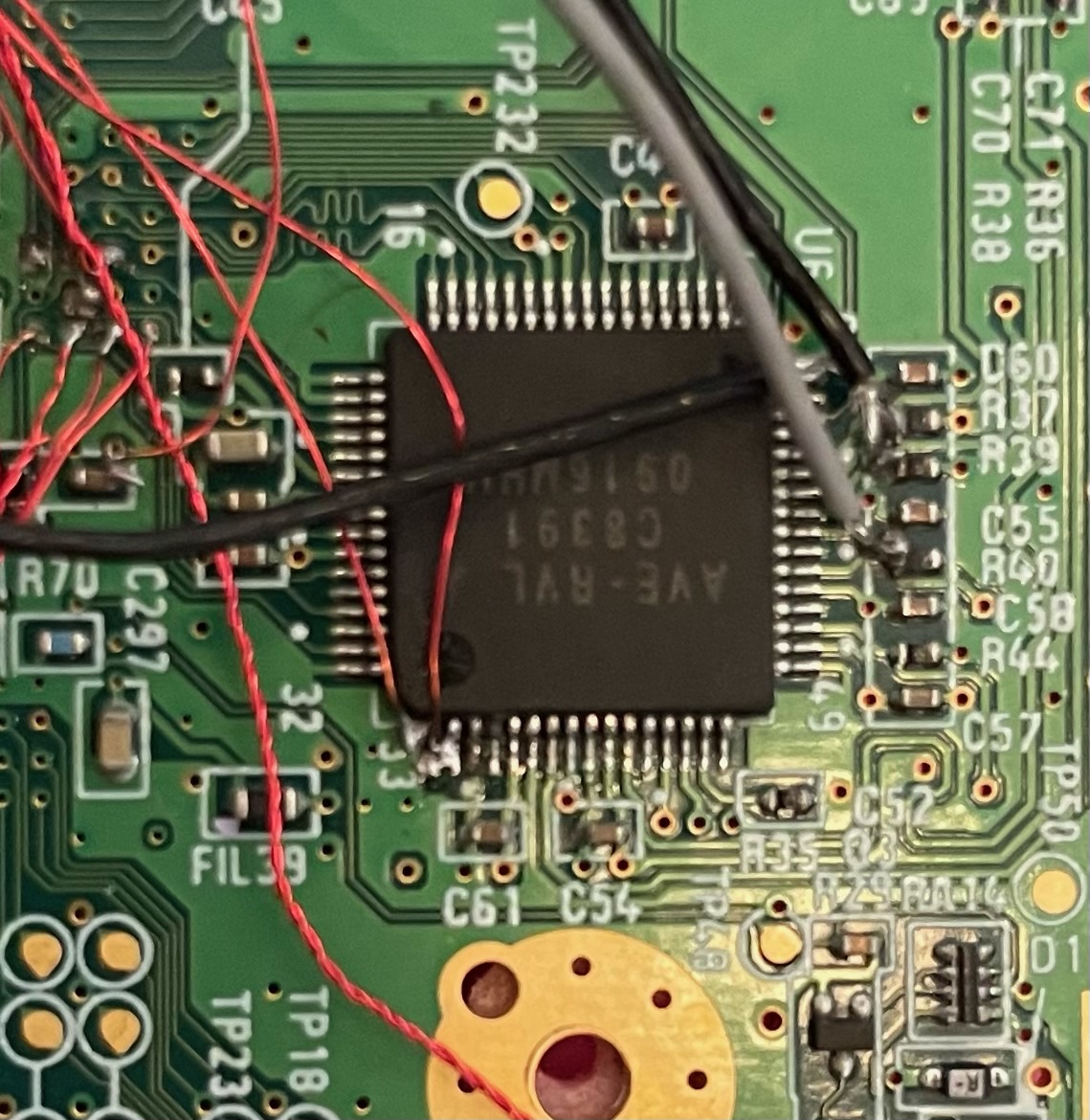

Send a closeup of your H and V sync wires on the Wii AVE. It looks like they might be shorted.
Right I forgot about that. It might be a problem.

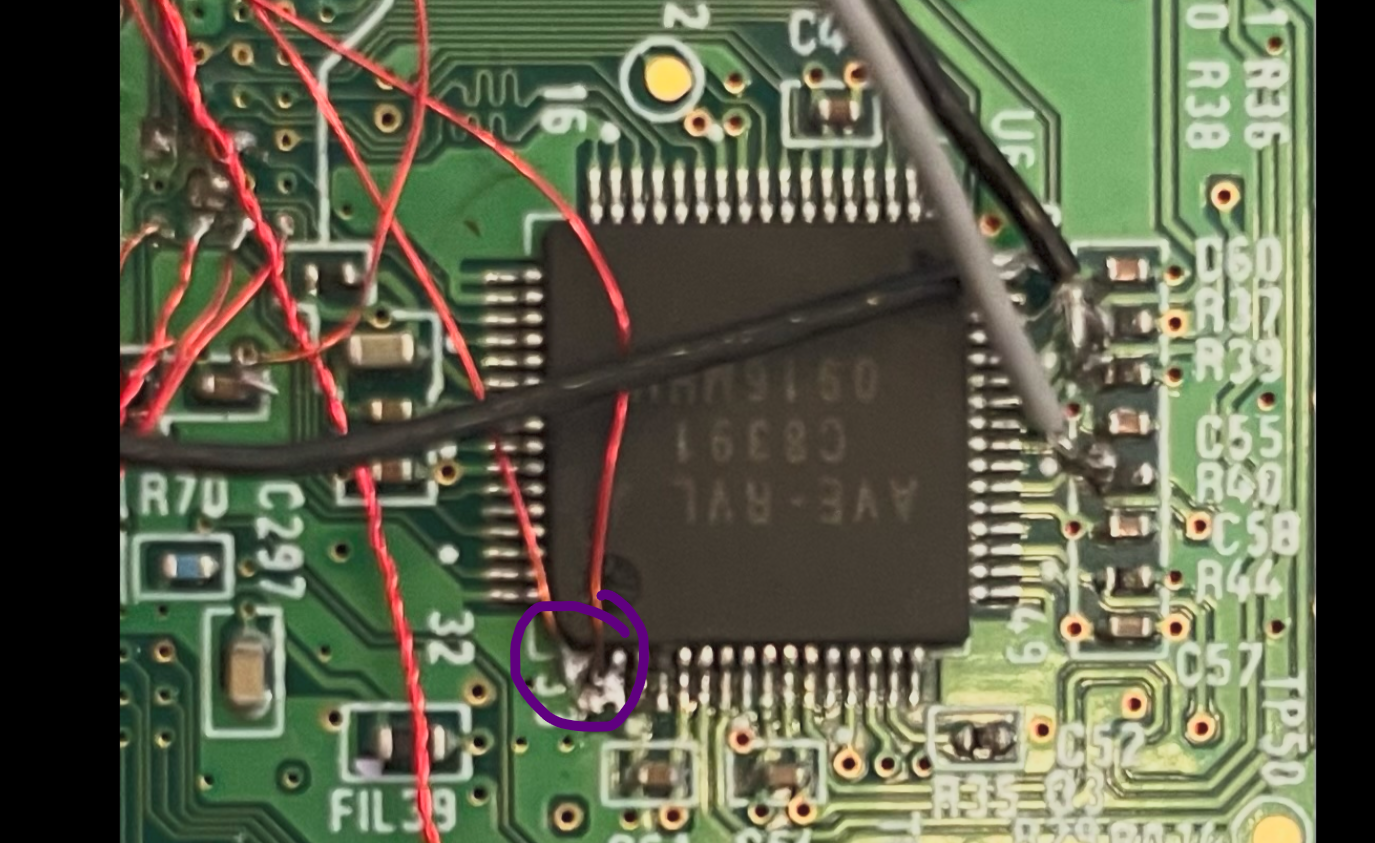

So it's a bit jank, but I read a post that said Hsync pad on the AVE isn't connected to anything, so I bent the Hsync pin off the pad and used both pads for my Vsync wire because I was having a real hard time with the soldering. Despite looking really bad I'm not detecting any shorts between those pins. Maybe there's an Hsync via on the board somewhere else where I can test if I've broken the connection to the AVE by bending the pin.
Actually, try reflowing these pins here:
From what I can see, they look bridged. I'm not entirely sure if that is still the issue, but I'd reflow them first.

That's not a mode via, so your VGA output isn't enabled. The most convenient mode location is the TP47 pad nearby.

Thanks, I was super wrong about the mode via, but I’ve moved it to TP47 now, but still no difference.

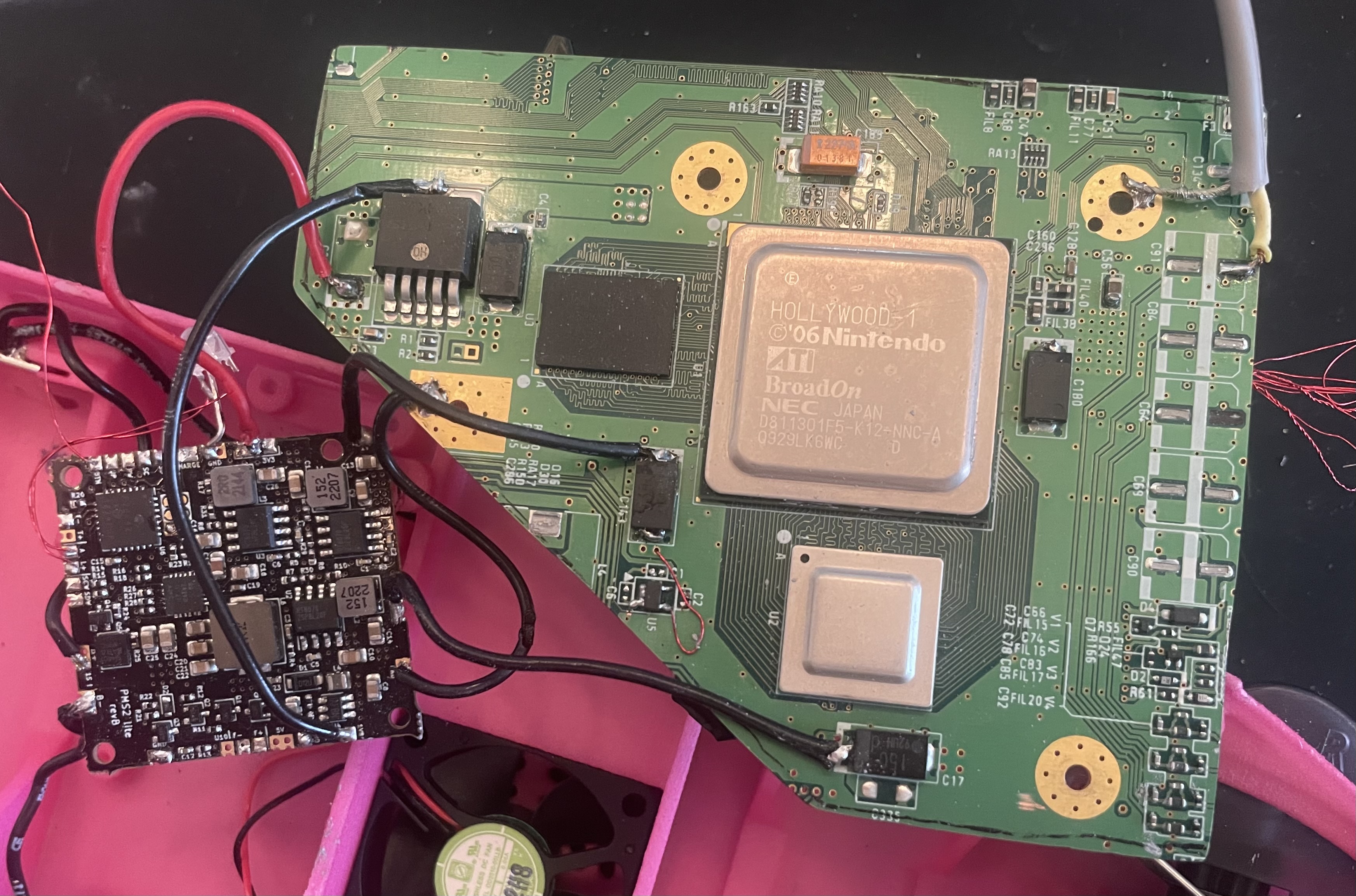

Tragic update… I completely unwired my trim from the ashida and wired to PMS to test with nothing else connected and it no longer boots, just black screen. I must’ve broken something in the process of wiring up everything.
I checked my resistances against the one’s on Nold’s resistance thread and they are still totally fine or higher. I have no idea what it could be. U10 wiring still looks solid. Lost a couple MX data lines in disassembly but that’s alright. I might remove the MX just for sanity.
Also… I just removed the Wii and tested the PMS with battery for voltage and my 1.8 line is registering as zero… All other lines are fine. Super weird.
My theory right now is that either my PMS is fried or my CPU is.
Excuse the excess wires. They aren’t connected to anything, just didn’t want to disconnect them in case they’d be harder to reconnect later.

To make it more affordable for simple builds, the PMS-Lite doesn't have a 1.8v regulator onboard. It instead consumes 1.8v from the Wii's LDO to run some of its logic processes, so a reading of 0v on the 1.8v line when the PMS-Lite is disconnected from the Wii is normal.
