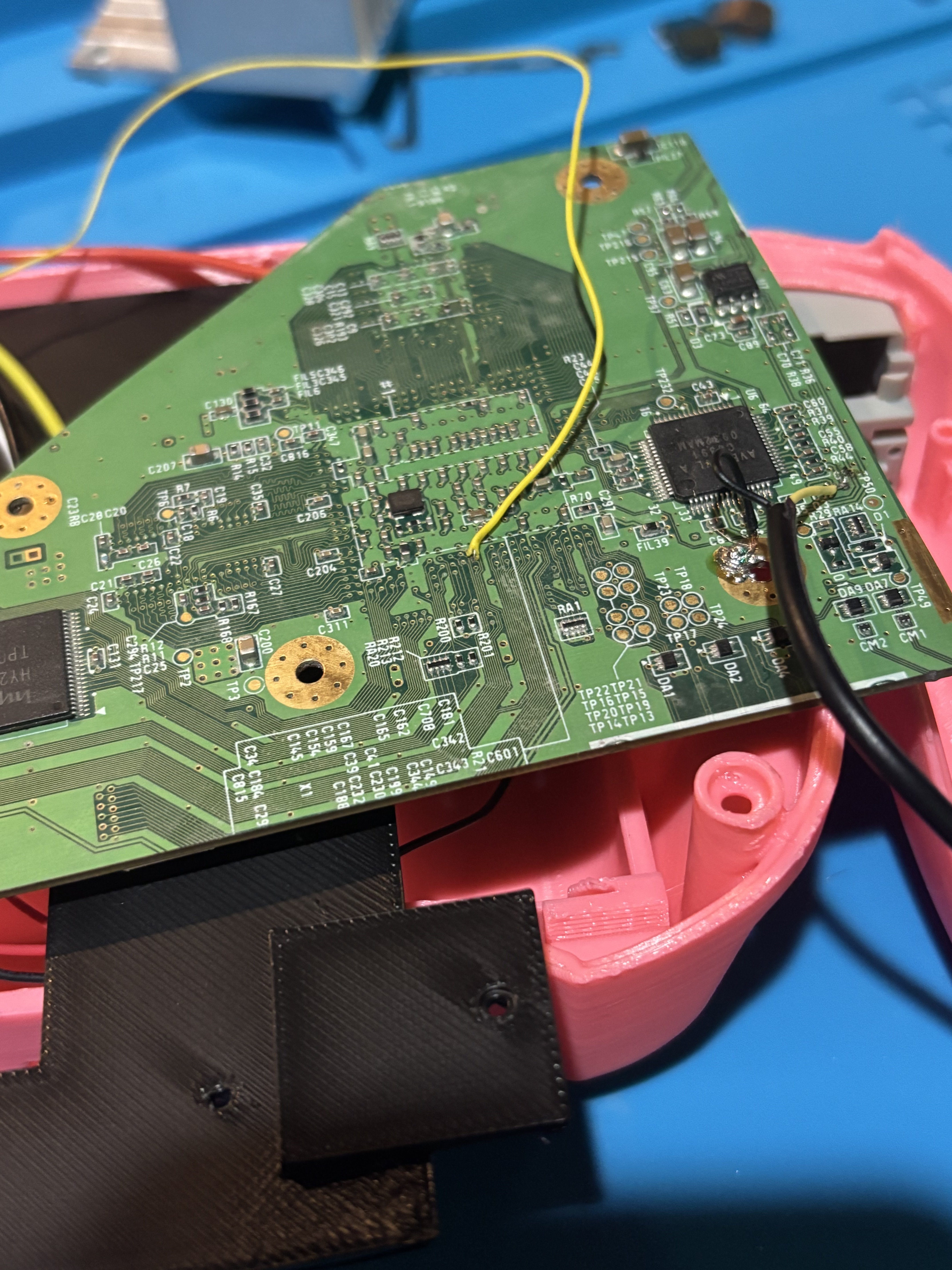

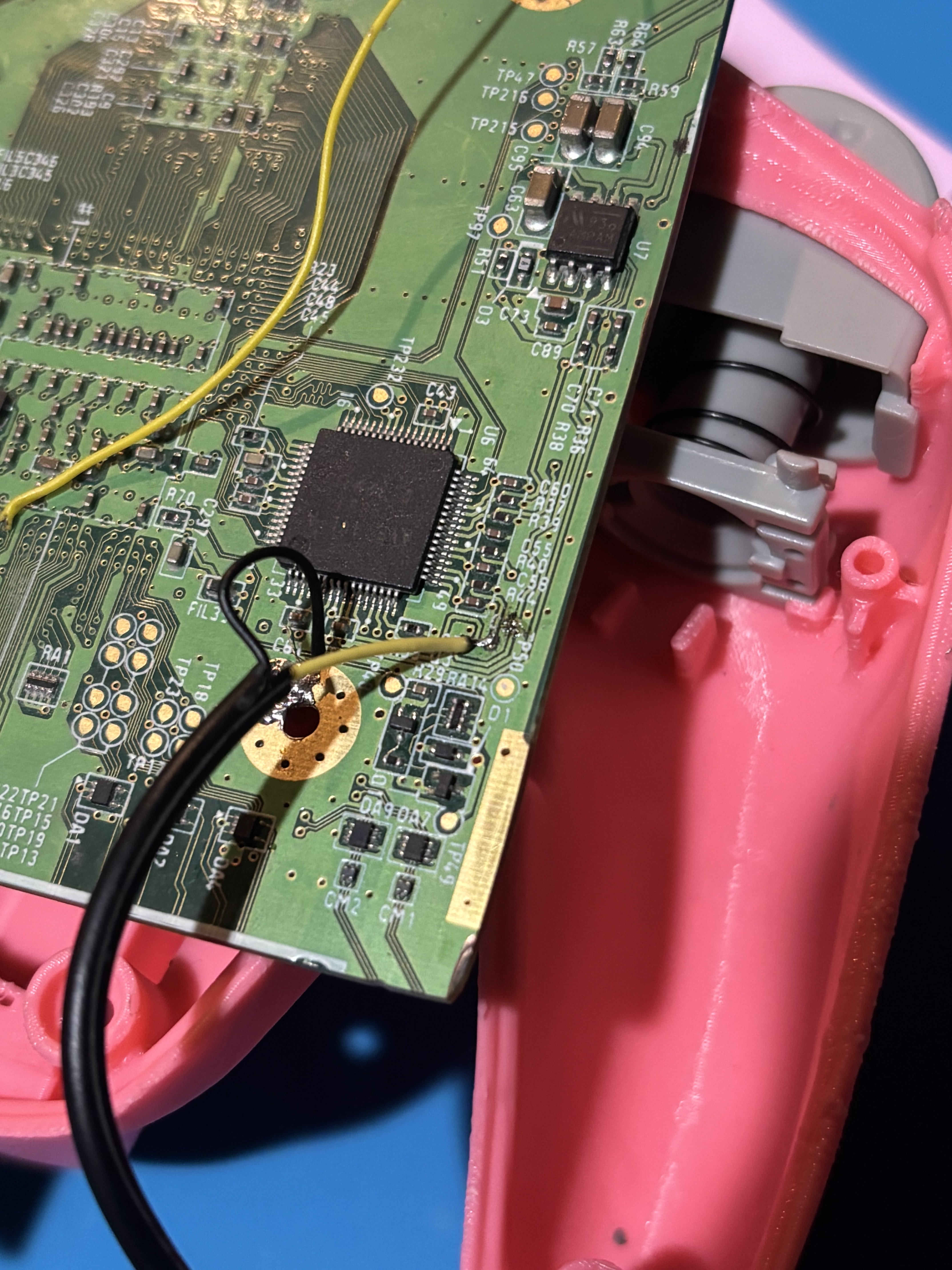

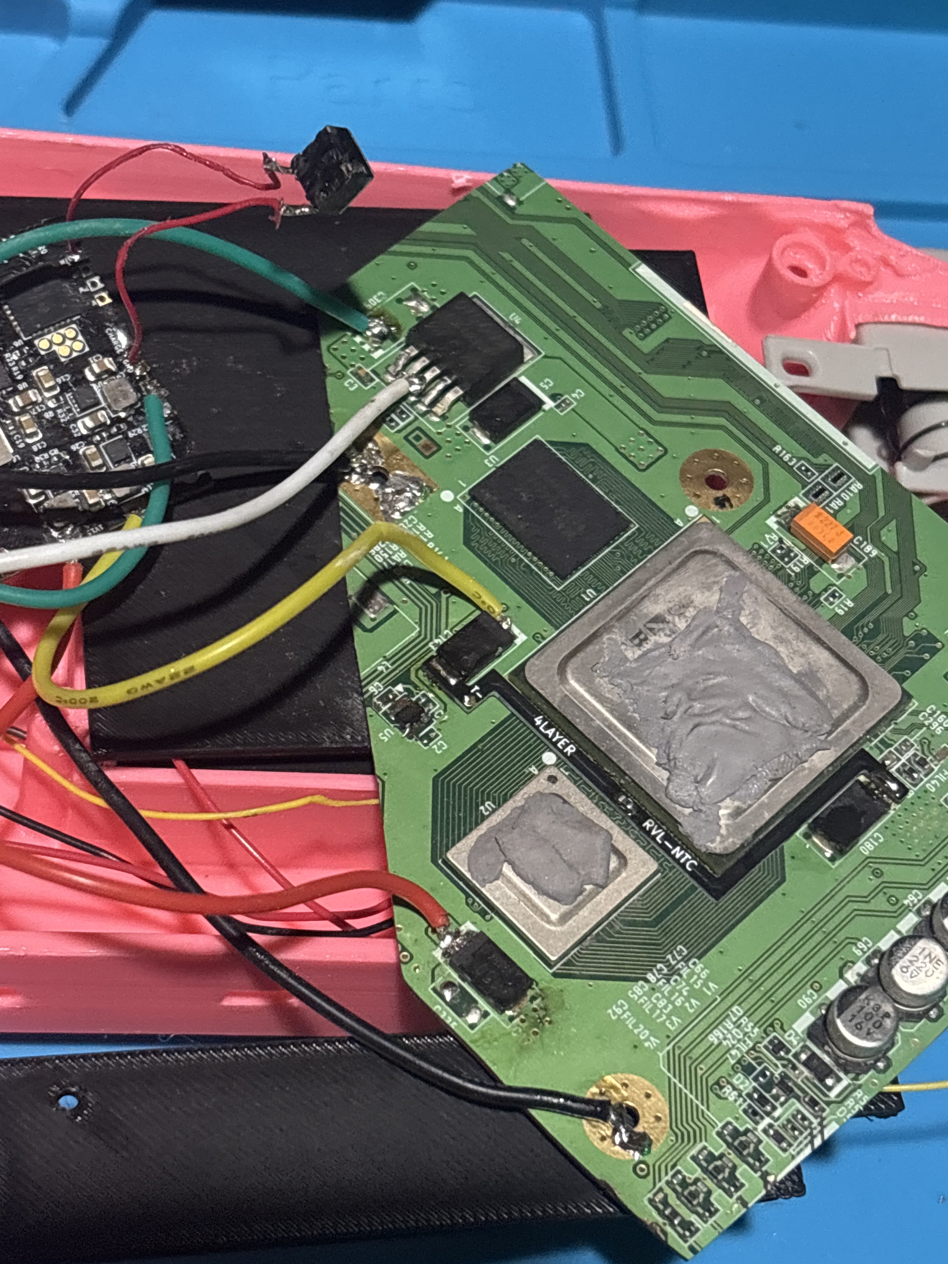

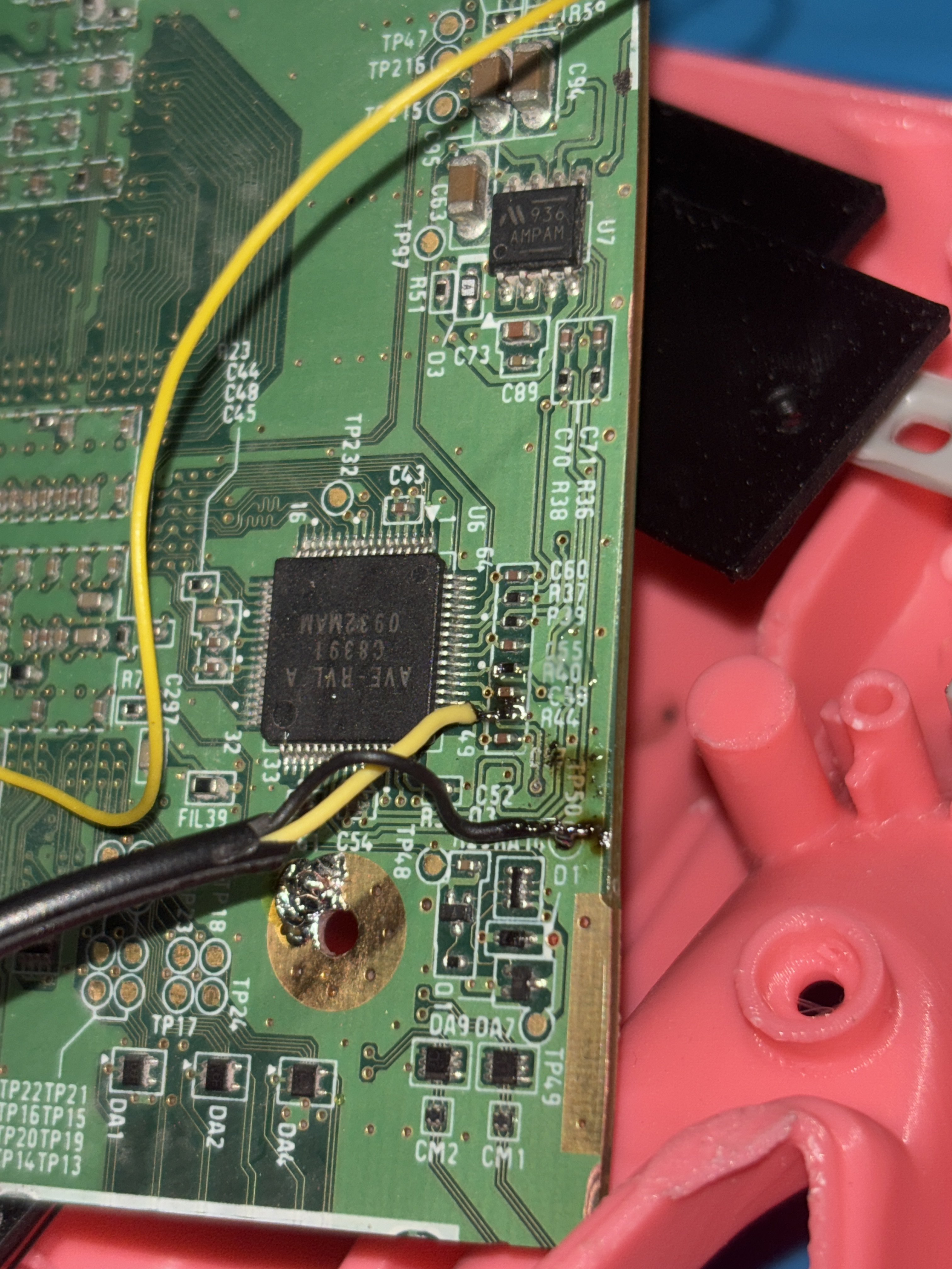

Hello all,

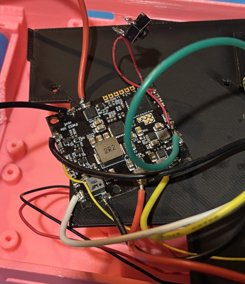

I've successfully gotten my Wii to turn on and send a signal to my tv, but it is just a black screen. I have rewired my U10 multiple times, and I think I properly soft modded my Wii for portablization. There are no shorts and continuity and resistances are good everywhere. I have also since removed the fraying on the ground wire of the composite wire. Any help is greatly appreciated, thank you in advance. Also, I am trying my hand at writing about the Ashida build process as I a progress through it. Should I post it here or link it here if there is any interest? Let me know.

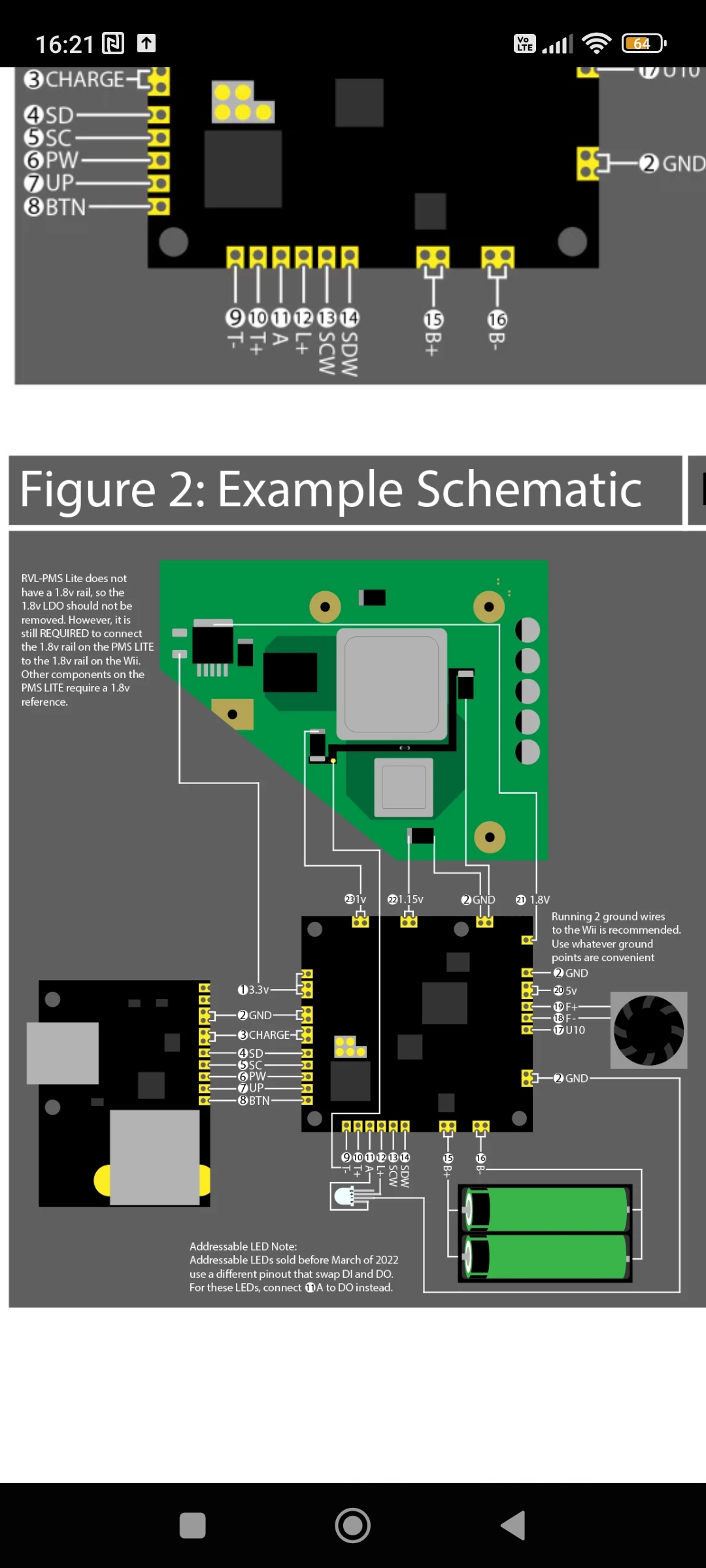

Hello,you need to sold your ground wires on 2 different ports.If it's still not working,check this

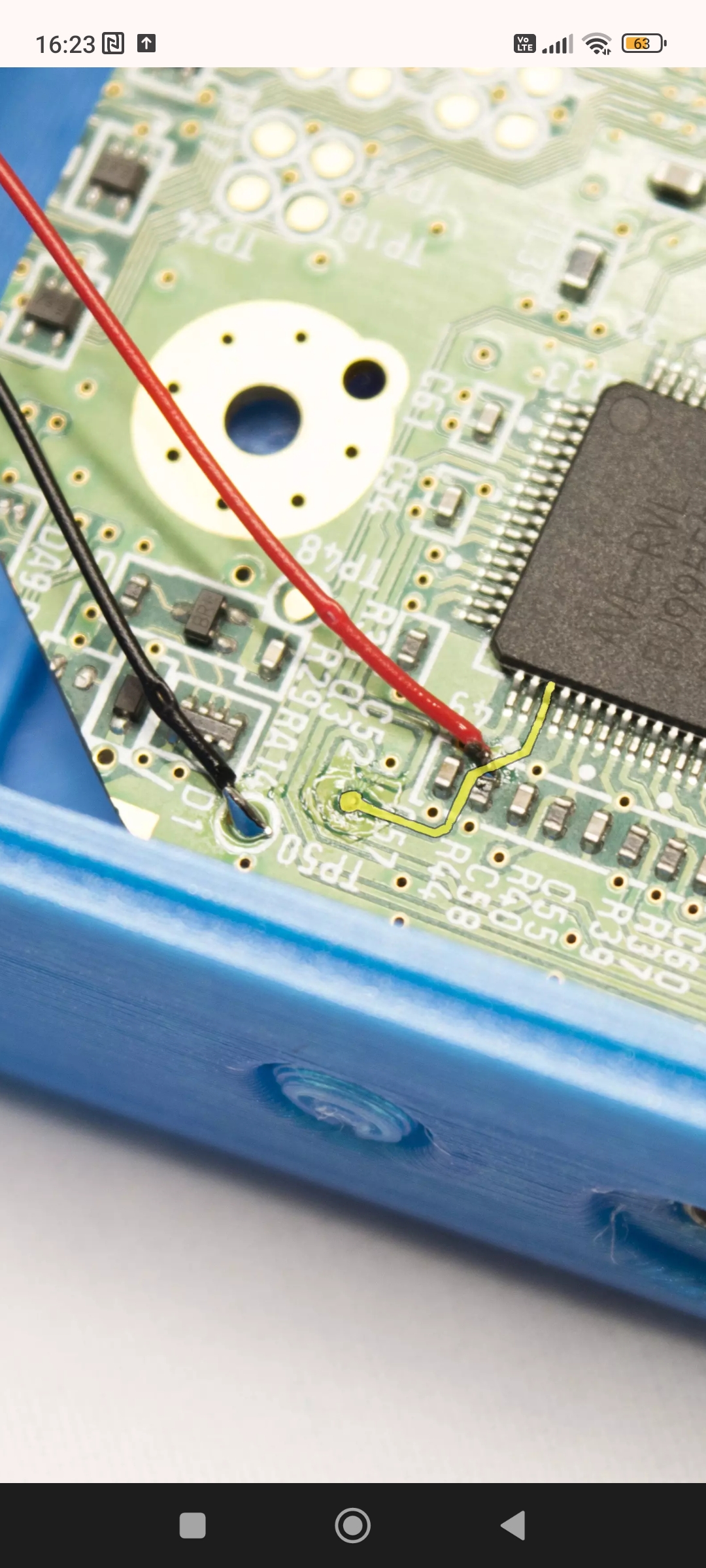

You also forgot to properly wire the composite câbles like this:
Hope it helps :)
I’ve wired my grounds to separate pads on the pms, do you mean different screw pads on the Wii? Will try the different composite video wiring
update: tried the new composite wiring. Ground wires are wired to separate screw pads and pads on the pms lite. No luck. My Wii is modded for vga but I am using a yellow AV cable for testing.

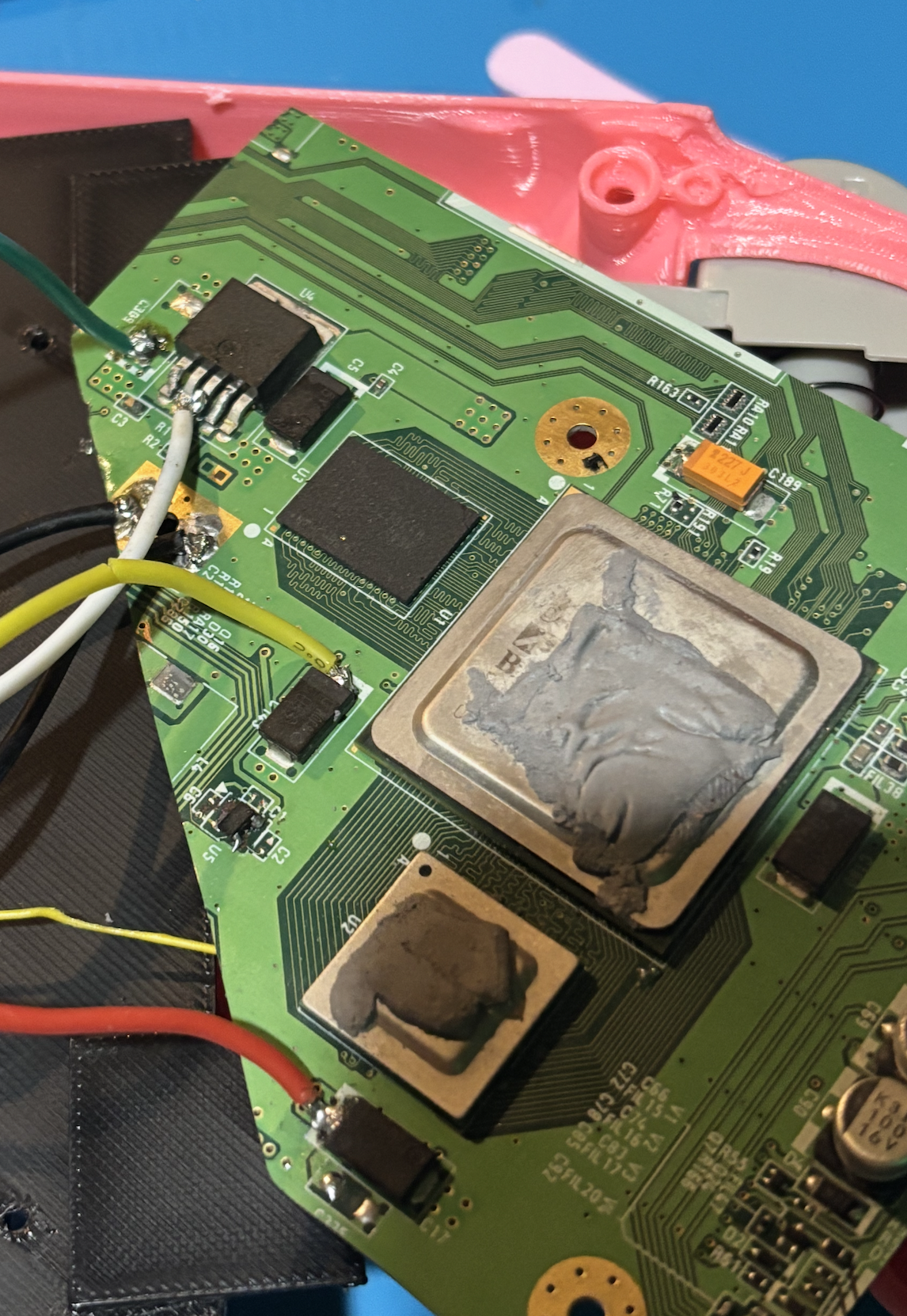

Yeah thats what I mean for the pads on Wii.I do that for my précédent Wii and it was working so I think it's like that we need to do:?:
By the way,why did you not remove the voltage regulators at the right of the Wii?
I'm not an expert but I take a lot m'y informations from this vidéo,si definitly check it:
