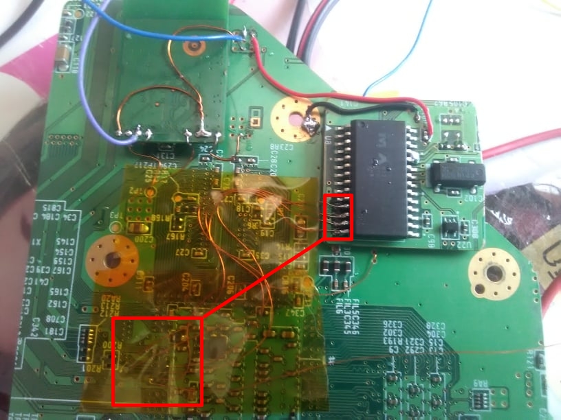

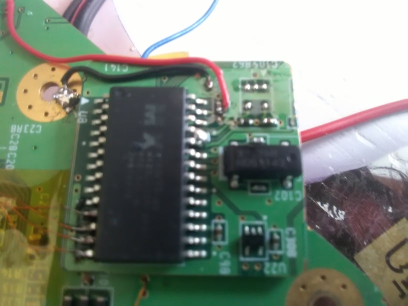

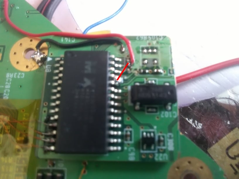

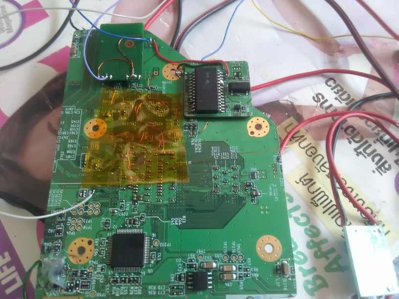

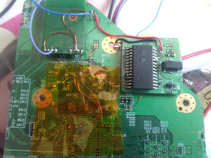

Hmmm, are you sure about the 4 voltage pins? I see that you have connected pin 24 and 25 together, though you are not powering them directly based on your images.
Pin 27 and 17 are connected on the internal 3.3v plane on the mx pcb, but 25 is not connected directly to the 3.3v plane, but rather through the R62 resistor. So there is continuity, but there should be a high resistance by default between pin 27 and pin 25. Try to power pin 25 and 24 directly to 3.3v instead of going through that resistor and see if that works?
