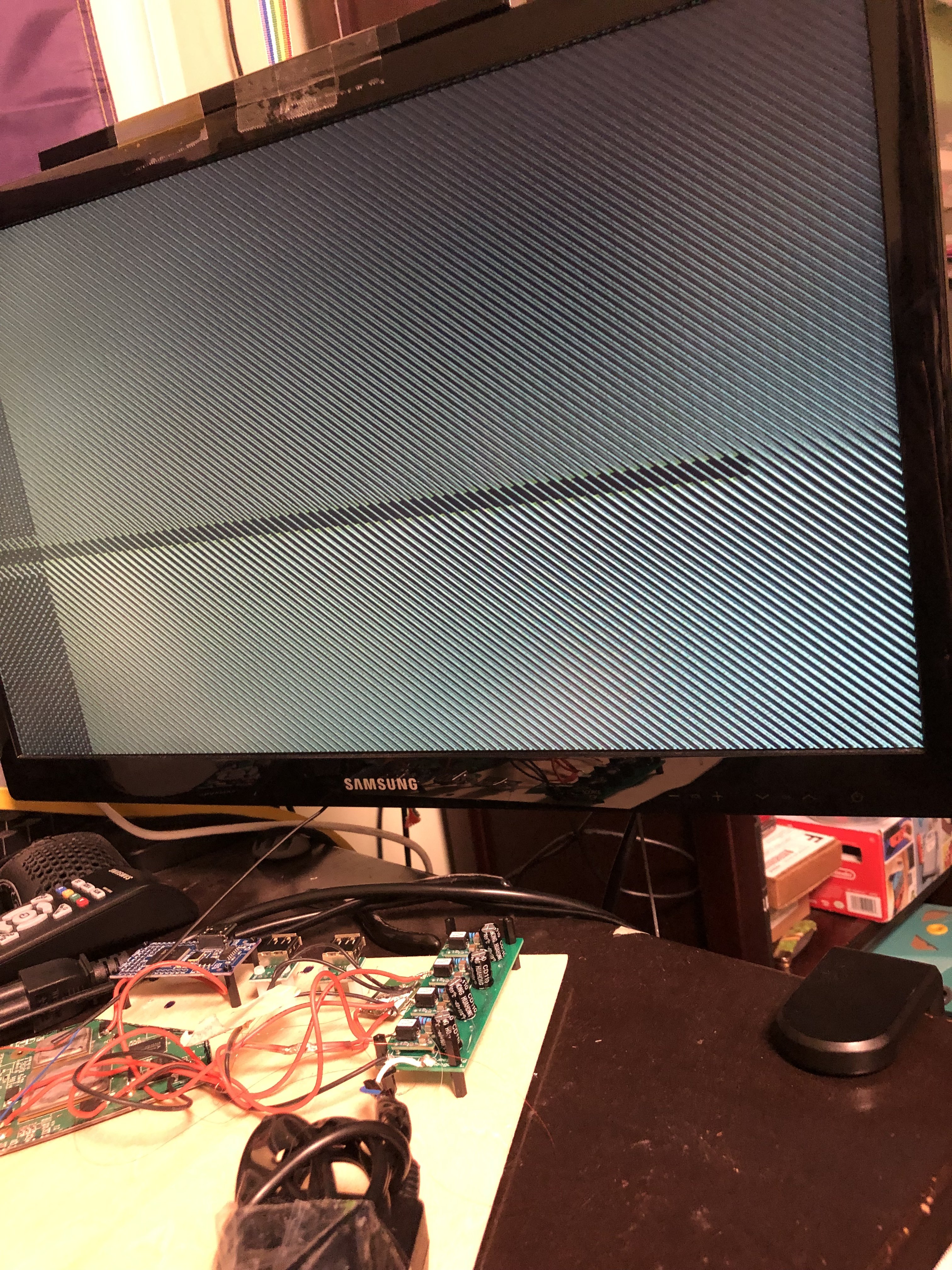

Solved Is my wii fried, and if not how do I fix this

THANK YOU ALL SO FREAKING MUCH
Oh so it was the supply voltage then. Guess I should add that to the list of "shit what causes Wiis to act fucky"
