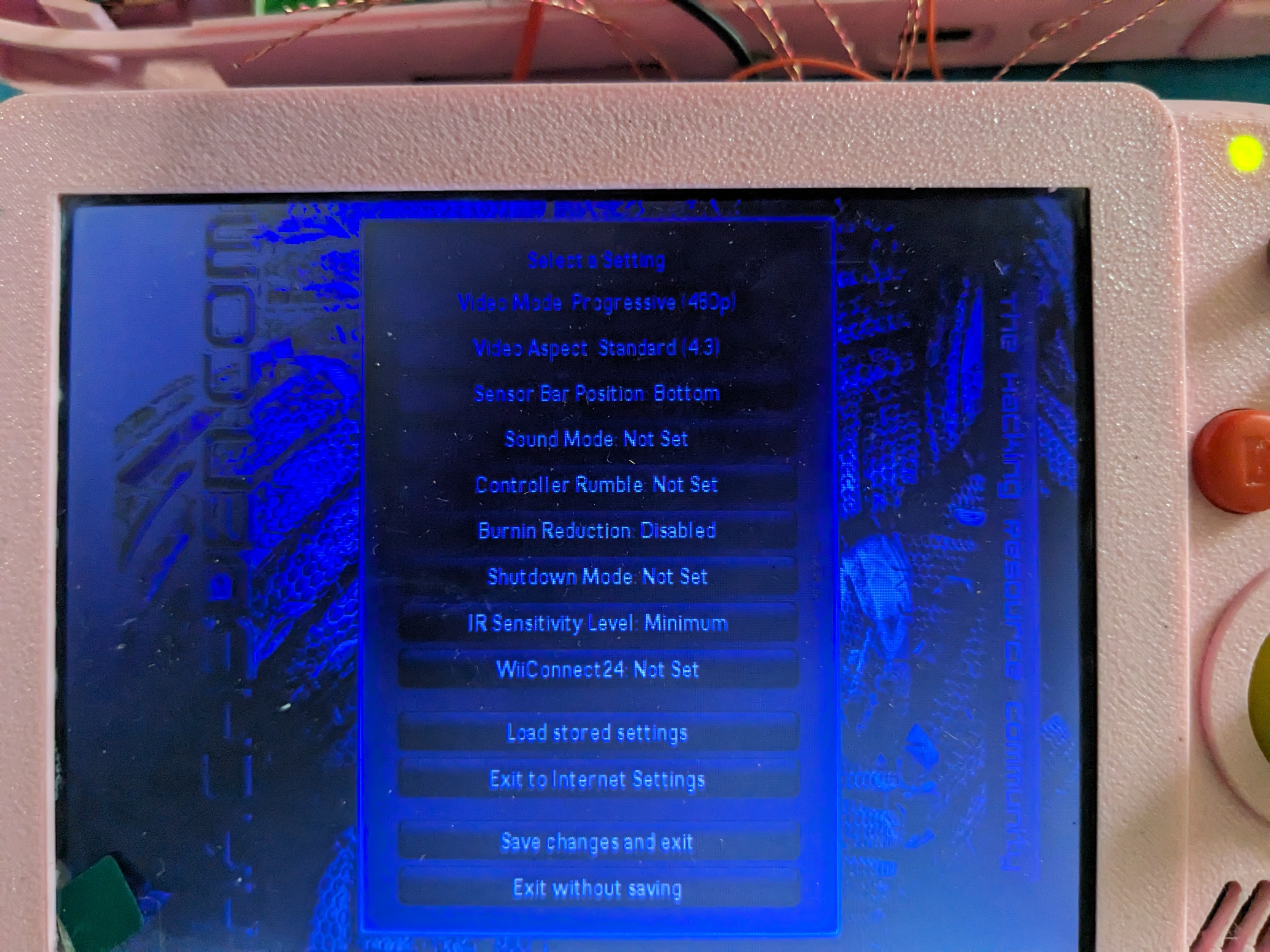

This was the best image that I was able to get to show the settings for my Wii. It's 480P outputting in VGA to a 640x480 screen with a 4:3 aspect ratio. For whatever reason, a small portion on the left side of the screen doesn't get used. I've looked at some other G-Wii builds and this doesn't seem to be normal. Does anyone know what my issue might be?
You'll need to access the screen controls and mess with the OSD settings for it. Depending on which driver board you have there is an "Auto" setting that will attempt to fit the image to the screen.
Thank you so much for reminding me about that. The auto config didn't help, but I was able to manually offset it, and all is well now!
