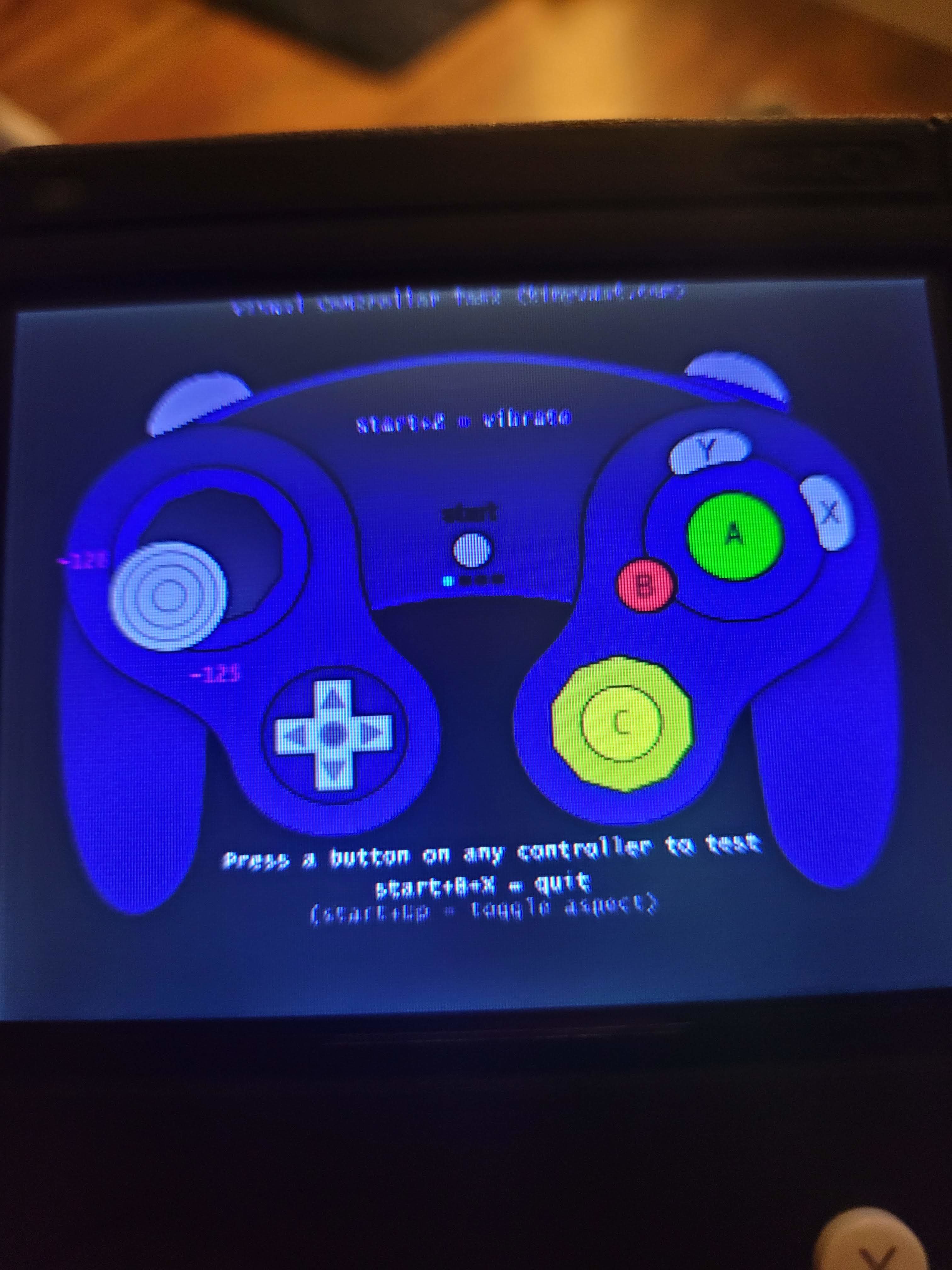

i recently got this wiiboy and i encountered an issue where the left stick would drift to the bottom left, i do not know where to fix, and i can`t access any apps, although im able to acces visual controller test because it is set to the bottom left of the screen.

Before you do that try to reset the gc+ analog stick configuration by holding X+Y+A while you turn on the wii.
