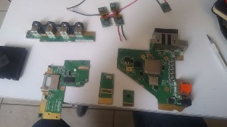

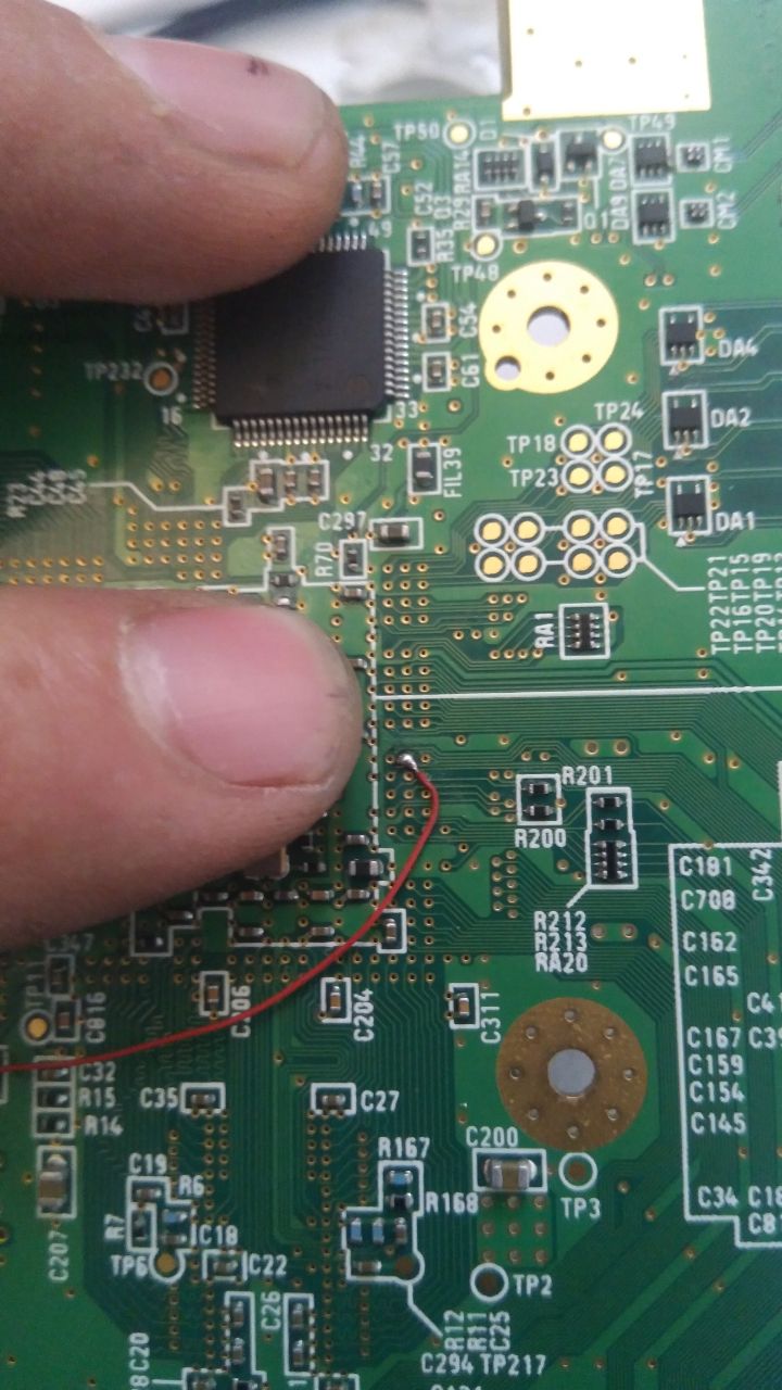

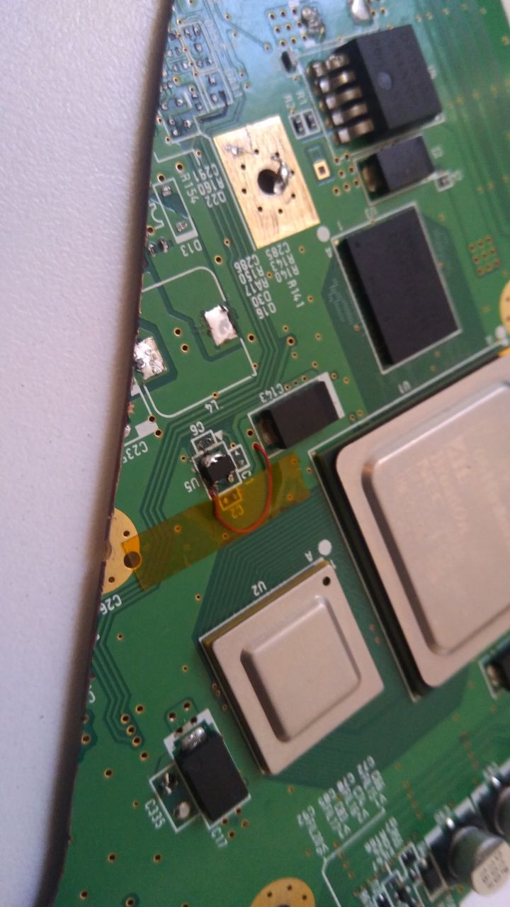

I trimm my mb using a hacksaw and then the sandpaper, the trick is not to press, just scrape the surface till it cut, why do I do it that way?, because the dremel usually jumps in case you are nob (my case xD image 1 & 2)

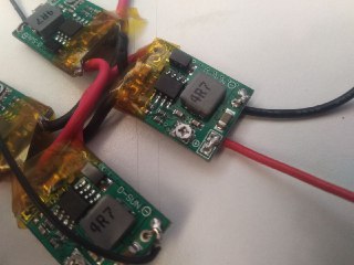

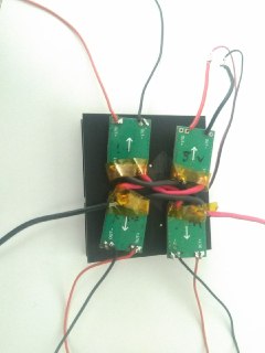

I will use mp8415 as a power source, if they are powered at 12v or more they give 2 amps, the problem is that they get hot, so I mounted them on an old gpu fan (image 4 & 5)

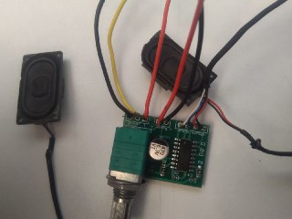

s a sound amplifier I will use a PAM8403n module and two speakers from an old laptop, it sound nice (image 6 & 8)

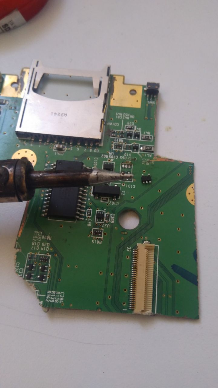

I reassigned the u10 using a normal soldering iron, but I have enough practice (image 9, 10 & 11)

Those regs won't work reliably if at all, and they're clearly a fire hazard. You should get some PTH08080s or a PMS from the BitBuilt store. As for the batteries, you mustn't mix cells of different capacities, it's not safe. Use either the 2200mAh cells or the 3400mAh cells, but not both together. Powering the fans off a separate pair of cells is pointless and wasteful, they don't pull enough current to warrant a separate power source. Just run the fans off the shared 3.3v or 5v lines.

yes it can get fired, but i made some test on it using my 3d printer thermistor, if u use it at 2 amps it reach the temperature of 45°C at 10 min, for that i'll use the fan dissipator, the pwr supply will be adding to it using thermal paste then making the same test at 2 amps the temparature get down to 20°C at 1 hour using the 4 at same time, now my new issue Is that i must replace the potentiometer using resistors for each pwr supply; i'v read about the battery be shure that i wuld'nt , maybe i use one or two only for the two fan, these fan must have a 5v pwr supply if i use It separaste from the other batteries

You're going to use a fan (and a rather large one at that) just for the regulators? How are those regulators even mounted on the fan? They look like they are just taped on. There is no way that will work well. Plus using 6-8 batteries with whatever battery solution you come up with, I doubt this project will be very "portable". You also mentioned that the regulators must be ran at 12V or greater. Therefore you must use either 4 or 8 batteries. I'm not really seeing it here man.
Also this is just begging for a short, put some heatshrink around those solder joints
Hi, i use thermal paste on the central chip & Coil to glue it on the fan, the measure is height 1cm, widght 7cm & long 4cm, the coil that i use is thermal coil 22 & 25 gauge, the same that i been use on my 3d printer, it support 300°c (its what the coil says on it), yea i allready use kapton on the solder join, on this image i just was testing the fan, about batteries, maybe i use 4-6 It depends how i make my case design, tnks to comment
