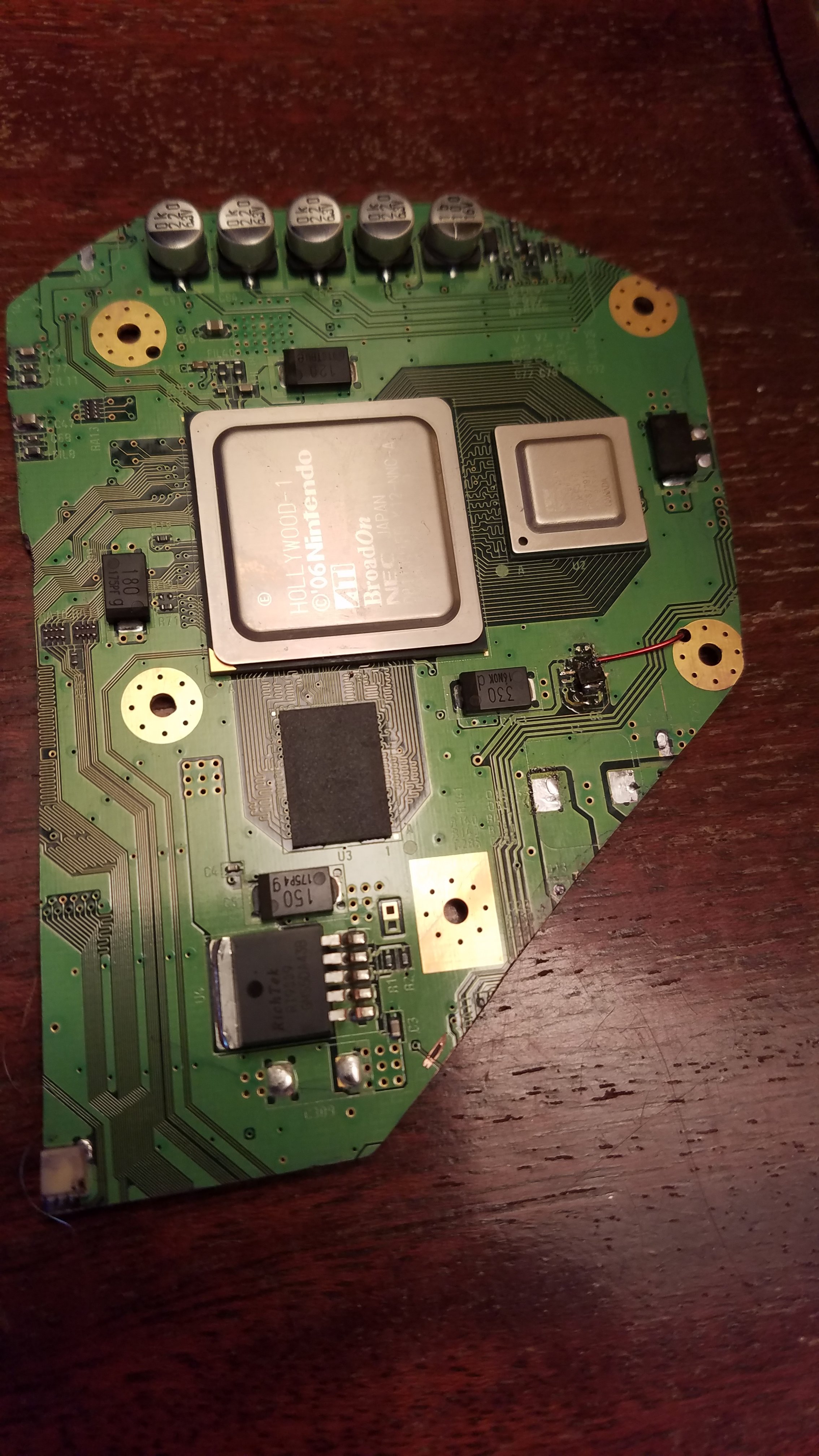

Got the caps and inductor pulled off, want to make sure this is a good trim.

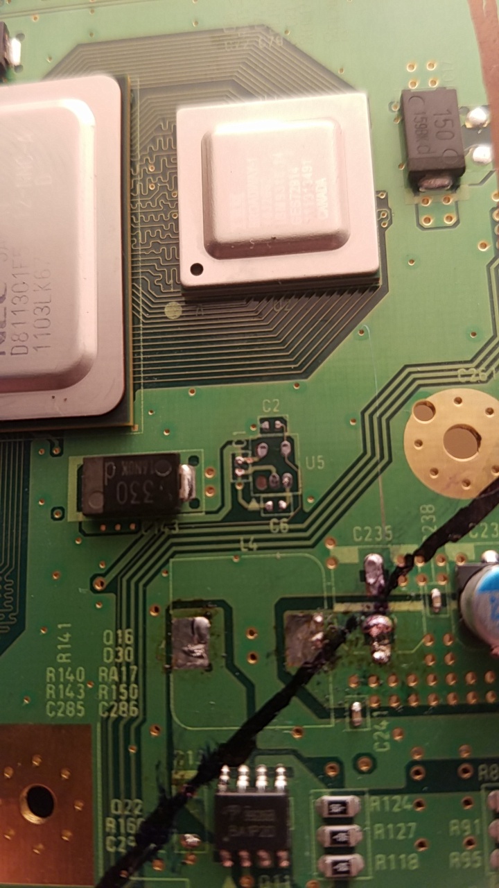

Also I just removed U5 and it looks like a pad lifted, but I see the same pad lifted on the U10 Relo guide. I assume this is ok?

That trim looks good to me. Just make sure that you don't cut too close the NAND traces.

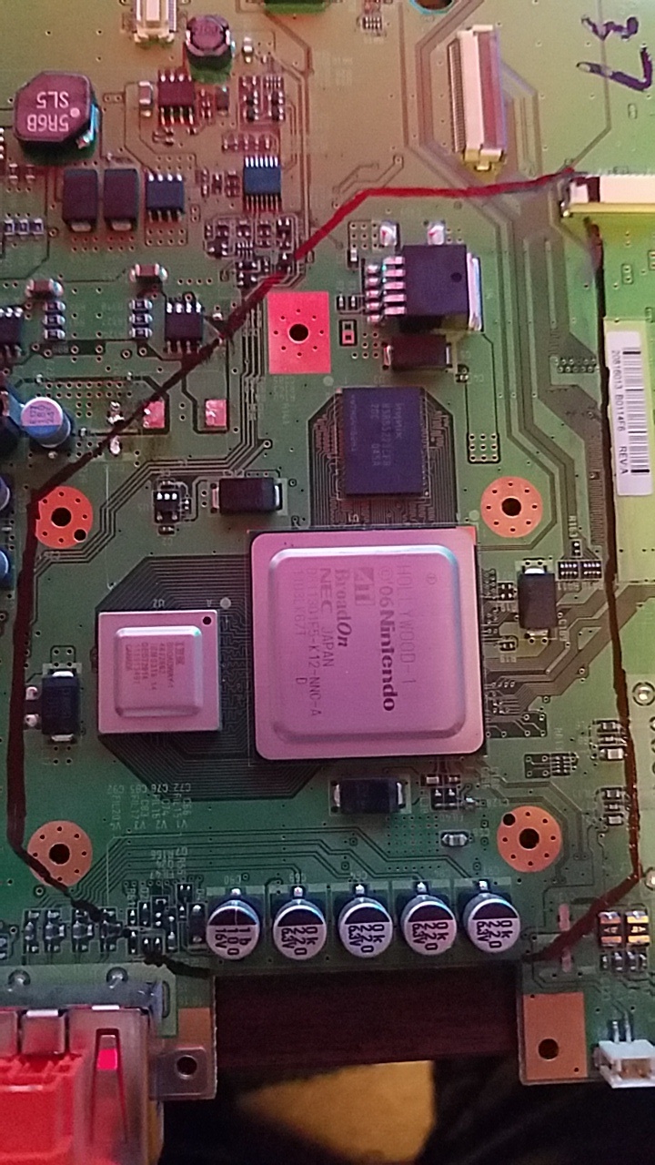

Here's a comparison video:
Also, it's fine that that pad is lifted, just make sure that you still make a solder bridge across all 3 of the pins on that side.
So would it be better if I make that bottom corner by the USB ports more square as shown by the red line? Really cool how you layered the two images in the video, very helpful for giving a perfect point of reference.
Sorry, I forgot to specify. The light blue line is the one you're supposed to be following. The red one is the original OMGWTF, and the light blue is the GBoy trim.
So I need to follow the light blue one on the inside, NOT the rectangular one?
I think I'm good? About to remove LDO and re-solder the U10 wire on the GPU pin side.

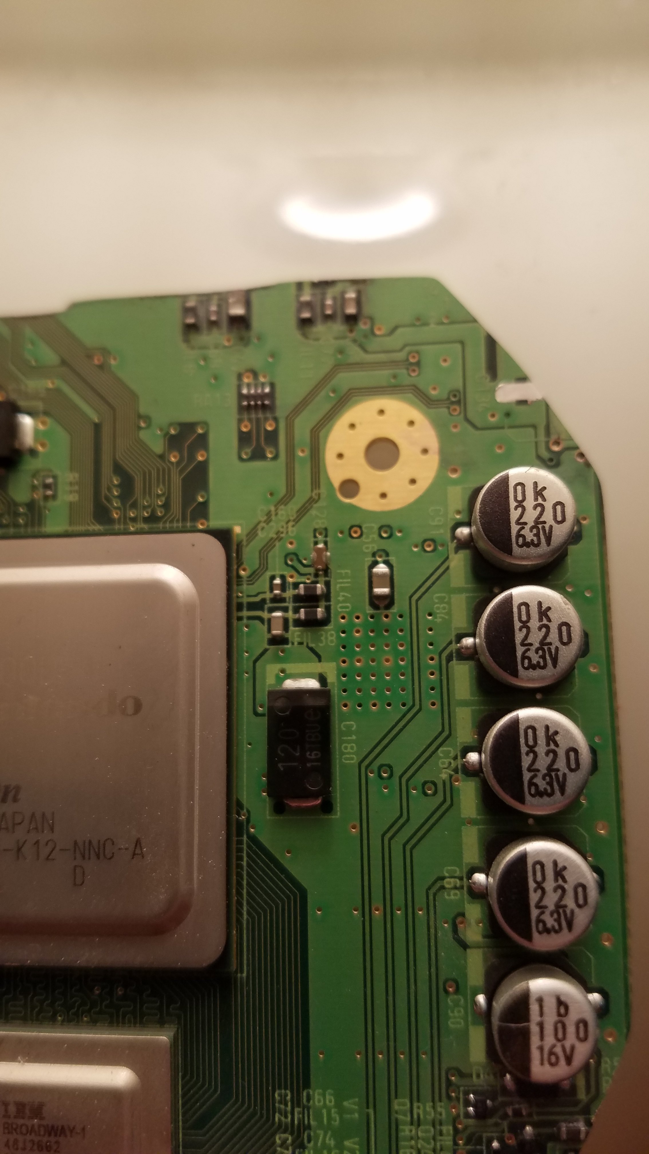

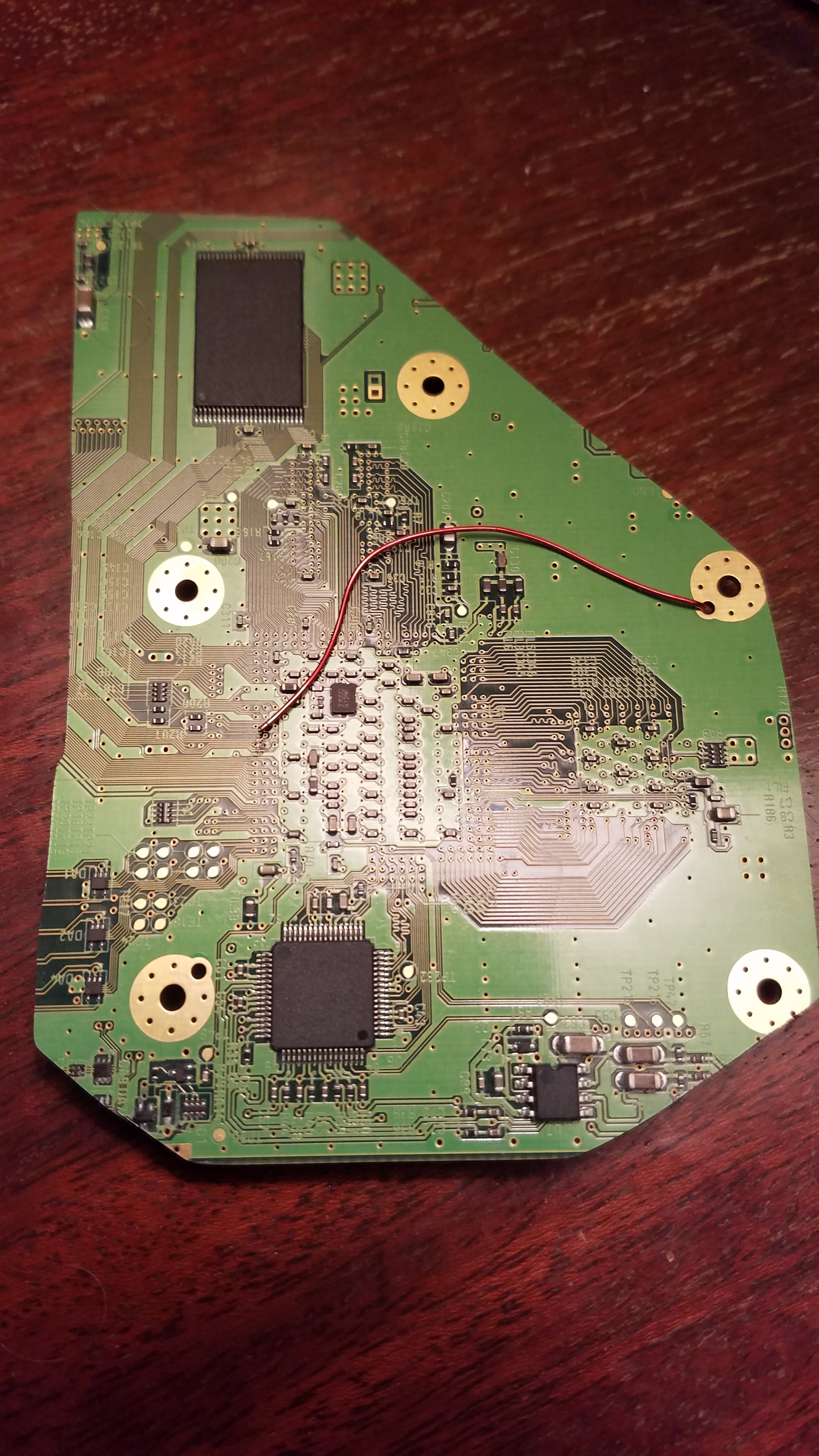

Trim looks good! Just be sure to sand the edges of the board with 220, 320, 400, 600 and 800 grit sandpaper and then checking the resistances between the voltage lines (see thread: https://bitbuilt.net/forums/index.php?threads/wii-trim-resistances.2602/). Also be sure to remove any bits of components that got cut through during the trim, as they could cause some wack stuff down the road.
I've got the edges sanded nice and smooth, no bridges. Resistances checked good, except I've got 64ohms between the 1.15v and 1.8v. Is this alright?
Edit: Saw the updated one from Wesk, he had 66 so I'm good. Onward!
