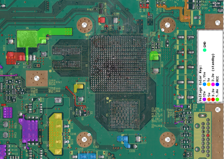

What does it mean if my multimeter doesn't read continuity on my trim?
We need a little more detail to answer that. Between what two points are you measuring? Do you mean 0 ohms or infinite ohms?
And to clarify, you need to measure resistance, not just continuity.
The charts here are very helpful, but basically only the resistance from 3v3 to GND or any other voltage needs to be more than 6k ohms.
Higher resistance means less continuity. Here's a snapshot from the Wii compendium. 12v and 5v aren't used.
I tested it on 1-1.5v with 20k omega, but my reading said 0.05. Do you know if that translates to anything?
20k ohms is the value divided by 1000. So, 0.05 = ~50ohms. Set it to a lower multiplier to get a more specific value.
The sheet says that 1.15v will have 47ohms. Is 50 close enough or does it need to be exact?
As long as the resistances aren't single digits, it's usually fine

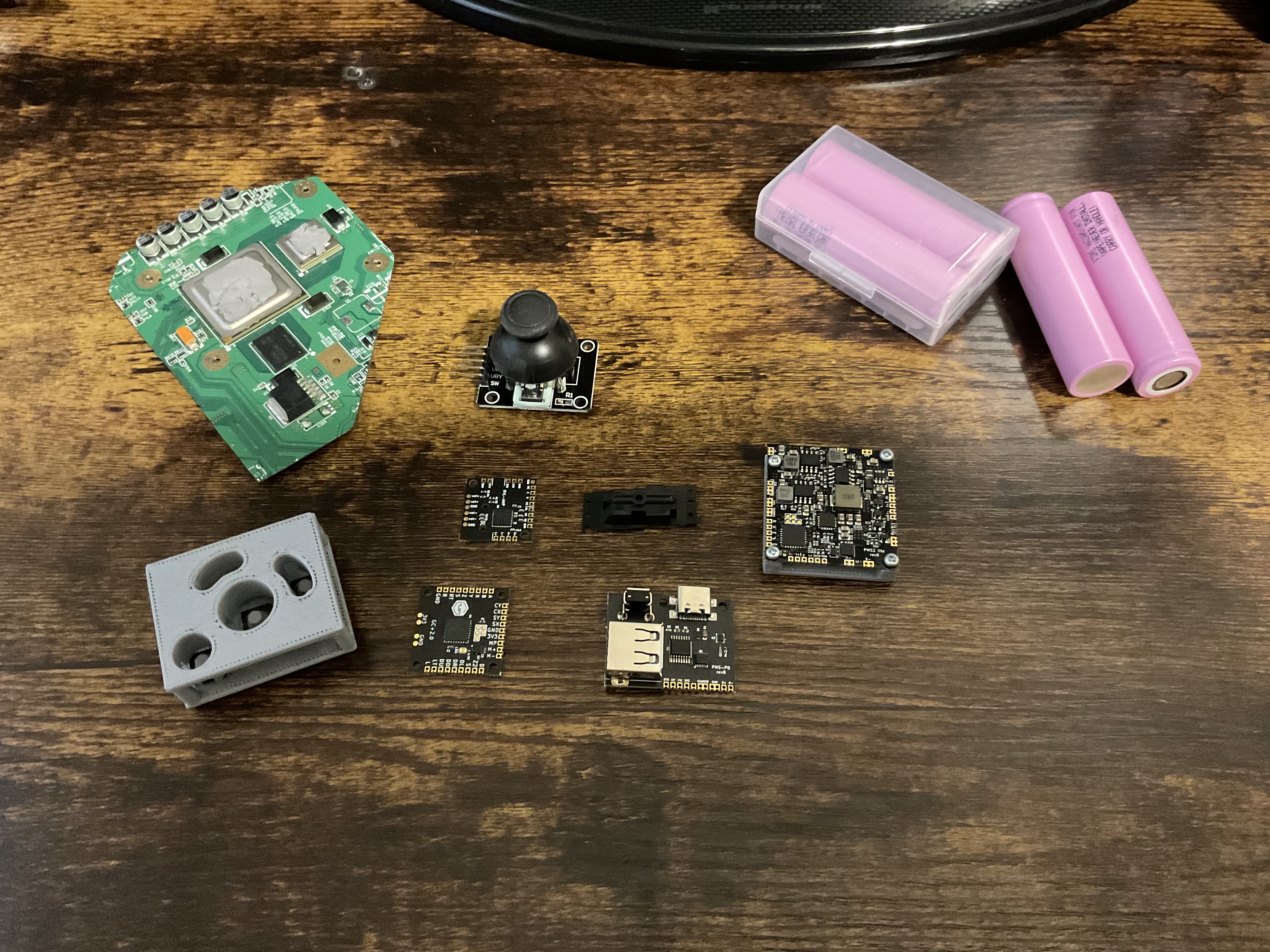

Hey everyone. Sorry for the 3 month long post drought! I couldn’t really do anything with the project until the 4 layer tech boards arrived. But good news! They’re here now! I’ve had then for about a month and have been designing mounting pieces for when they‘ll go in the case. This week, I hope to actually begin soldering. Hope to have more posts out soon!
