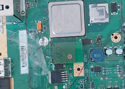

My bluetooth relocation. I used wire from an old dc motor.
pin from the u10

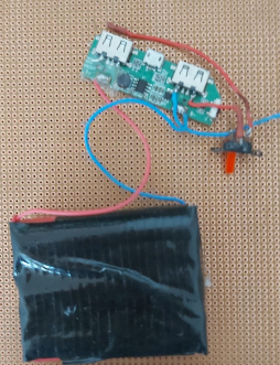

This circuit was harvested from a powerbank with a leaking lipo (that smelled good but unfortunately i had to get rid of that). Now it has 3 18650 batteries harvested from an old laptop battery (I have a lot of those so if these ever go bad, I can just replace them)

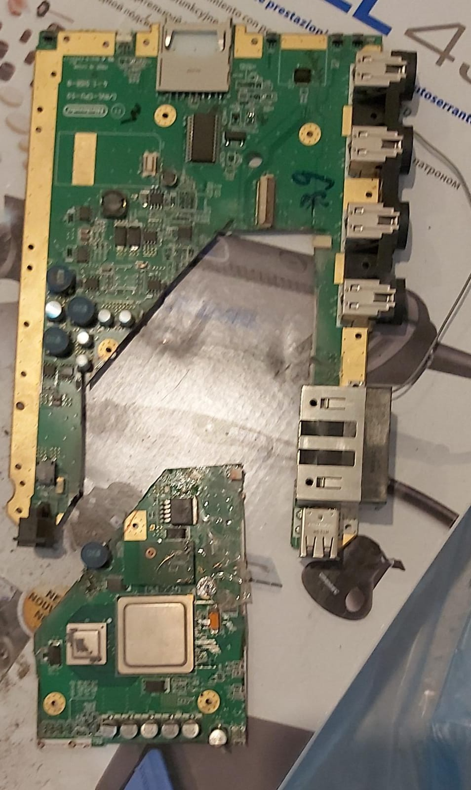

Today, I received my dremel (was a bit late) and I've trimmed the board
I don't have regulators on hand (They are being shipped from China.), so I can't test the trim but I hope it works. (The picture is from before I sanded the board, the inductor there is gone now.)
While trimming, I accidentally cut the wires going to the bluetooth module so I will resolder them.
