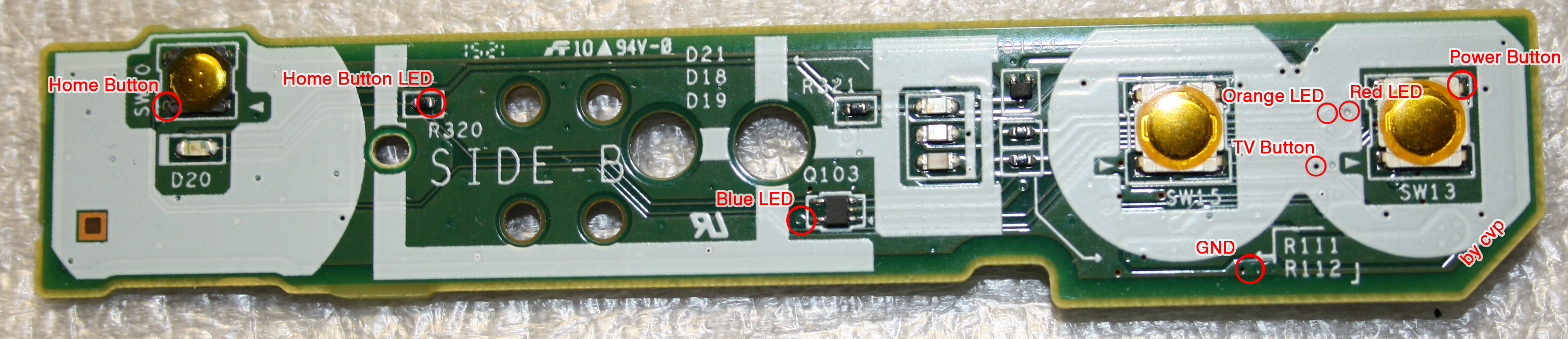

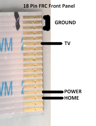

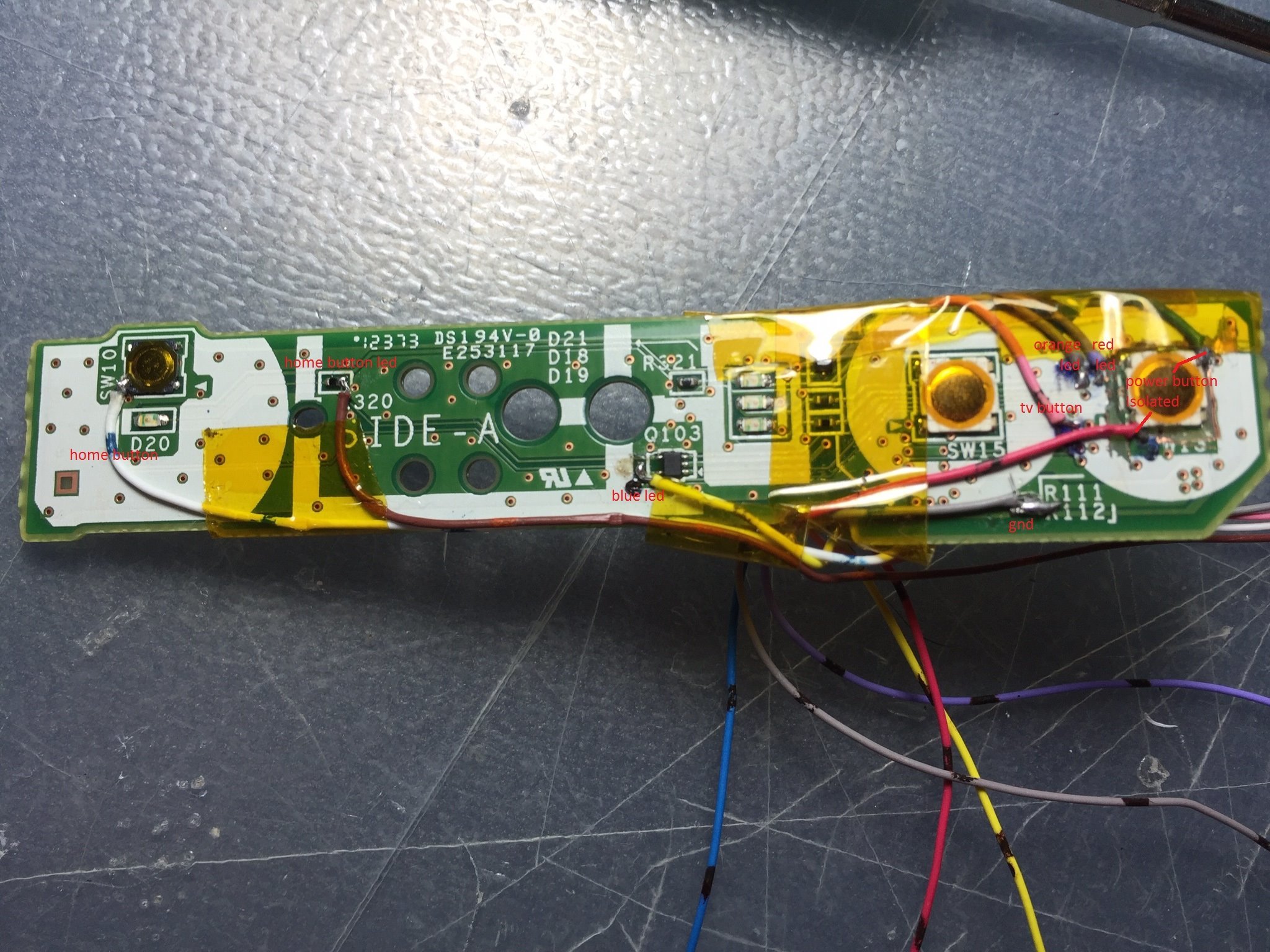

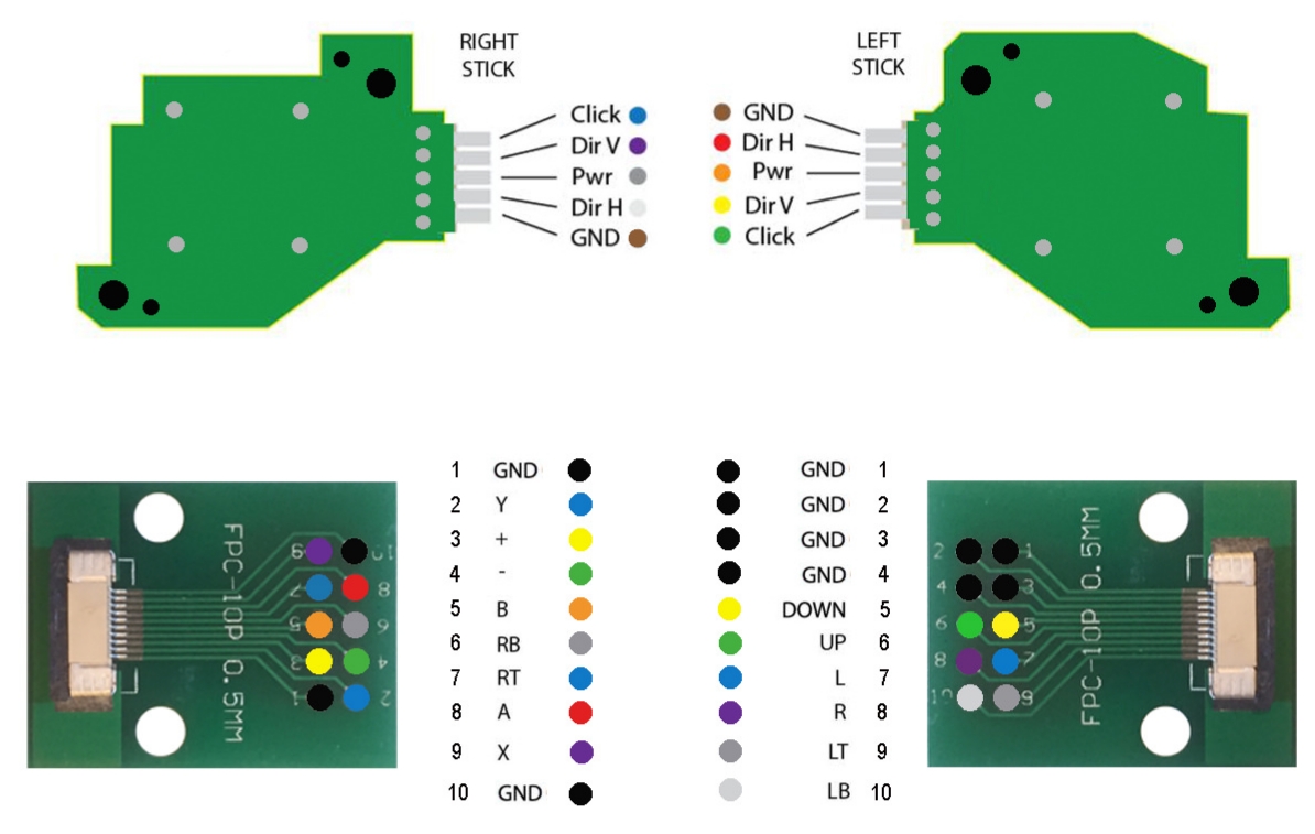

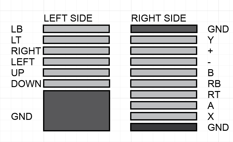

I am currently working on a wii u gamepad portable (no worklog), and hindsight it 20/20. Planning is key, especially when it is this thin (something I didn't do much of) and I am having problems now due to that (first portable for me).
I've attached some helpful materials if you are planning to go through with this though.
