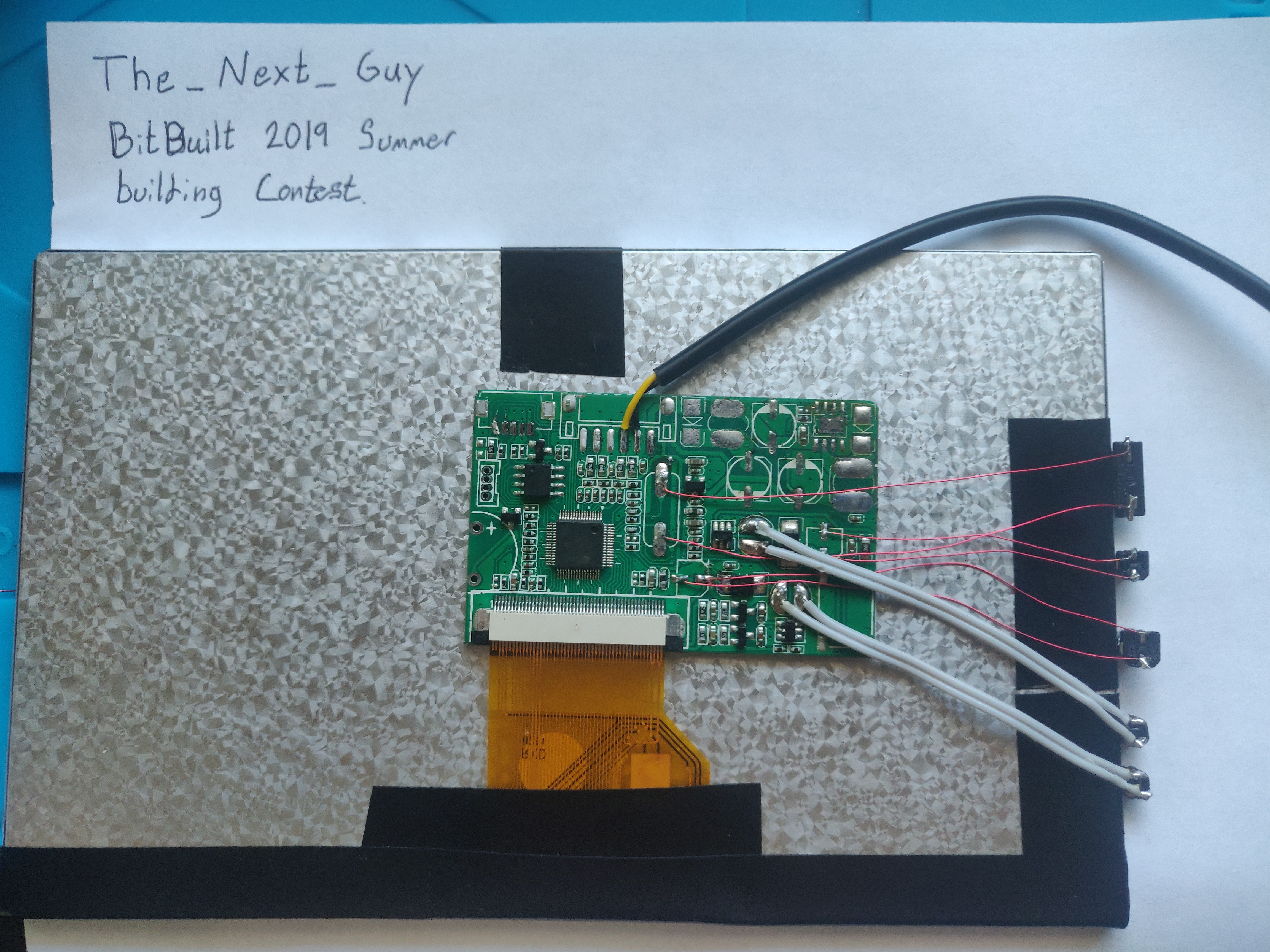

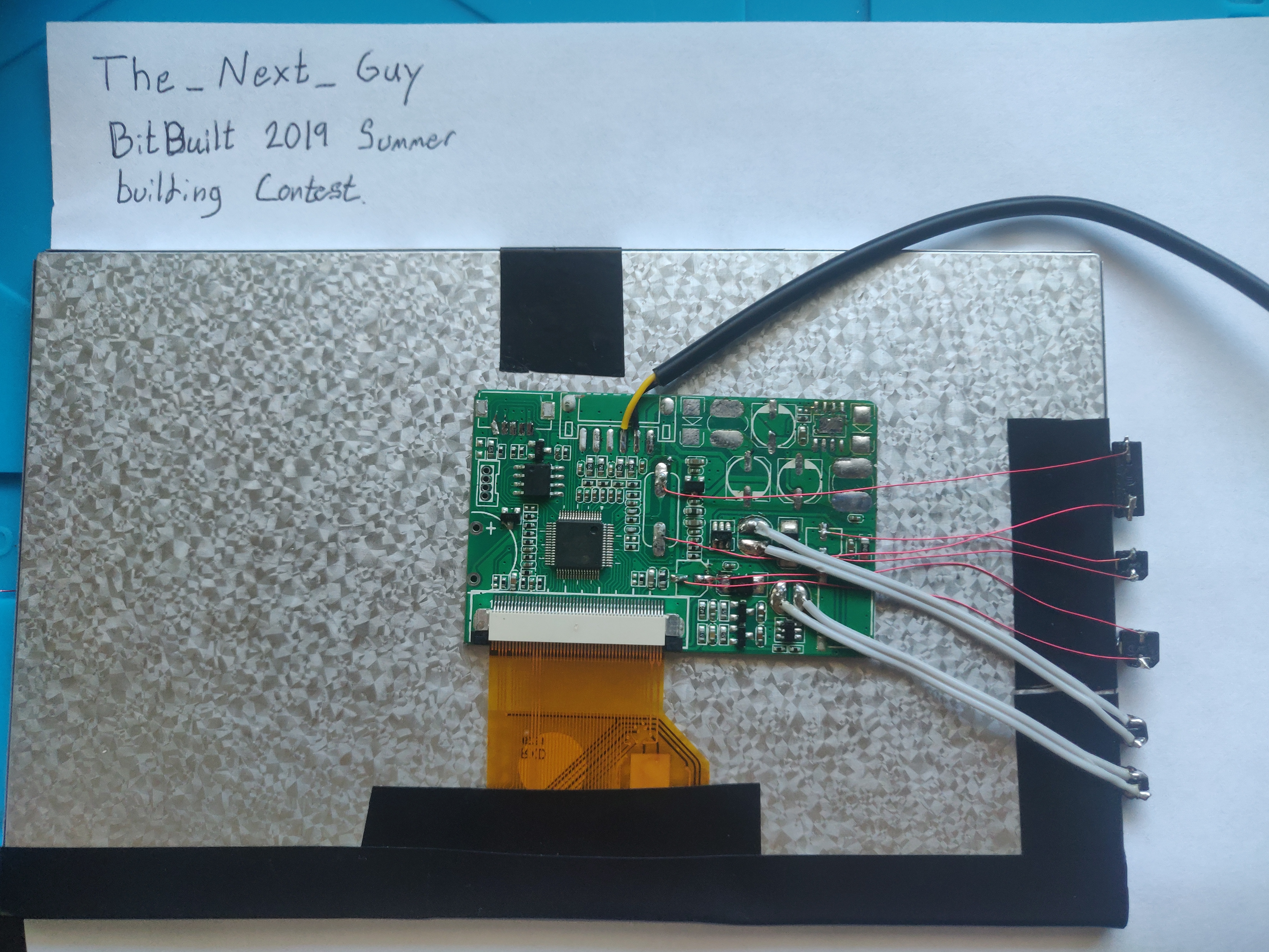

Finally got some progress. I bought this display from amazon. Its 7 inches, not 10 but it was very easy to slim down and to identify which components I could remove/relocate. I got the total thickness down to 6 mm, testing it along the way to make sure it still turned on and functioned. It runs off 3.3v reliably, but i'll probably run it off of 5v as this works too.
The case is currently printing. The total thickness I'm going for is 25 mm, not too thick but big enough for batteries. More updates to follow.
