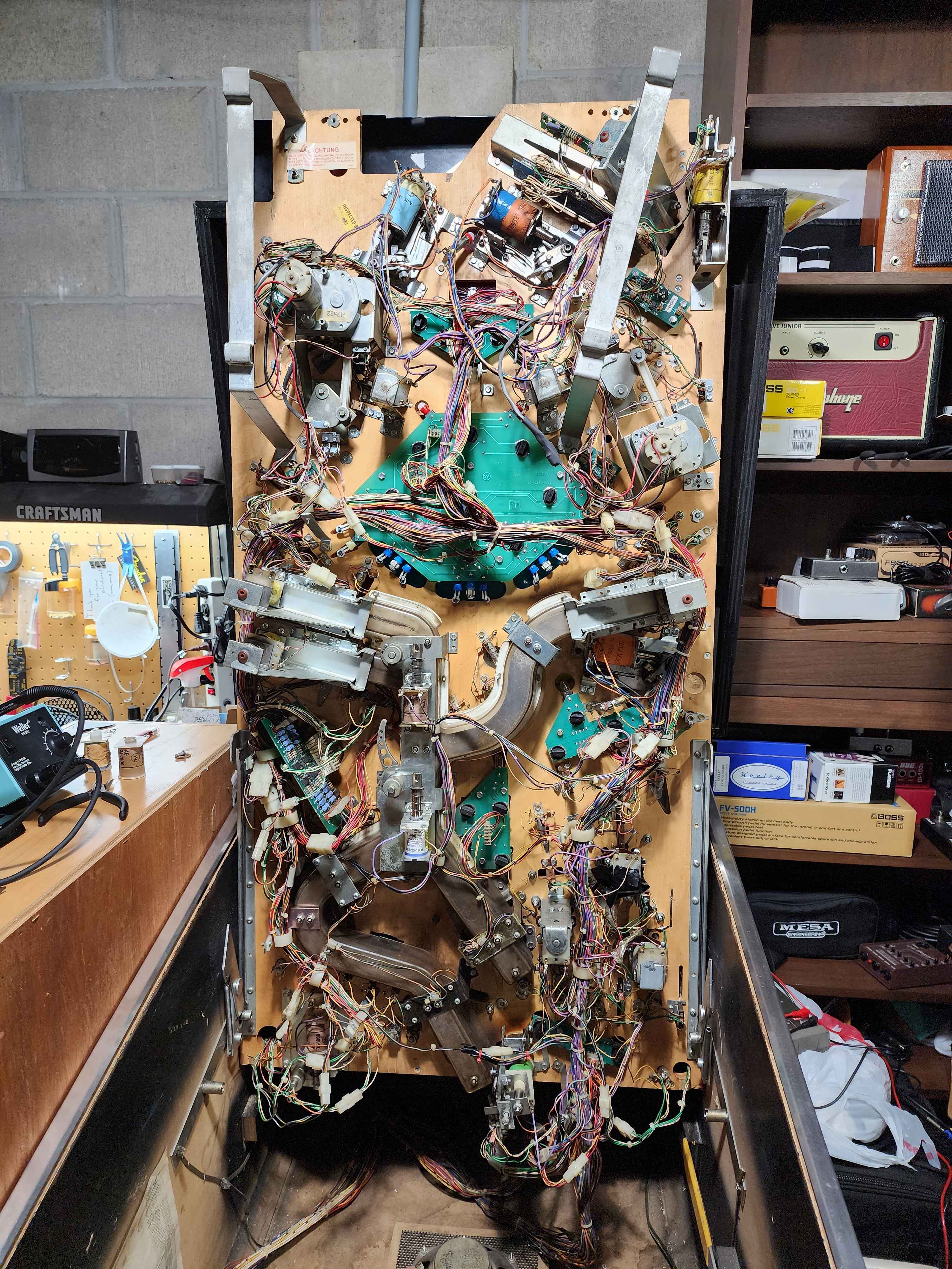

One day, it went to stage the balls, but it just kept sending one ball to the top of the playfield and into the subway system, and then the left ramp VUK would pop the ball out and let it drain back into the ball trough at the bottom. It would do this over and over, indefinitely (and it would not let you start a game). After some quick research and learning about the ball-staging process, I learned that there are two coils within the subway system that control little diverter arms, which in-turn route the ball to whichever VUK the system wants it to go to. By default, without either of those coils engaged, the ball will go to the VUK below the left wire ramp. Having some evidence that the diverter coil to route the ball to the right cannon VUK had failed, I pulled off the glass and lifted the playfield:

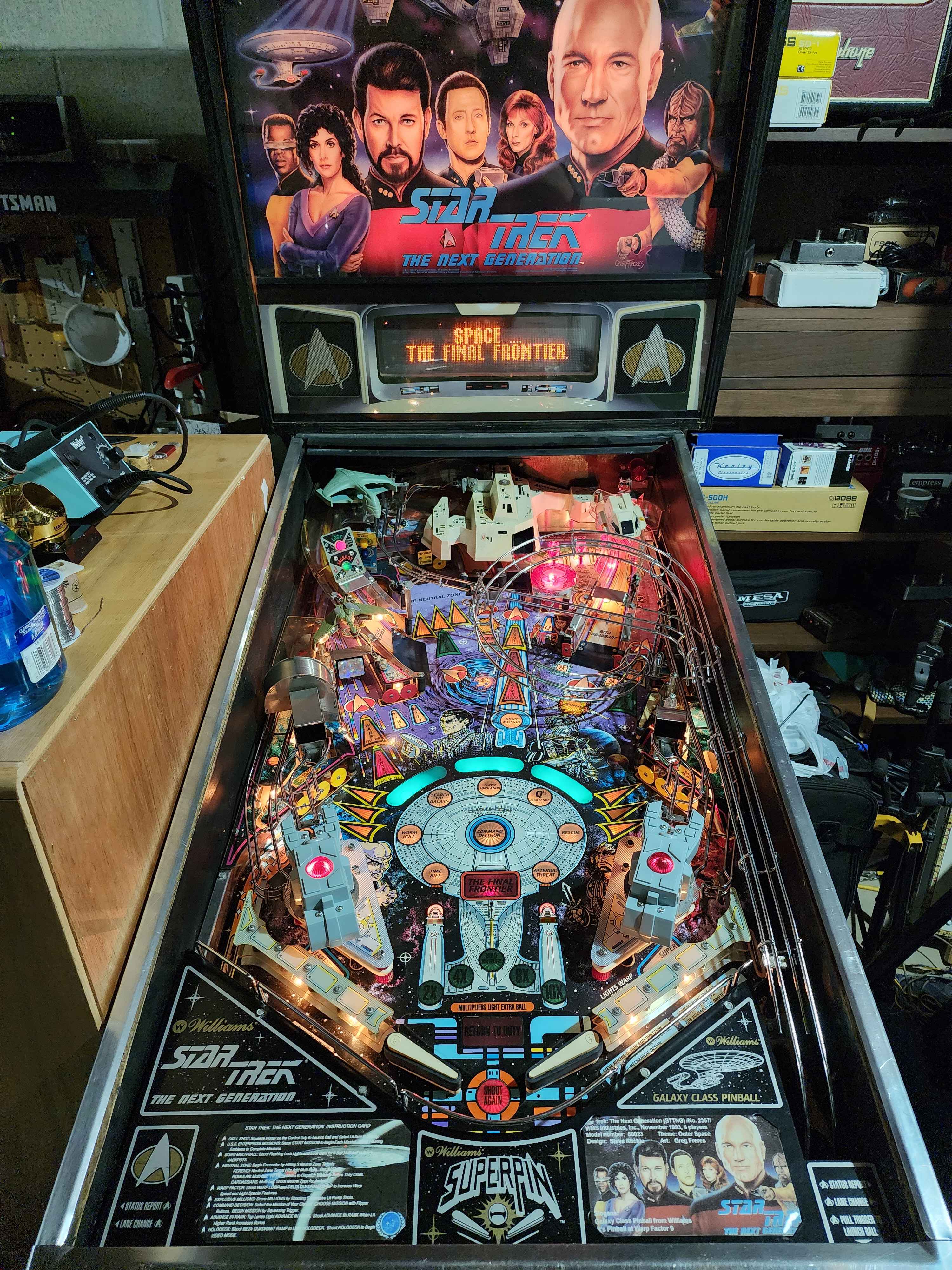

Between you and me, this picture was taken significantly later, but I didn't take a pic of the playfield before I started working on it....

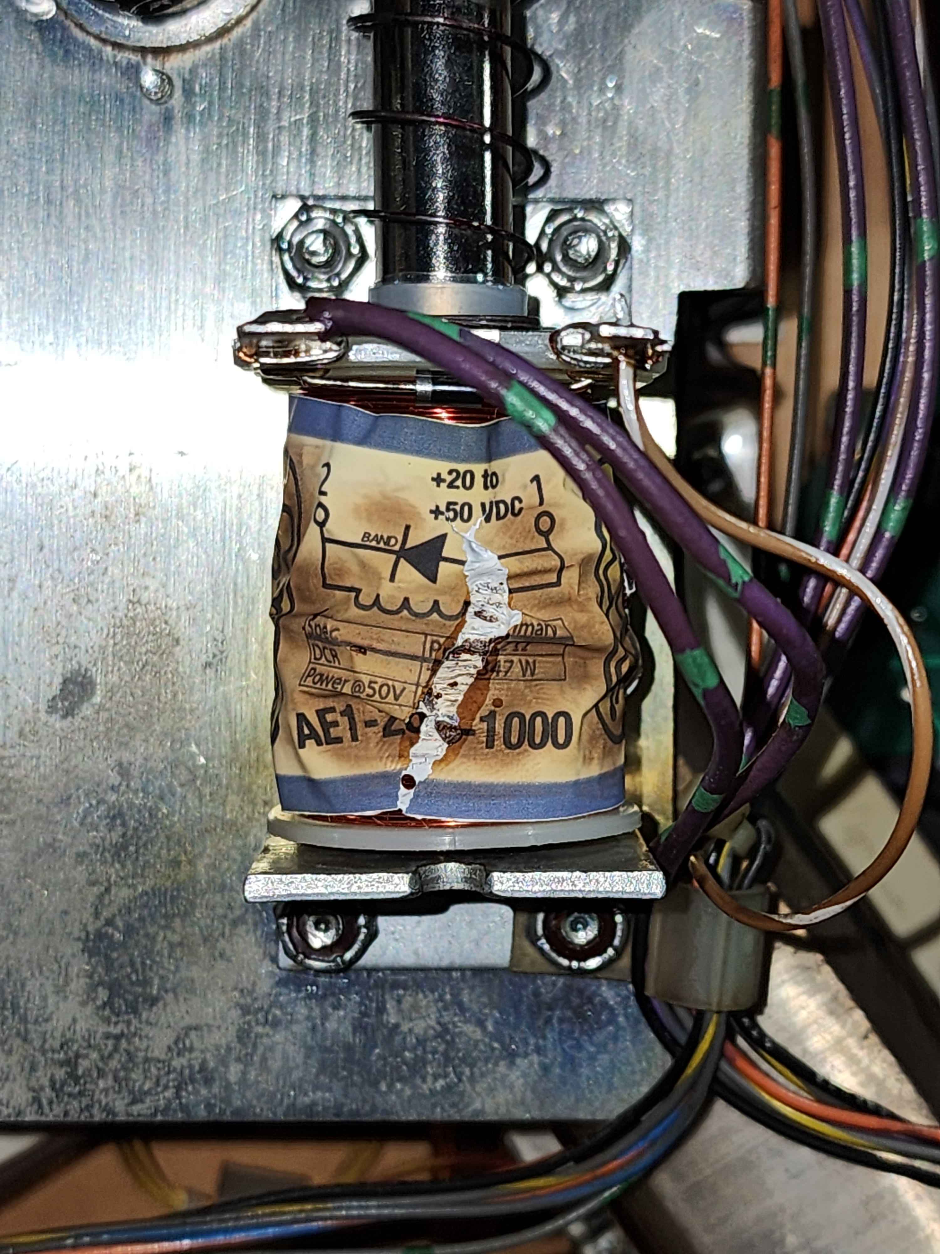

On the lower half of the playfield here (technically the upper half since it's upside down, but I'll stick with what makes sense staring at it), you can see the subway system and the two diverter coils attached in the center. Notice how the bottom one looks nice and new? Well it didn't used to look like that. It looked like THIS:

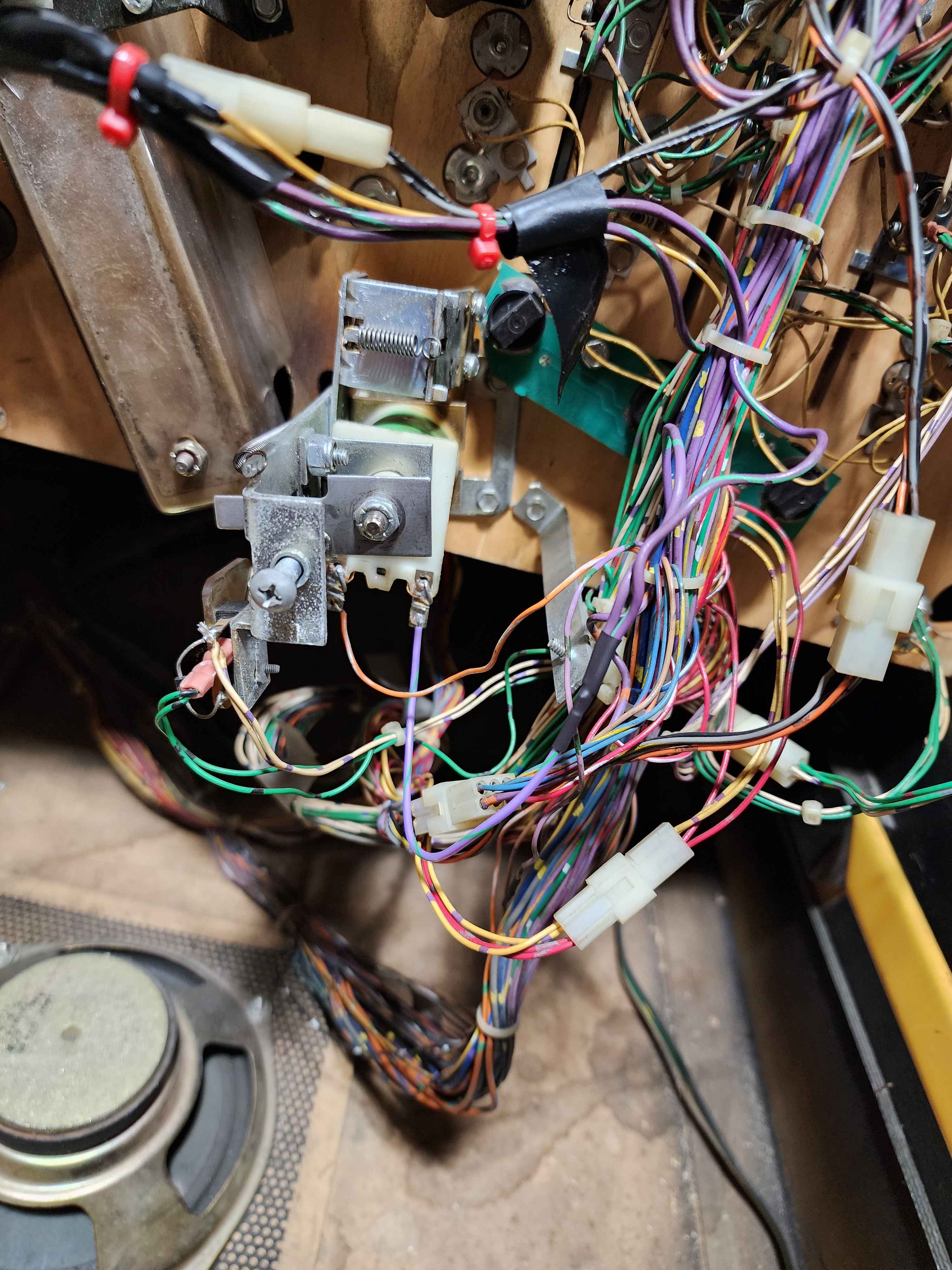

Toasty! Clearly the coil was no good, and the diverter arm could not move at all! Unfortunately, the machine sat in this state for almost two years while other projects took precedence, but with my break from work, I decided to get back into it. I swapped out the coil for a new one and turned the machine on and....... same behavior. It would throw a ball up to the top of the playfield and into the subway system, then spit it out the left wire ramp VUK. I didn't even hear the coil try to engage, so my next thought was a power issue. Reading through the manual, I found the circuit that supplies 50V to these coils and wouldn't you know it, there was a blown fuse. Thinking I had fixed the root cause of the blown fuse, I popped a new one in and powered the machine on. I heard the subway diverter coils fire, and the machine seemed to successfully stage three balls. I wanted to go into the switch test menu to check where all of the balls were to make sure, when magic smoke started coming from the playfield! I quickly turned the machine off, unplugged it from the wall, and lifted the playfield. Wouldn't you know it...

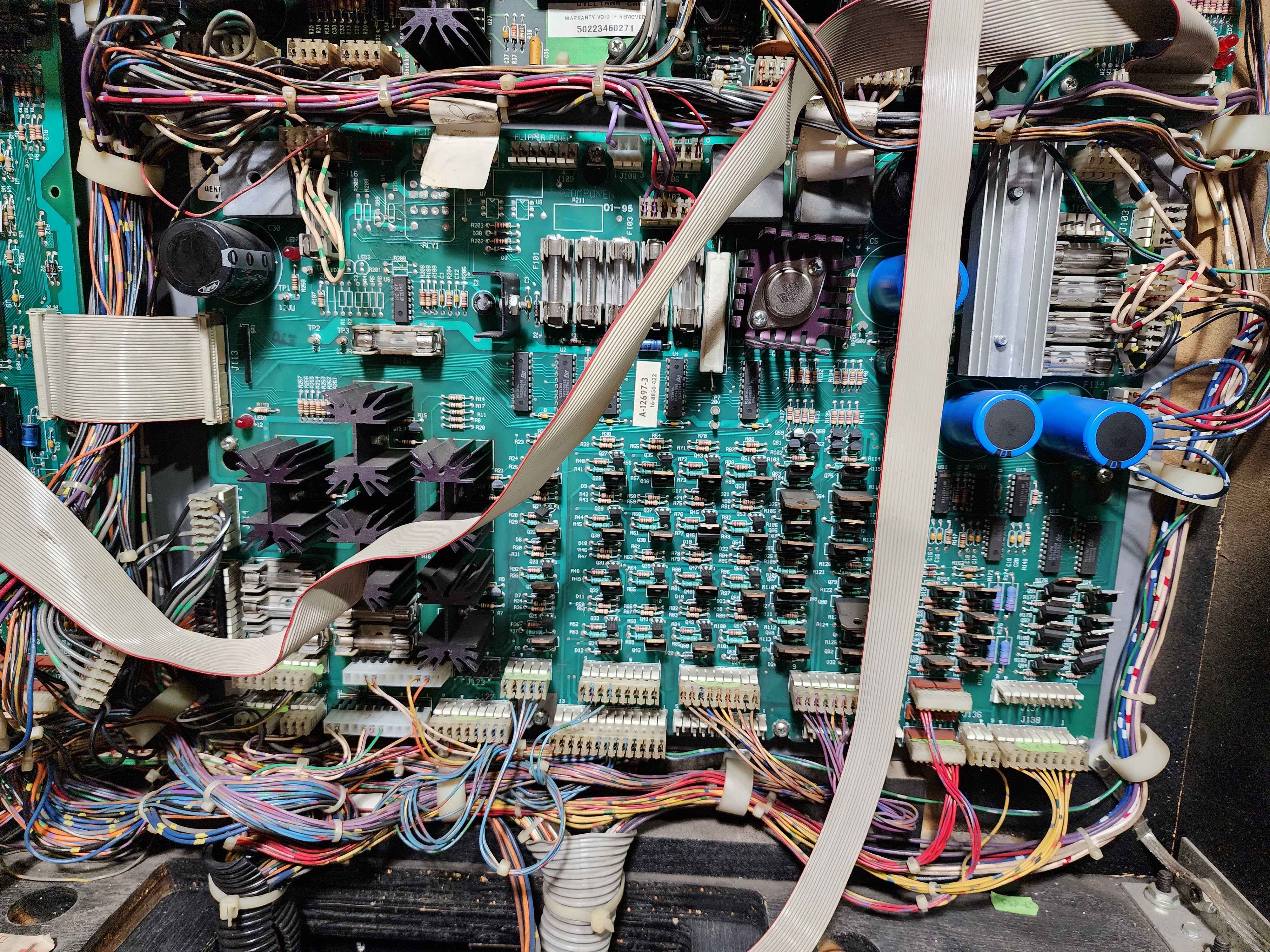

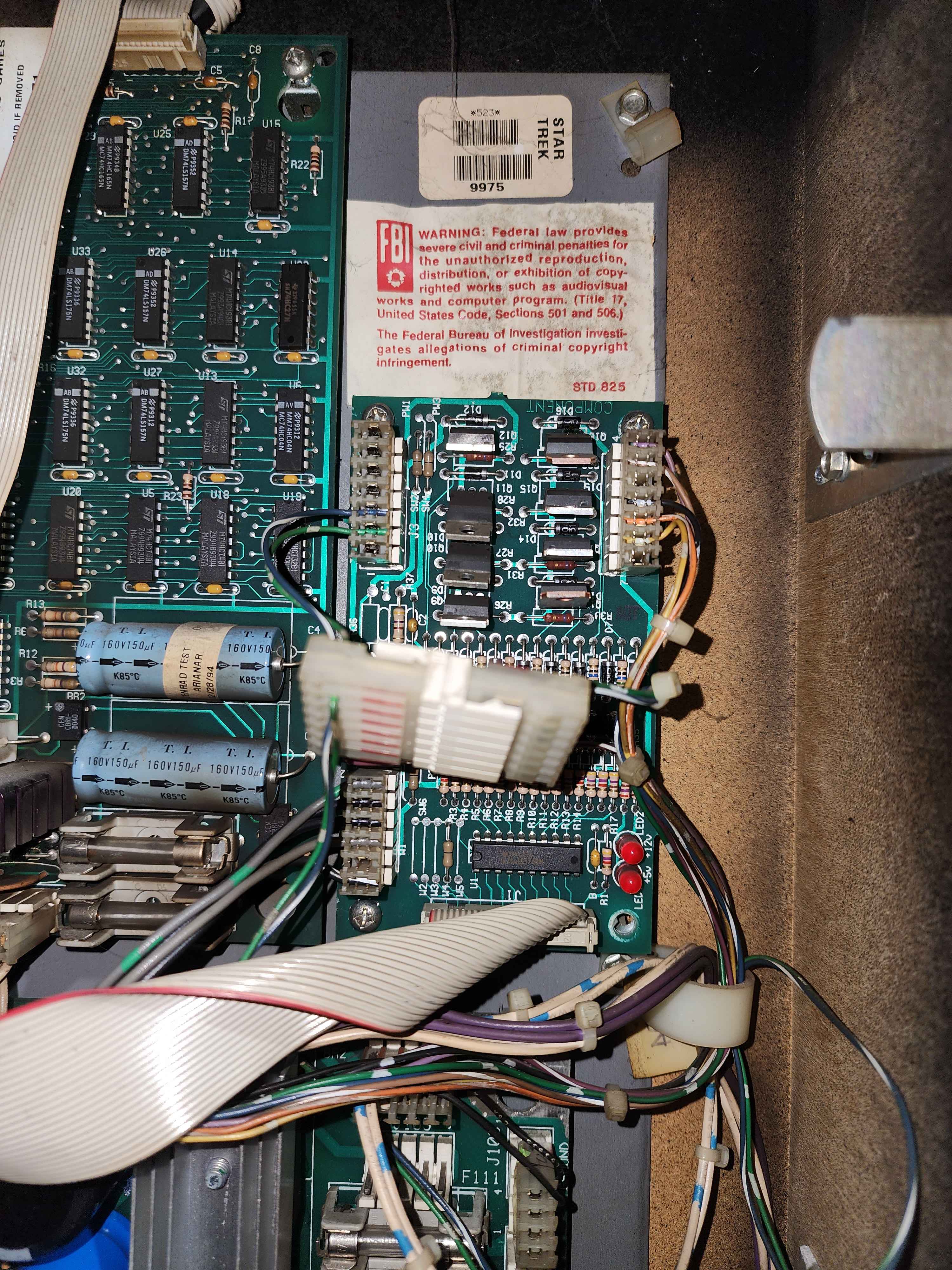

What happened? The coil locked on and stayed on (they're only designed to stay on for a couple seconds at a time), causing it to overheat and fry, which caused it to pull too much current and pop that fuse again. So what controls the coil? Well, most of the coils and lamps are driven by transistors on the main power / driver board up in the head unit, but Williams put too many darn coils and lamps in it! For the five games they did this in, the designed the "Aux8" board - basically just a copy-paste of the driver transistor footprint on the main driver board, eight whole times!
Main power / driver board:
Aux8 board:

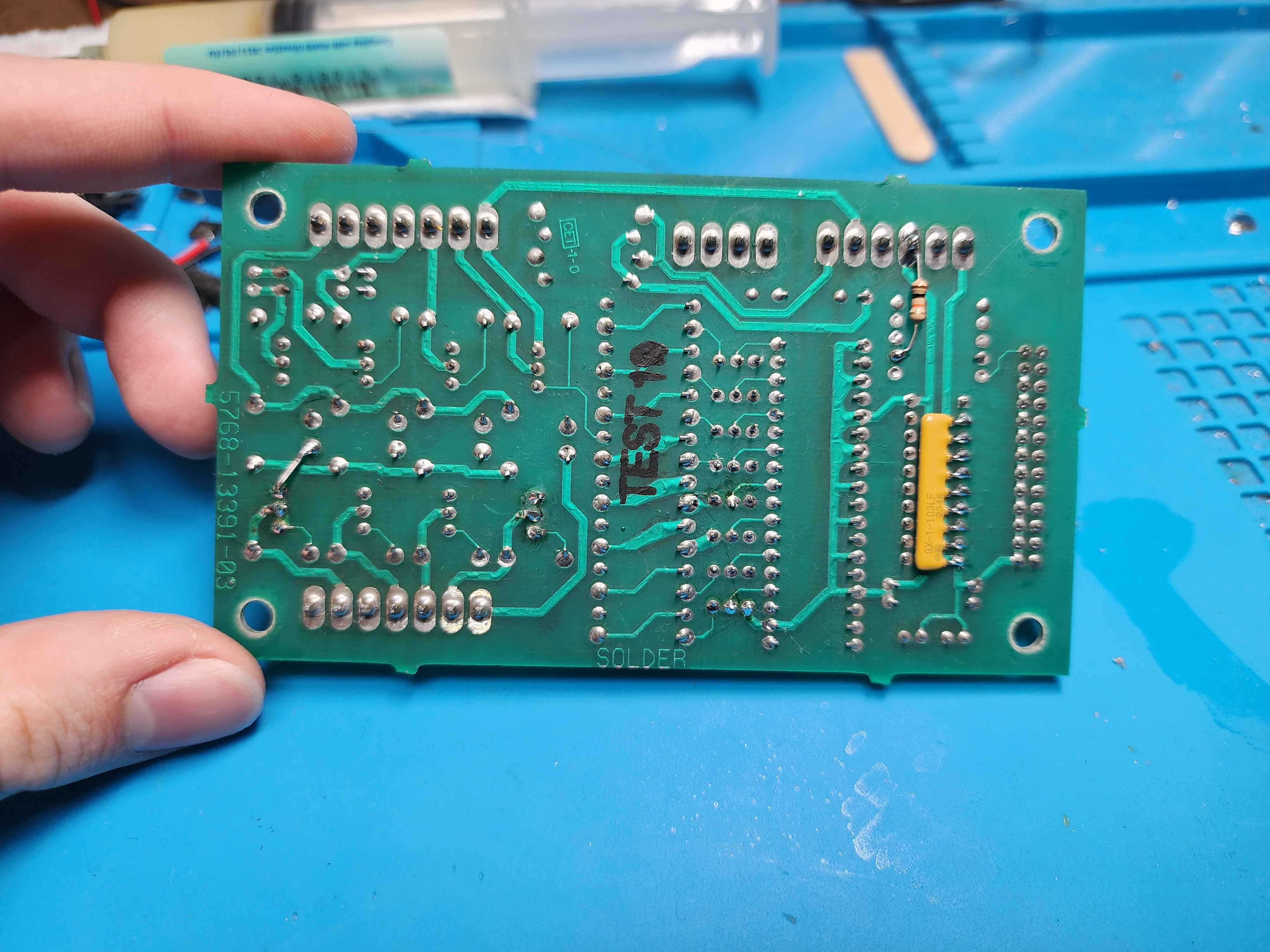

In this machine, the Aux8 board controls the two subway diverter coils, as well as the two drop-target coils. Pulling this board out, I found that the transistor that controls the subway coil that had blown was shorted, meaning that it would lock that coil on when the coil was provided power (the transistors switch ground). Even worse, it looked like that transistor (top right of the set) had already been replaced at some point, meaning this has been an issue in the past. The bottom right transistor of the set (which controls the drop-target-down coil) had also been replaced... more on that later.
I replaced the bad transistor, along with its associated pre-driver transistor for safe measure. Doing lots of forum digging on Pinside, I found that this was a very common issue on these STTNG pins, and there were multiple fault points within this circuit:
That ribbon cable at the bottom of the Aux8 board goes to the MPU board, which drives it. These output signals are left floating on the Aux8 board, which could potentially lead to an erroneous latch, causing a feedback loop that would keep the coil locked on and... well you know what happens when those coils lock on now... This issue is mitigated by bodging an array of pulldown resistors (and one pullup resistor) to the bottom of the board like so:
Off camera, I also added some fresh solder to / reflowed every joint, because why not!

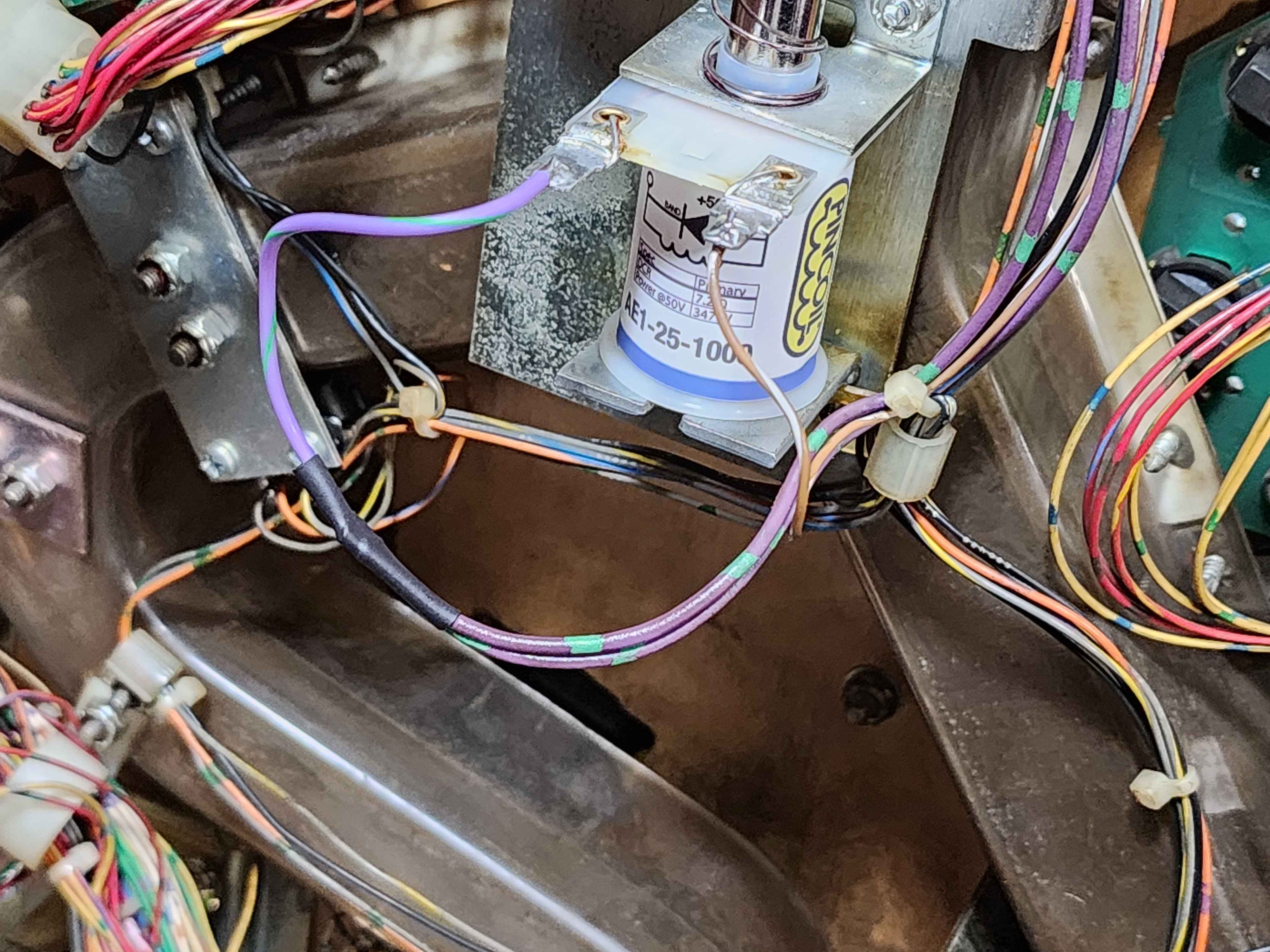

To mitigate this whole tie-back wire issue, I made up a wire to go right from the power board to the Aux8 board inside the head unit, completely separate from the daisy chain feeding the coils. For my own sanity, I also brought each point of the daisy chain down to a single wire, that way I wouldn't have to solder two stiff wires to one lug every time I had to change a coil out (which is even more awkward when you have to dive into this machine at an awkward angle):
