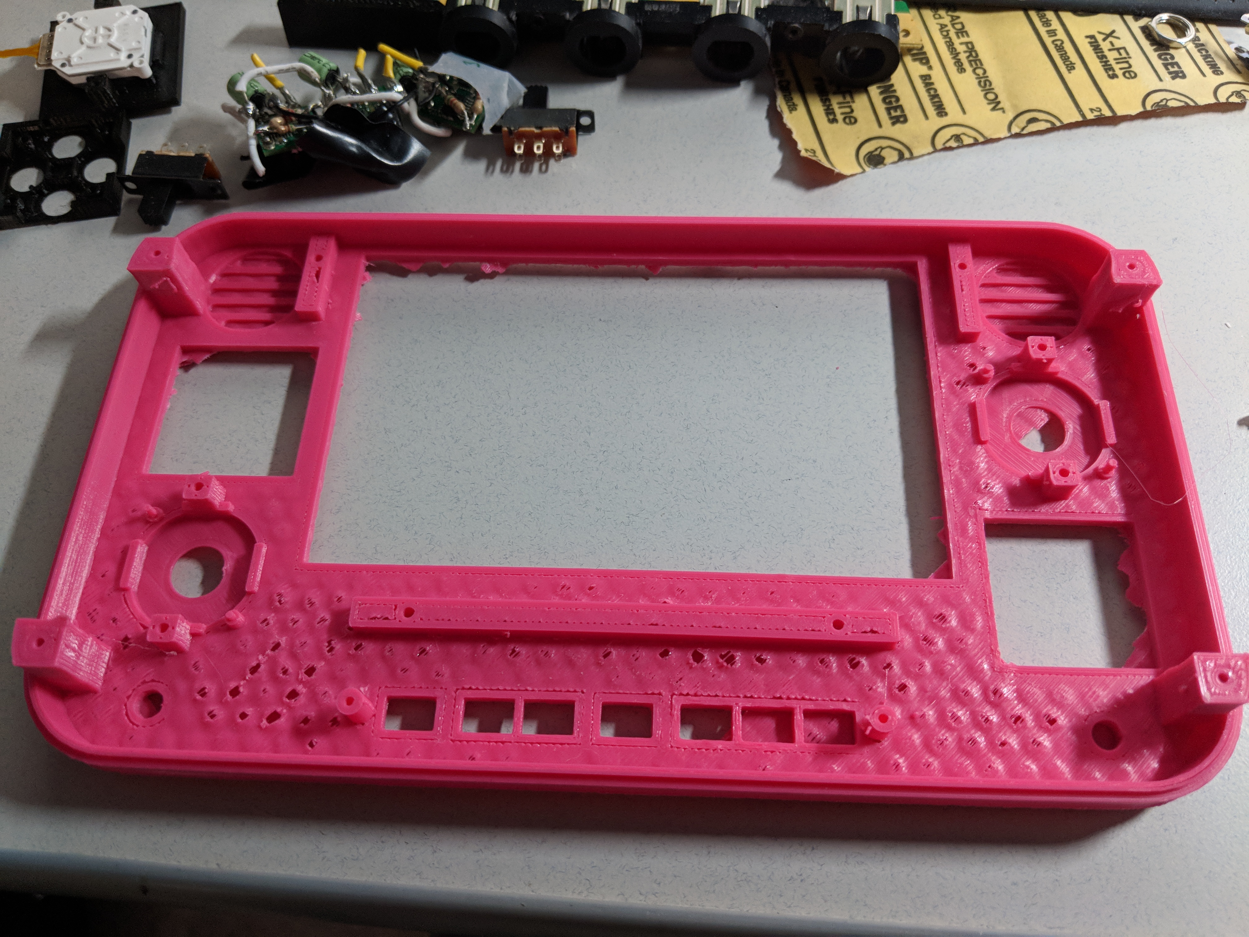

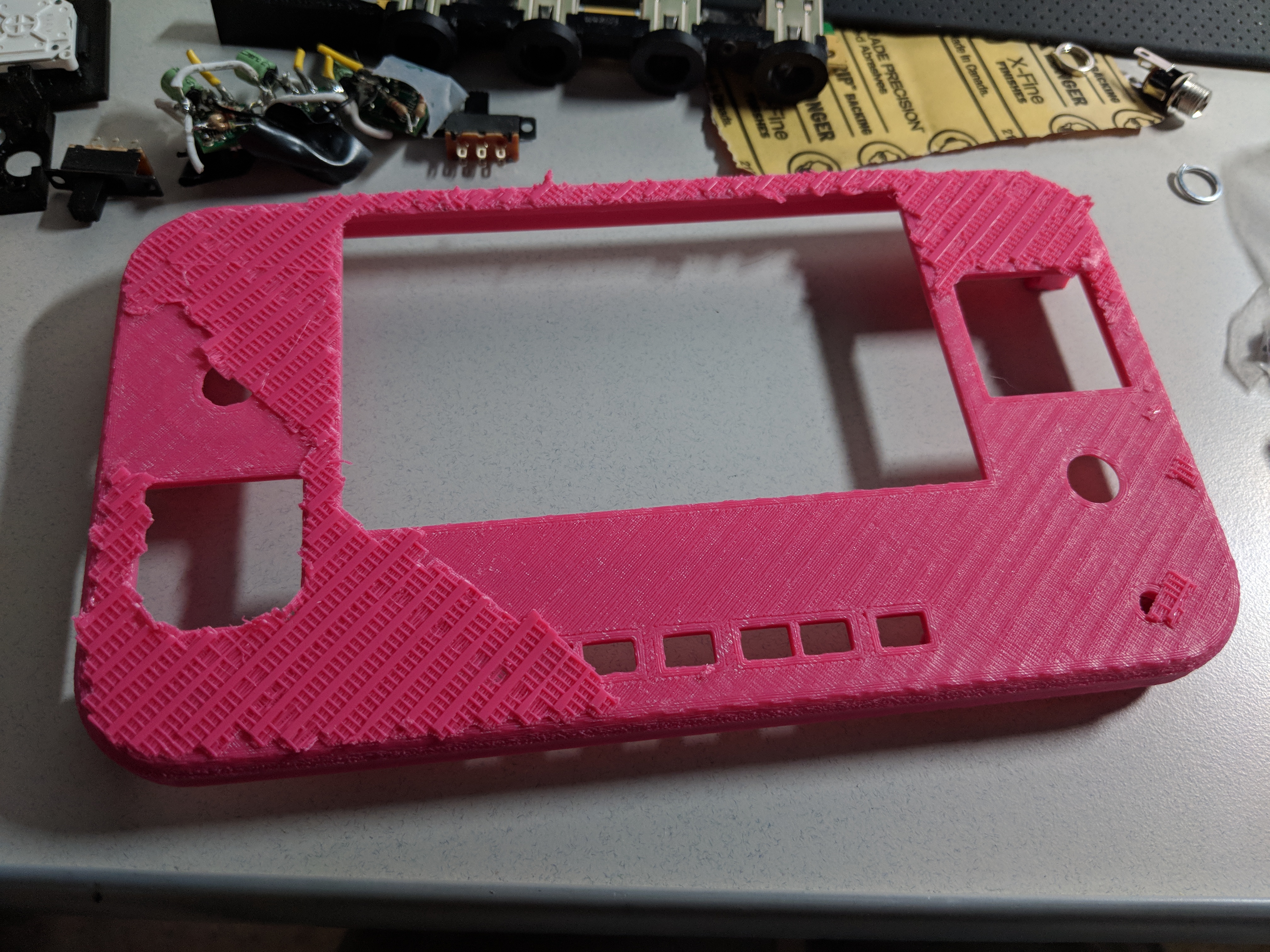

Glass handling gloves m8. They shrug off damn near everything.Small update but an exciting one. First run of the top shell came back and it looks great!
As you can see I didn't finish removing the raft but that's because halfway through using one of those print removal tools to pry off the surprisingly resilient plastic, the blade slipped and I sliced my hand open. Rookie mistake, I know. I'm going to wait for the bleeding to stop before I get back to scraping off the rest of the raft.
Ayy nice you hackerbilly'd yourselfSmall update but an exciting one. First run of the top shell came back and it looks great!
Actually if I were to guess, I'd say it has a low infill and the walls were too thin. To me, those bubbles look like a beehive style infill that is just showing. Making the walls thicker in the slicer settings might helpAyy nice you hackerbilly'd yourself
Wew that looks pretty neat for a first test print!
I wish I would just model out more shit before wasting filament on prints. The case design reminds me of Jeffs portable, it looks great.
I'd try to fix the "bubbling" (?) on the inside of your case though. I think it has something to do with either a nozzle thats too hot or a heated bed thats too hot.

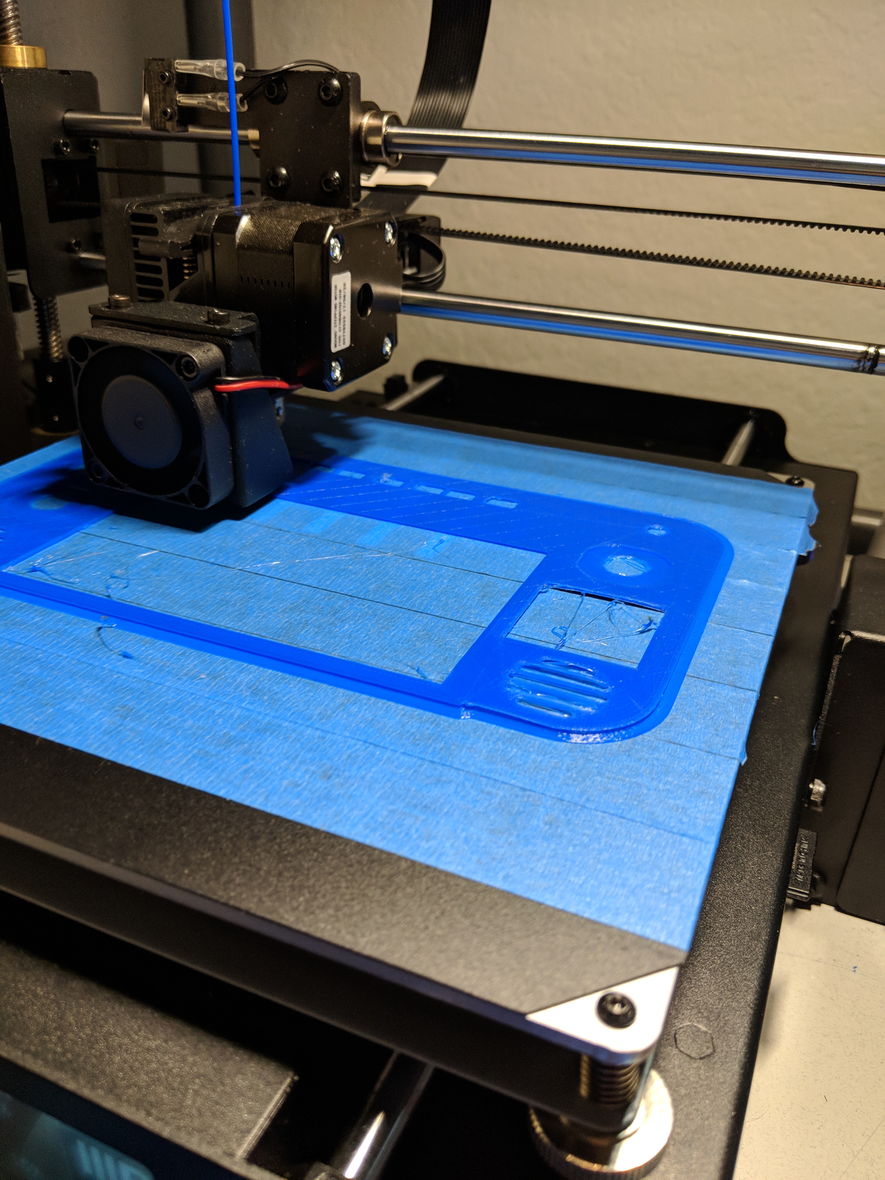

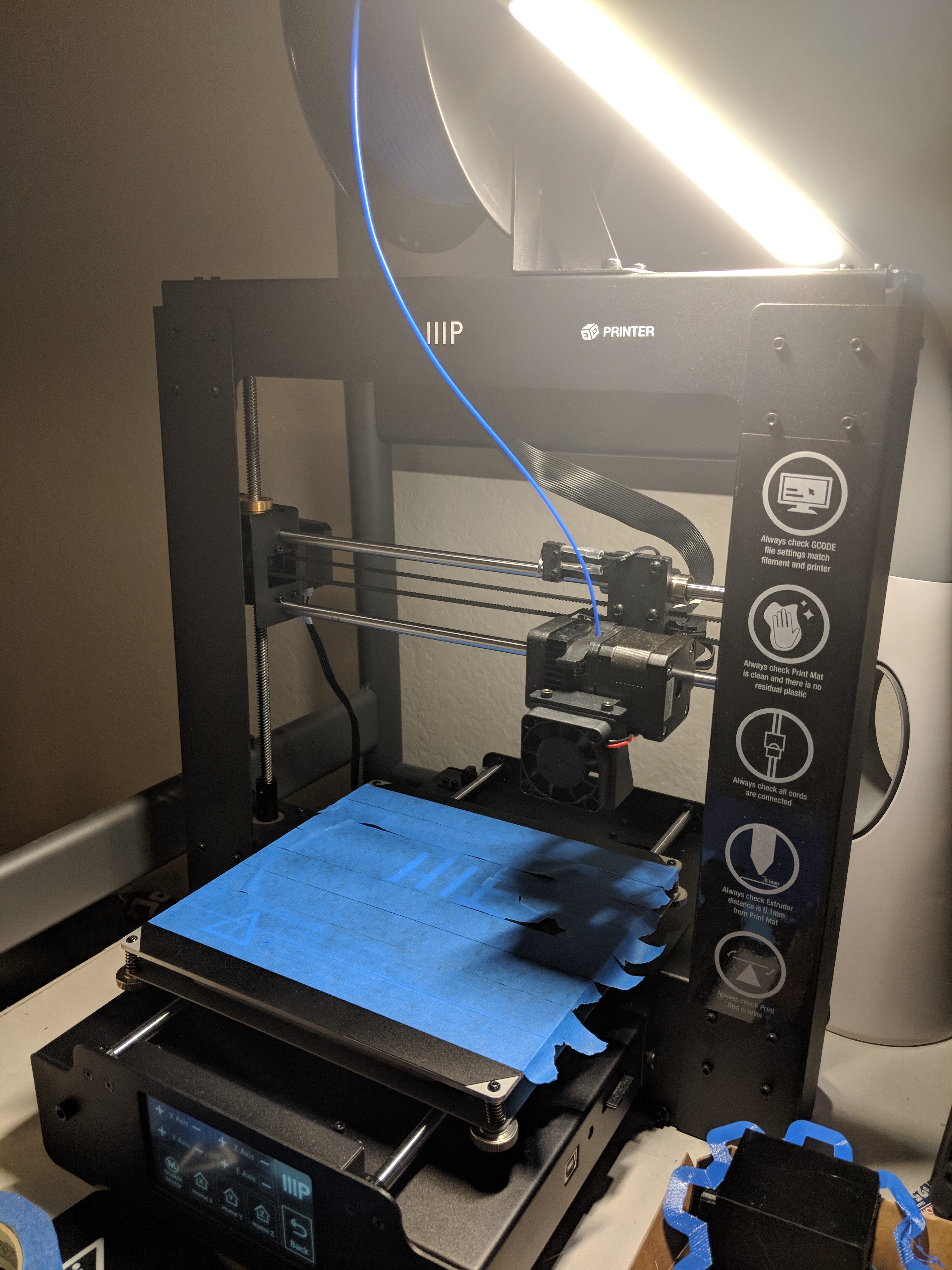

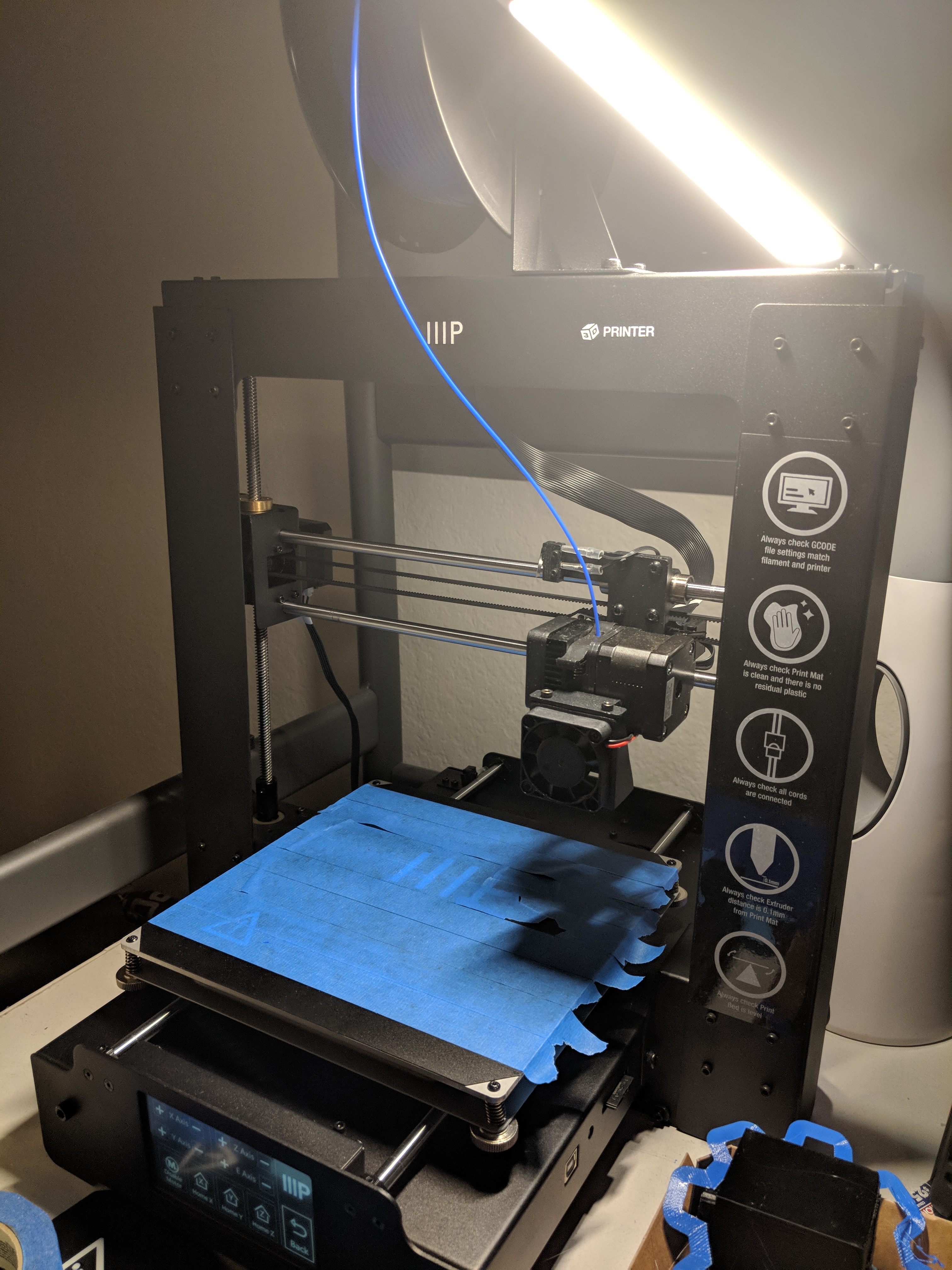

So after about a whole month and a half, progress! I just hiked this build cost by about $300 because I bought this thing: (Monoprice Maker Select Plus)

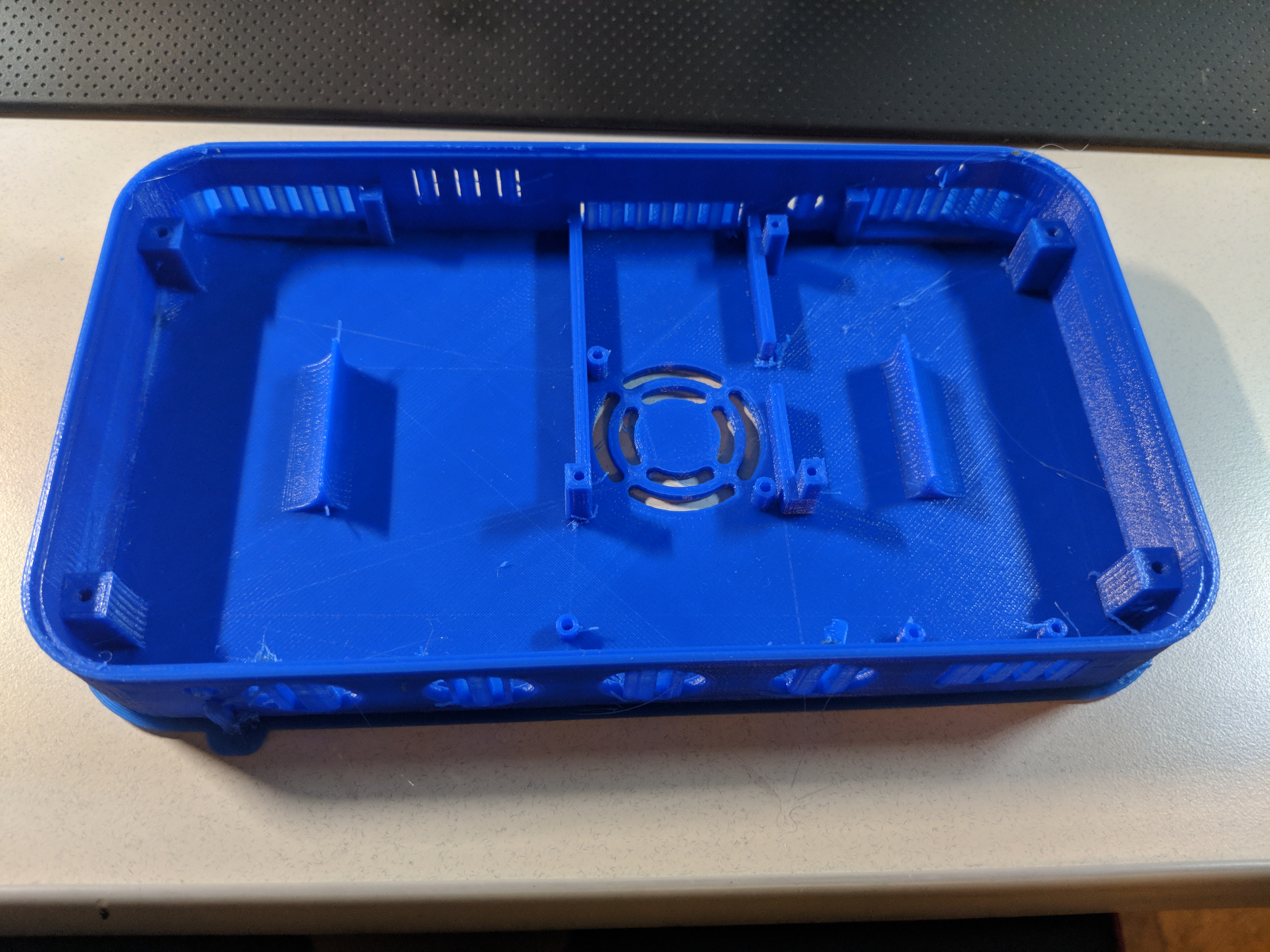

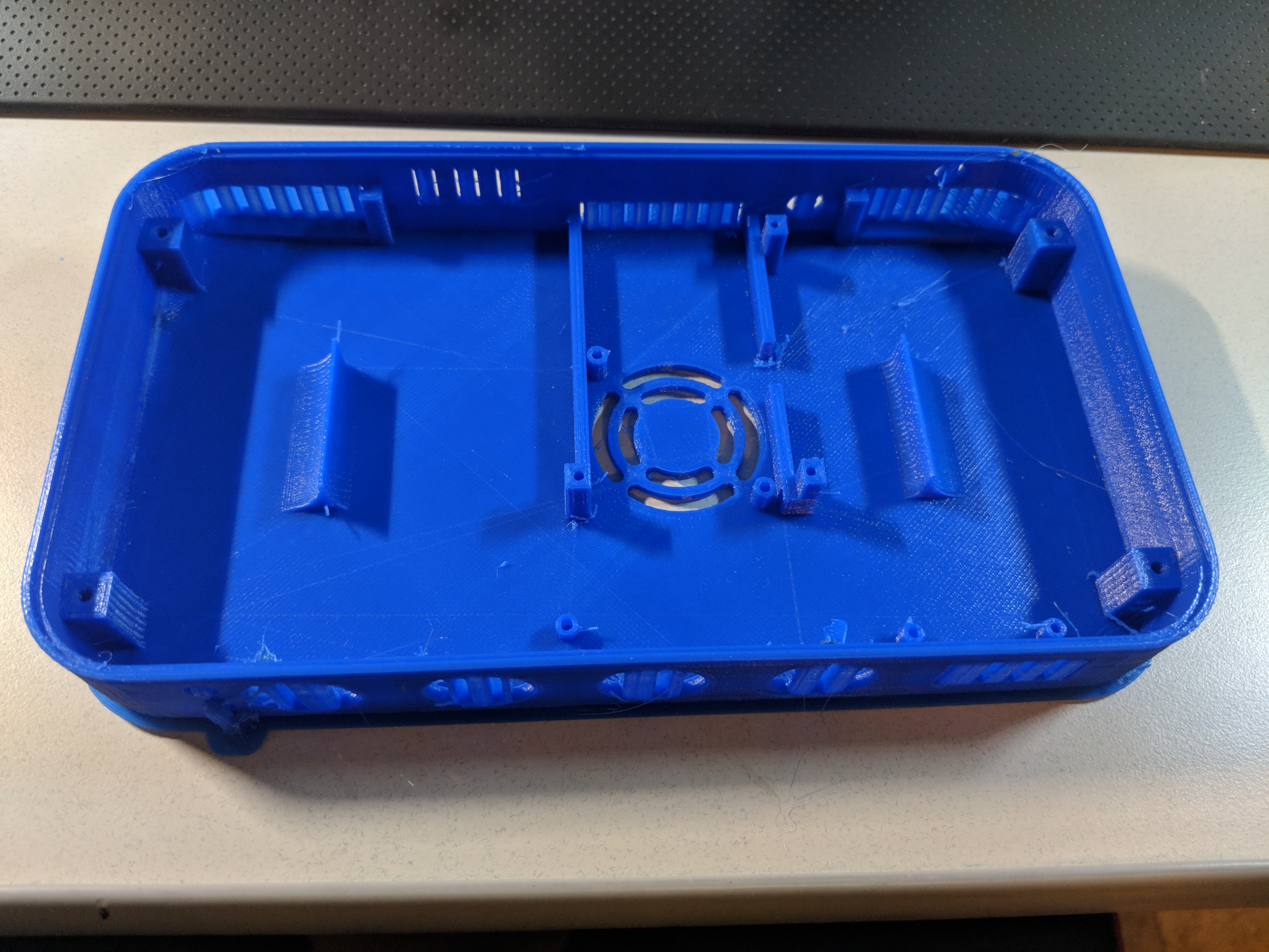

And then I used it to print this thing:

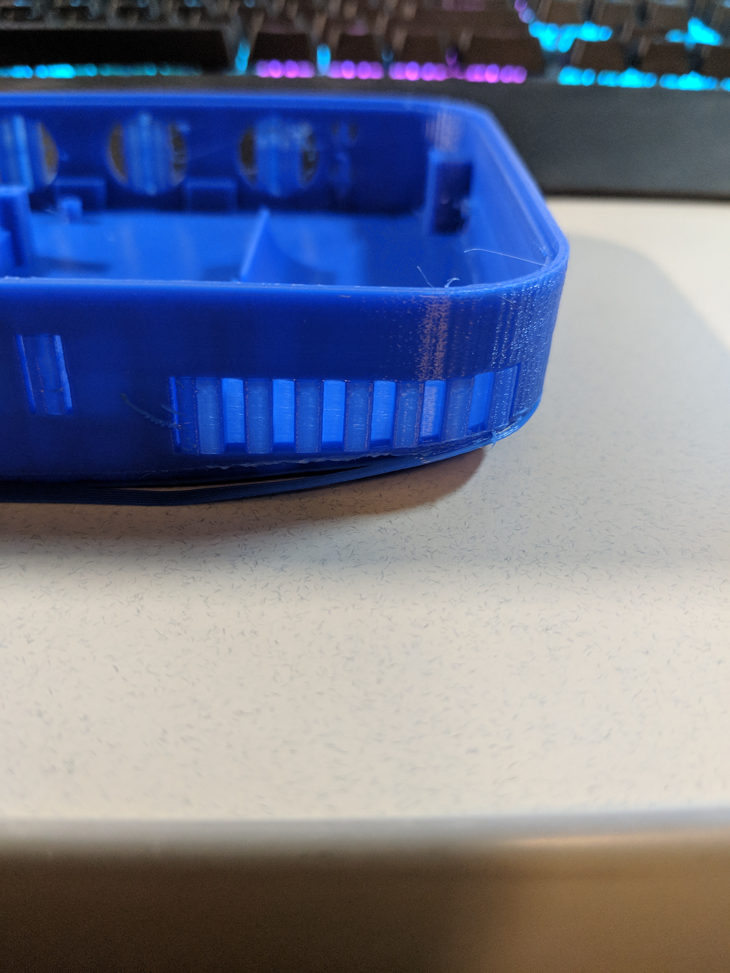

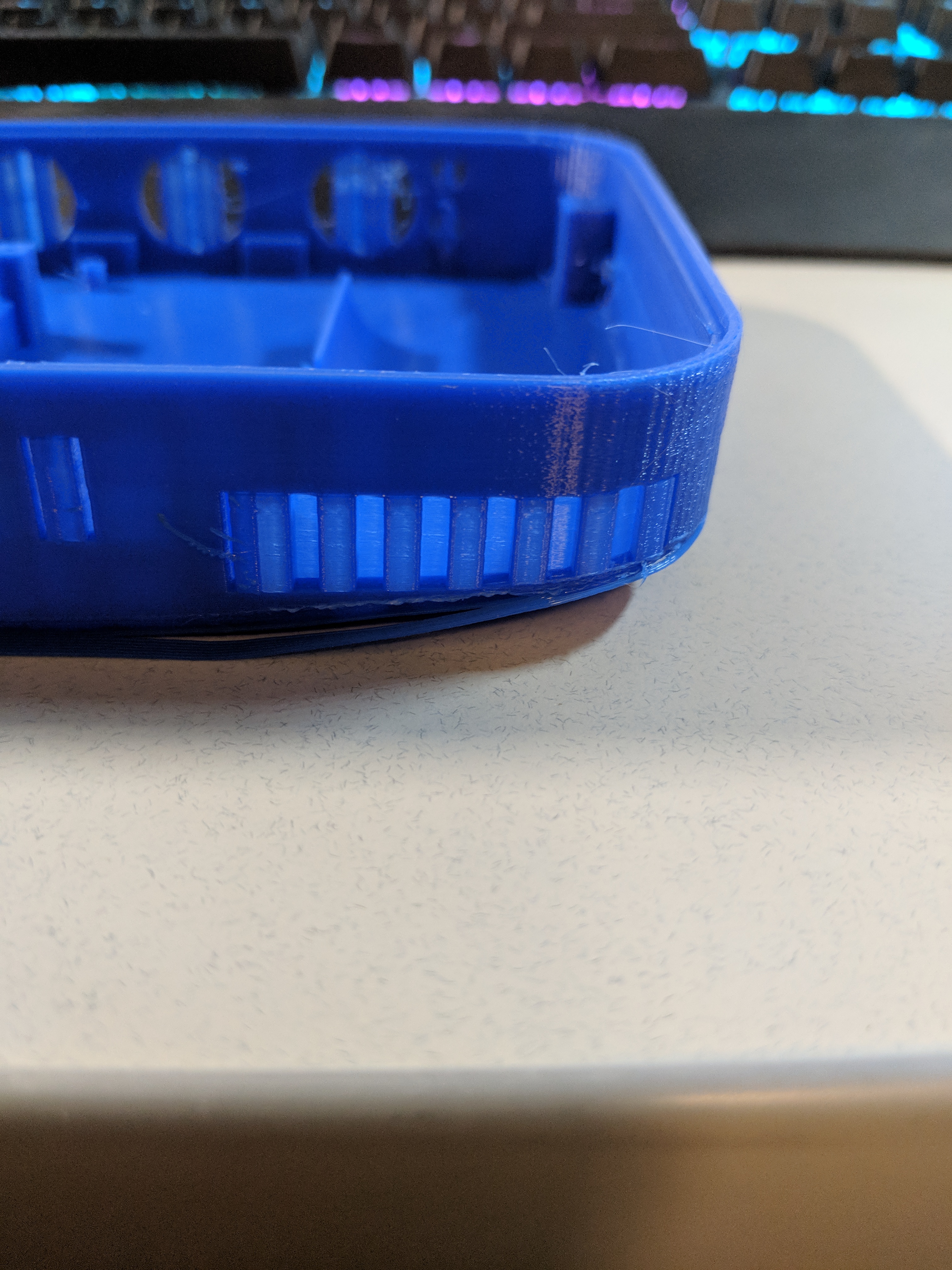

This was actually my third bottom shell revision in total, since the first one I made with my new printer curled up at one of the edges pretty badly. This second run was much more flat because I printed with a brim, but it still curled at one of the edges. It's minor enough where I don't care enough to waste another 100g of filament on a new revision, but it's still a small flaw. Any tips as to how to fix this in future prints?
For reference, I'm using Hatchbox Blue PLA, extruder temp 200C, bed temp 65C, 3mm wide brim on top of painters tape.

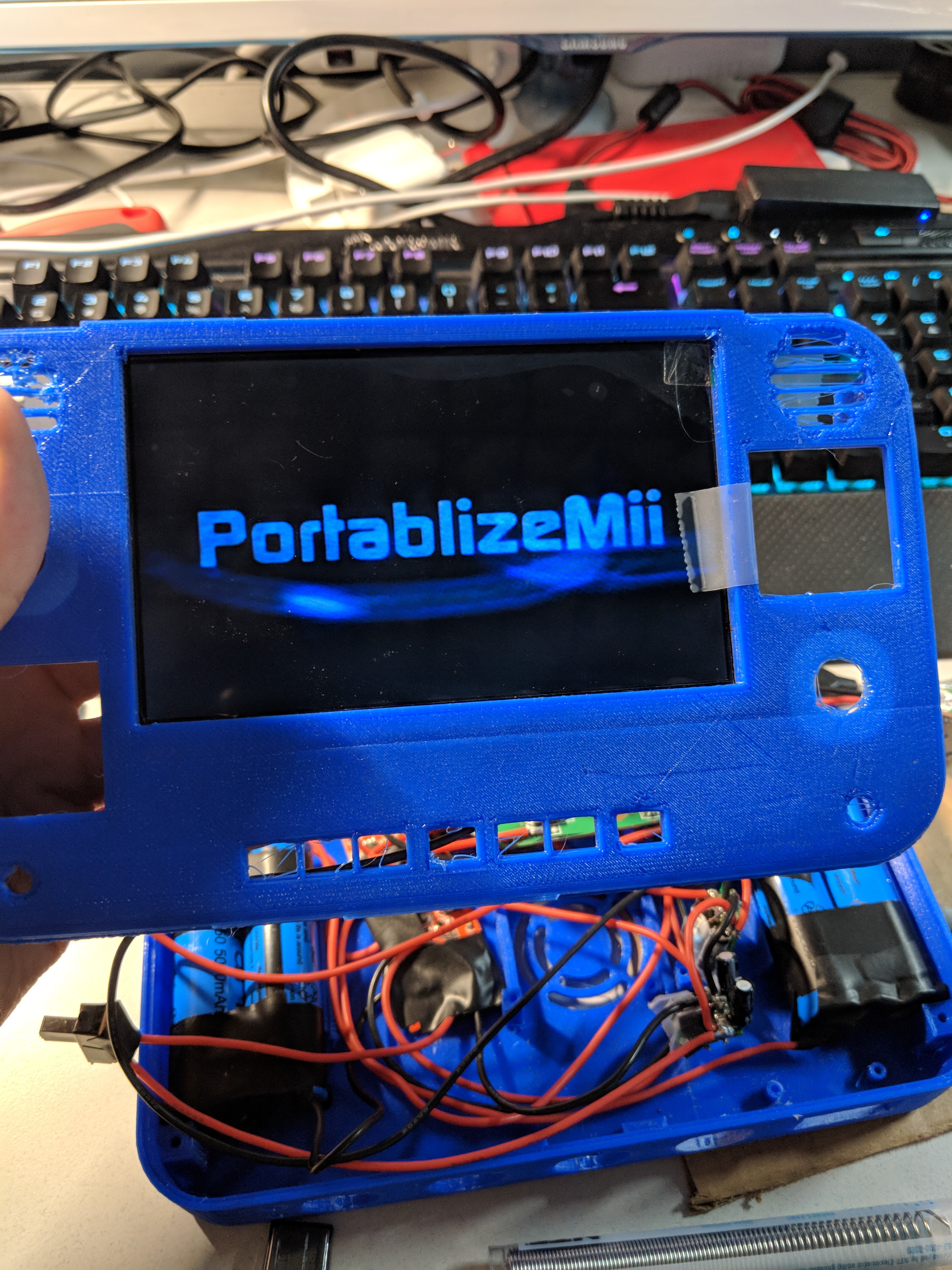

They should be fine. Yeah its normal if the multimeter beeps on some lines, even though they are not actually shorted. Some multimeters already beep at like 50 Ω..Finished a good amount of casework but then I ran into some wiring problems. I had wired up my regulators and they all output good voltages, but when I wired up the regs to the Wii, the input voltage on the whole Vout line from my charging board dropped to about 1.6V. I figured it was a short, so I checked the motherboard and sanded it down a bit. I tested continuity and the 1.15V line was showing continuity. However I read before that the 1 and 1.15V lines can sometimes show continuity because the resistance is so low. Can someone check my resistances to see if they're normal?
3.3V: 410ohm
1.15V: 40.5ohm
1V: 58.6ohm
