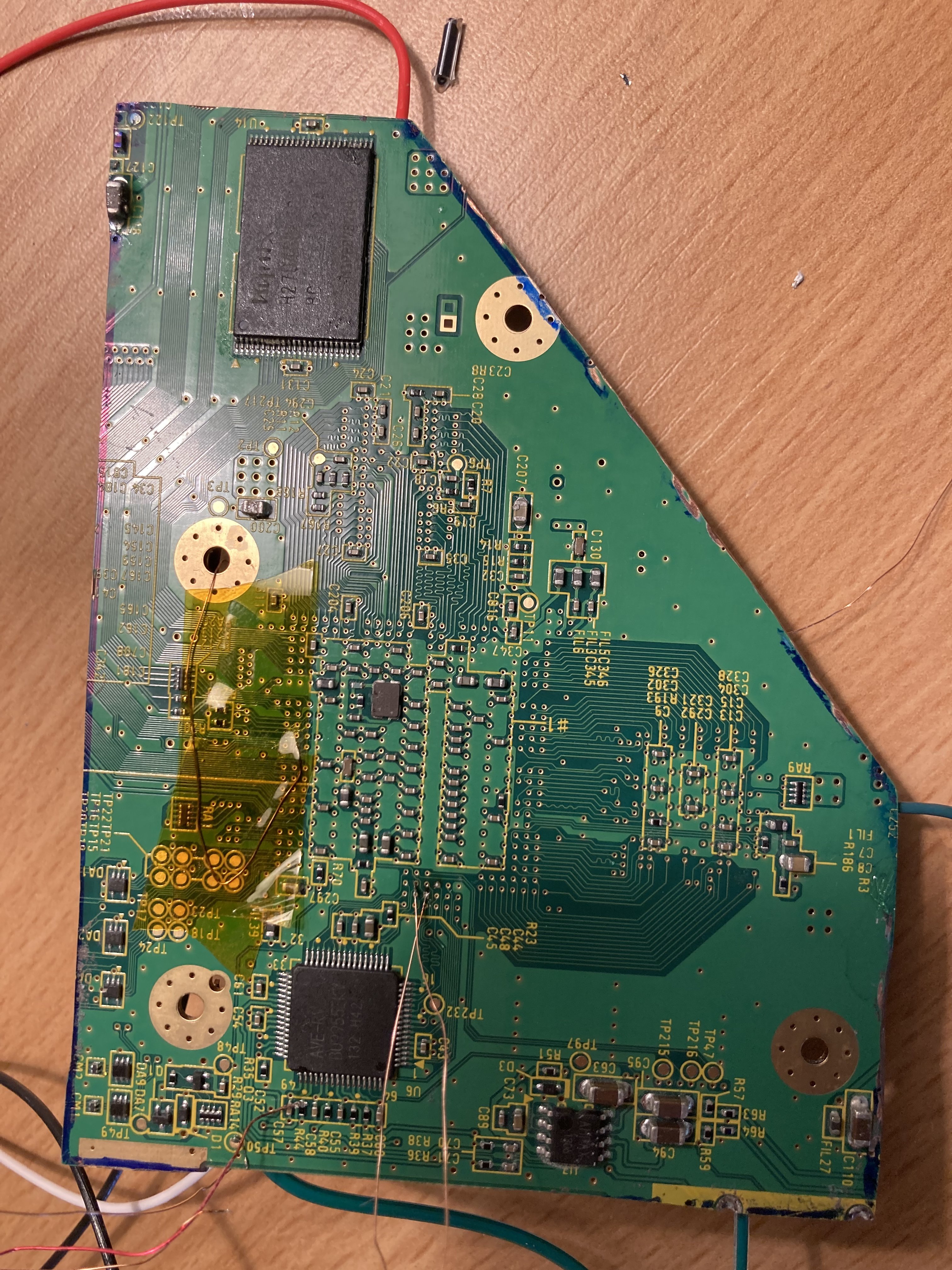

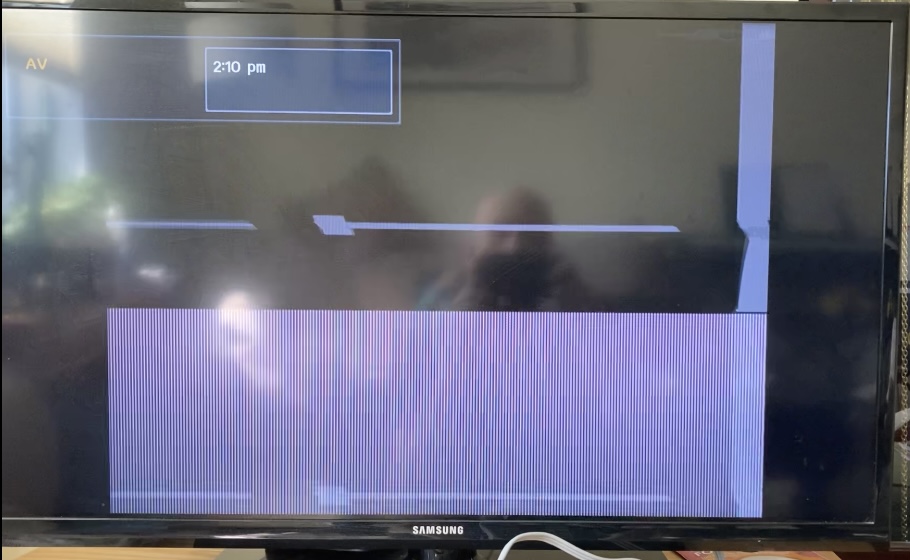

I am working on an Ashida and have a trimmed wii that I plugged in to test and got bad video that doesn’t match anything I’ve seen elsewhere, so I’m hoping someone can tell me what I’ve done wrong.
After pressing the power button, the wii turns on and outputs some garbled video, shown below. The screen scrolls and the snow flickers in and out before the wii resets itself after 5-8 seconds.

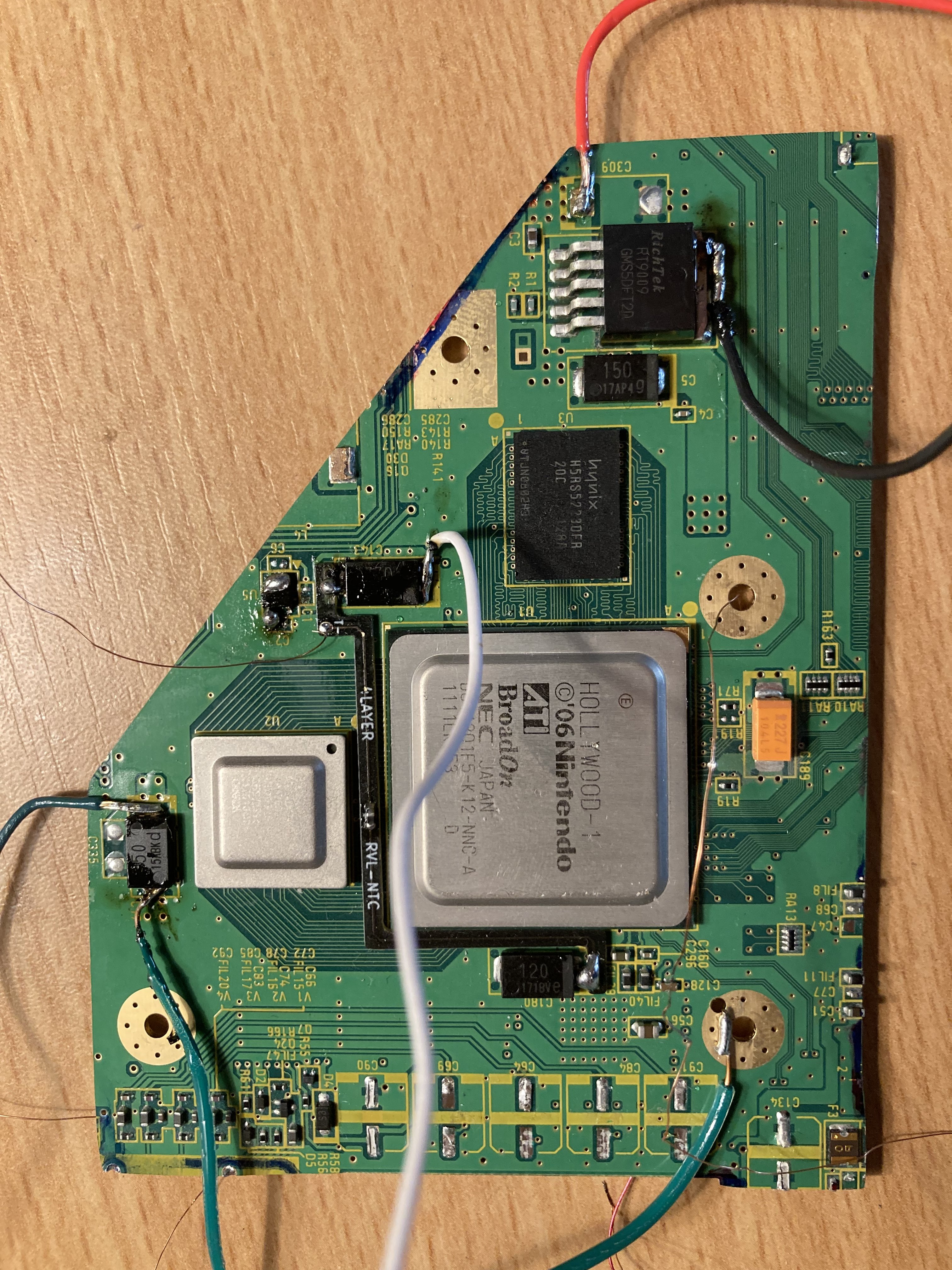

I have installed RVLoader, patched out WiFi, and checked resistances on the board. One thing I did mess up is I tried to relocate U10 instead of just using the PMS-lite output, but get the same video output whether I use my (poorly) relocated U10 or the PMS-lite U10 connection.
Below is a picture of the board with my awful solder work.
Thanks for any help/suggestions!

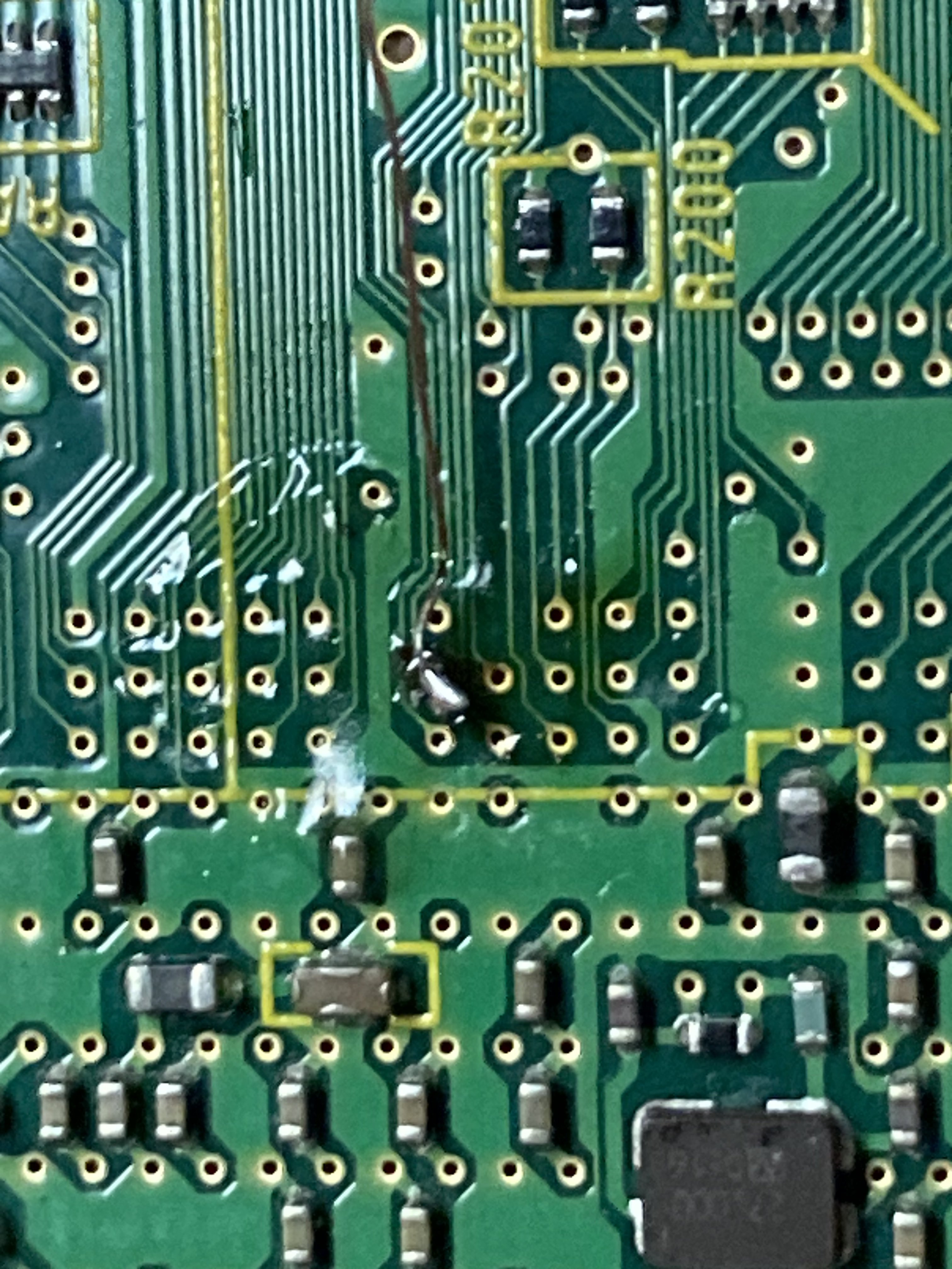

I have already connected wires to the SCW/SDW vias but they are not connected to anything on the other end.
That was my first attempt soldering to a via so I taped it down the moment it seemed to hold, but I see what you’re saying. I’ll redo it and report back.
I would also ditch that jacketed solid core wire you're using for the voltage connections and replace it with 22AWG stranded wire. Using solid core for voltage supply is very much not recommended

Thanks, I had actually initially started trying with the solid core i had on hand and have since switched to 22AWG stranded; the only solid wire I did not swap is the ground (light green). Everything else is stranded 22 gauge and I intend to switch the grounds out, too (just didn’t get there for the test run).

Funnily enough, the ground connection is the most important wire to not be using the wrong type of. Swapping it over probably won't fix all the issues, but it will at least narrow it down.
I also noticed that your u10 is blobbed as fuck. I'd clean that up a bit and ensure the 3.3v input leg is properly secured to the board. In your photos it looks a bit like it's floating
Also a tip: When removing the caps dont desolder them but rather twist them. It puts less force on them and reduces the chance of ripping them like they look in the picture.

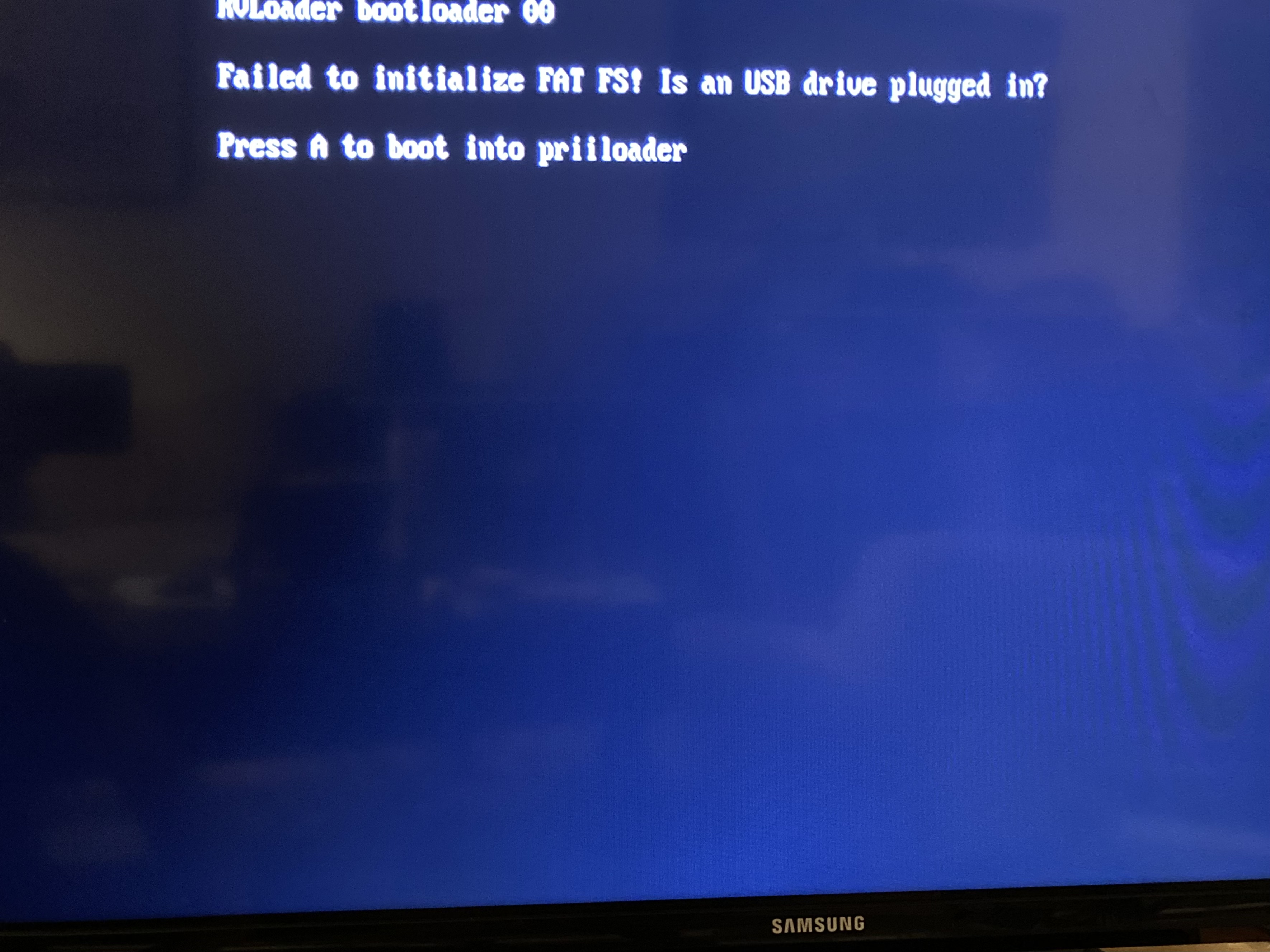

Switching the solid wire to stranded (and/or cleaning up those joints) and cleaning up the 3.3 line did seem to make a difference; the picture isn’t stable but I could sort of make out the text I expect to appear.

I would redo the u10 relocation, yeah. Just to be sure

Edit: I apparently can’t read. I will do that, too, though. I’m not using it, just using the PMS-lite, but that chip is probably poorly done.
Below is the redone U10 connection I did in response to Viilmo’s comments earlier. It’s globby, but seems to be a good connection with no bridging I can see.
It works! I tried adjusting my U10 relocation, which didn’t help, but remembering what Stitches had said about the importance of ground wires i redid my video signal cable. At first i had mixed 30 and 34 gauge wire because they were different colors (and you can guess which one my ignorant self used for the ground), but redid it with 30 gauge for both and got a stable picture.
