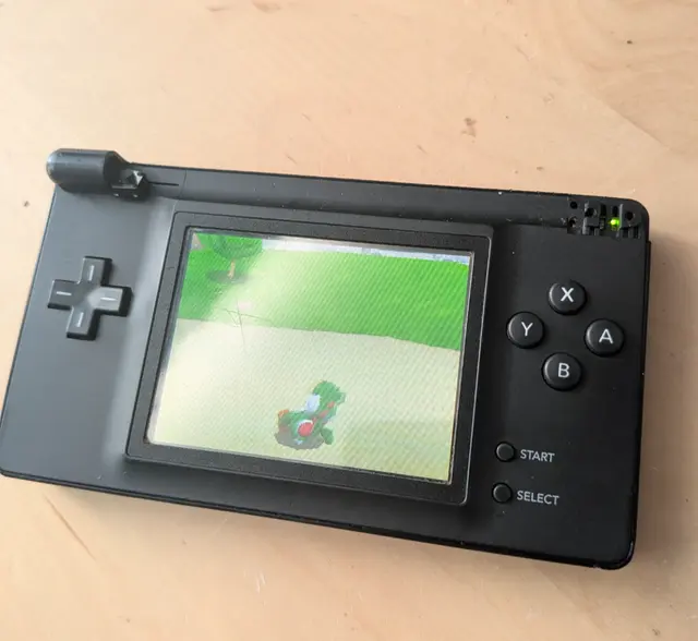

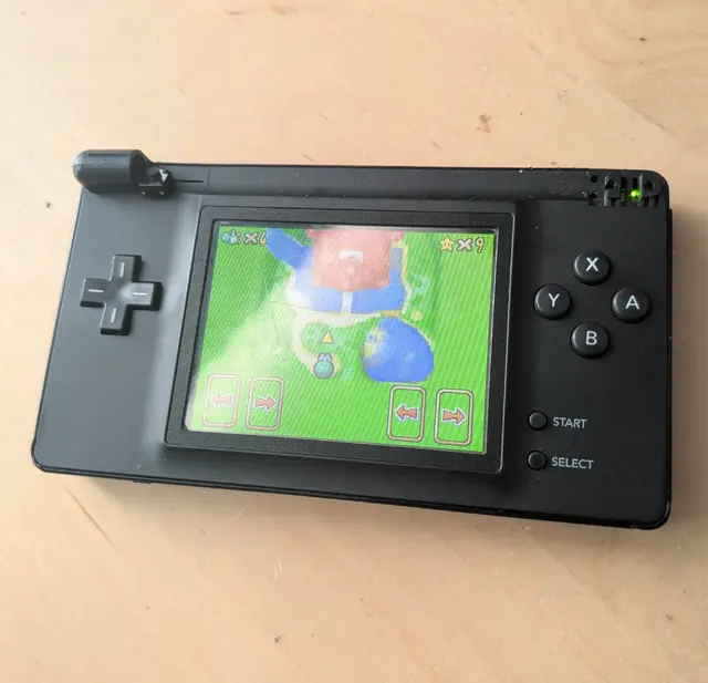

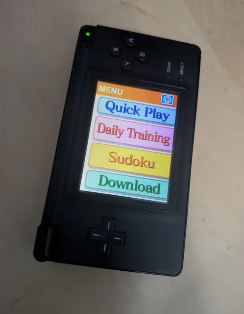

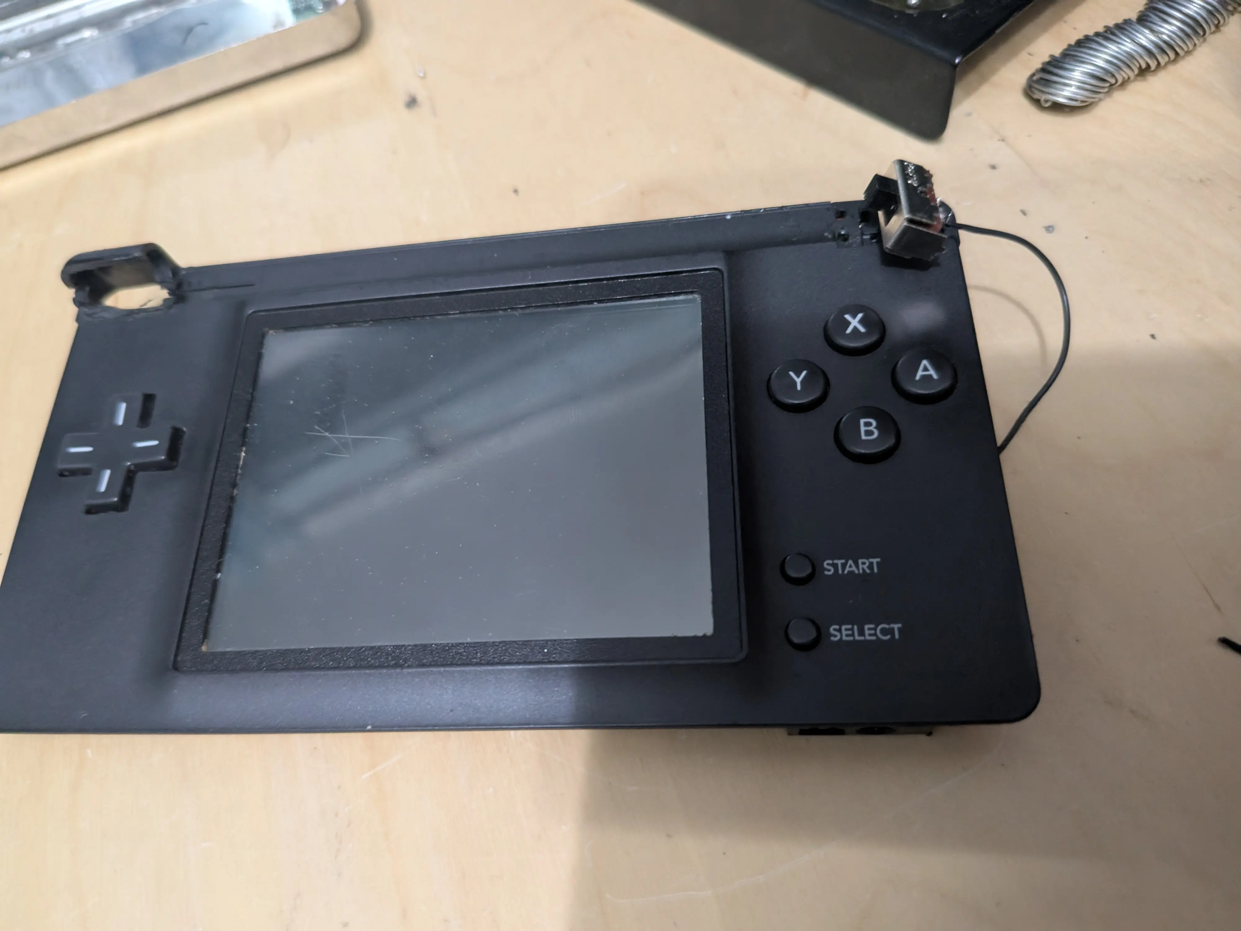

i got a DS lite with a dead top screen for free, and decided to do something with it.
my goal is to make it just as functional as a normal DS (while only having one screen), and hopefully make it better. and also do it for cheap
firstly, i got rid of the top screen and replaced it with a resistor i stole from a broken wiimote battery pack; and i relocated one speaker to the former stylus slot. that gave me this (for free so far):
then i set my sights on the tv out mod. except i didn't have any 470ohm resistors on hand... there was still an easy mod i could do with what i had on hand, though. by installing the tv out firmware, it let me add a button to swap the screens.
that's what i have so far. it's already pretty decent just for playing ds/gba games.. but there's a lot more i want to add. my next addition'll be a sleep mode switch, and eventually i'll:
