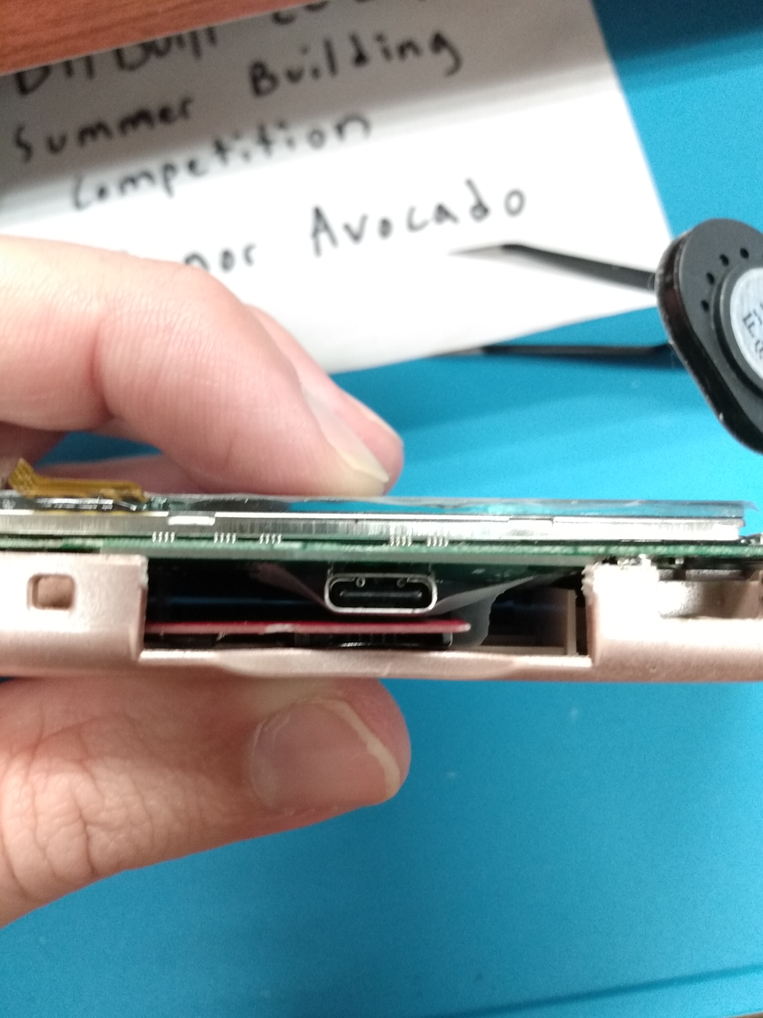

My project for the Summer 2024 competition is going to be the Ultimate Gameboy Macro. I wanted it to be as if all the switch like features were available for the Gameboy Advance, one of my childhood consoles that I spent quite a bit of time with. The bones of it will be this beat up DS Lite. Below is what I am trying to achieve:
Design Goals:
  • Custom shell
    • Will have indents on either side of usbc port and big grove directly in the middle behind the port to help with aligning with the dock
    • Resin Printed in Black
  • Has all ABXY buttons
  • Utilizes original light pipe that is sanded down
  • Has touch screen digitzer
  • Original Charging port will be sealed off
    • In its place Will use Sleep magnetic IC to trigger dock mode, will have magnet in dock, ic inside Macro
  • Will have 3 way button PCB in stylus:
    • Press down is manual screen swap
    • Press in is sleep (only in ds mode)
    • Pull out is Bluetooth connect, can wire it if it is a long hold it turns on and off the Bluetooth module
  • Mono Speaker with Helder Amp and Speaker
    • In top left
  • Has microphone on front bottom right (next to start and select buttons)
    • Will be embedded in bottom right corner of faceplate, connected with glue
  • Also still has wifi antenne
    • Will be embedded in bottom left corner of faceplate, kept in place with glue
  • Have Bluetooth audio board
    • Will sit under WIFI board, make sure you cut off shielding to make room, isolate with Kapton. Antenna will be towards top of board
  • Custom PCB that will sit where Slot 1 used to be
    • Uses active DAC and amplifier to generate composite signal
    • USB-C Jack PD compliant
      • Will have charging
      • audio pass through to dock
      • video pass through to dock,
      • snes controller data lines
    • Use Attiny 85 to switch screen automatically, turn on and off headphones when appropriate jack is plugged in, provide delay of video on to avoid popping
    • Have snes gamepad controller board sitting on top of custom board
    • Keep DS cartridge slot 1 by cutting out slot, but hardwiring 128 in 1 flash cart
      • Will sit on top of board, the sd slot will be available in the top too
  • Will use Sleep magnetic IC to trigger dock mode, will have magnet in dock, ic inside Macro
  • Will have a dock
    • that converts composite to HMDI
    • and be able to connect to wireless or wired SNES gamepad
    • powered via usb-c 5v 3amp supply
    • uses usb-c as connector
    • will use pen springs to help with plugging in and taking out
    • will have window in top of dock to allow screen to act as indicator light
We will see how it goes! It feels ambitious but I work well under deadlines haha

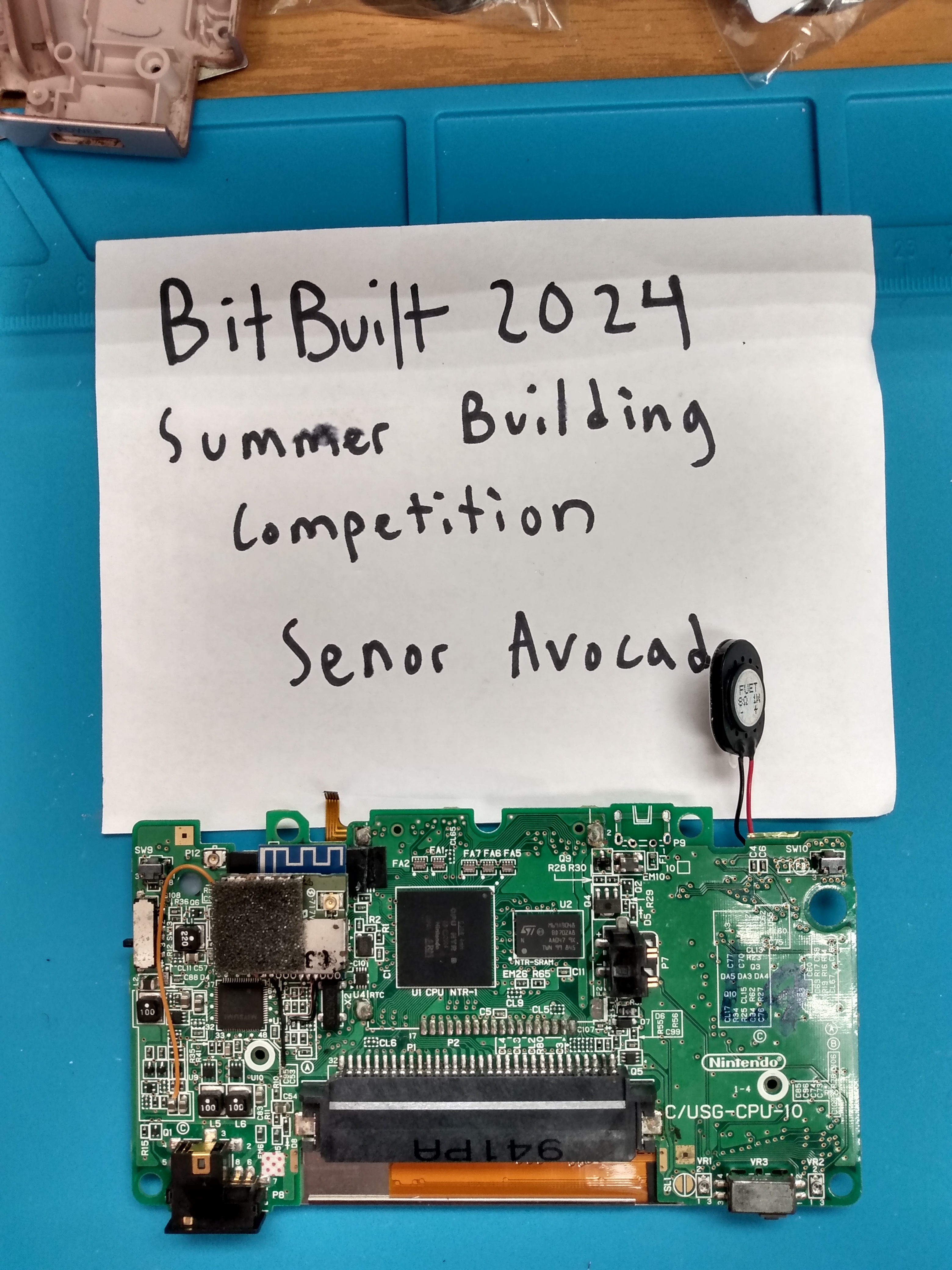

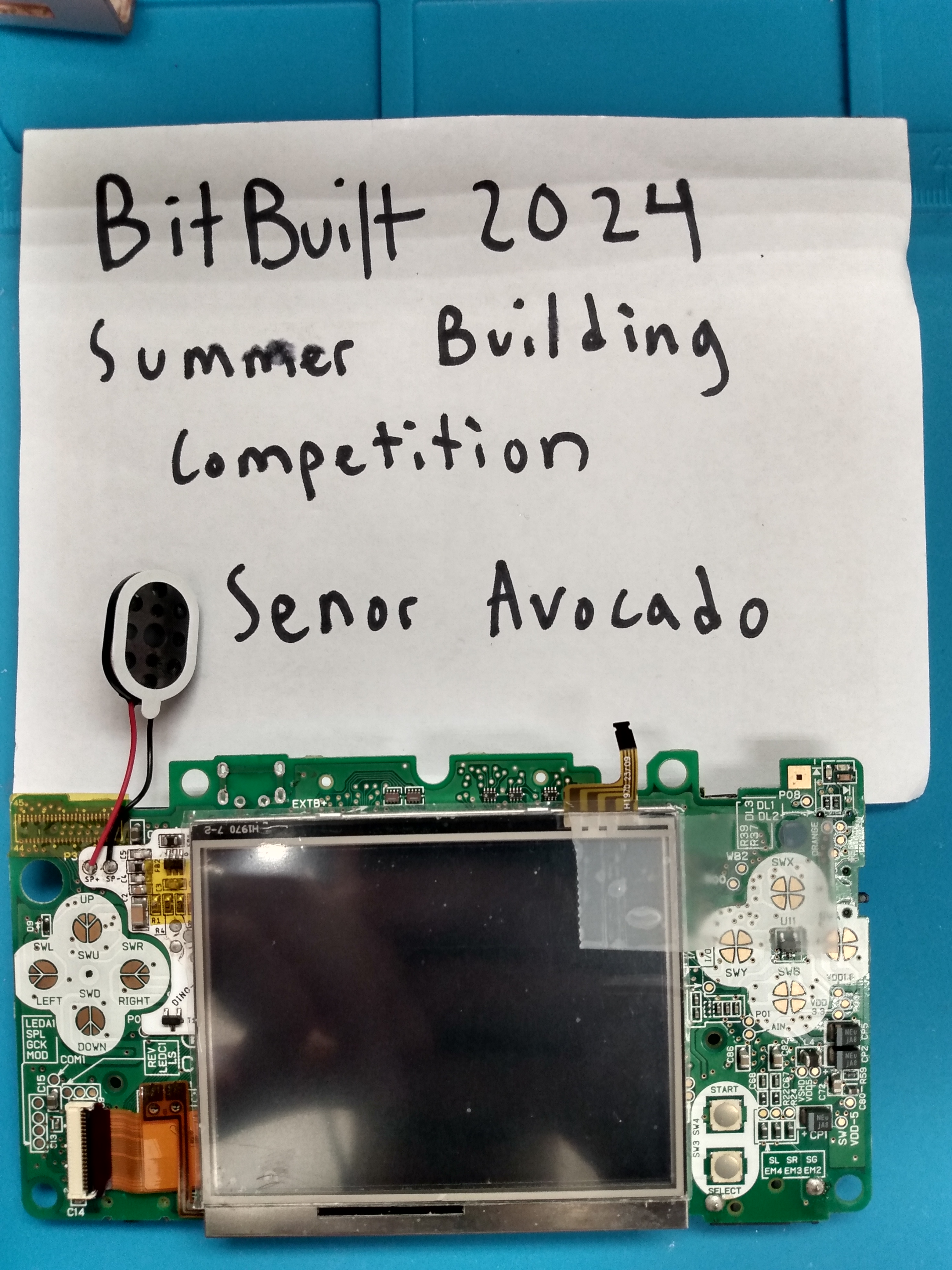

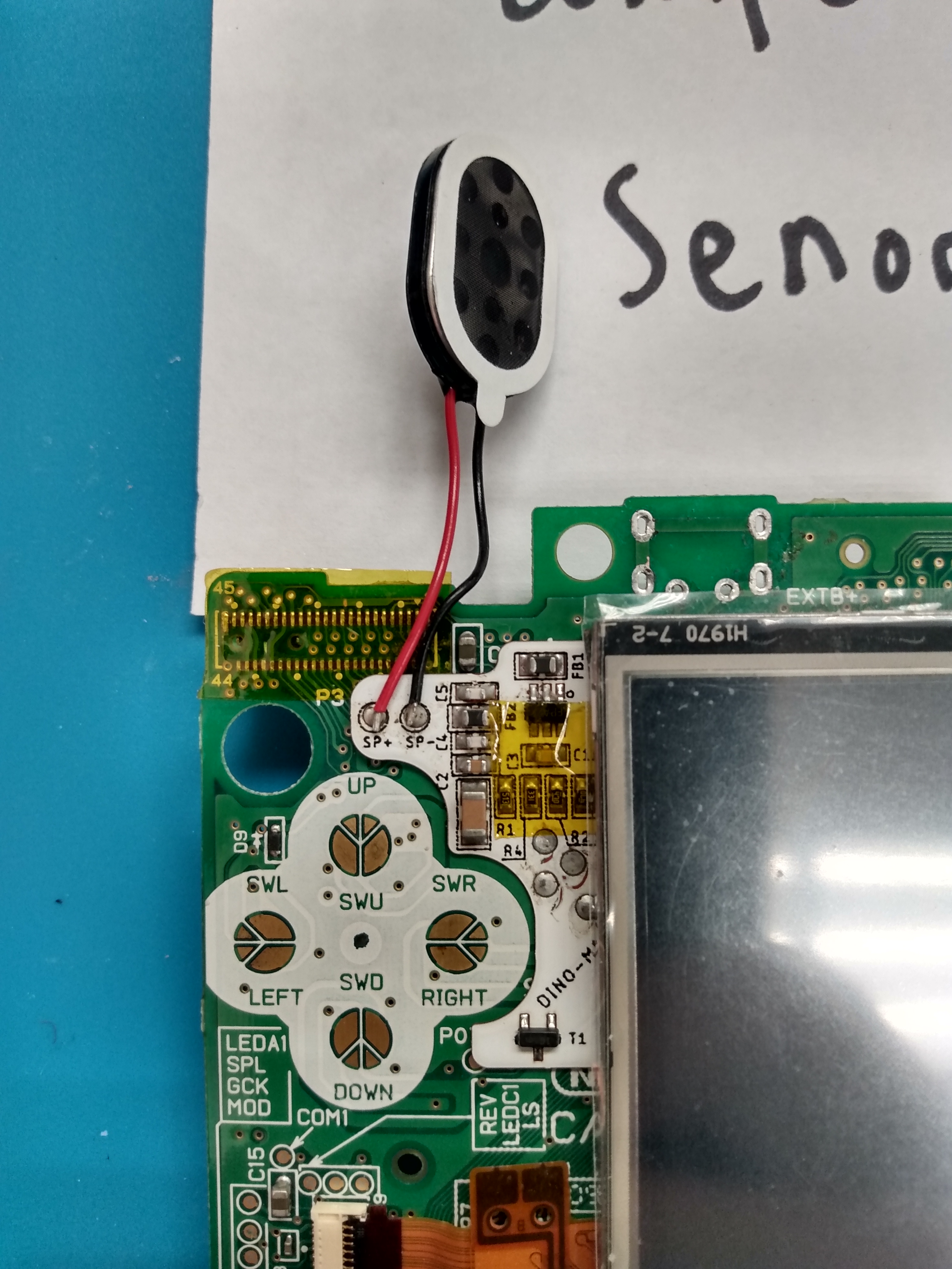

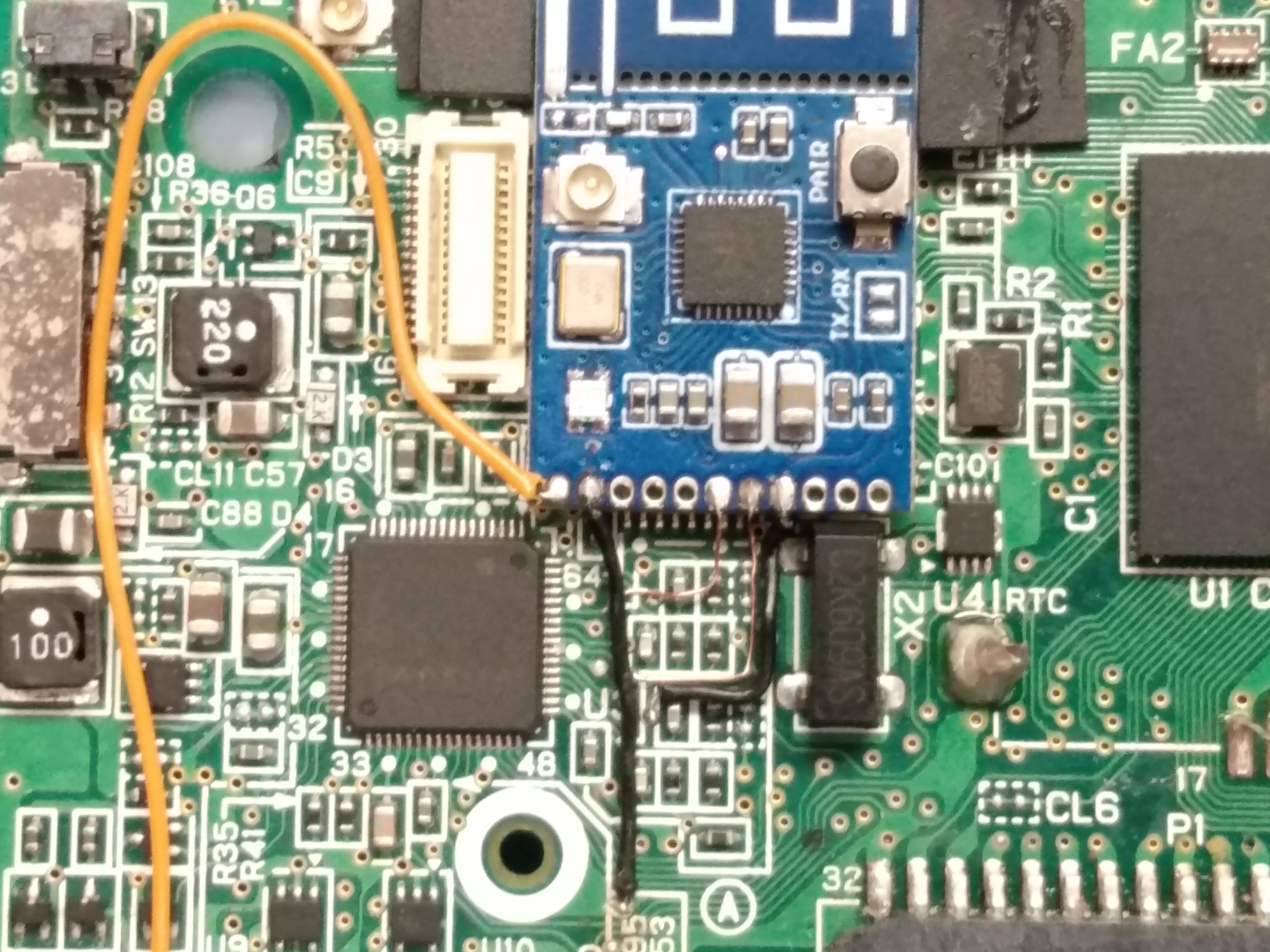

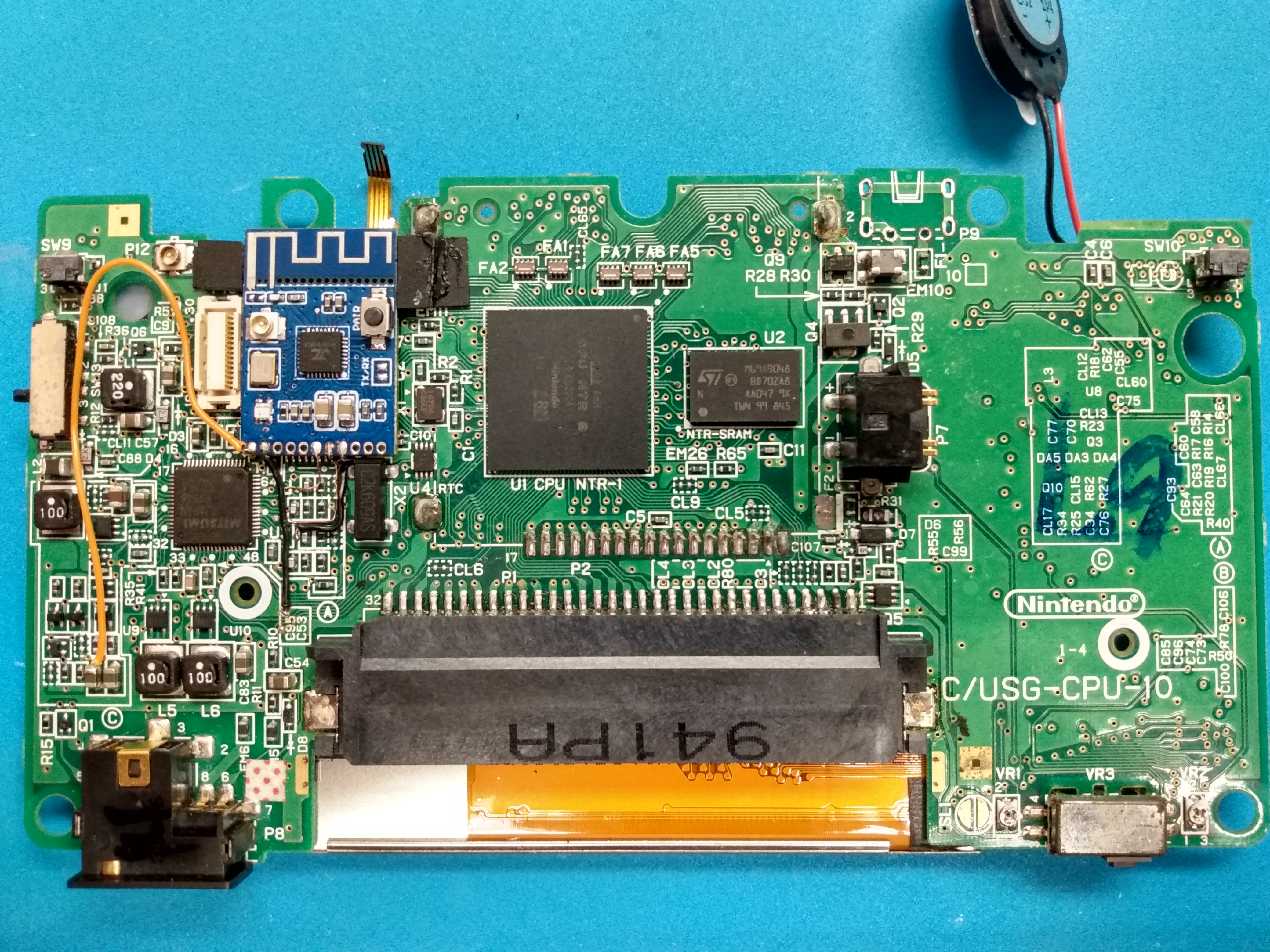

Got the Bluetooth board and Helders audio amp wired up, next is finalizing the main pcb and 3d modeling the flash cart.
I had an issue with the Helder Flex amp, I have never soldered a flex pcb to vias before so I thought it was user error, but i eventually found that one of the legs to the smd IC was not even soldered :\ Quality Control Issue lol.

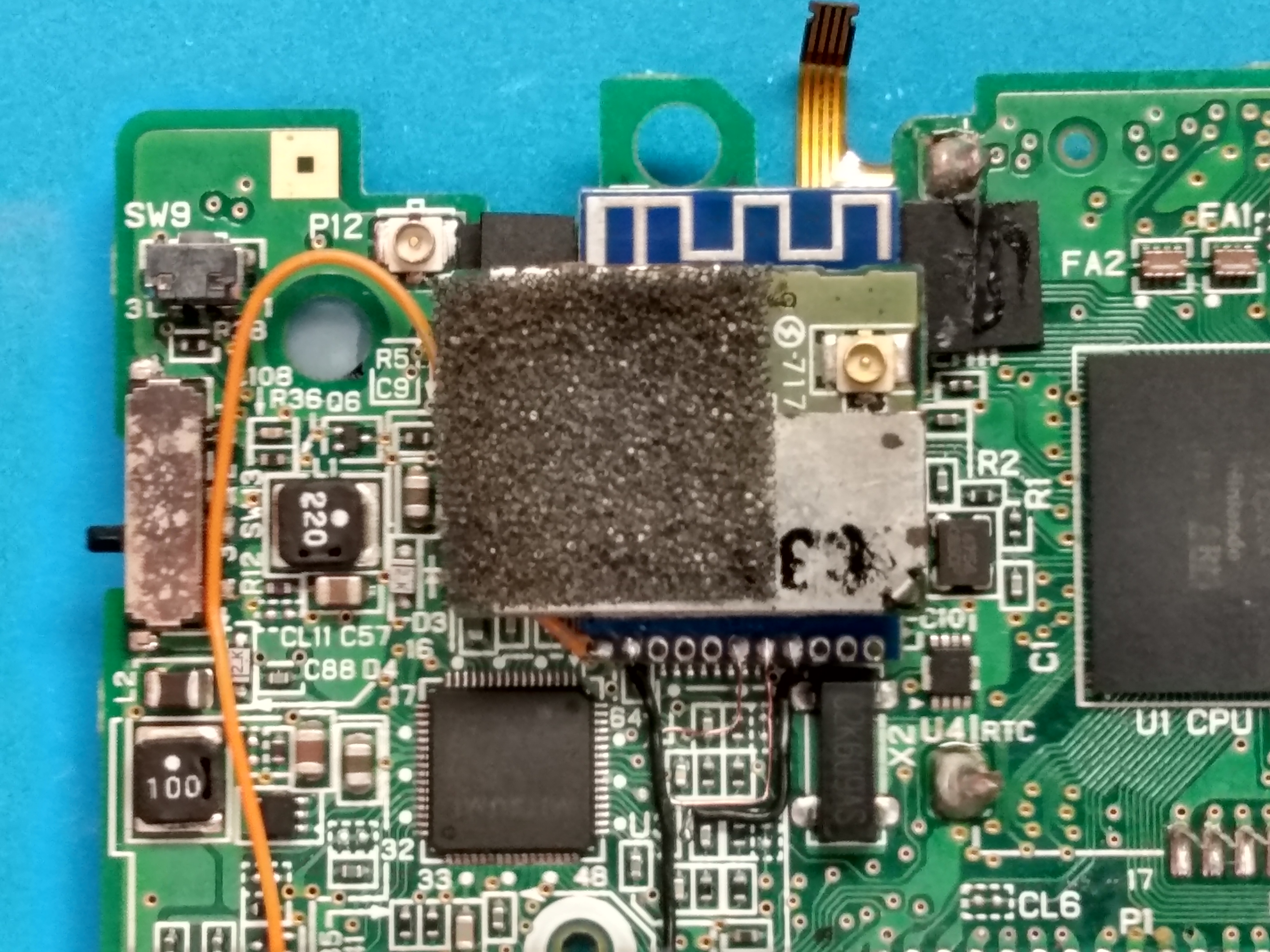

Also I found a perfect placement for the bluetooth board, i snipped the shielding from the wifi/bios board and slipped it under there. it is near all the audio vias and is tucked away. connection is good too, I thought maybe it being surrounded by PCBs could cause interference, but it was crystal clear! the 5v line is long because eventually i will have it connected to a pfet and a microcontroller to toggle it on and off. I don't want it always on sucking the battery life.

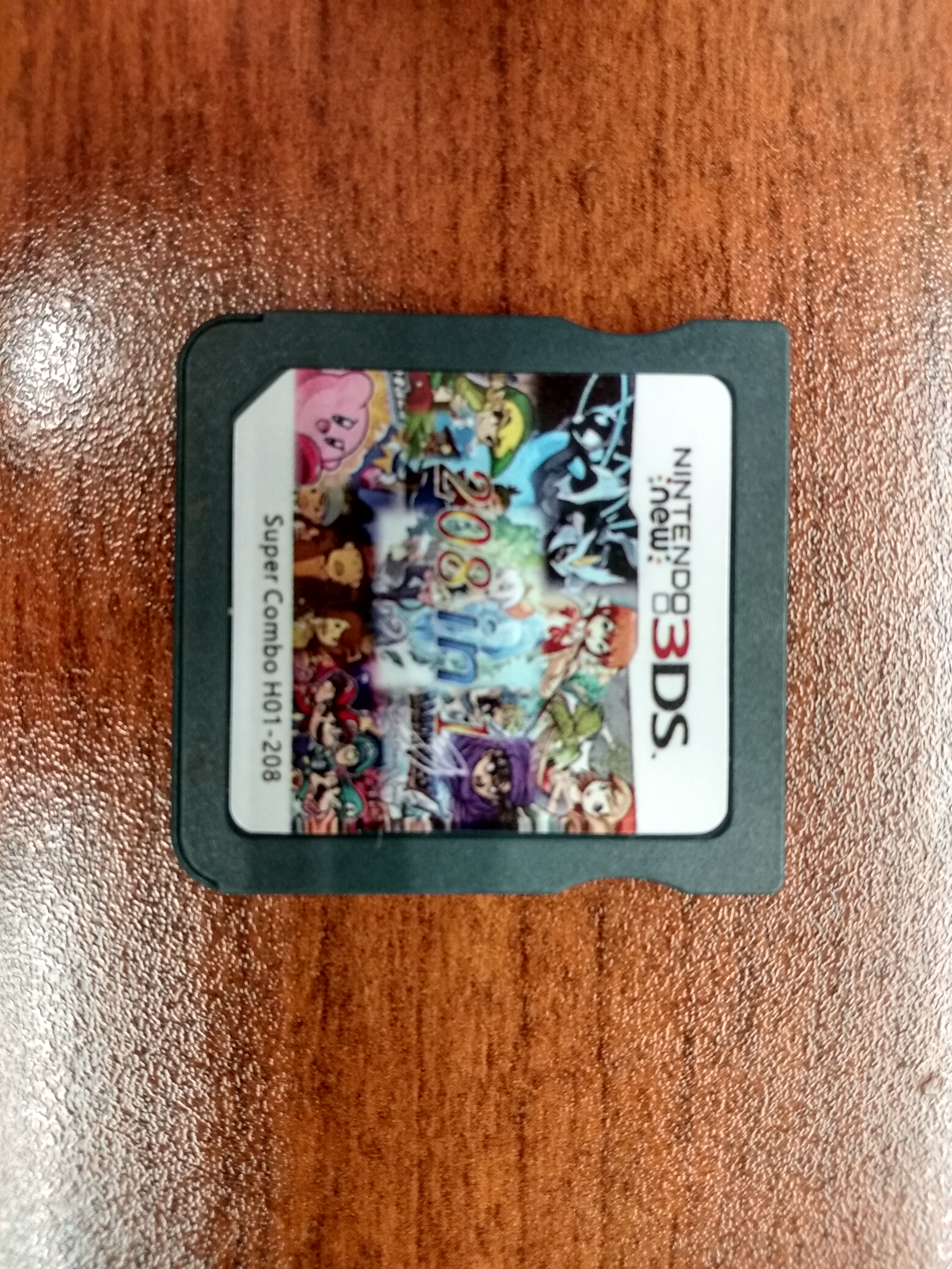

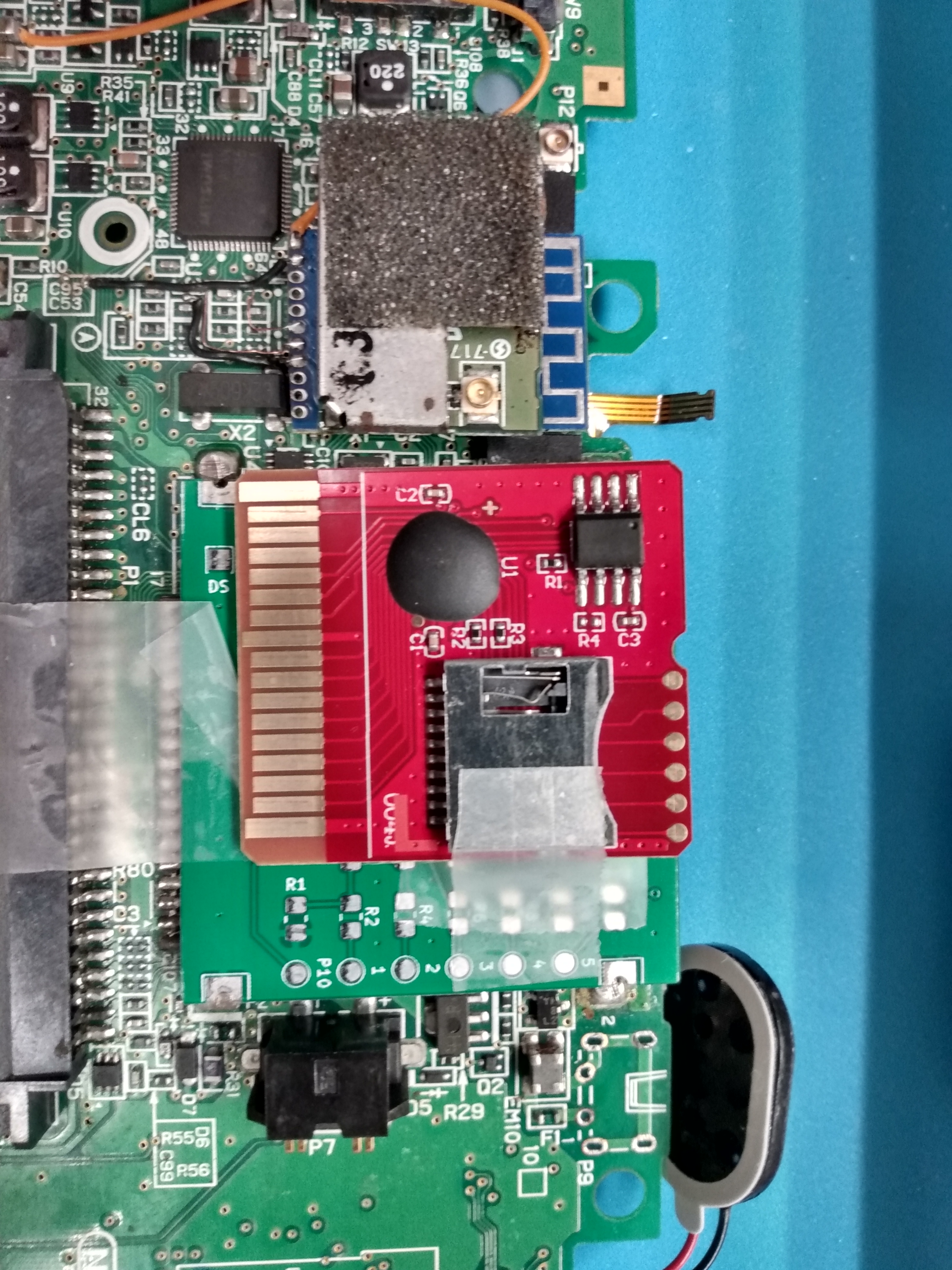

I was trying to figure out the flashcart aspect of this, I wanted to see if i could omit having to put a switch to manually turn on and off an internal flash cart. I got one of the cheap 208 in 1 ds games as they could have different firmware loaded onto it. After a lot of firmware searching and settings tweaking, I think I have something that works well. I will eventually hard wire the slot 1 flash cart to its contacts on the motherboard, and it will sit stacked on top of the usbc port that will have all the video out/dock stuff. This link is the firmware i was using as a starting point. Releases · flashcarts/AOS (github.com)
I can choose in the software either to load up ds games, gba roms, a hard copy of a GBA game in slot 2 or the various emulators that are on here. This video shows a little bit of the options https://photos.app.goo.gl/WceBCaMRXXHa5Lw16

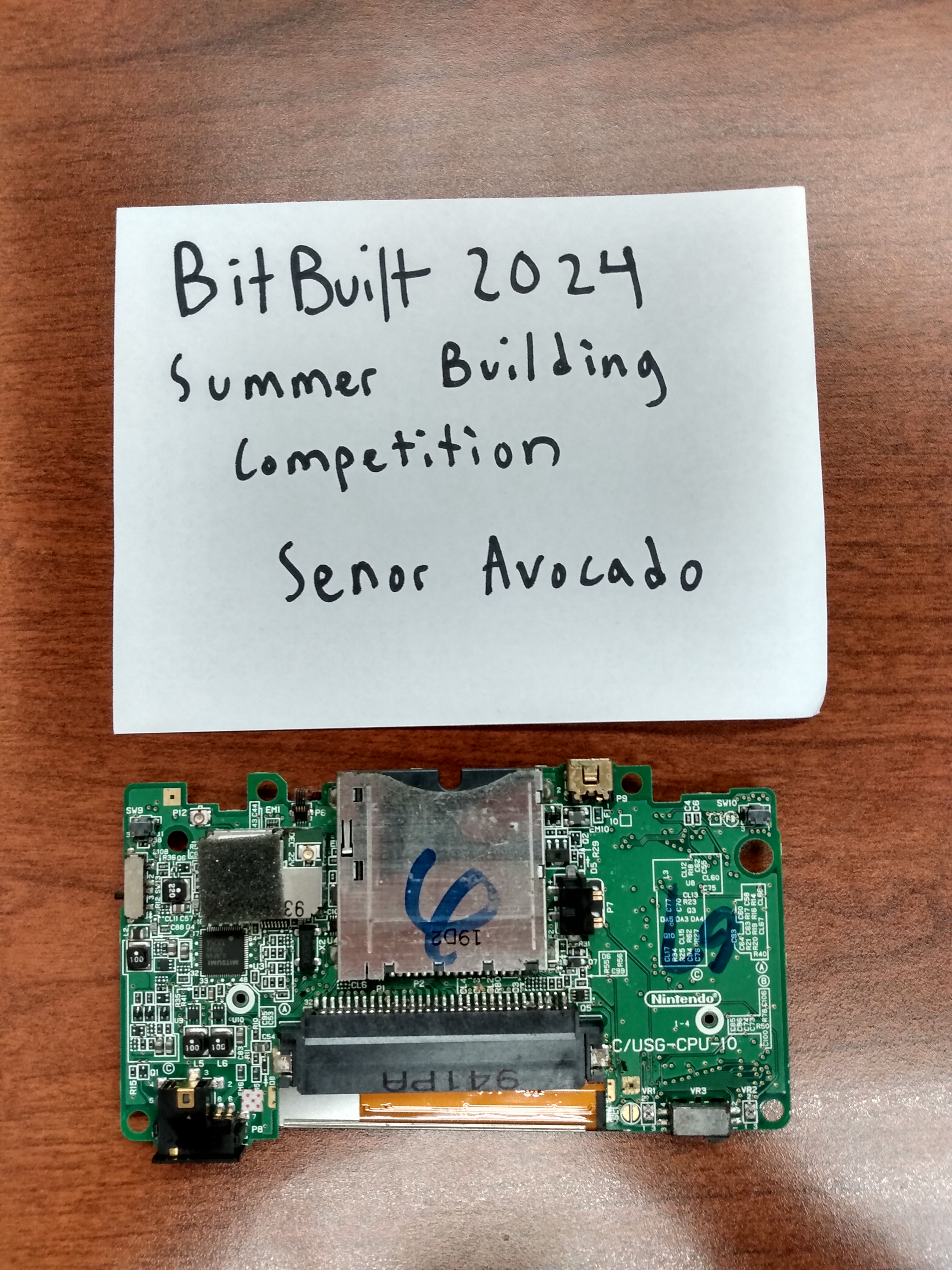

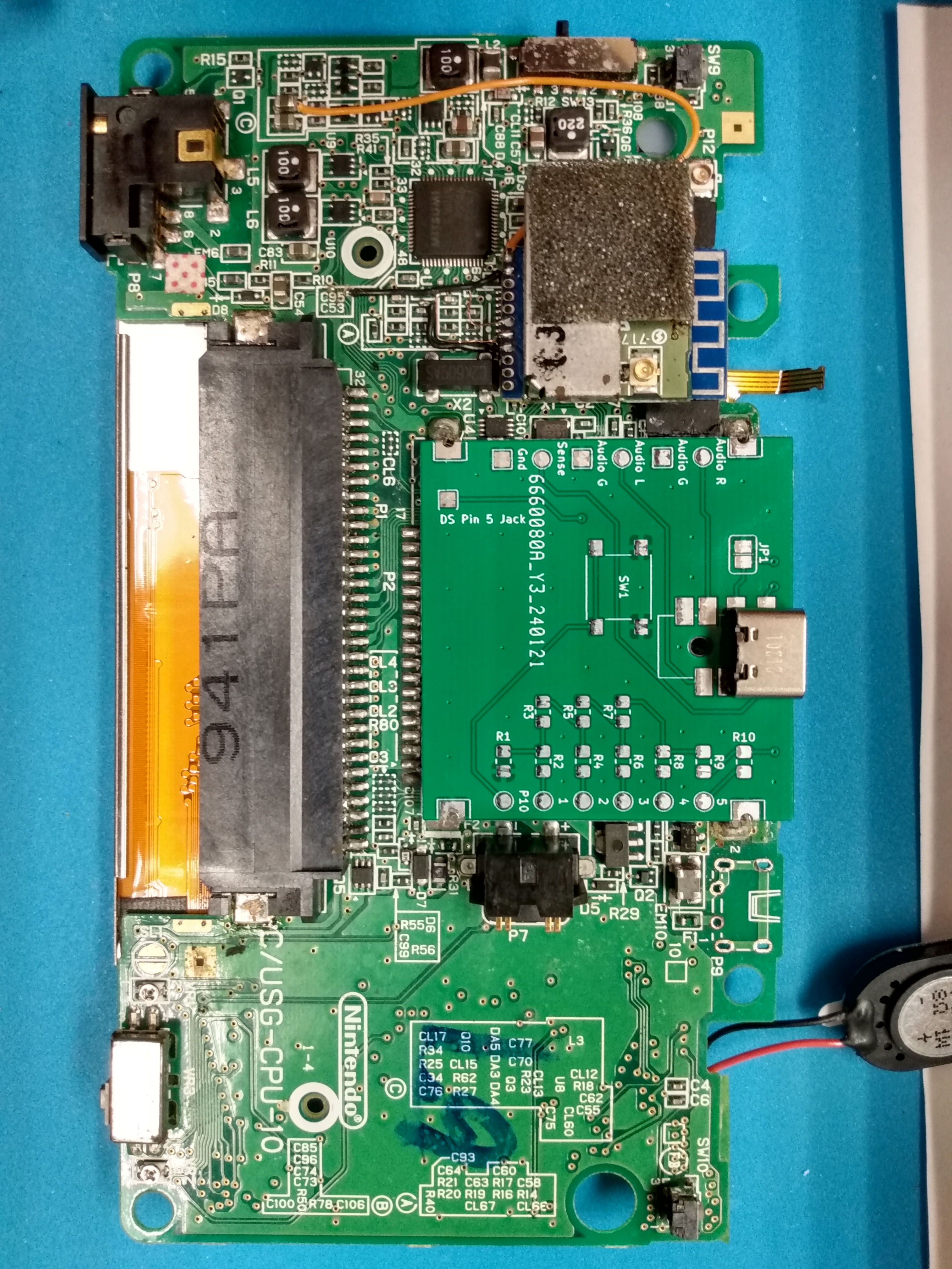

The green pcb is from my initial composite out board, and was helpful in getting the jist of how thing would be placed
Now i need to cad this stuff and modify the faceplate to accommodate these ports on top!
