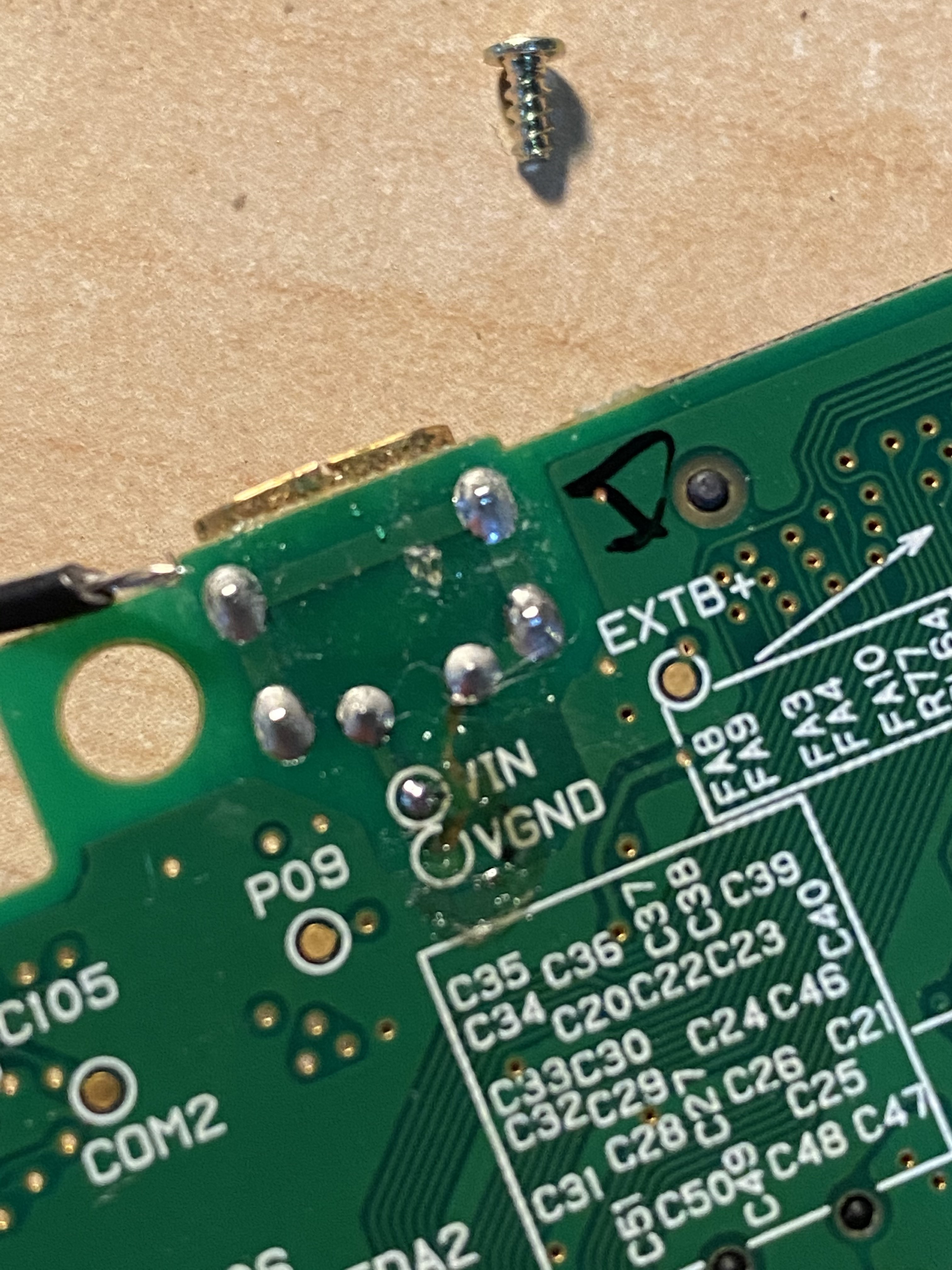

Hey guys, this is my first GameBoy macro project and I wanted to make this as stock as possible to the original DS lite so I can bring it up in conversations
“Hey so I turned my brothers broken DS into a GameBoy ”
here’s my issue:
I desoldered the speaker because I wanted to relocate it and while attempting to solder it back, I accidentally burnt off the golden pad on the VGND pad. So it’s pretty much impossible to solder the speaker on there.
Is there some sort of external micro 3.5mm speaker that I could use to plug into the headphone Jack for sound?
