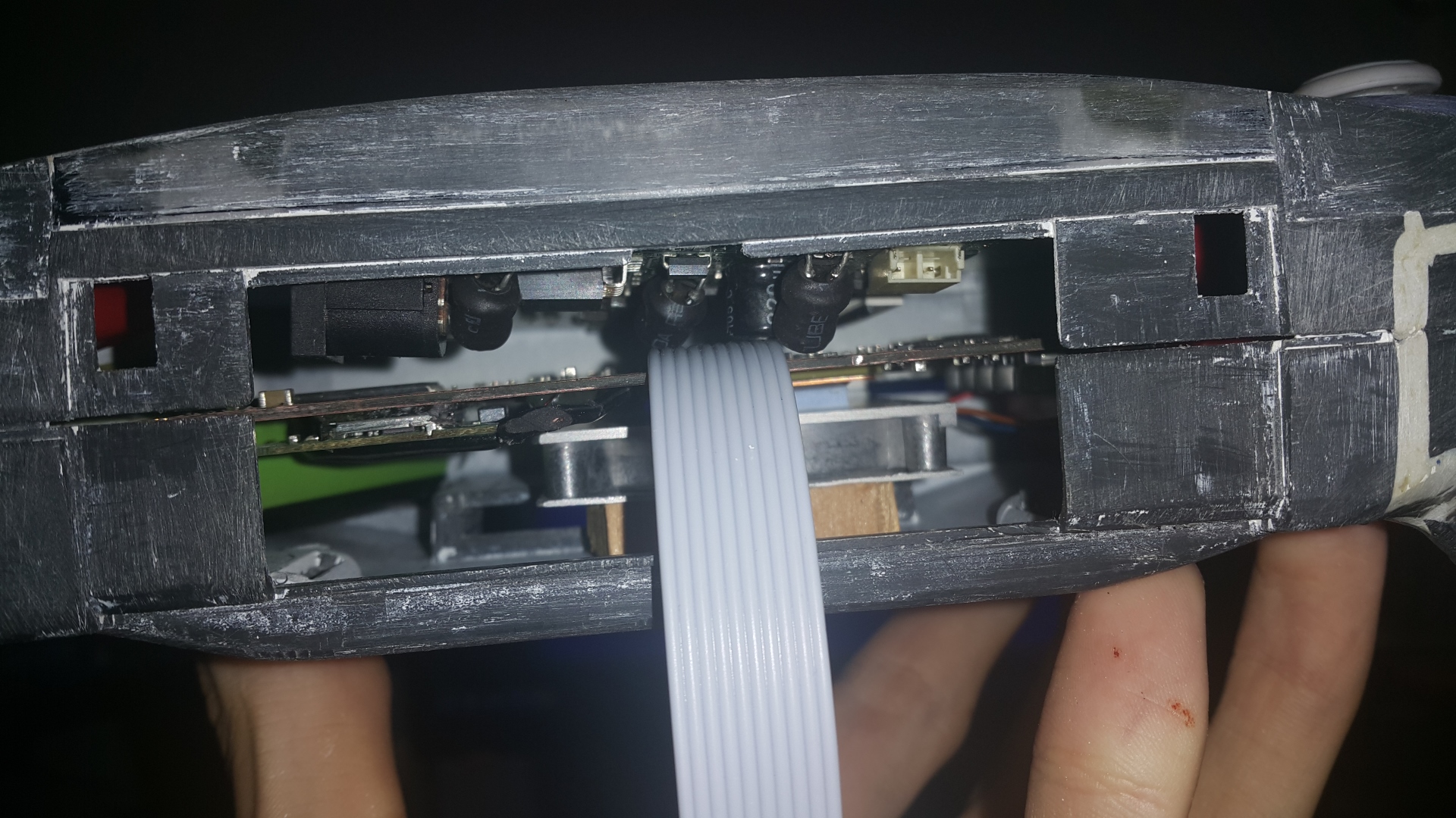

Not too bad. Ignore the skew stick, the blu tack holding it up came off.
By a single mumble ass hair all the big things fit.
Bit more space optimising to do, but it's going to work I think.
Pure gold. Good timing too, I'm bout to wire up my regs soon. Bout to put an extra cap in diz bish.

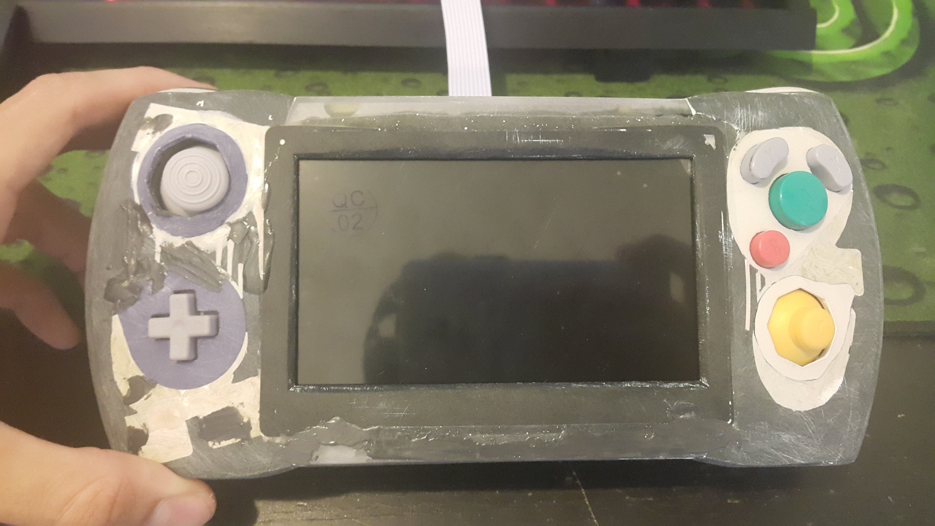

Words cannot express my ecstasy
FIRST TRY NERDS!

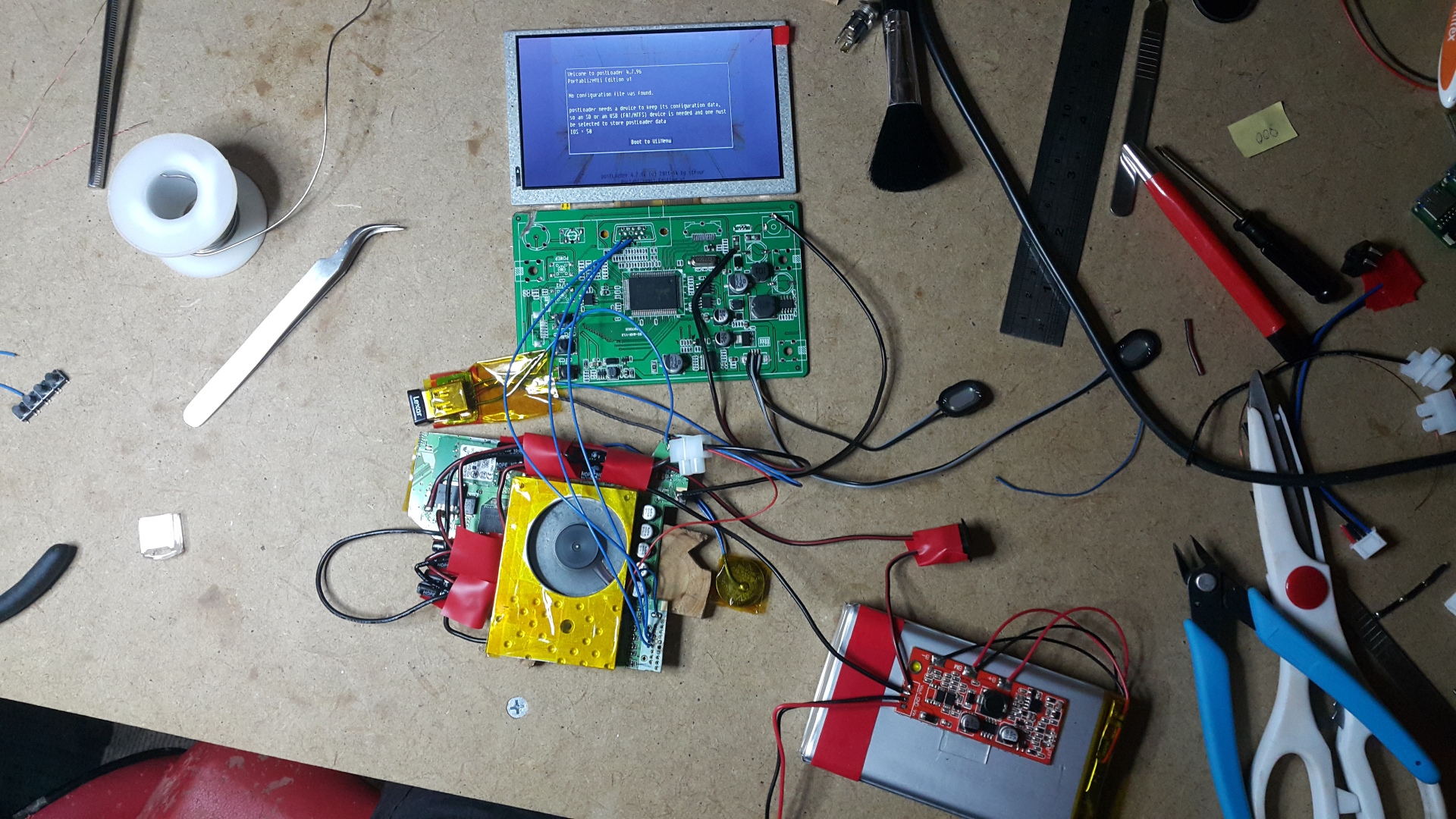

Ignore the non-functional USB port, I'm working on that.
EDIT: All Wii-side stuff is working, even my dodgy MX chip wiring. Just have to debug the Eyoyo screen's controls since they've arbitrarily decided to stop working, then I'm good to go once the Lynx's top coat is fully cured.
EDITEDIT: I fixed the screen controls. Turns out I nike swooshed the control sense trace when dremelling out the screwpost anchors. One wire was the solution.

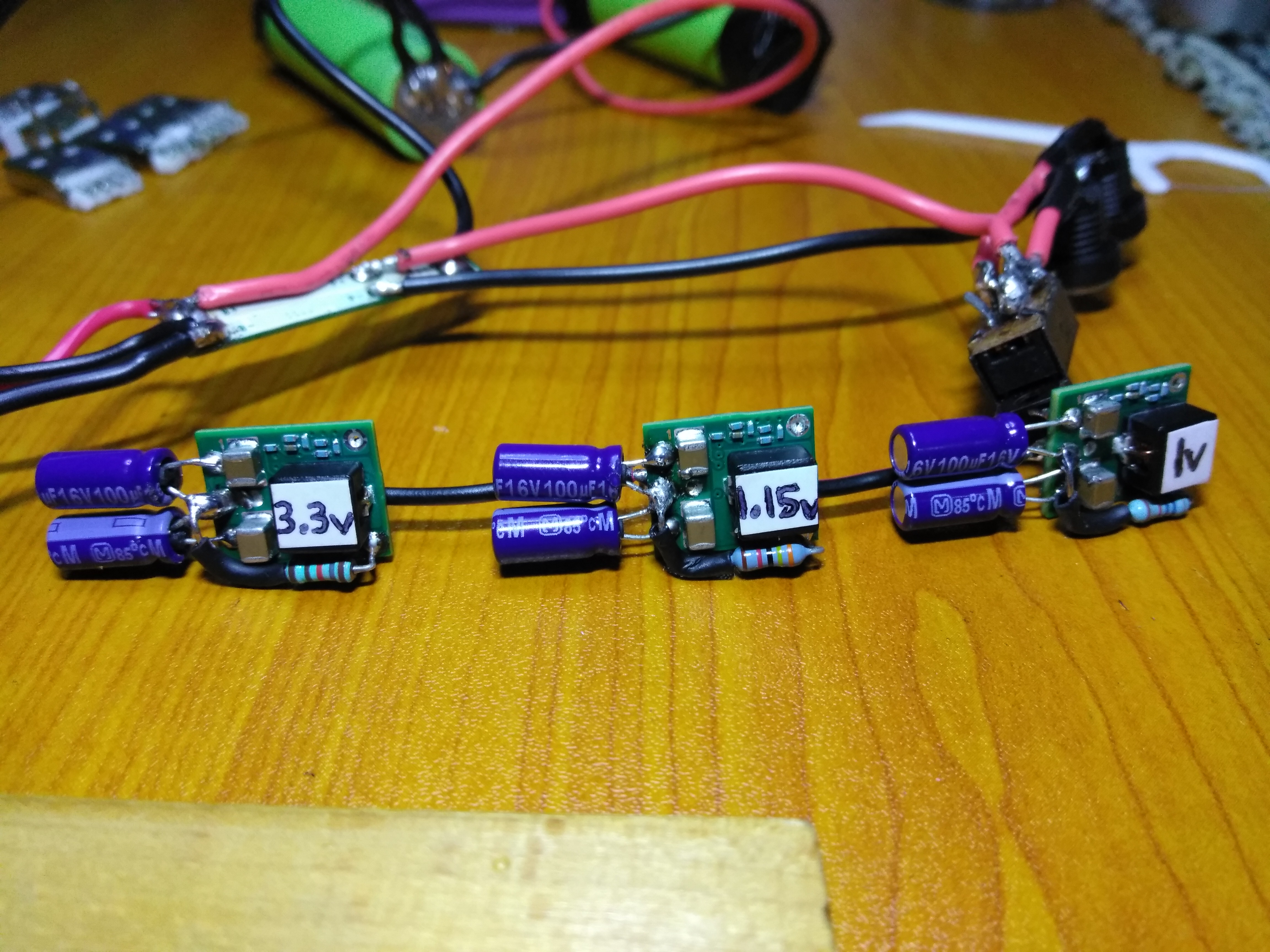

Well fuck how do you wire the output caps (My teacher in electricity class couldn't fucking explain how caps work)
I attached a picture of how I wired mine. Just reverse the cap on the output, make sure you keep ground the same polarity. Gman can tell you what happens if you wire a cap backwards.

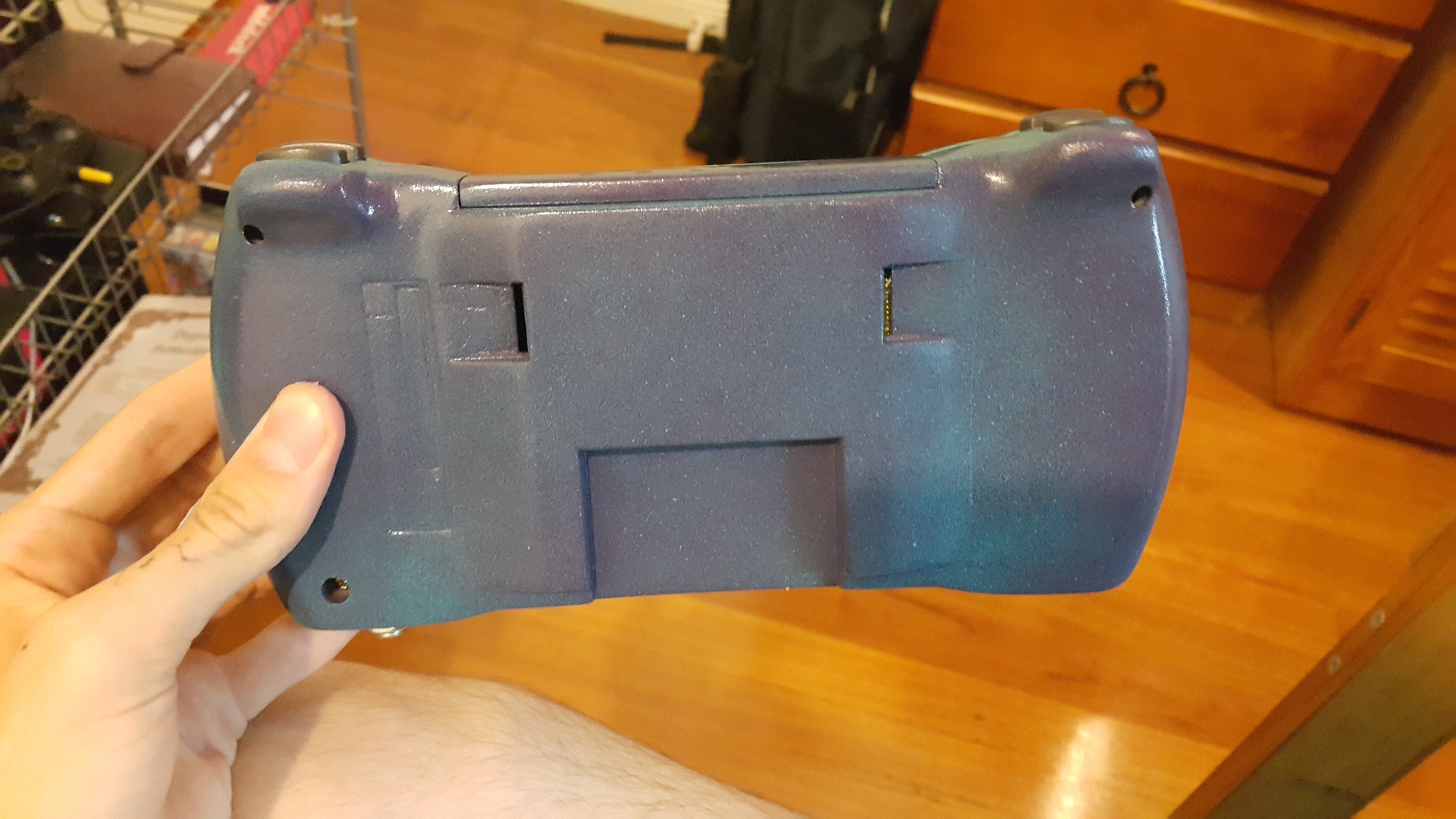

MY DUDES IT IS COMPLETE!
Full pictures and video to come tomorrow. It's too late here in the land of Kangaroos and Dollarydoos to do it all now, but I'll leave this booty pic here as a teaser ;)
Actually hold that thought, my Lexar has died and I can't do anything until I get a replacement USB. RIP.
Output capacitors should be wired in parallel with the output load. When working with electolidic capacitors, you must place the negative side of the capacitor to ground or the cap will explode. Some other kinds of capacitors have no polarity so you can wire either side to ground.
Capacitors work by having a voltage build up between the plates of the capacitor, which are seperated by a dialectric such as paper or air. When the input voltage to the capacitor is less than the voltage built across the plates, the capacitor will discharge. This keeps voltage at a regulated level even when there is drop in the output from the power source. When there is a spike in the input voltage, the capacitor will absorb the spike by wanting to charge to that voltage level keeping your precious components safe.
This is in no way a comprehensive explanation but it is enough for a portable.
Output capacitors should be wired in parallel with the output load. When working with electolidic capacitors, you must place the negative side of the capacitor to ground or the cap will explode. Other kinds of capacitors have no polarity so you can wire either side to ground.
This is in no way a comprehensive explanation but it is enough for a portable. If you want me to make a.capacitor guide in the guide hub just ask.
This was honestly amazing. Why couldn't my textbook say this? This explains everything. Saying that wasn't comprehensive is too modest.
