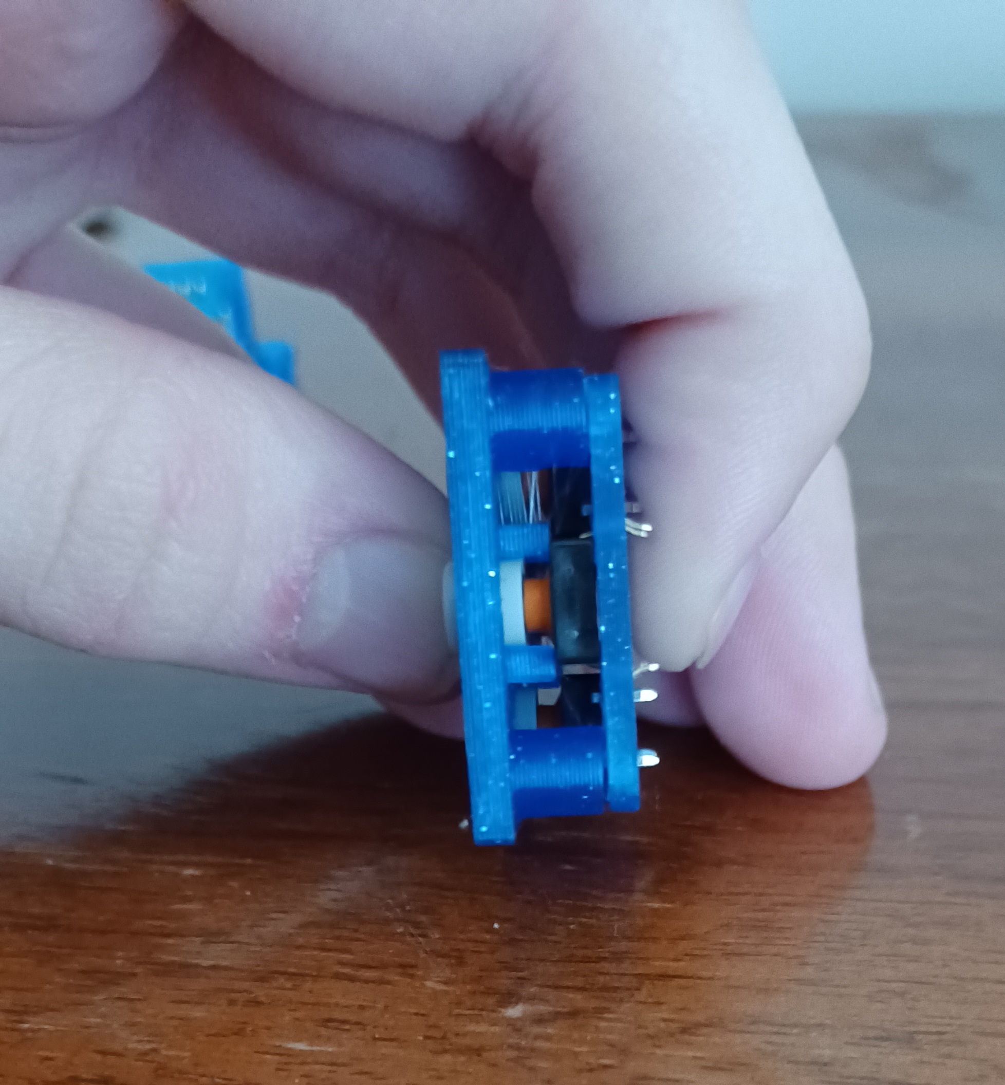

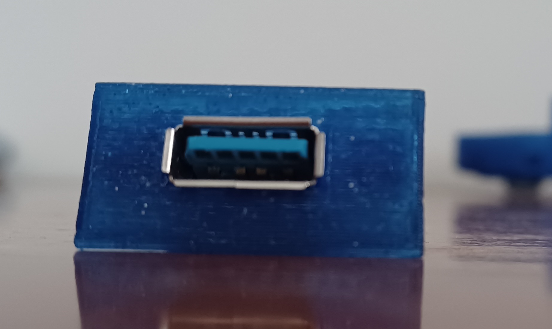

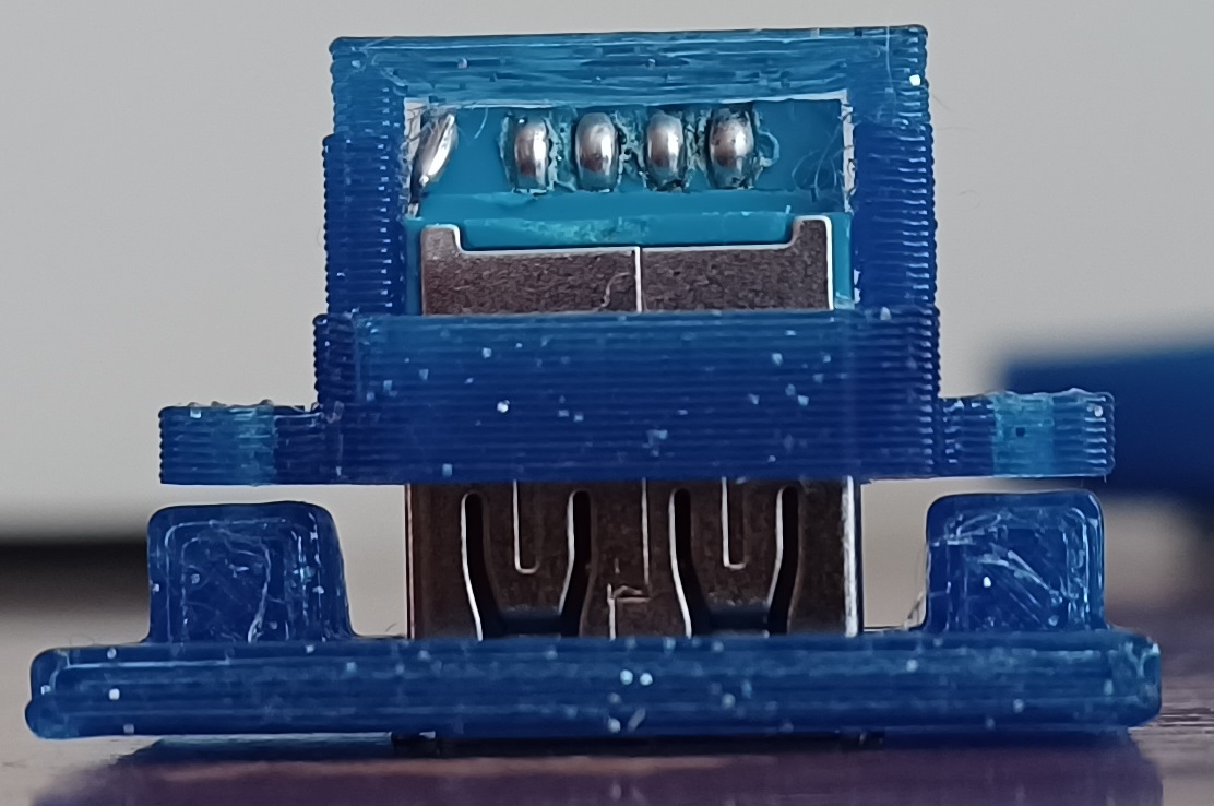

Custom USB 3.0 mounting solution (the bracket does lay flush with the screw posts, it's just floating to showcase the two separate pieces)

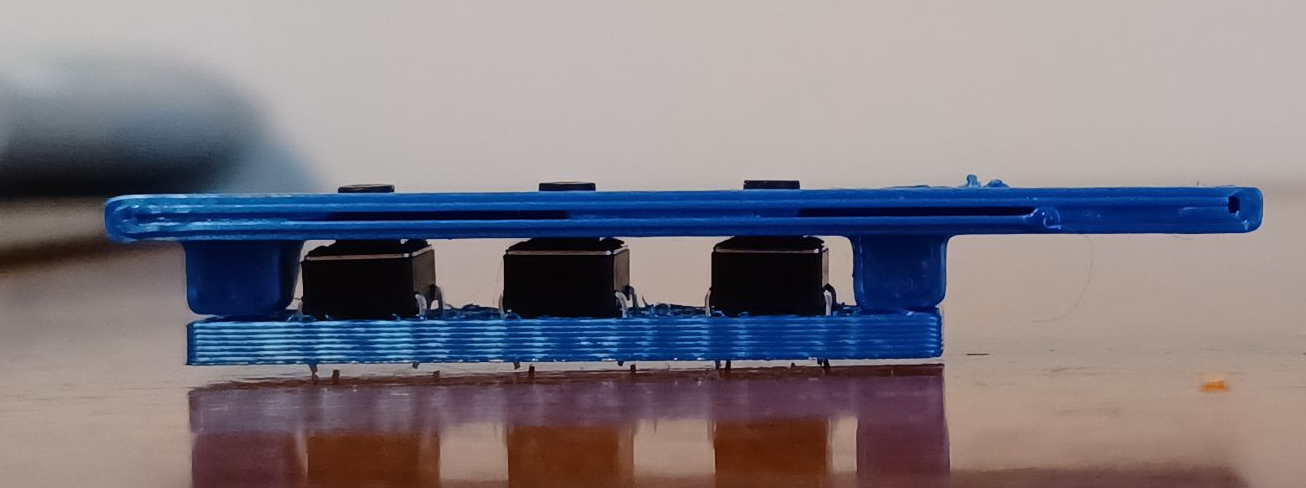

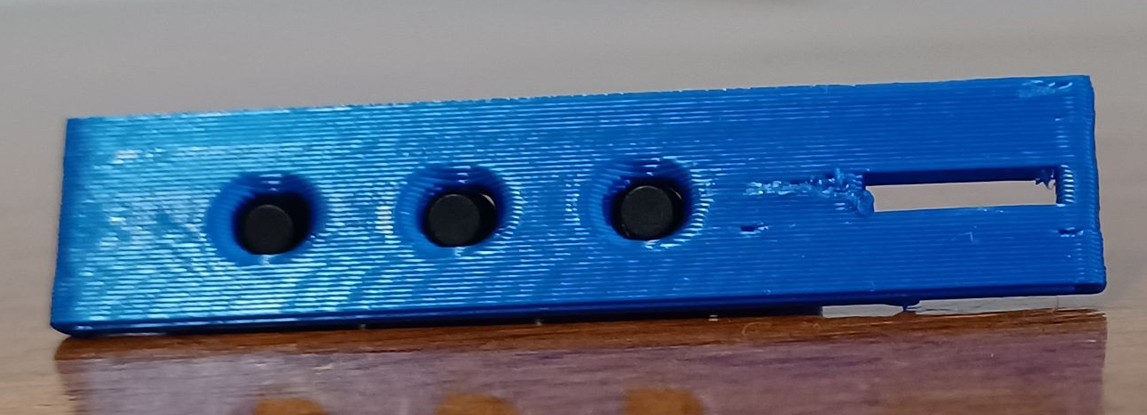

Since I plan on adding more buttons for reset, sync, and screen power, I've decided to divide the screen control bracket into two groups of three buttons:
The group on the top of the unit will be for screen power, reset, and Bluetooth sync.
The group on the bottom will be for menu, increase, and decrease for brightness, saturation, etc.
Here's what my groups of 3 buttons will look like (ignore the slit in the print, it's a WIP for the volume wheel):

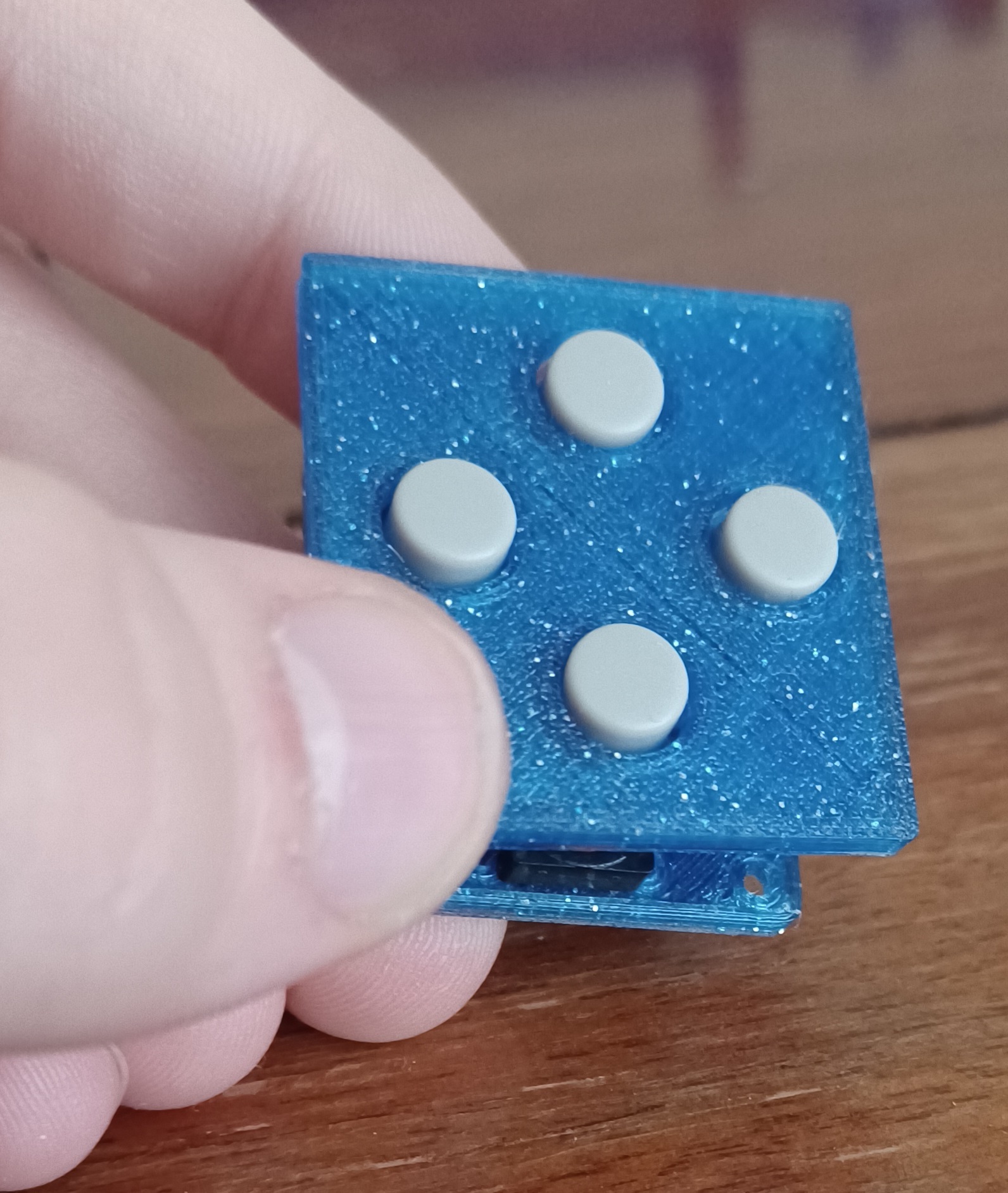

I've also decided to replace the Dpad with four pause buttons (out of personal preference). Here's what that assembly looks like:

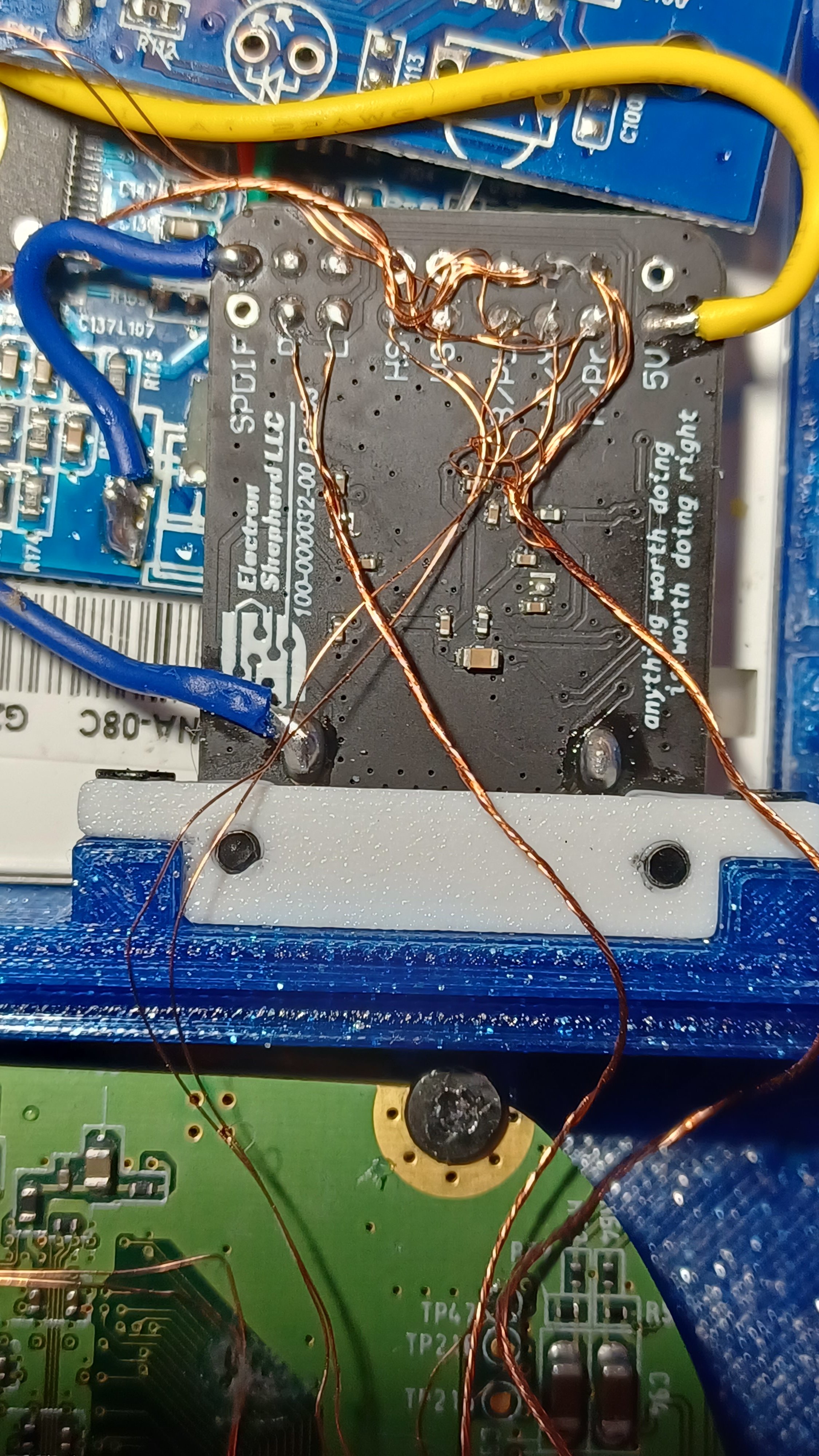

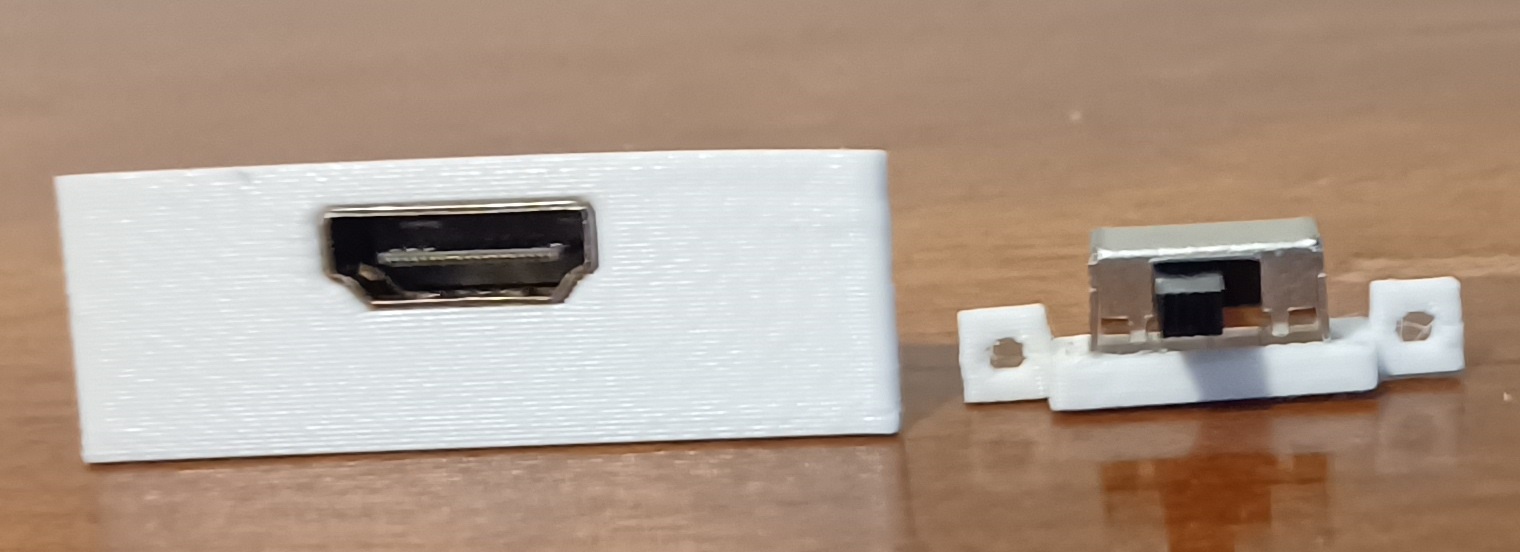

Time for an update! I'm still working on the top half of the case, progress on that has been slow, but it is almost finished. Here's a shot of my HDMI mounting solution completed:

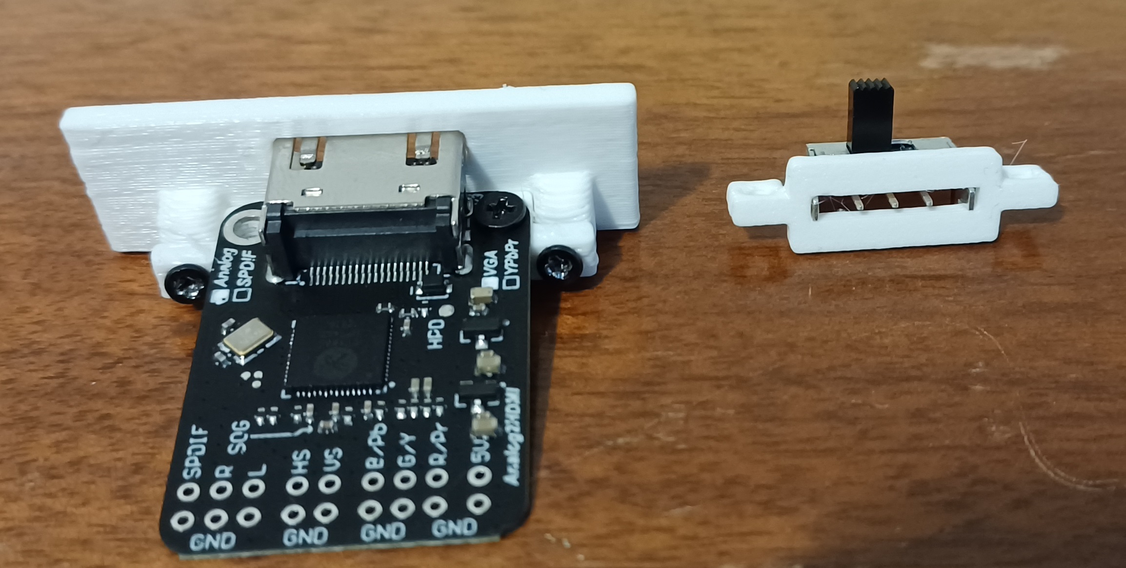

For this project, I'm using the Electron Shepherd HDMI board. It has two screw holes which mount into a bracket I've designed. Said bracket screws into the sample wall which represents the case. The switch works similarly except it shouldn't require any additional mounting, worst case I'll end up just gluing it.

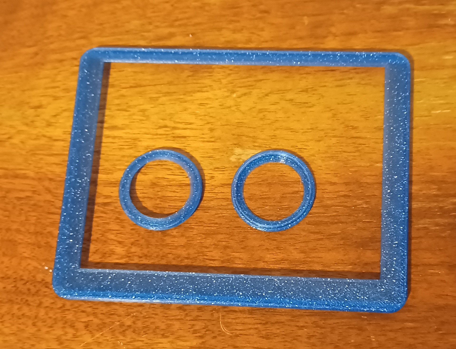

Since this project is using Wesk's remix, I've also printed out a set of button gates, and screen bezel. The ones from my initial post are glued to the top half of the first shell, but I printed a new set because that shell doesn't meet the criteria for this project anymore. Here's what those look like:

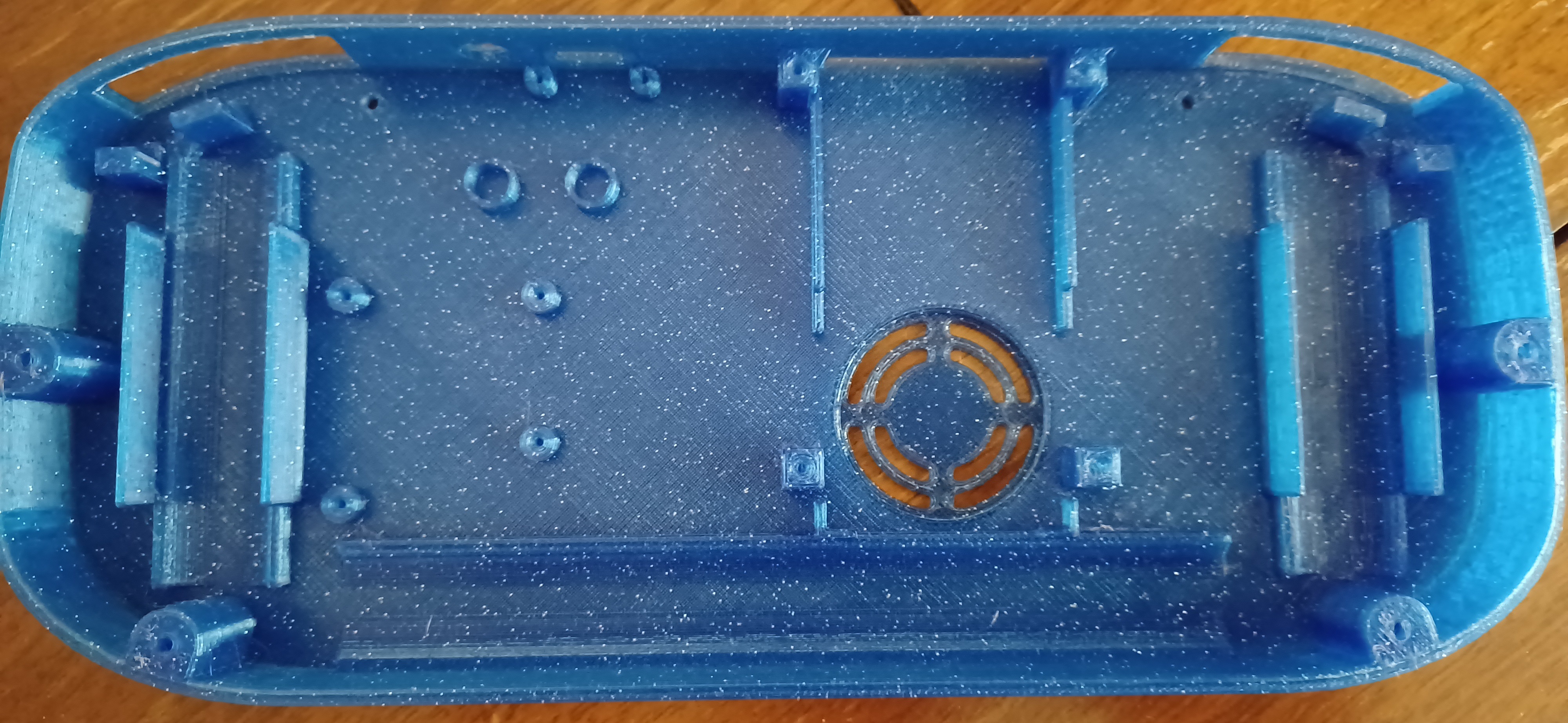

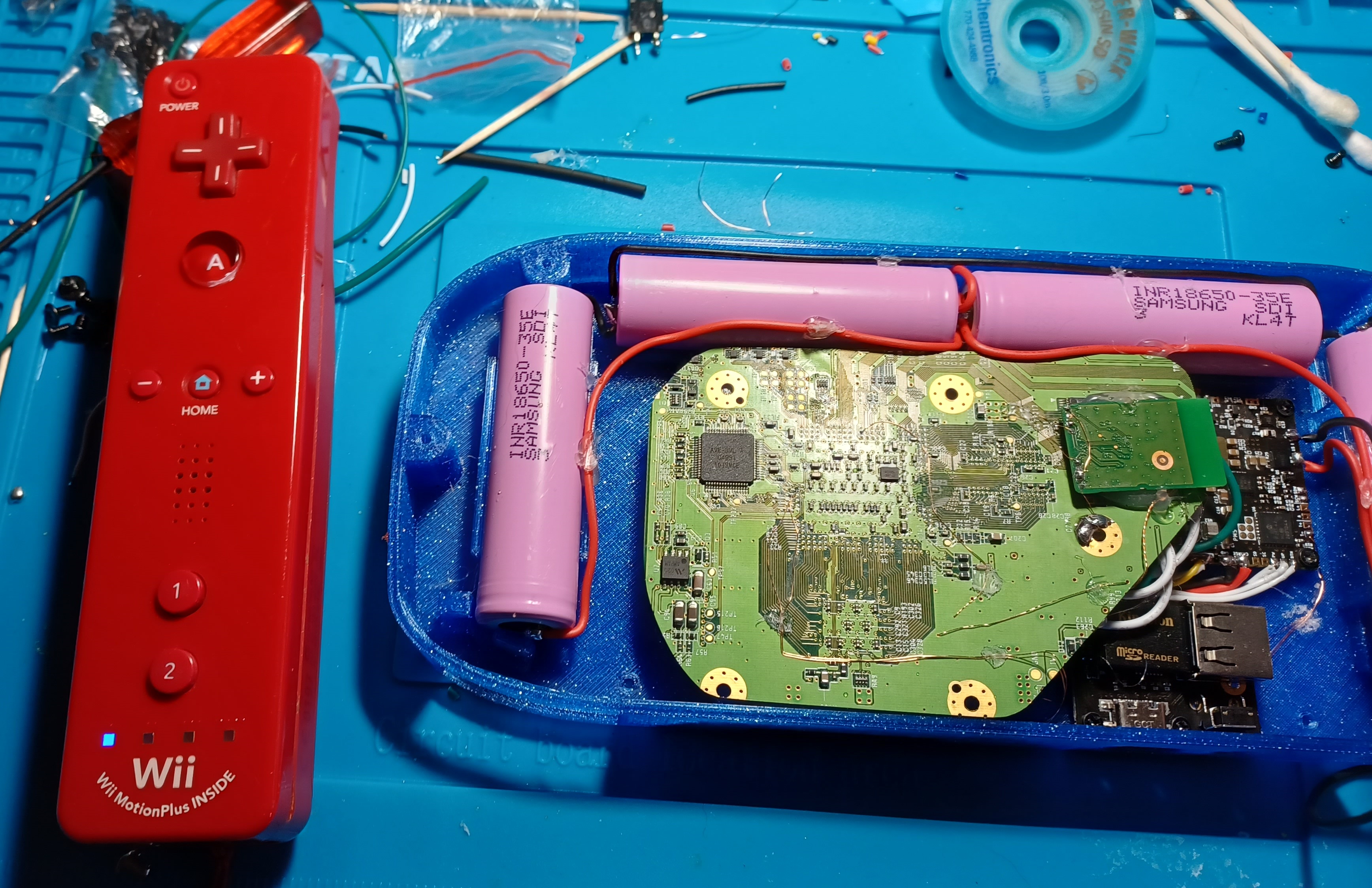

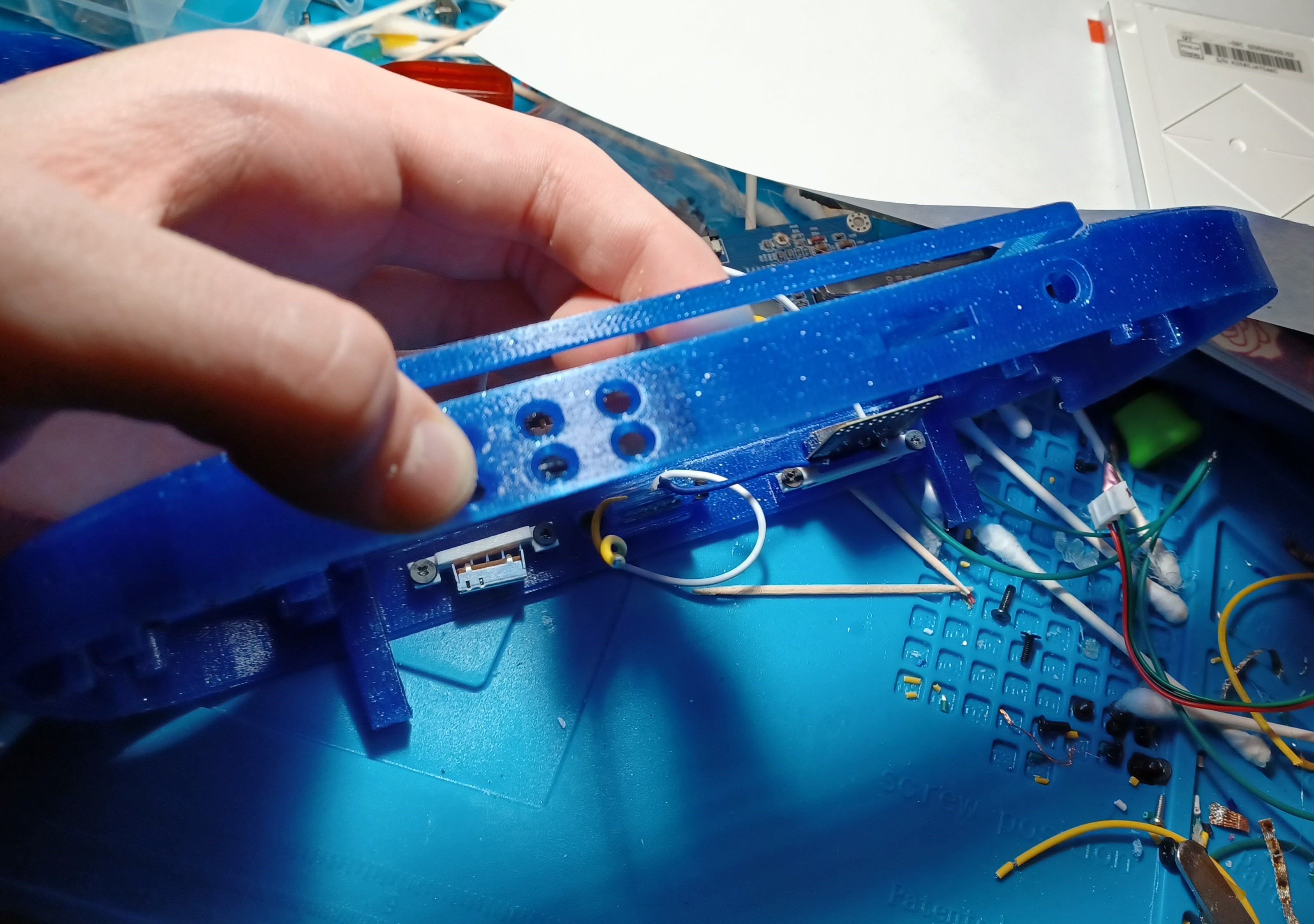

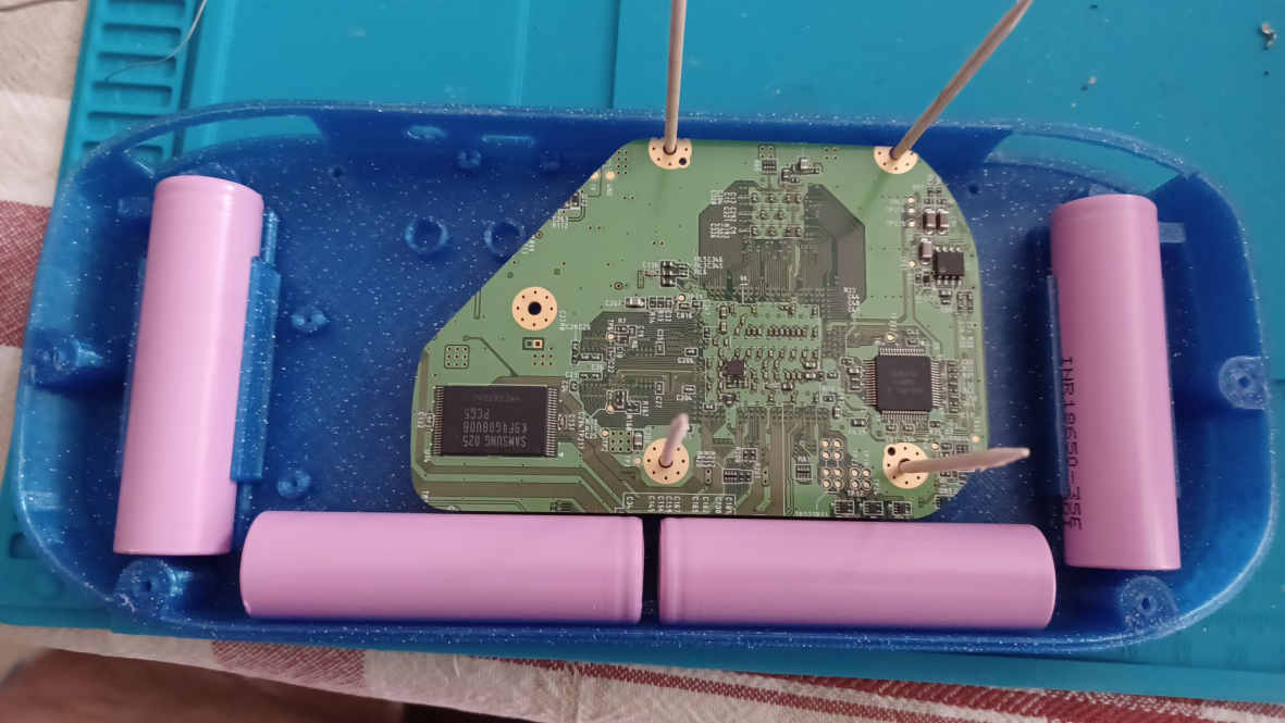

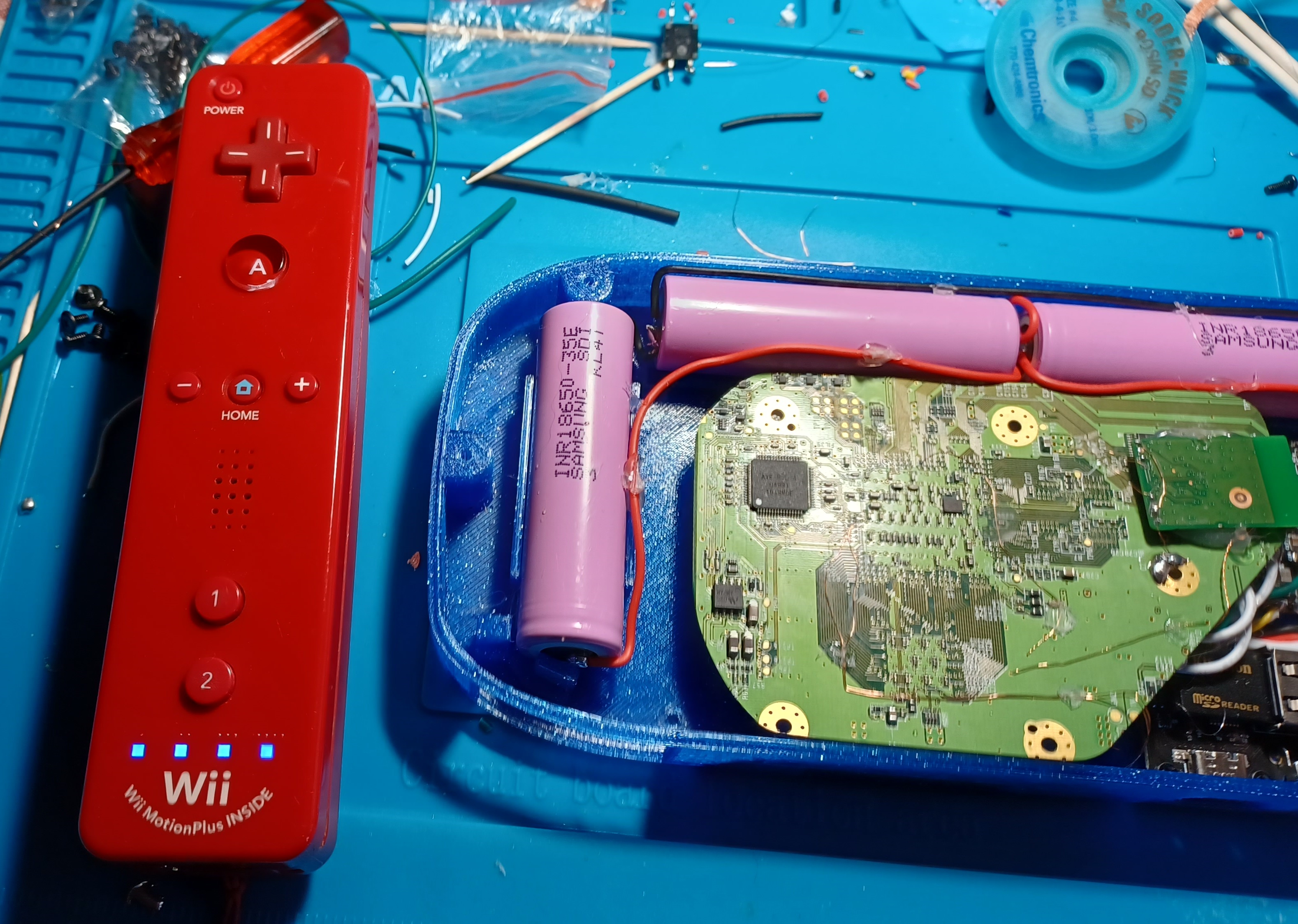

I've started the back half of the case, and have successfully wired up the batteries achieving fan spinage in the process!

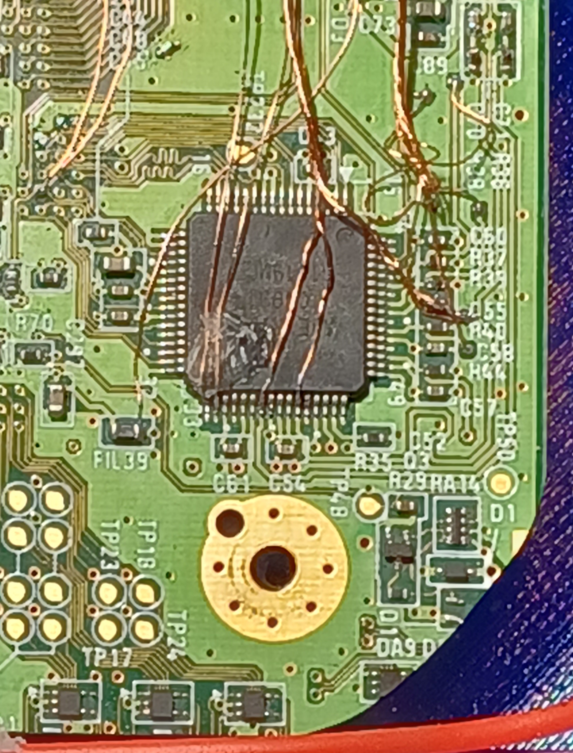

I wired up the Wii and Bluetooth while I was at it:
Not only that, but the trim appears to be working along with Bluetooth? I can't confirm conclusively because I'm still waiting from my screen to arrive, but I doubt Mr. Remote is lying considering I had to sync him post-trim (this was fun...):
I'm also assuming my USB data lines have been wired up correctly, because all four of the Wii remote's lights go on and stay on after I press A to presumably select a game (of course this is after waking up the remote meaning I have to press it twice).

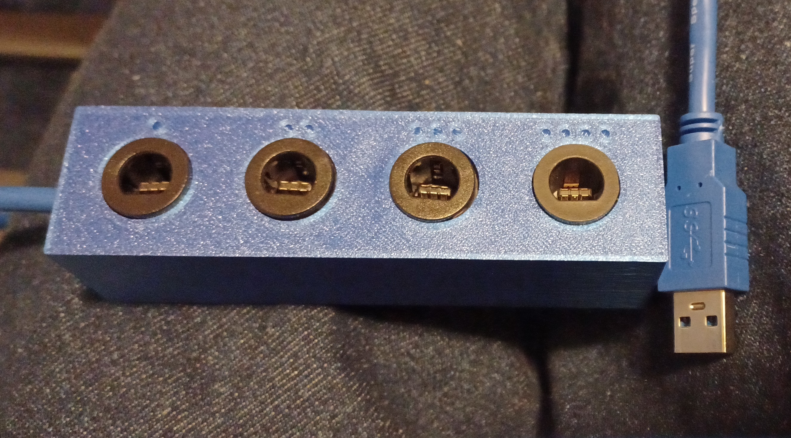

Whoops, I almost forgot! I also made a GC Hub which uses USB as a passthrough. The plan is to connect players 2, 3, and 4 to the USB port pins, and player 1 will be attached to the switch which will have a GC+2.0 mode (for normal portable use), and a GC controller mode for when the unit is being played on a big screen. Here's how the hub turned out (it's been tested and is working!):
Internals aren't too clean on this thing being that I used hot glue to mount the ports in it. That's also why they aren't perfectly flat, but it looks clean and works fine otherwise! Since the internals aren't anything to write home about, I ended up skipping taking pictures. It would've been hard to get well-lit ones anyways.

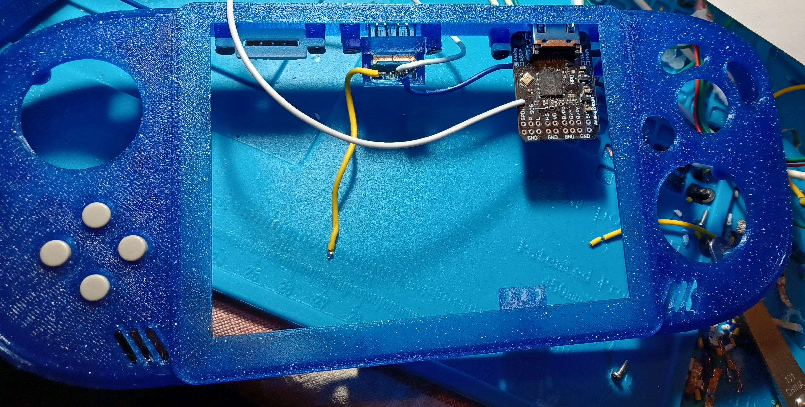

I'm overdue for another update and I actually need help this time, but we'll get to that. After nearly 3 months of waiting, the screen finally arrived! So I
decided it was the appropriate time to print the front of the case. I had a few dumb technical difficulties with getting the scaling correct - really I should've double checked the units the original case was printed at, but anyways here's what the final case is looking like with the screen in place:
Speaking of the screen, because this build features additional functions that aren't normally present in the G-Wii, I settled on locating them at the top on the top half near where the screen usually sits. I didn't think this far ahead when designing and as a result, the screen cannot be removed after the screen bezel is glued in place. Despite being fully aware of this after printing, I've decided to proceed being that I trust myself enough to not mess the screen up. This image illustrates what I mean about the screw posts making it impossible to remove the screen:
I still wanted to avoid gluing the screen to the bezel however in the off chance I'm somehow able to remove the bezel without destroying the screen (again, this is in the event that I need to remove the screen). So in order to do this, I glued the top half of the bezel without the screen inside, and then peeled up the bottom so I could slide the screen in like so:
I decided to hold off on gluing the bottom half of the screen bezel in place until a later point in this build. Again, if something were to happen to the screen... God DAMN it! I jinxed it... The screen's ribbon cable came with a break in it. I don't have any way of effectively showcasing what exactly I'm talking about, but basically, when the ribbon cable for the screen moves at all inside the unit, power to the screen is lost. At first, I tried securing it in a static position with hot glue, but I was unable to secure it in a manner that would hold up. I waited almost 3 months for this screen to arrive, and I really didn't want to wait for another one, so out of desperation, I tried another LCD panel I had lying around that looked similar. It turns out, it was the identical panel, it just had a different screen driver board, but this driver board ended up being compatible.

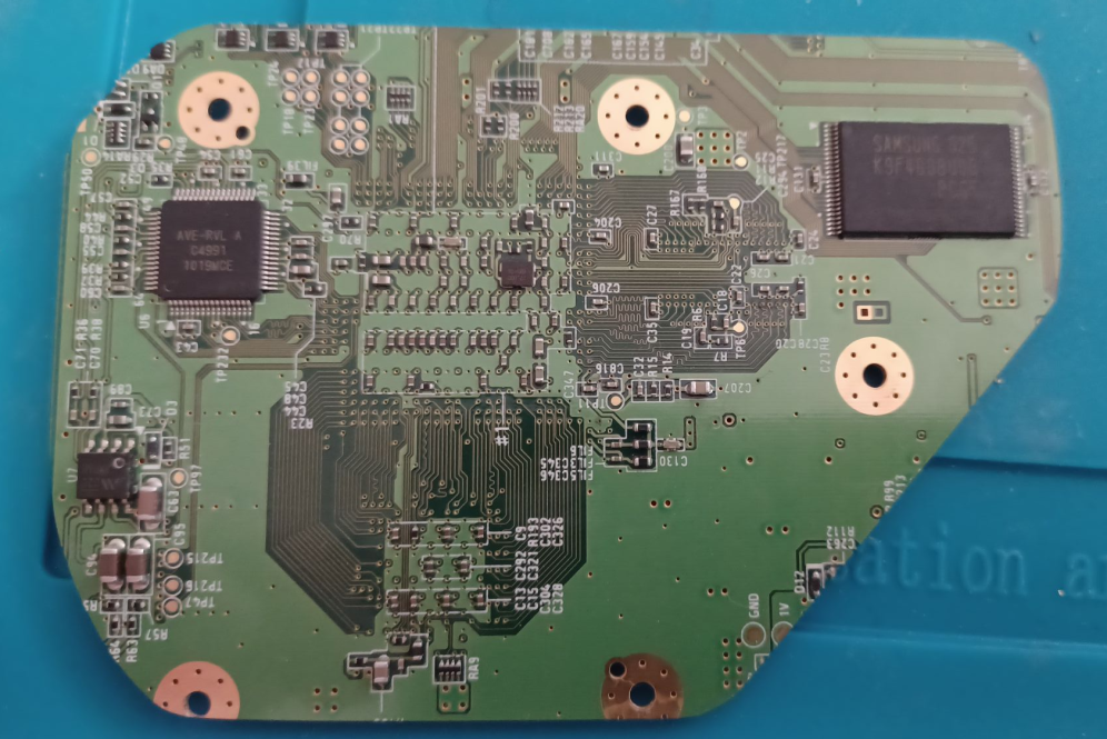

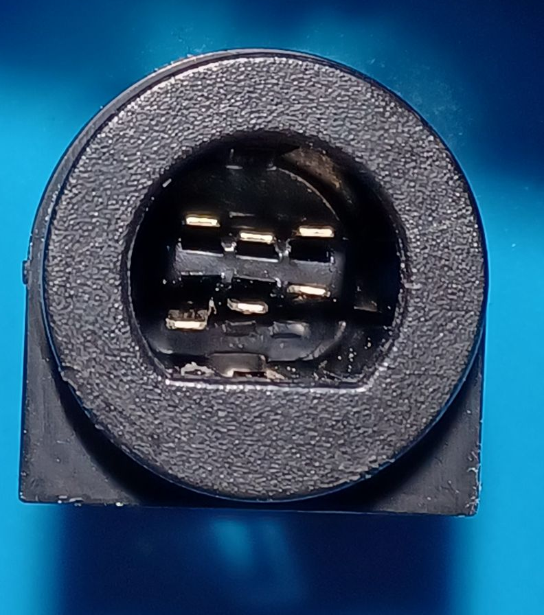

So it turns out, the HDMI board I bought is faulty. I don't know what exactly is wrong with it, but Shank suspects it is running the wrong firmware. Either way, I was able to get audio on the replacement board I ordered. I suppose that's what I get for ordering from Skent though, One of my gamecube controller ports was also broken when I got it - the pins were bent in an irreversible manner (and believe me, I did try to repair it):

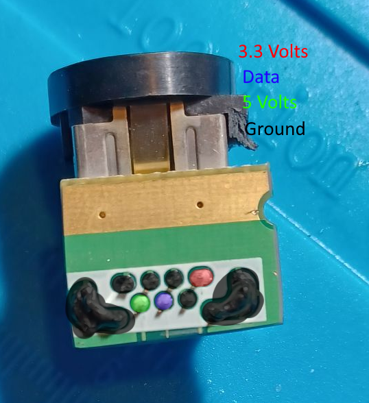

I decided to buy these because Curtis from Shank's discord did something similar to what this project is doing and claimed this was easier than trimming GC ports off a Wii. He was wrong though, it was honestly easier and more effective to trim all 4 ports off a Wii because these ports aren't attached to each other. This was a complete waste of money; do not buy these if you need GC ports. With all of this said, I needed to figure out the pinout for the OEM GC ports off the Wii in order to continue. I found a diagram on Mod Retro, but it was incomplete so I made my own. Here it is it anybody wants it:

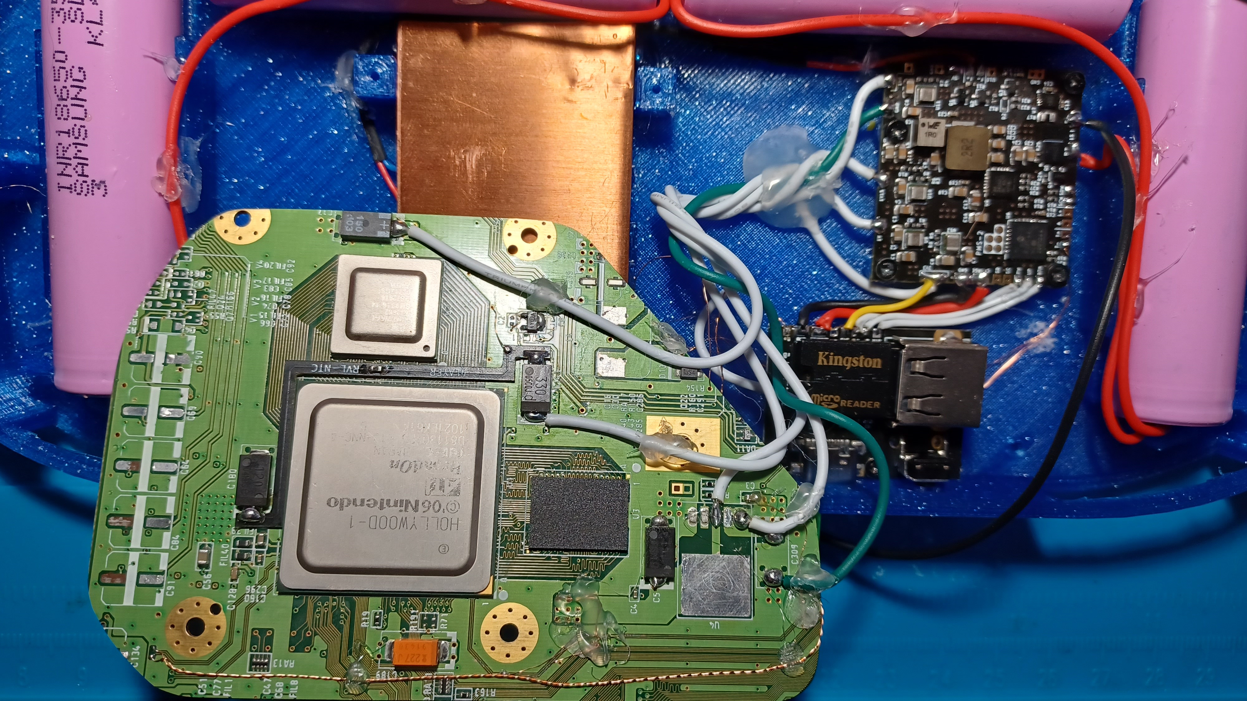

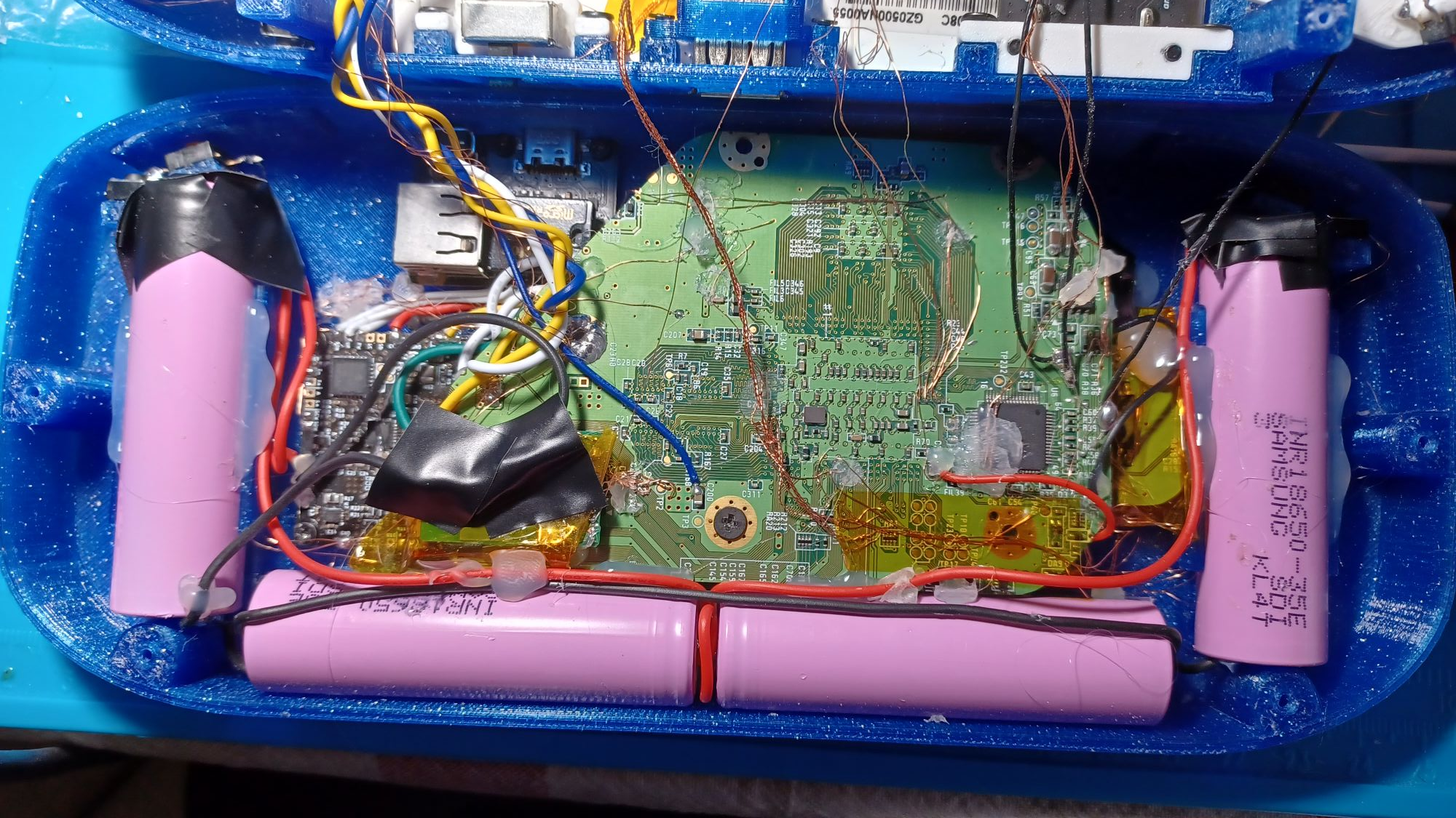

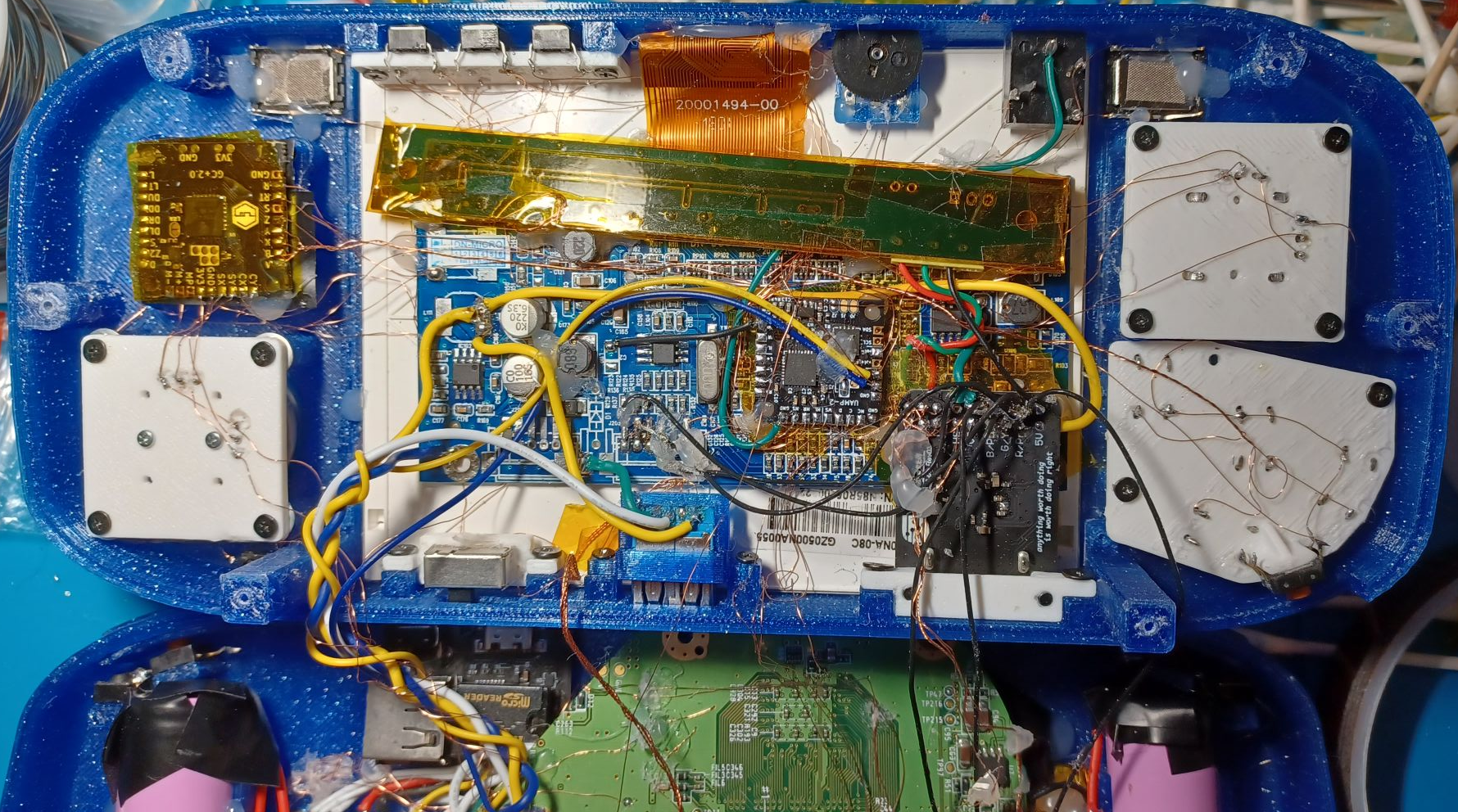

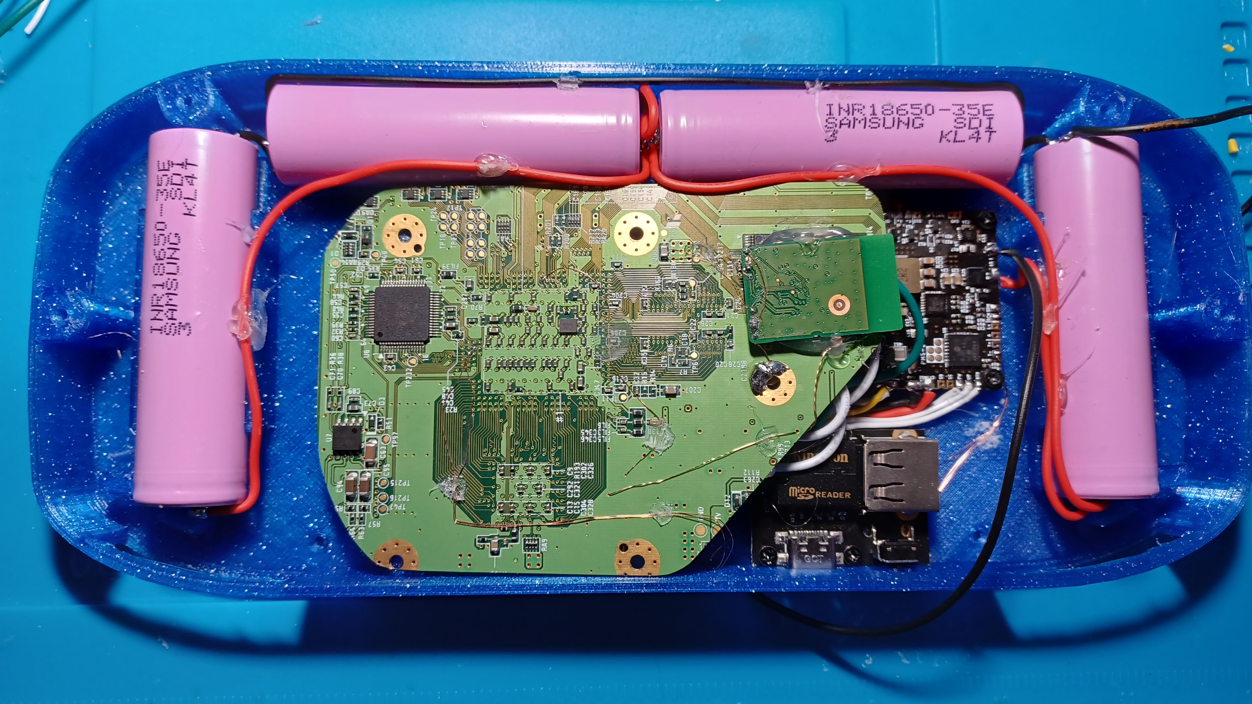

Anyways, I promised last post I'd share some internal pictures. I meant to keep this thread up to date, but once I got rolling on this project, everything kind of fell into place. I guess that's where building 3 other G-Wiis an Ashida, and a G-boy gets ya. Anyways, here's what the final internals look like:
Believe it or not, an attempt was made at keeping the internals clean, but I kind of just stopped caring once I got halfway through the project. The HDMI board mounts upside-down inside the case. This works well for positioning and orientation outside of the case, but was a source of interference for the video signal. Luckily I was able to circumvent this interference issue after an embarrassingly long trouble shooting session dedicated to fixing it and help from Shank.

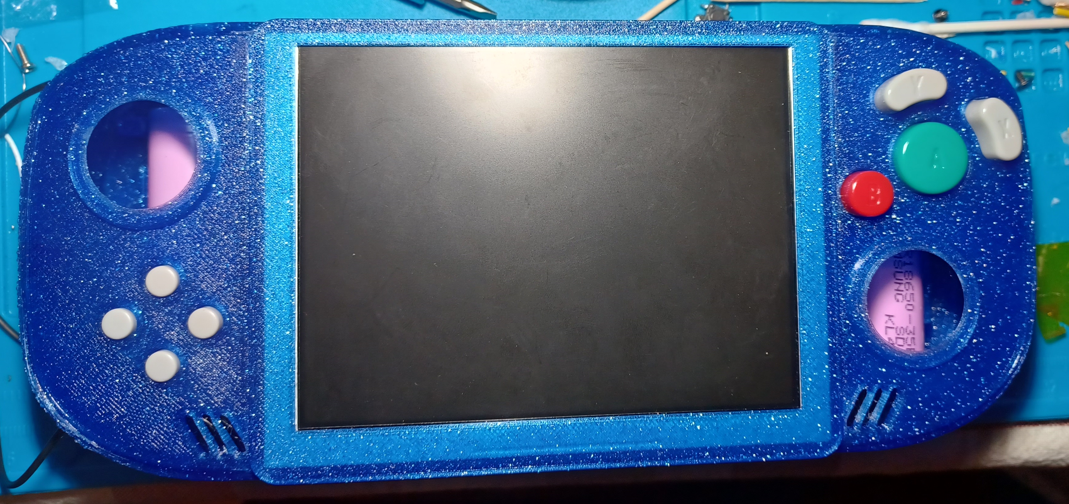

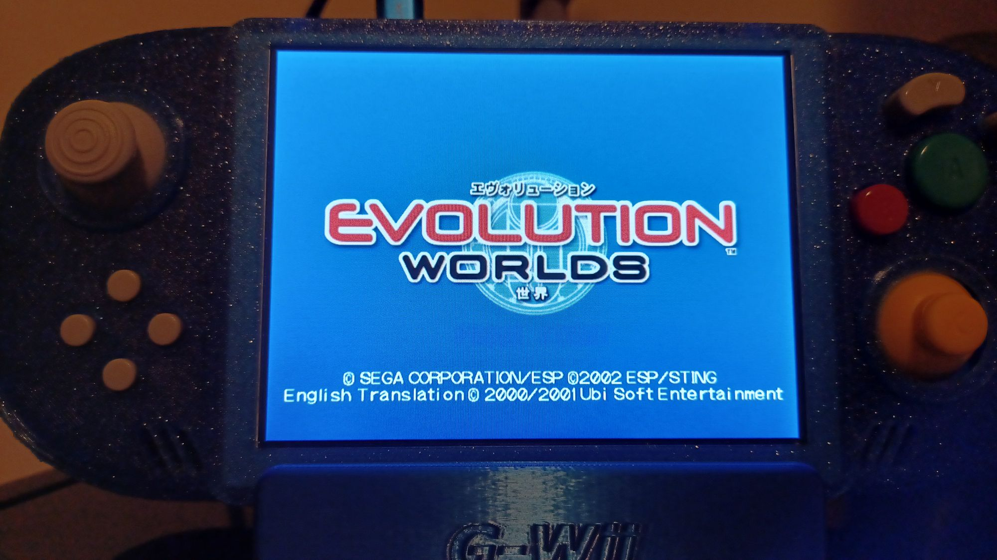

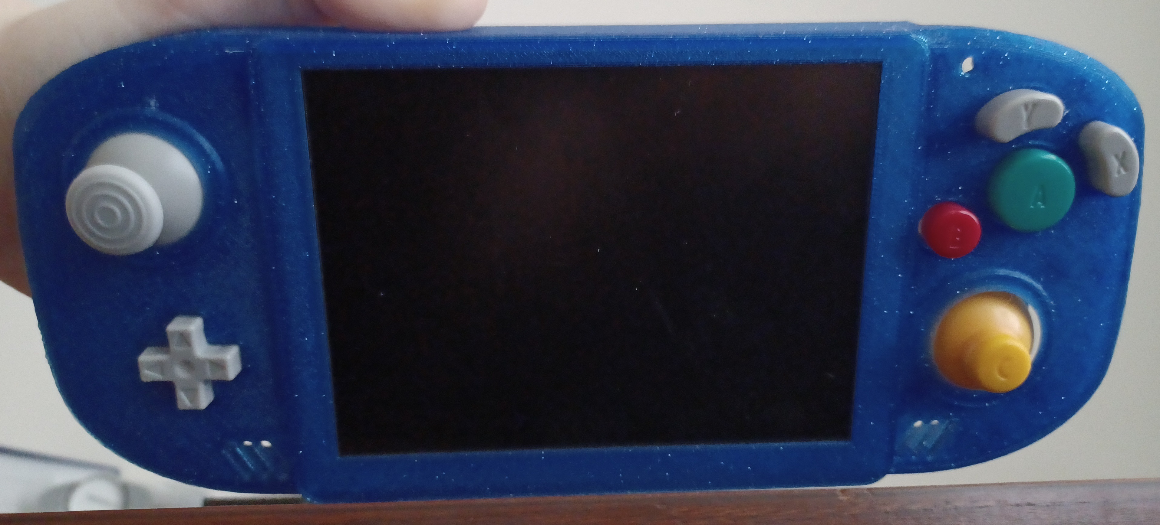

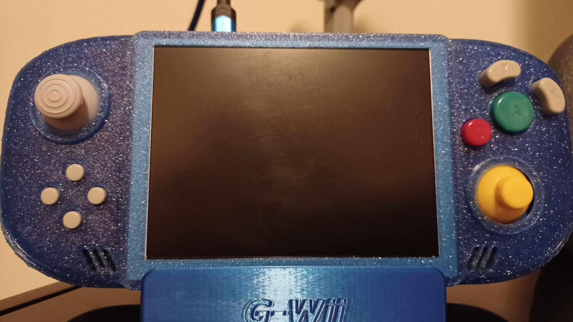

With a clean video signal, MX Chip and Bluetooth relocations, Volume Wheel, HDMI out, Full set of screen controls (including a screen power and Wii remote sync buttons) and working USB pass-through I'm happy to call this project complete. Expect to see a show-off thread in The Cutting Edge soon enough with a proper video demonstrating the HDMI, USB pass-through, and other cool features.
Anyways, here are some pictures of it completed:
The 4 pause buttons may look a bit strange, but they are very useful for games like Puyo Pop Fever and Tetris Party, both of which I play. I will get into more detail about this unpopular design in my actual show-off thread.

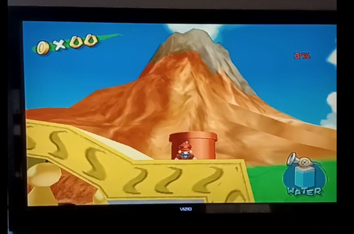

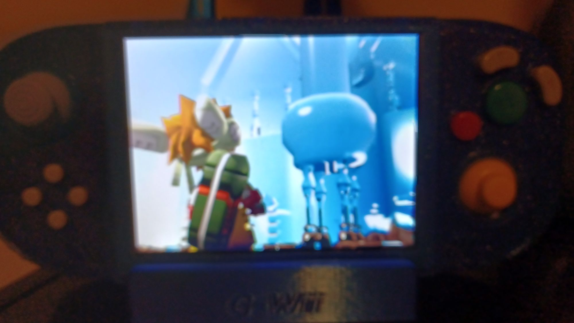

Here's a game running on it (pardon the light adjustment and one blurriness of image 2):

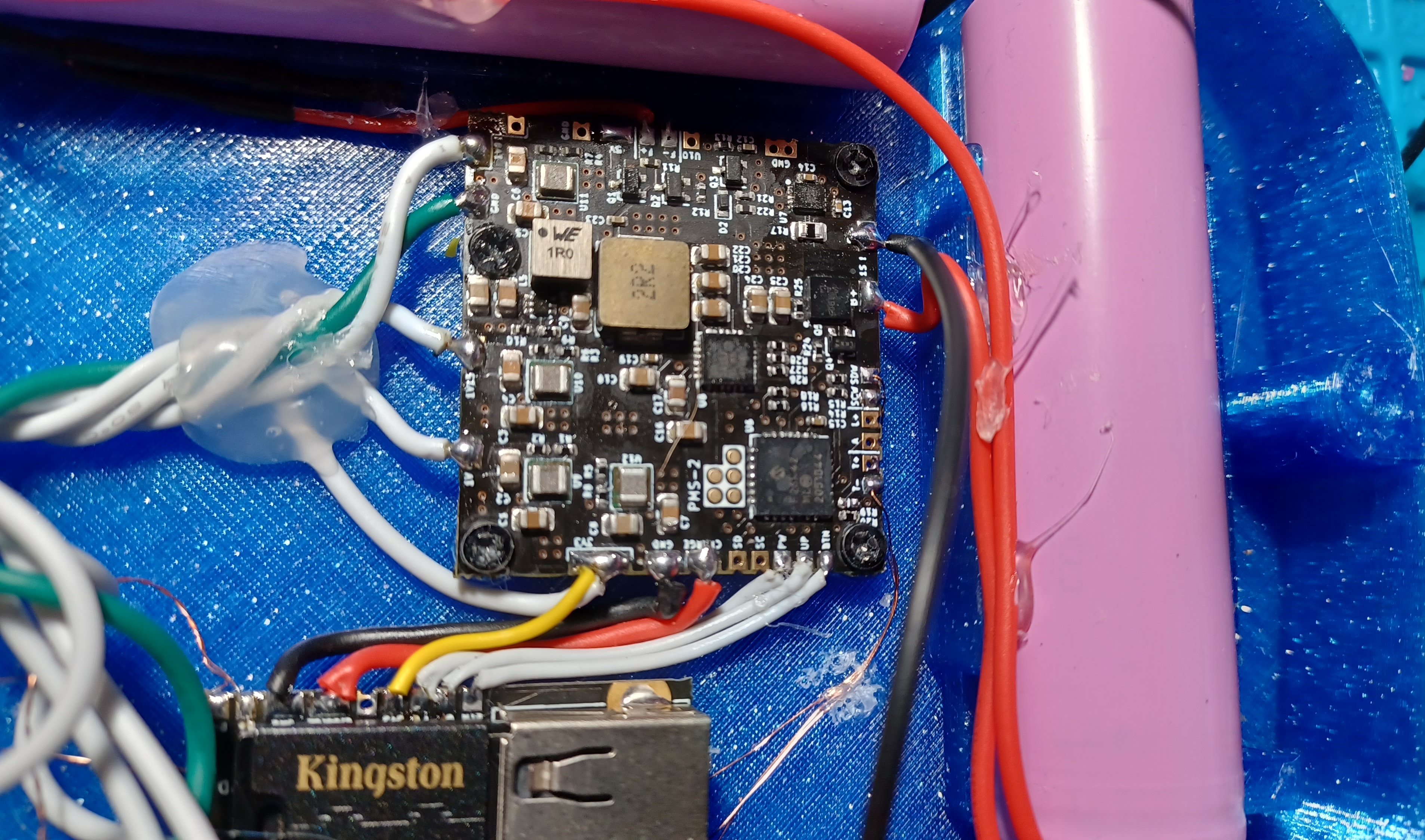

Okay so, sorry for the double post, but I'm realizing this seems to be drawing a lot more current than it should be. It gets worse the lower the batteries get, but at a full charge it draws -2300 mAs and when it gets lower it starts to draw around -3000. Regardless of how charged it is, it discharges faster than it charges by -600 to -700 mAs. It's possible that this is normal behavior, but it's going to reduce the battery life by quite a bit and one of my goals was to be able to charge and play considering it has HDMI out. Does anybody have any suggestions? Thanks!
Concerning your statement about the PMS charging, I don't think the PMS can charge as fast as the batteries discharge. I remember seeing this on a different thread and @CrazyGadget gave this response:
From what I've heard, the PMS is not able to charge as fast as the batteries discharge, so charge and play will just lengthen the overall discharge time, but not let it actually charge
As for the battery discharge... I'm not sure what to say. I'm not an expert, but your batteries look like 3,500mah in 1S4P, and if they discharge at 2,300 milliamps (and going on 3,000 milliamps), that should still provide you with 4-5 hours of battery life. In my opinion, as long as nothing is blowing up or making a giant squeaky noise (and as long as it's getting as many hours of play time as it should), you should be fine.
After reading this and having time to sleep on it, I decided to open the unit back up to disconnect 5 volts from the HDMI board to see how much current it was drawing. It didn't make up the entire difference (normal G-Wiis draw around -2000 mA, give or take one to two hundred), but it made up a lot of it (-500 mA or so). Between that, the USB, and the bluetooth module (this is being compared to another G-Wii that doesn't have bluetooth), I don't think anything is wrong.
Thank you for reassuring me that things are probably fine. I could have added a switch to disable HDMI and the extra USB and I might still at some point. But for now, I'm happy with the result and I'll do a proper battery life test sometime soon. I doubt it'll get the 4 to 5 hours of battery life it should simply due to the extra current draw from these features, but that's really not a big deal as long as it is reasonable.

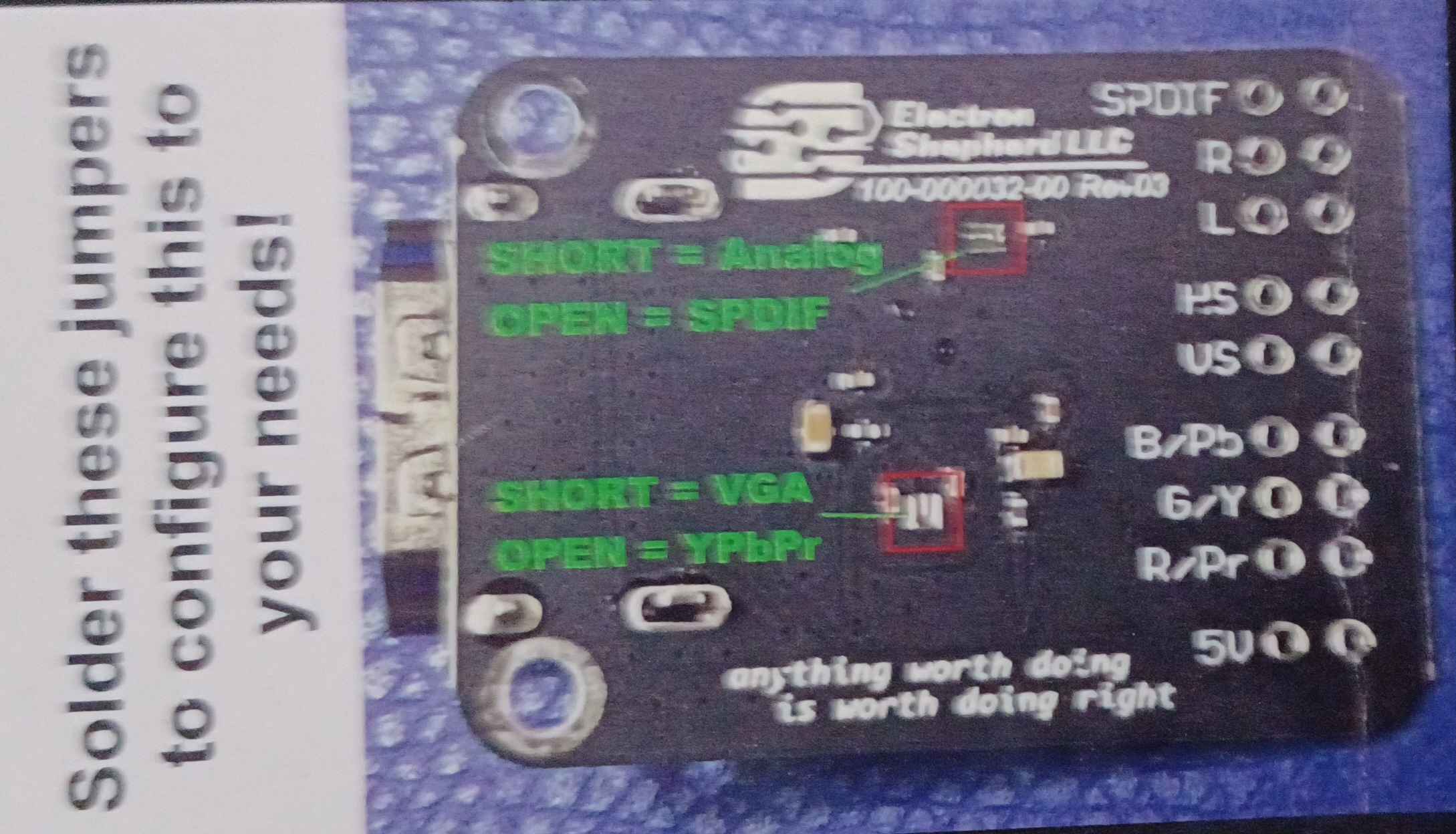

Sorry to bump an old dead thread but I wanted to follow up on my HDMI issue.
A little while ago, I ended up ordering another Analog2HDMI board from Skent, and with this board he included this card:
After taking a close look at the HDMI board I was trying to use in my Starlight G-Wii, I found that the Analog jumper was closed meaning that the board was in SPDIF mode. I'm not sure how well known this is, but I thought it was worth following up on since this clearly wasn't too well known and it caused me some problems. I have since tested the original HDMI board I was using, and with the jumper closed it works fine.
Hi! I'm trying to do something similar as an upgrade to my ashida, but I wanted to ask what data lines did you solder the female port to? As for the hub itself, is there a micro controller translating the inputs from gc -> usb, or are they just a one to one connection to the male part of the usb?
  • Like
Reactions: cy
The USB port just passes straight through to the player 1-4 points on the motherboard. There is no micro controller or anything, this does mean that the hub is only compatible with my unit and wouldn't realistically work on a PC or anything like that. If you're talking about the female port as in the USB 3 port, I soldered wires to 3.3v (power), GND, 5v (for rumble support), players 1, 2, 3, and 4, on the motherboard, and I'm pretty sure that's it. Which wire you solder where doesn't matter too much so long as your hub's pinout is consistent with the port.
Okay, so I was just overthinking everything after all lol. I was thinking I'd have to program a micro controller and end up making my own adapter. Thank you for saving me a headache. :D
