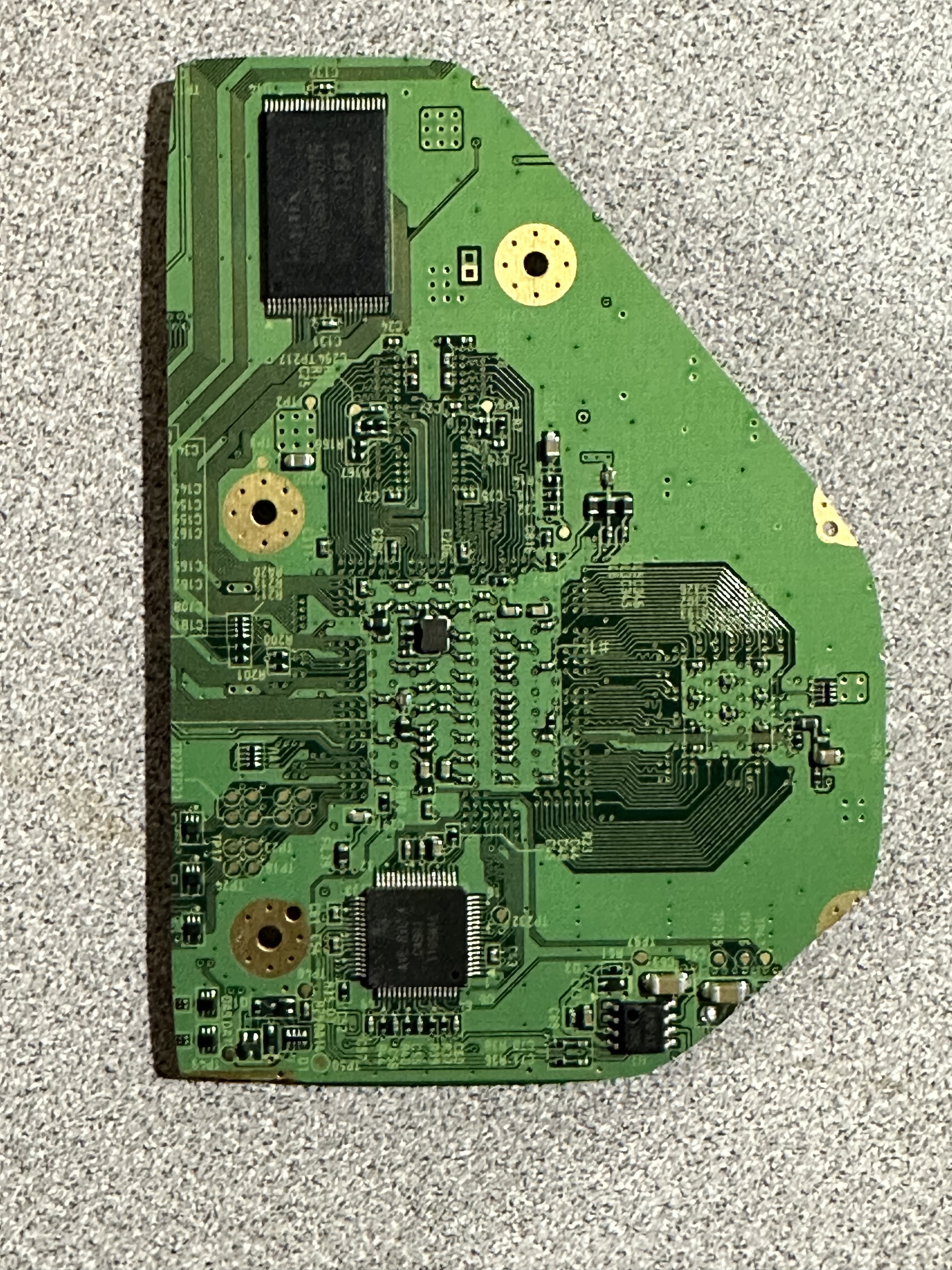

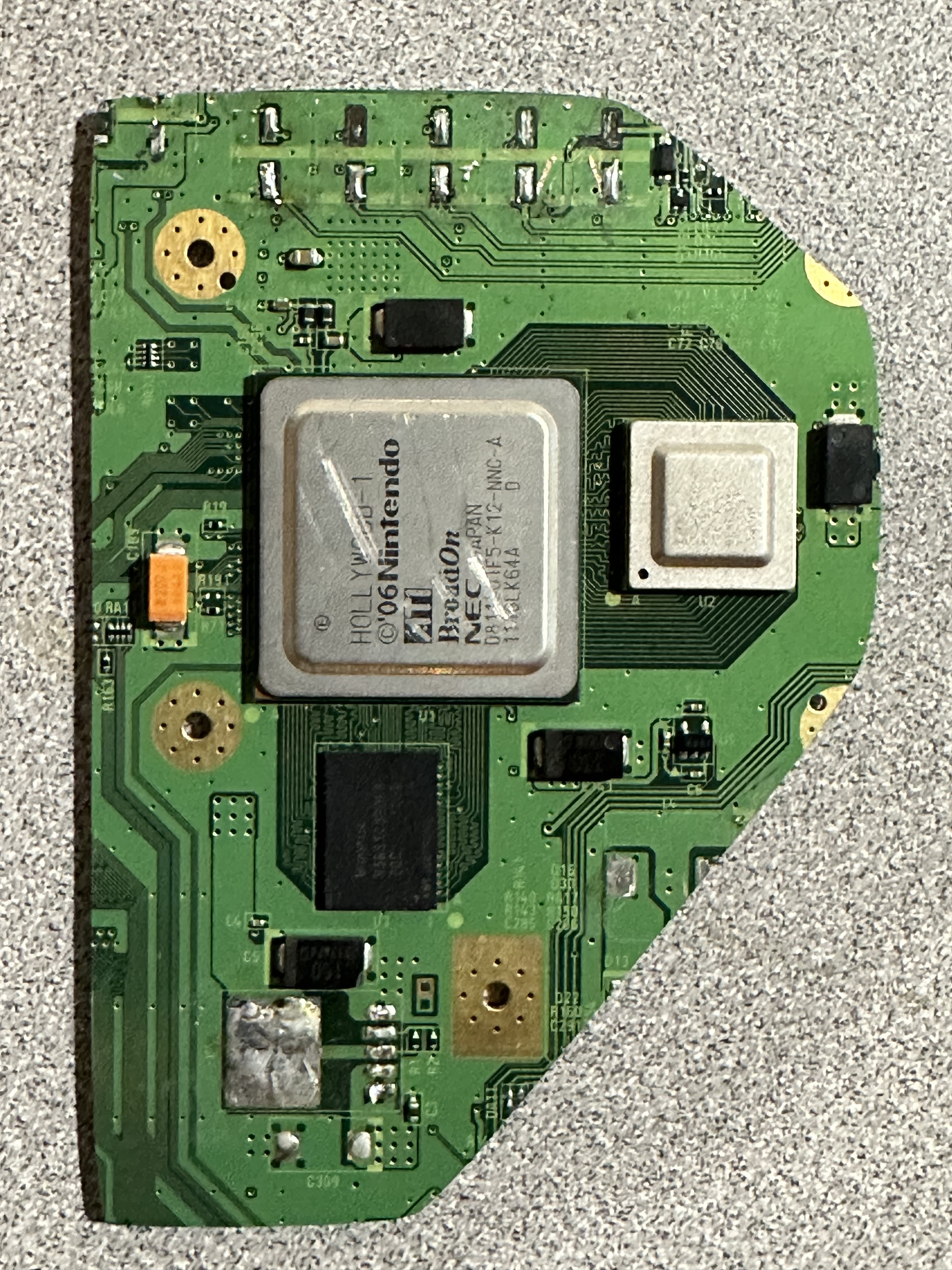

Just to double check before proceeding, is this a serviceable trim?

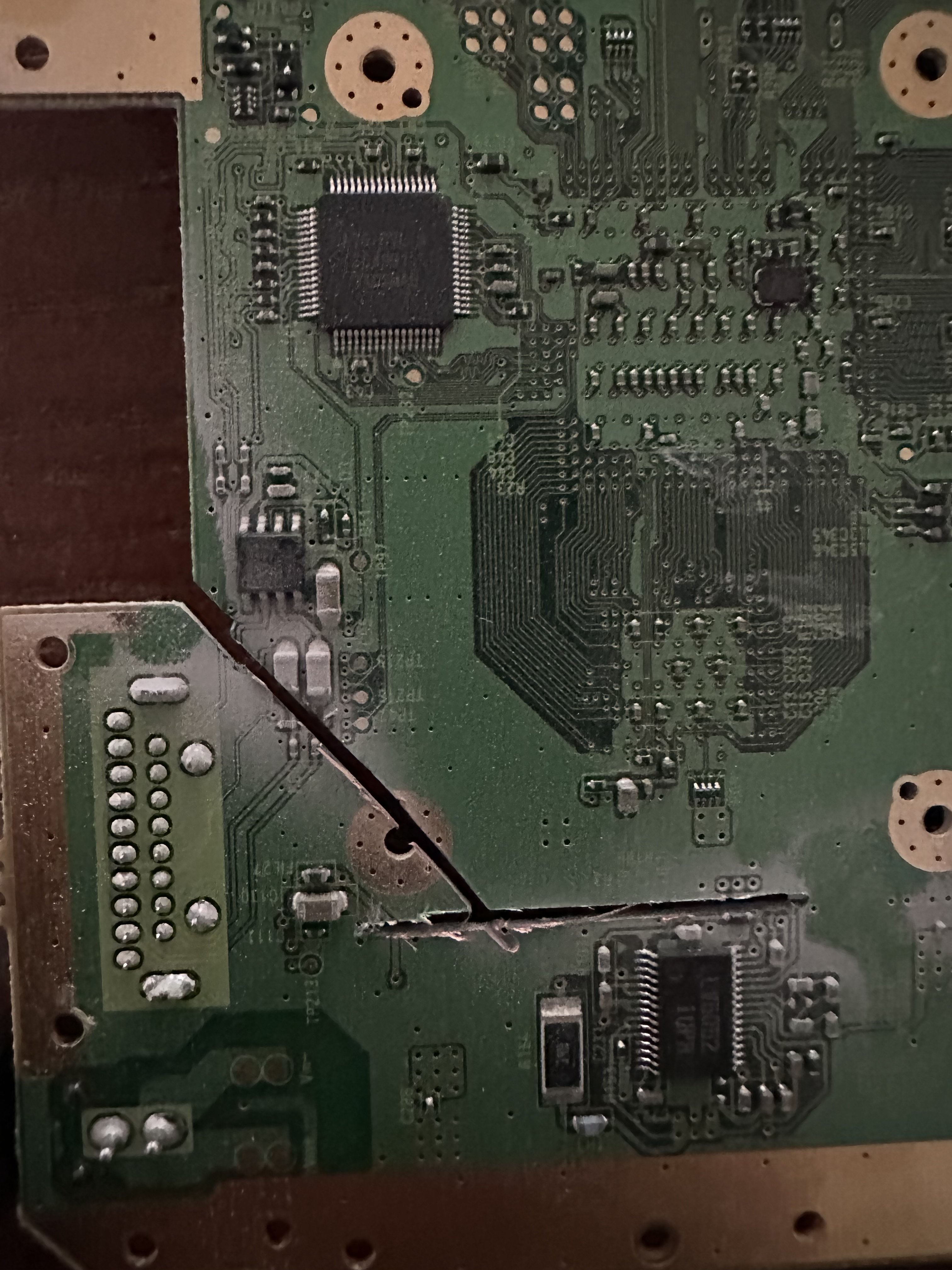

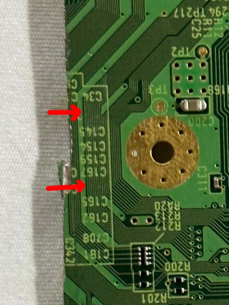

The edges are jagged and need some good sanding, but be careful of the NAND traces.
You don't have much margin there, so be careful not to sand into them

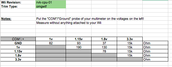

My resistances mostly match the trim resistance thread, though 1.15V over gnd is about twice what most others got. I'm assuming it is fine and moving on. I've also included final trim images.

Those restances look fine, there's always some variance between trims. For the PMS U10 you don't have to do anything with U5. The U5 does nothing on a trimmed Wii and we just use it as a handy matching footprint to relocate the U10 chip to for convenience. When using the U10 pad on a PMS, you only have to run a bit of magnet wire from the U10 pad on the PMS to the U10 via on the Wii. All the other U10 relocation steps aren't needed
