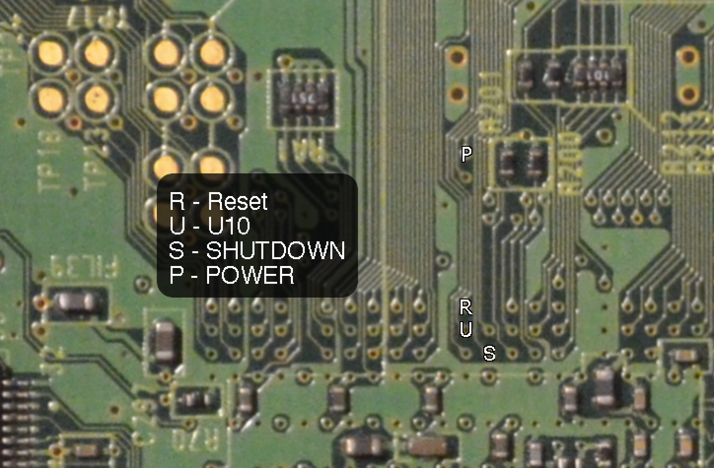

The POWER and SHUTDOWN GPIOs are available on the following vias:
If you want to just respond to a “software initiated shutdown” then you’ll need to wire your microcontroller to the SHUTDOWN GPIO via, and detect when the pin goes high.
If you want to initiate a soft shutdown yourself, (eg. triggered by a power button press) you will additionally need to wire your microcontroller to the POWER GPIO via, and send a ~30ms HIGH pulse when your power button is pressed.

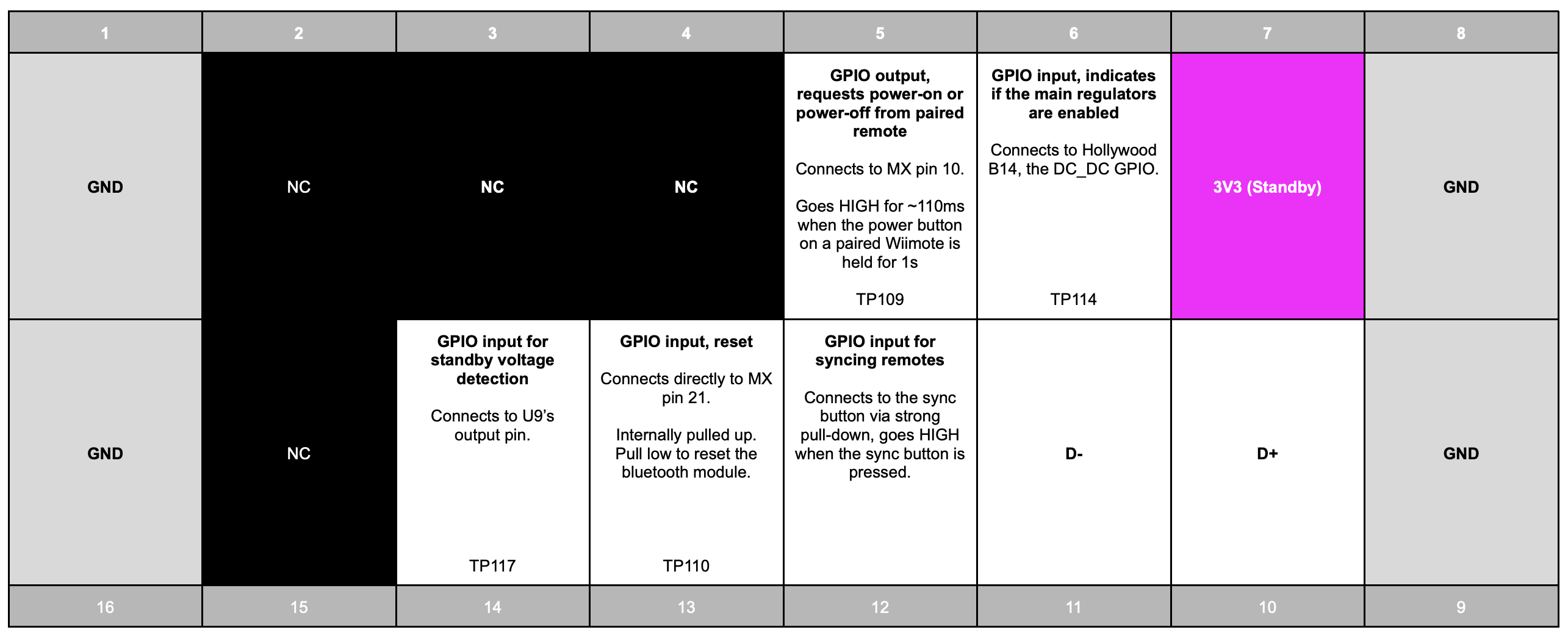

While I was researching this project, I took some time to further document the pinout of the Bluetooth module.
One tangential discovery was that, contrary to the Wii trimming guide, you don’t have to provide 3.3V to pin 13 of the Bluetooth module. This pin seems to act like a “reset” for the Bluetooth module, and is internally pulled-up to 3.3V. So that’s one less wire you’ll need on portable builds with Bluetooth!
