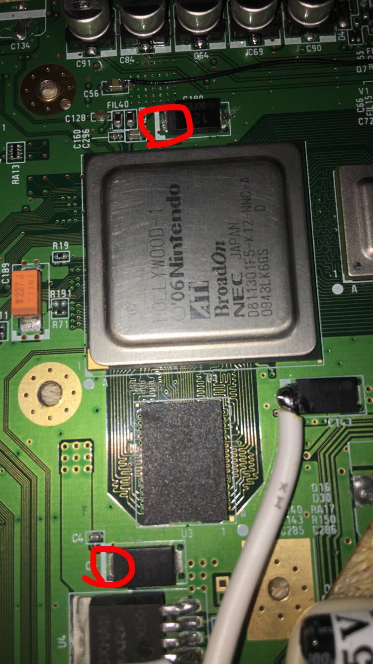

Thanks1.15V seems a little high, i'd try to lower it to atleast .17
3v3 seems okay, I'd try to raise it a smol bit imo.
other than that it seems fine![]()

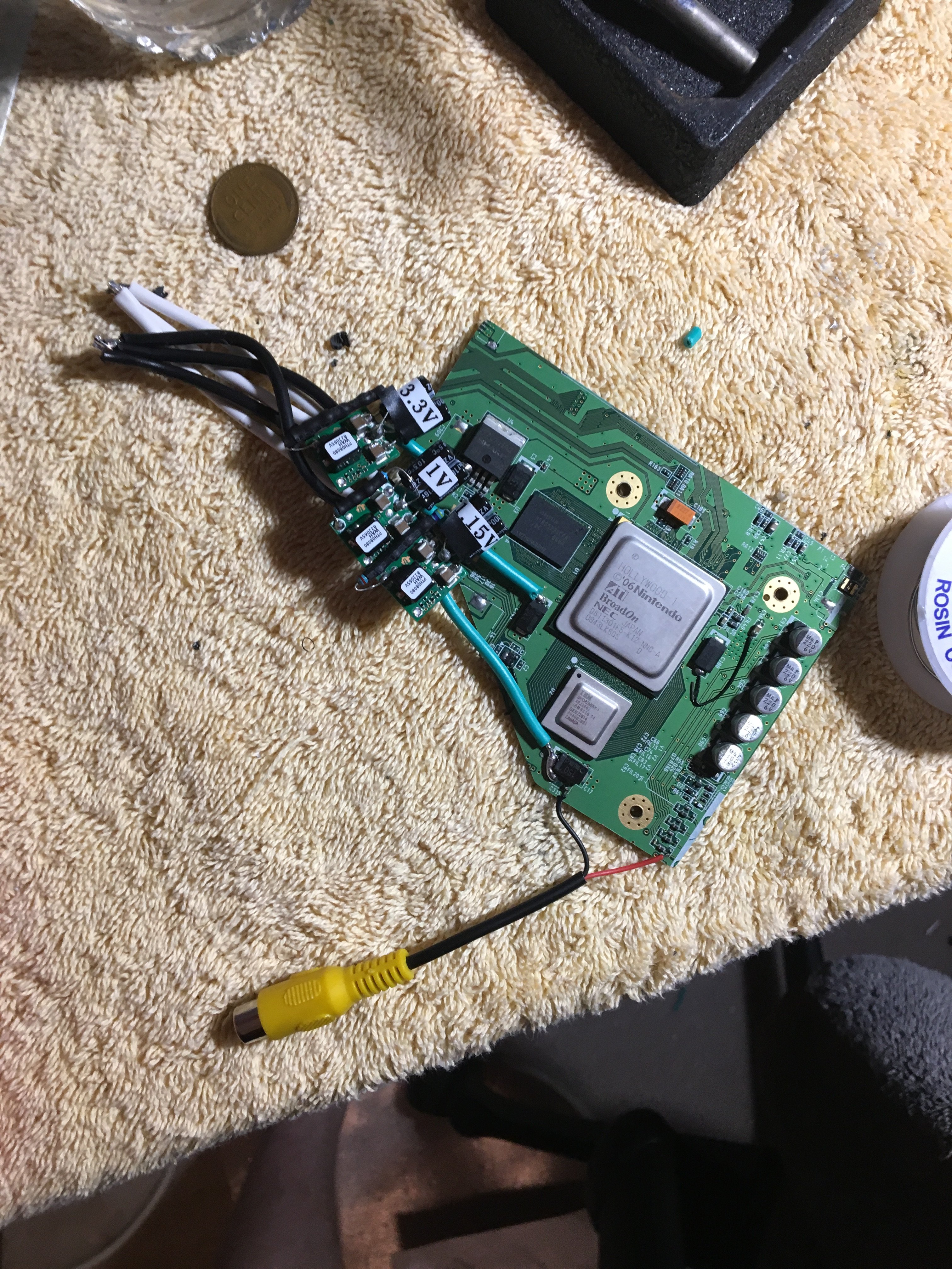

... Is my Wii dead?No video signal. I thought PortablizeMii had a menu pop up without USB... I’ll report back once I troubleshoot the 1v.When you say no video was there no signal or a black screen? If there was a black screen, then you need USB wired up before there will be video. Alternatively you can short the reset via to gnd to see if priiloader boots before wiring up USB to confirm the trim worked. But you should definitely figure out what's up with that 1v line first. That sounds problematic but I doubt your Wii is dead.
Perhaps there is a short between 3.3v and 1v?No video signal. I thought PortablizeMii had a menu pop up without USB... I’ll report back once I troubleshoot the 1v.

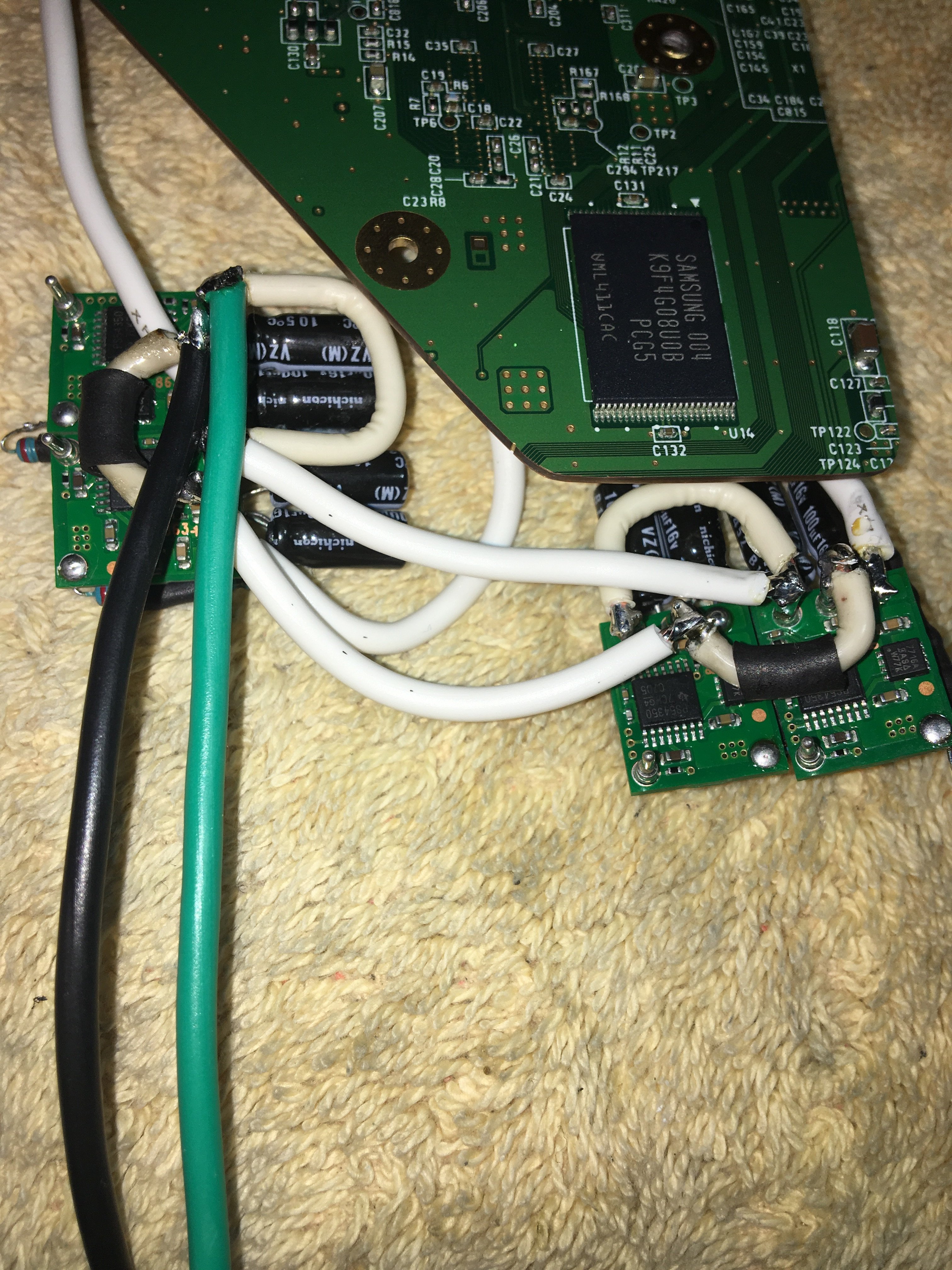

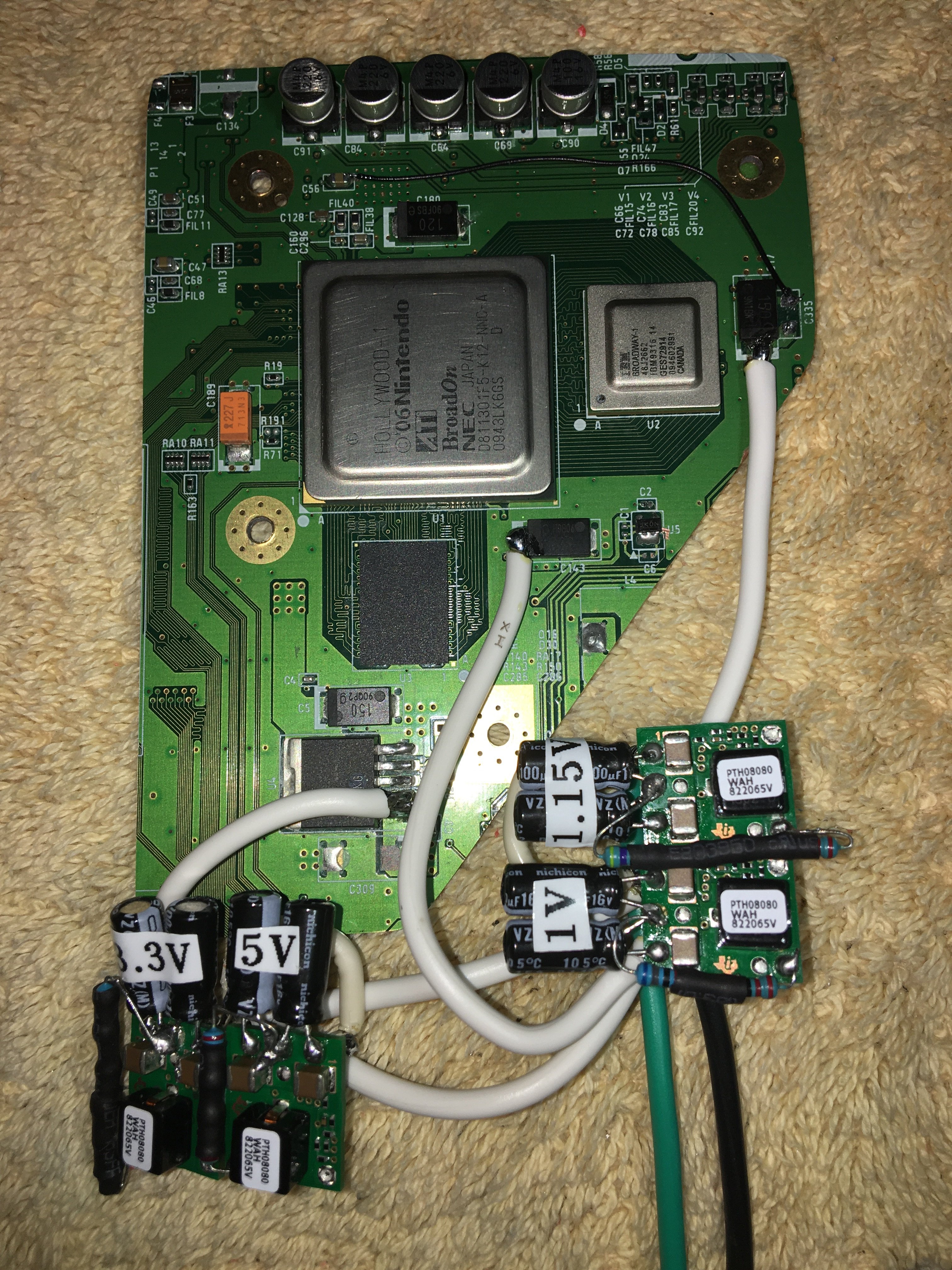

Edit: Very weird... 1v is .97v when connected to the board alone, but When it’s connected along with 3.3v and 1.15v it outputs 1.2v. I need help figuring out what’s wrong.
*When 1.15v and 1v are both connected to the Wii there are no problems
*When 1.15v and 3.3v are both connected to the Wii, 1.15v becomes 1.2v.

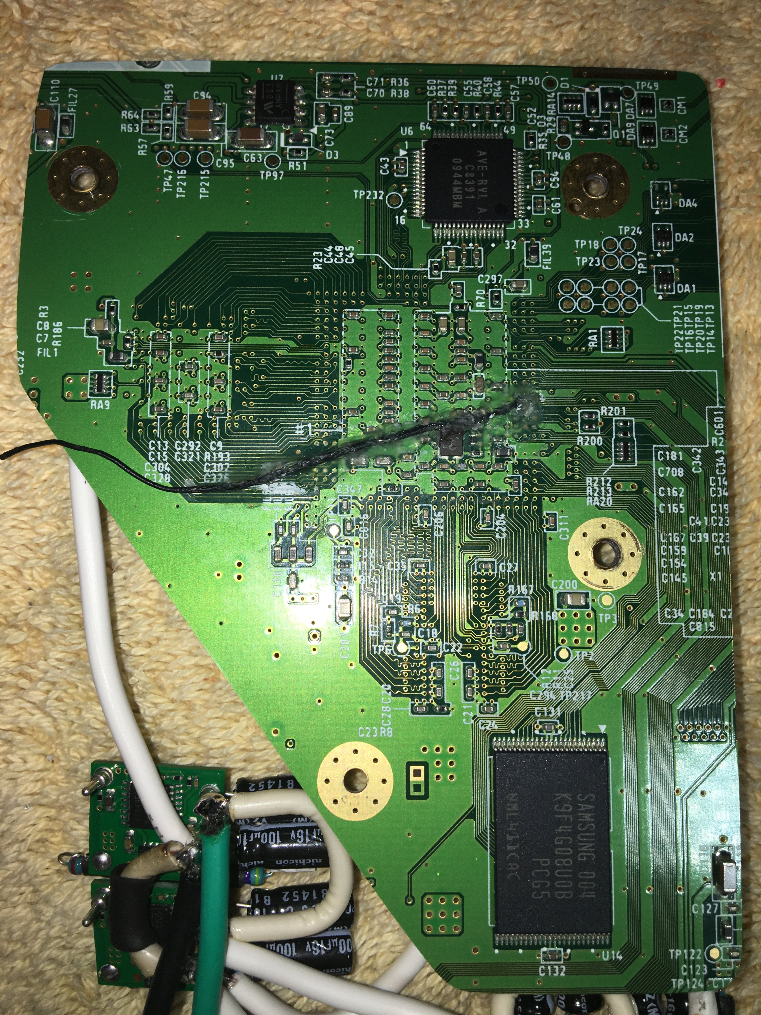

There is a short between 1v and 1.15v. Time to sand some more.Perhaps there is a short between 3.3v and 1v?
