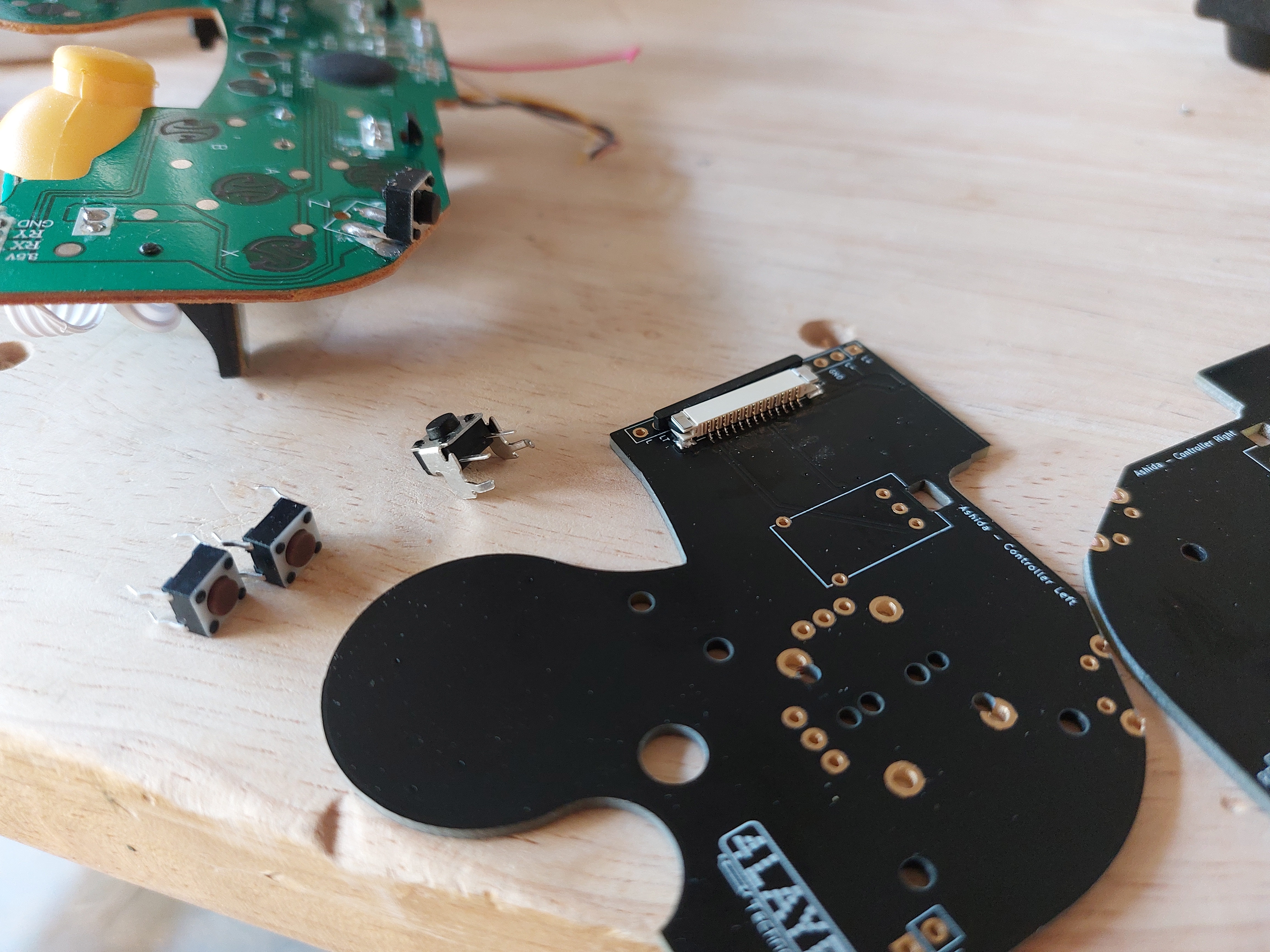

Instead of making lots of threads for my questions, I am going to ask them all here. Hopefully that is alright. Here was my first question about z button switches.
Hey all, started putting together my own ashida today. The picture enclosed shows the ashida controller pcb, an extra switch i ordered that is the same as the power button, the two z button switches I sourced from the BOM, and a third-party gamecube controller pcb I figured I would open up to salvages parts if i needed them. A broken, original gamecube controller is coming in the mail that I will harvest most controller pieces from.
So I am thinking that the BOM might be wrong about these digikey switches I ordered? They are not right angle mount switches to my knowledge. I do like their feel however.
The extra power switch I ordered is a right angle mount, but actually faces the wrong way (inside the controller) instead of out to where the z button will be placed.
Obviously I don't really want to harvest that dingy z switch from the third party controller, especially since it only has 2 solder points.
Assuming the original controller has the switch I need, I would still require an additional switch for the other z button. Any advice for making one of these switches here work, or a link to buy a proper replacement?
Thanks Wesk. I'll wait to see how the original switch feels but I will definitely use at least one of those ones I ordered from the Ashida BOM.

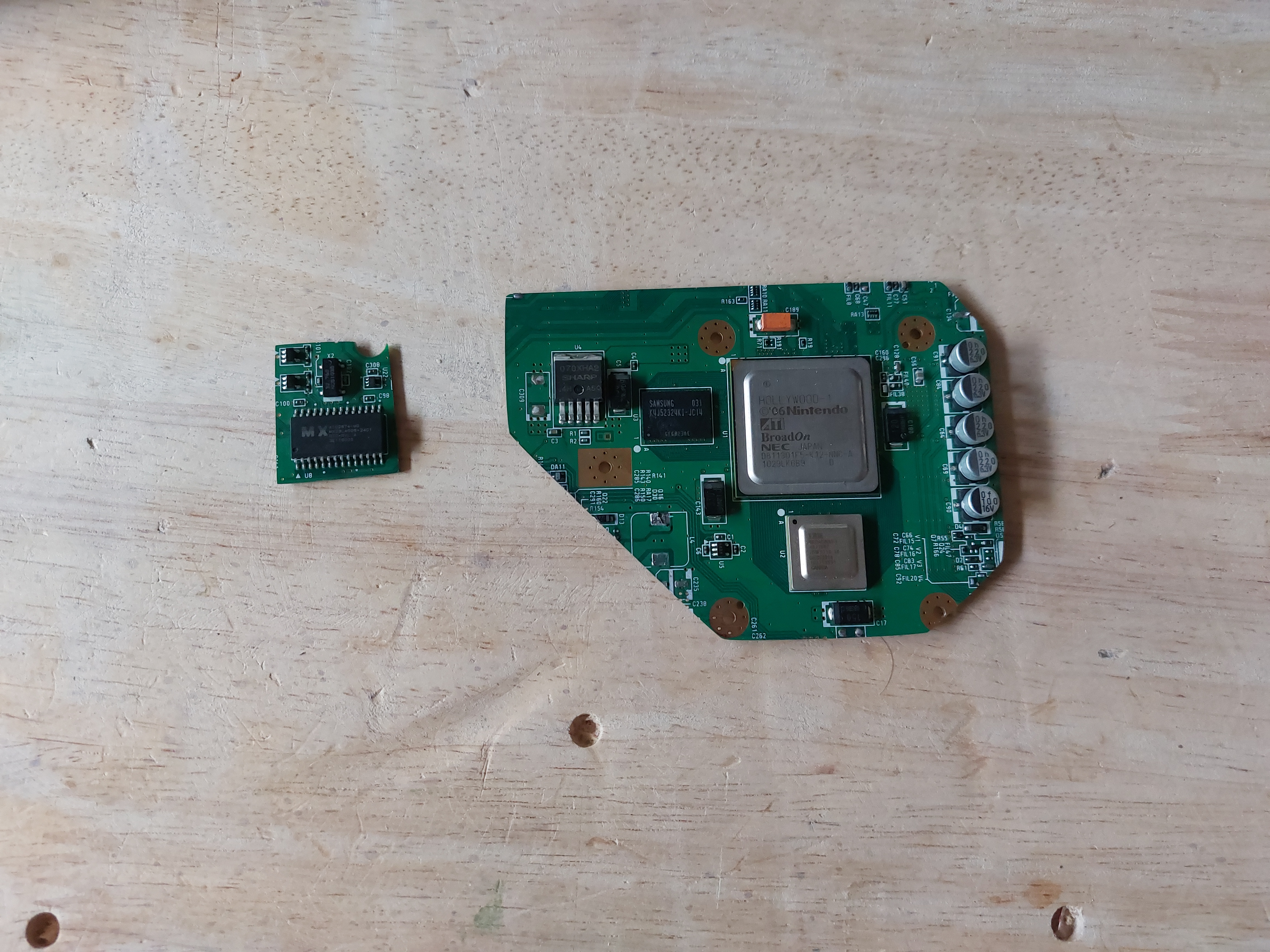

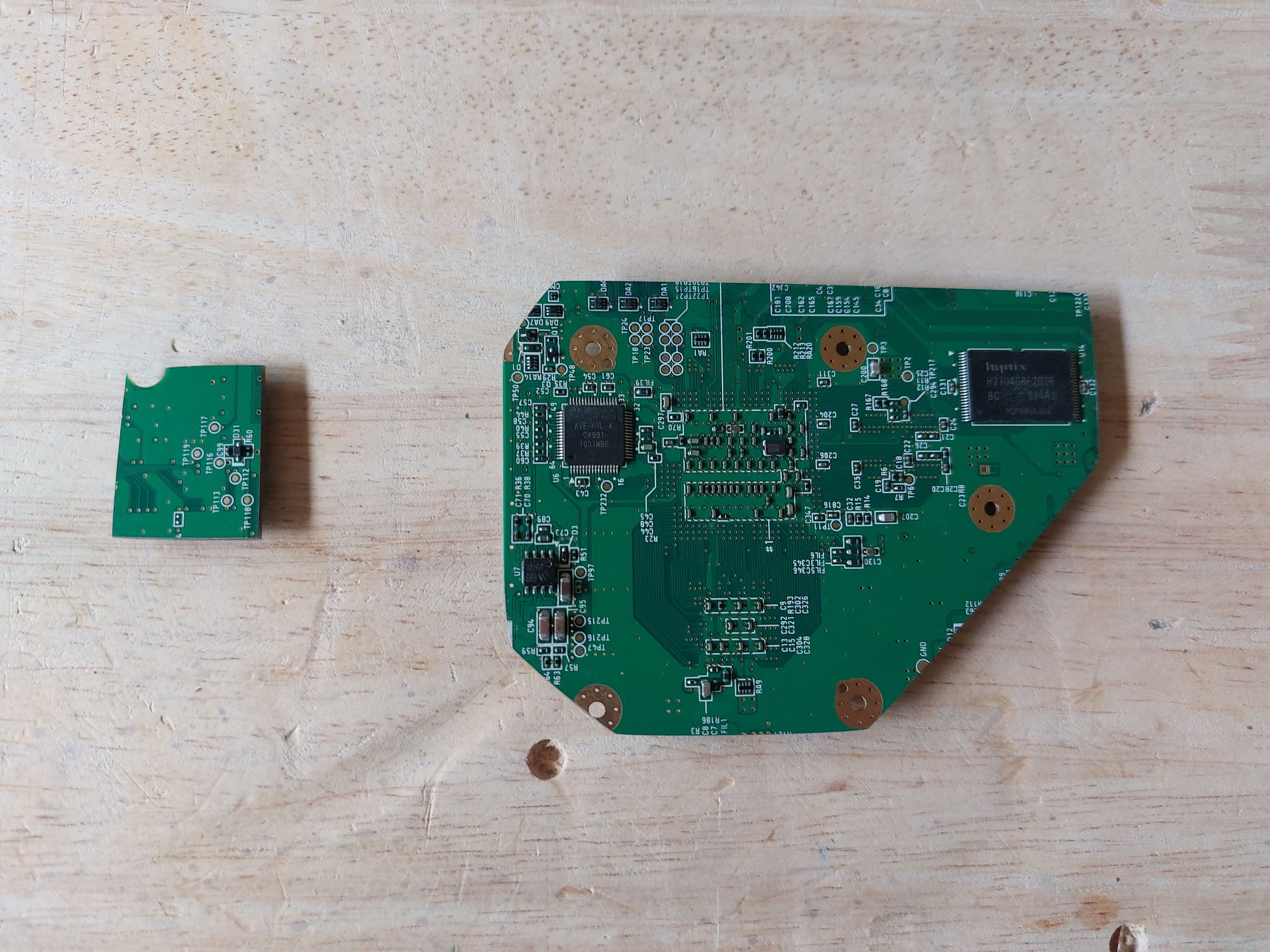

Trimmed my Wii today! Here are some pictures. I was referencing the trimming guide on the g-boy assembly manual for the lines on the board. I hope I didn't brick this one. I also trimmed out the MX chip.
You'll notice that one of the large components on the diagonal trim line had a hard time coming off. Should I be worried about that?
