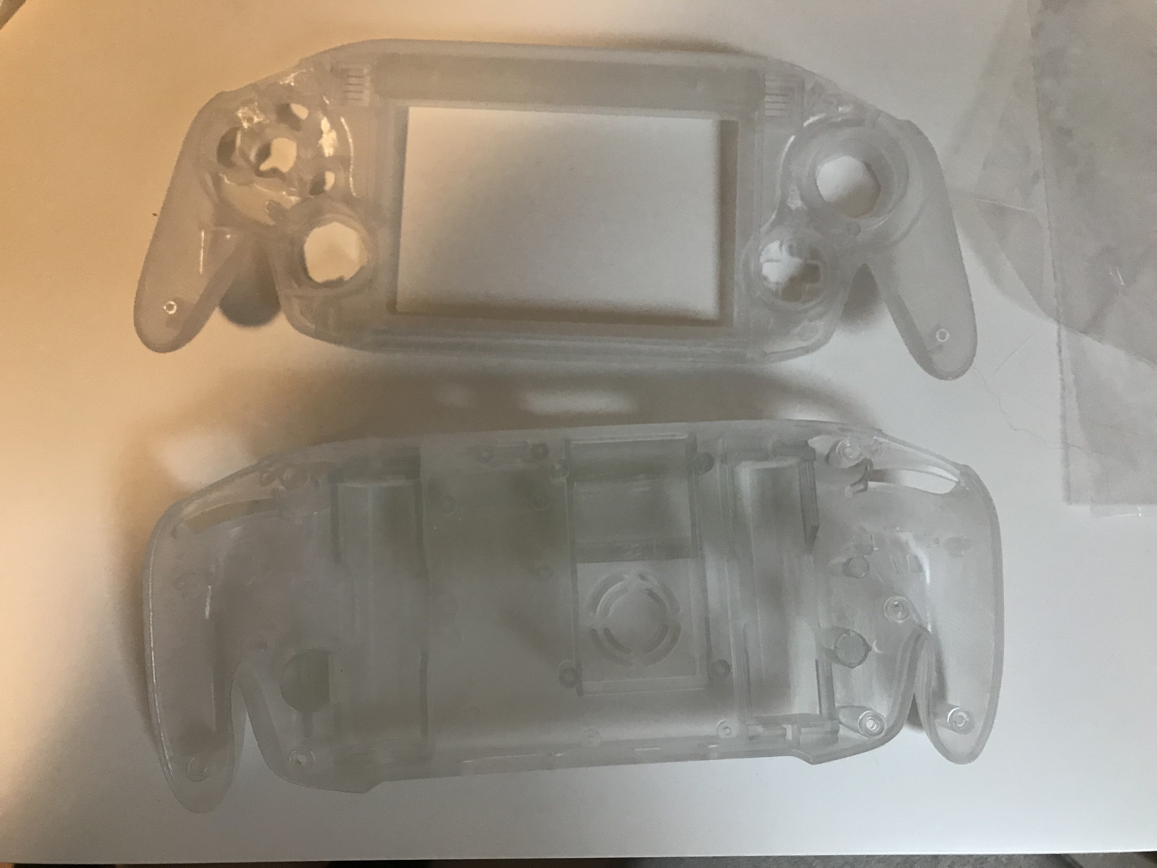

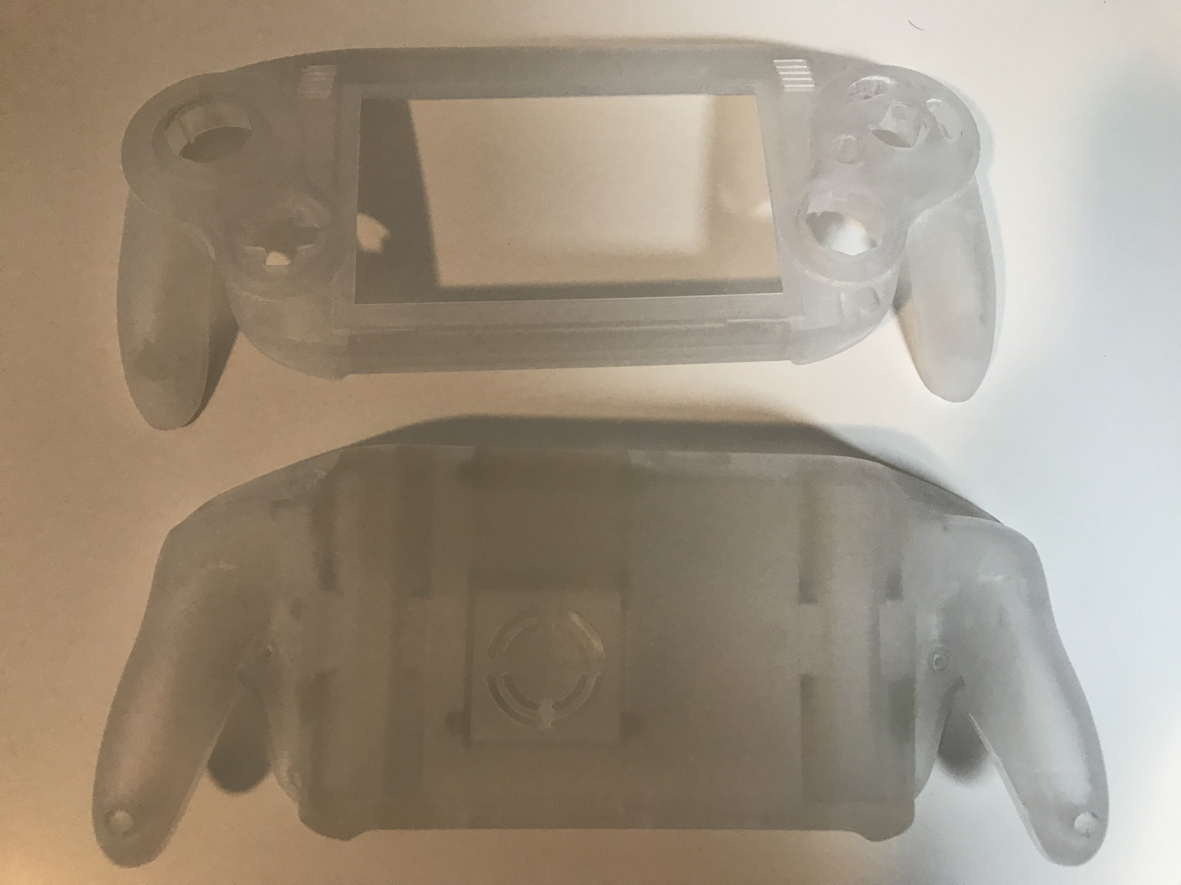

3D Printing from PCBWay:
  • Ashida 3D print $165
  • Shipping $63
  • Tax $63
  • Total $291

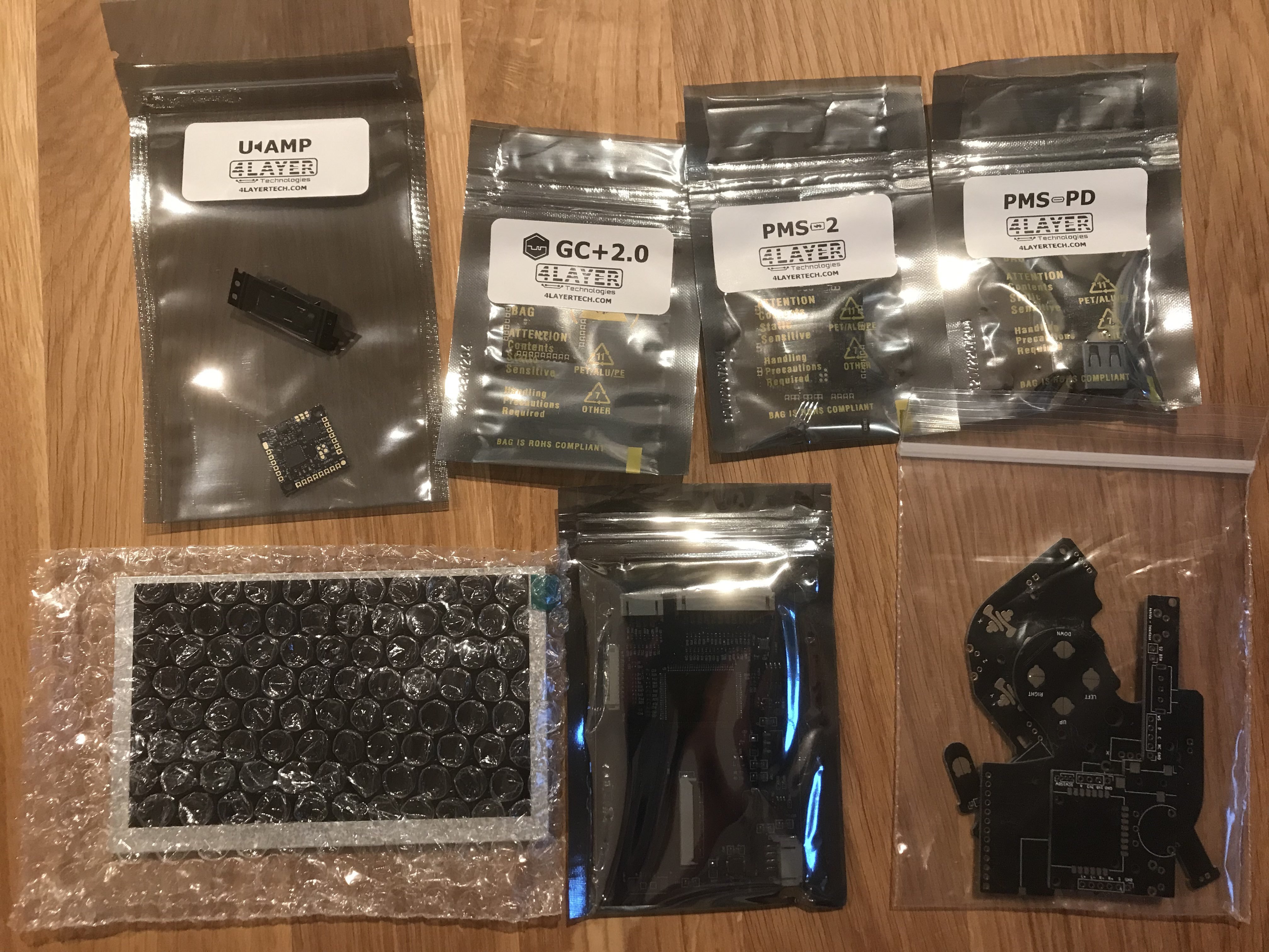

I received the packages.

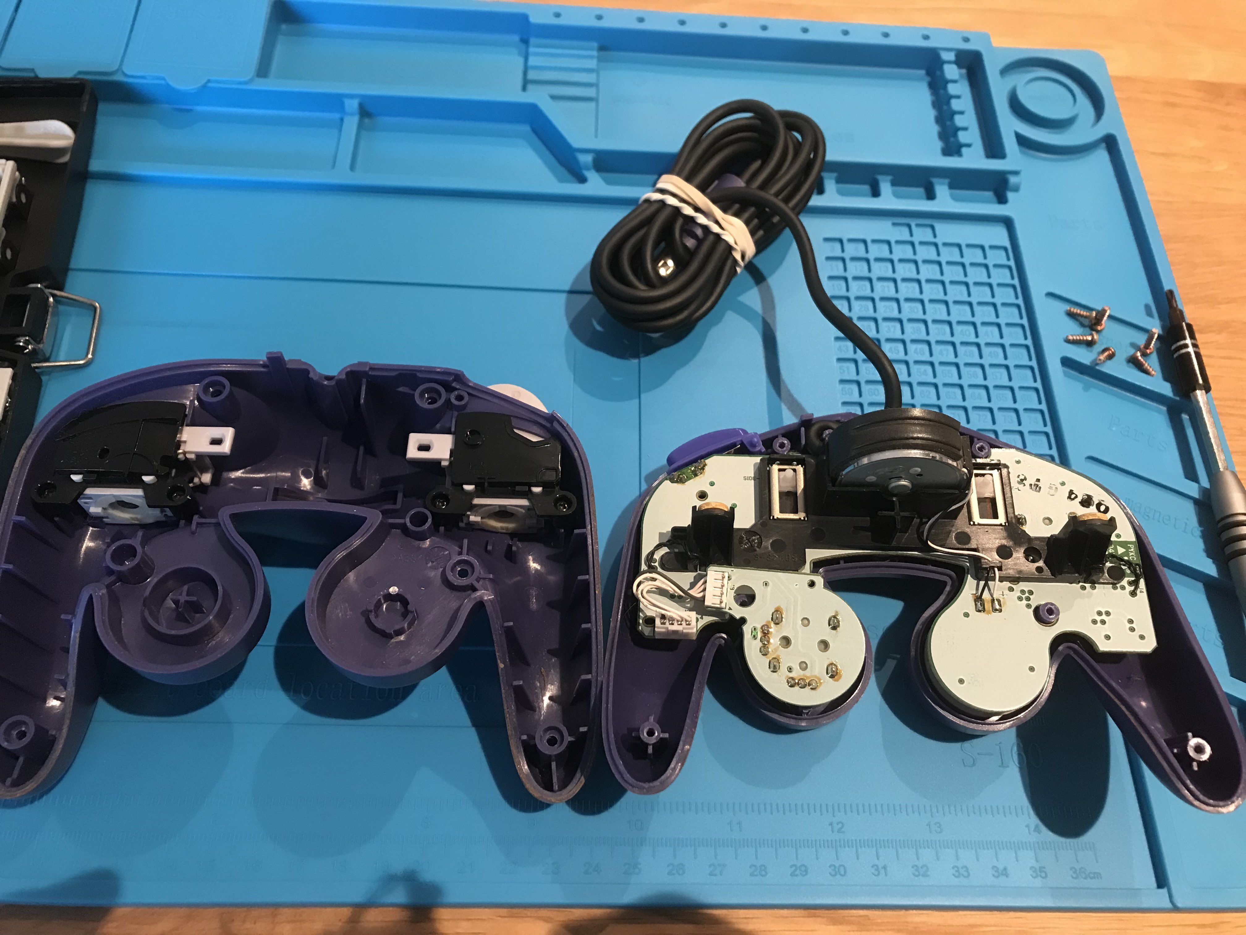

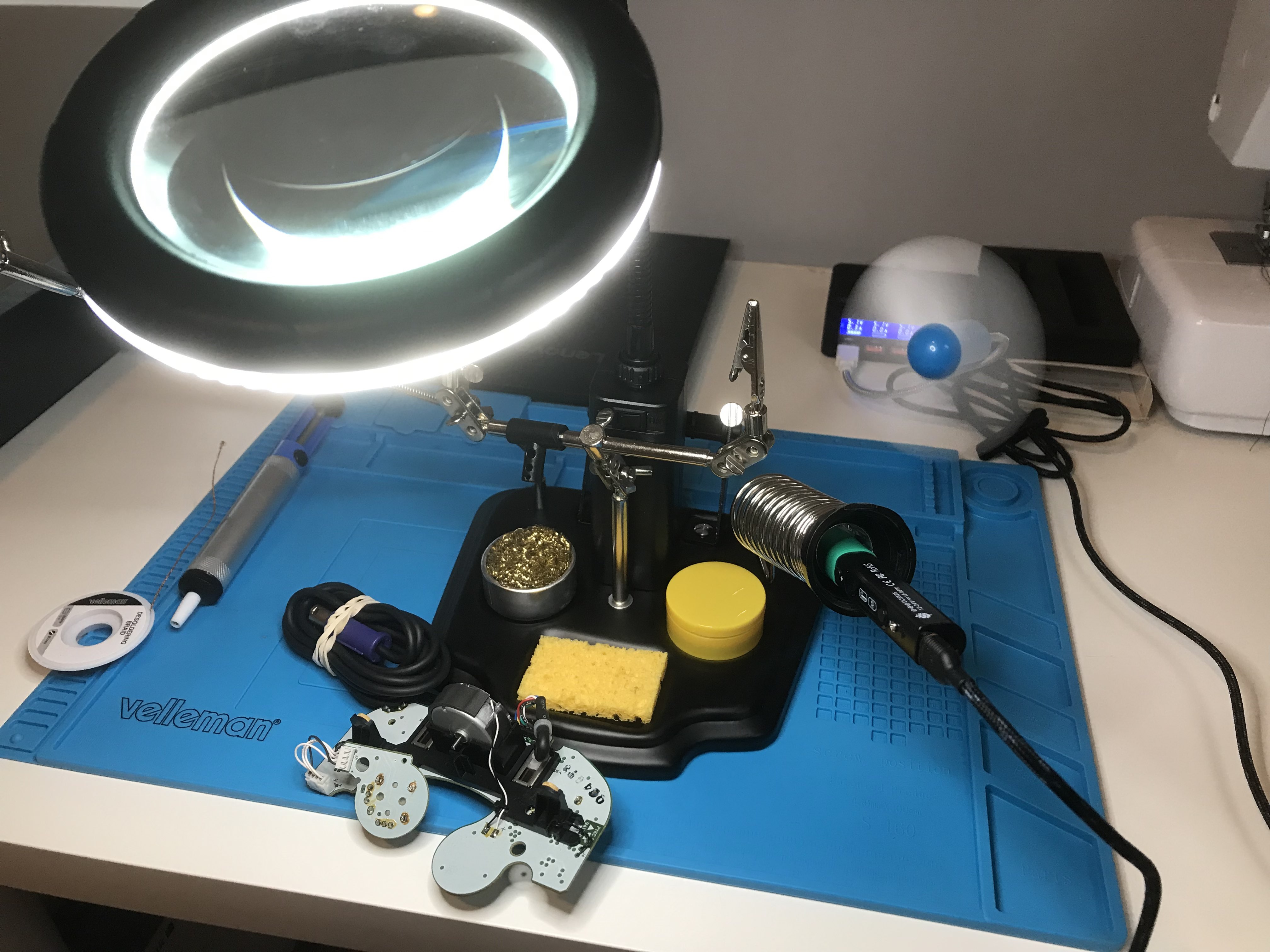

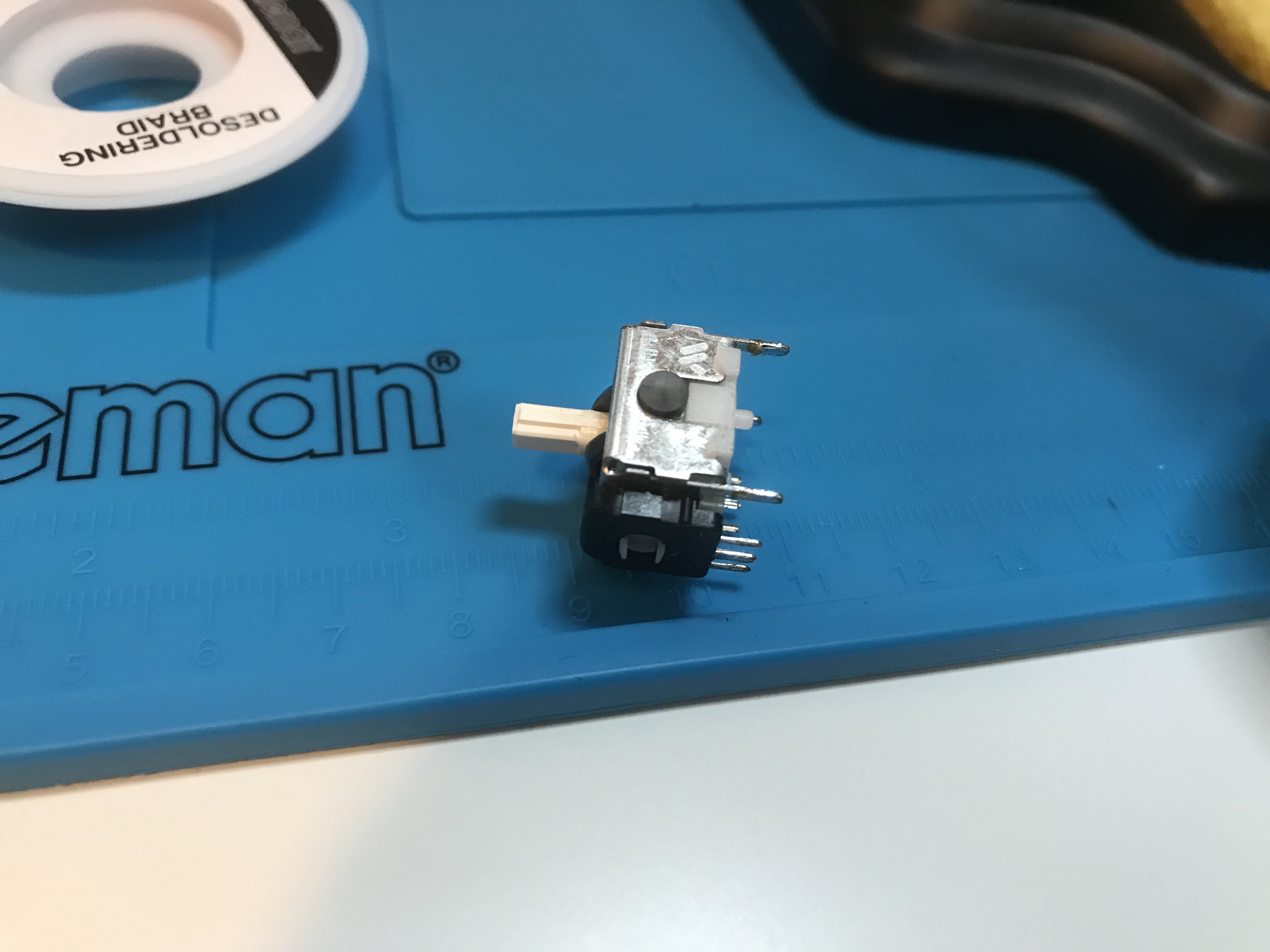

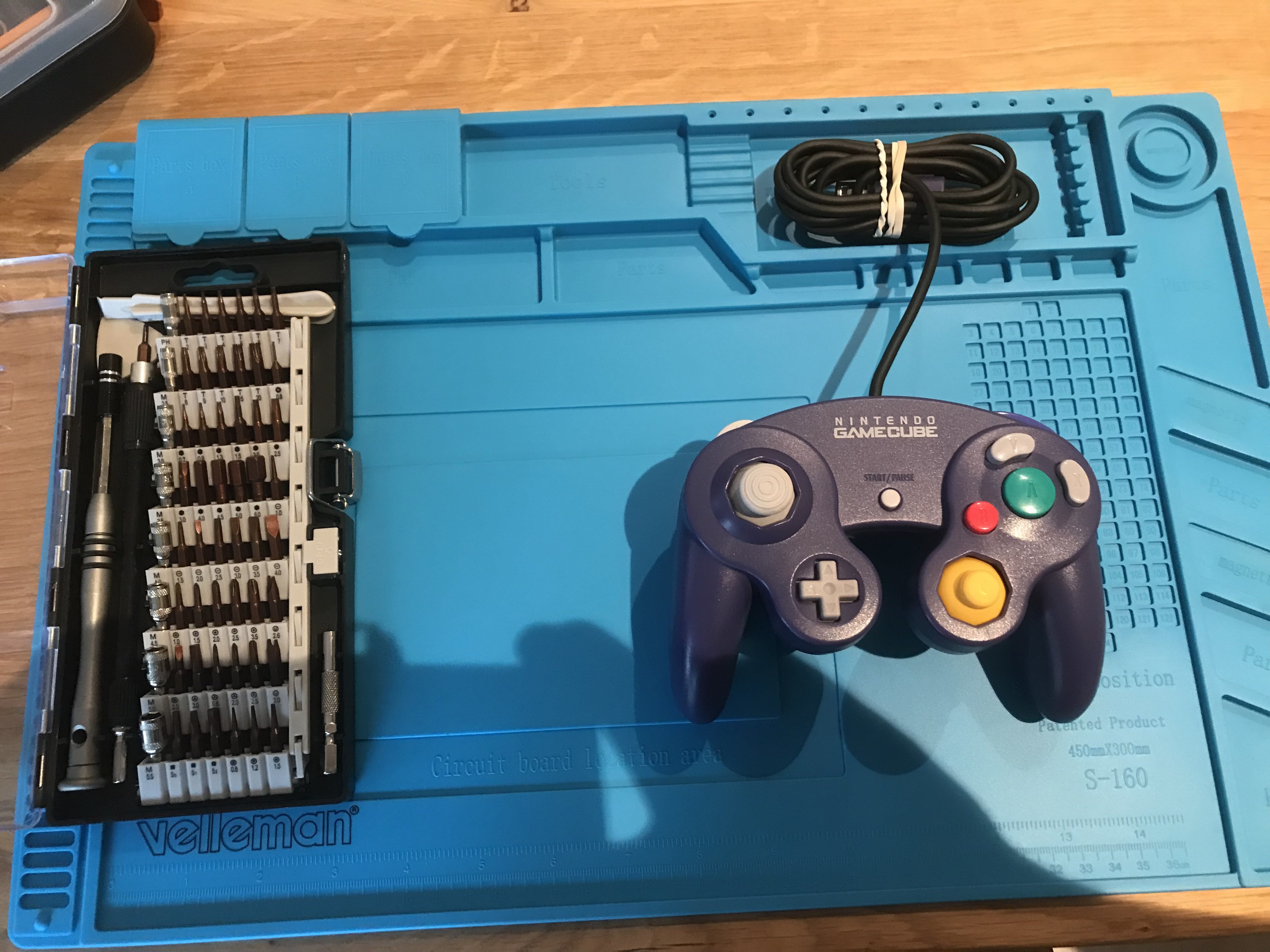

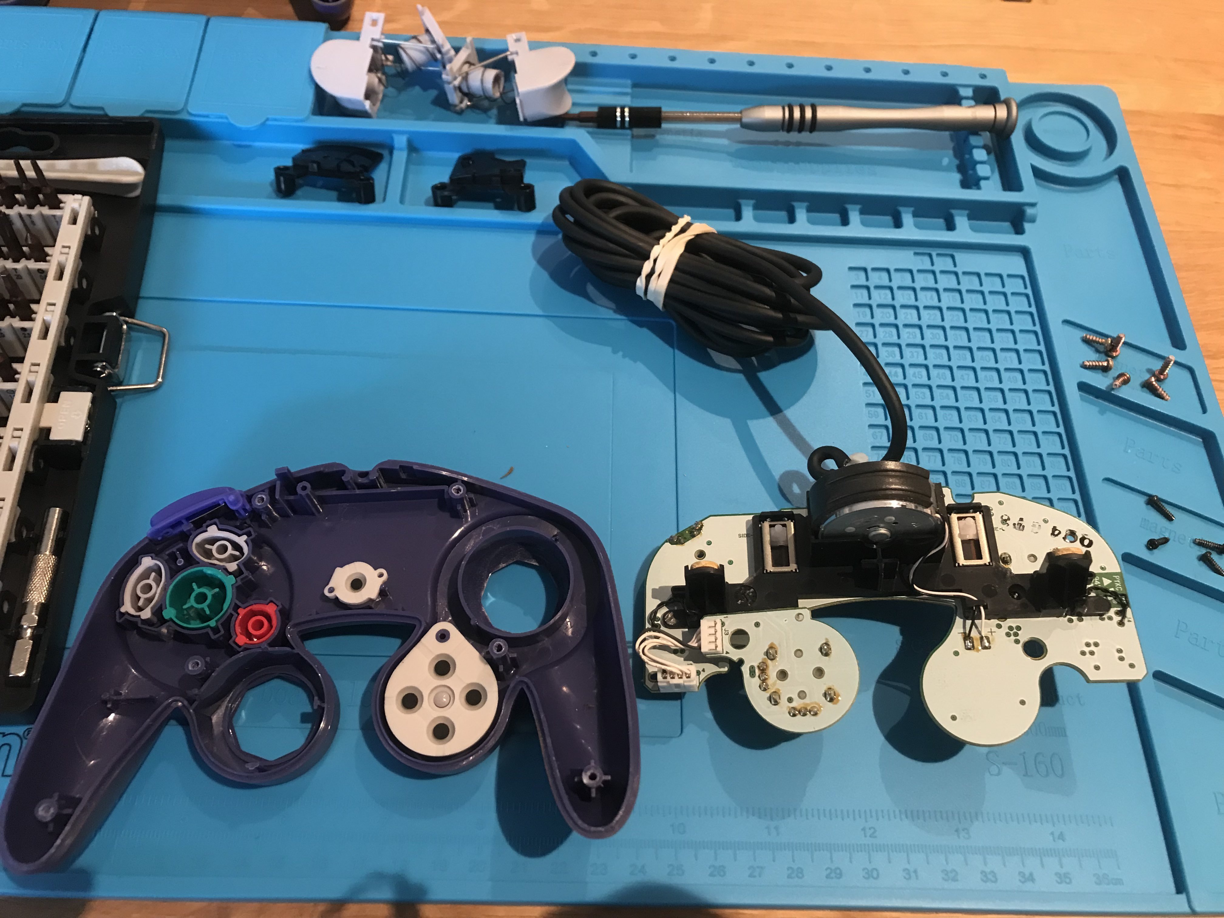

I took apart the GC OEM Controller.

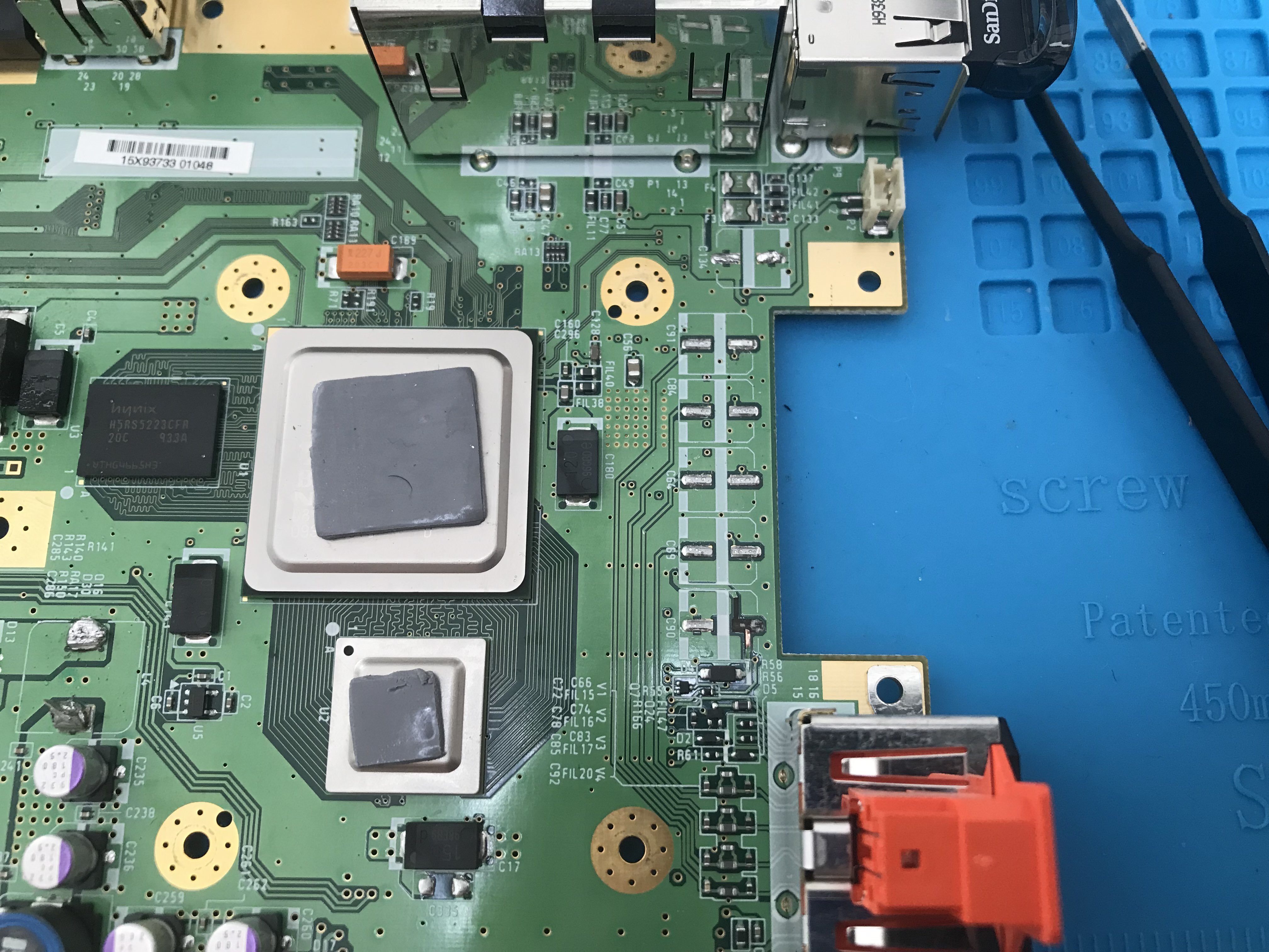

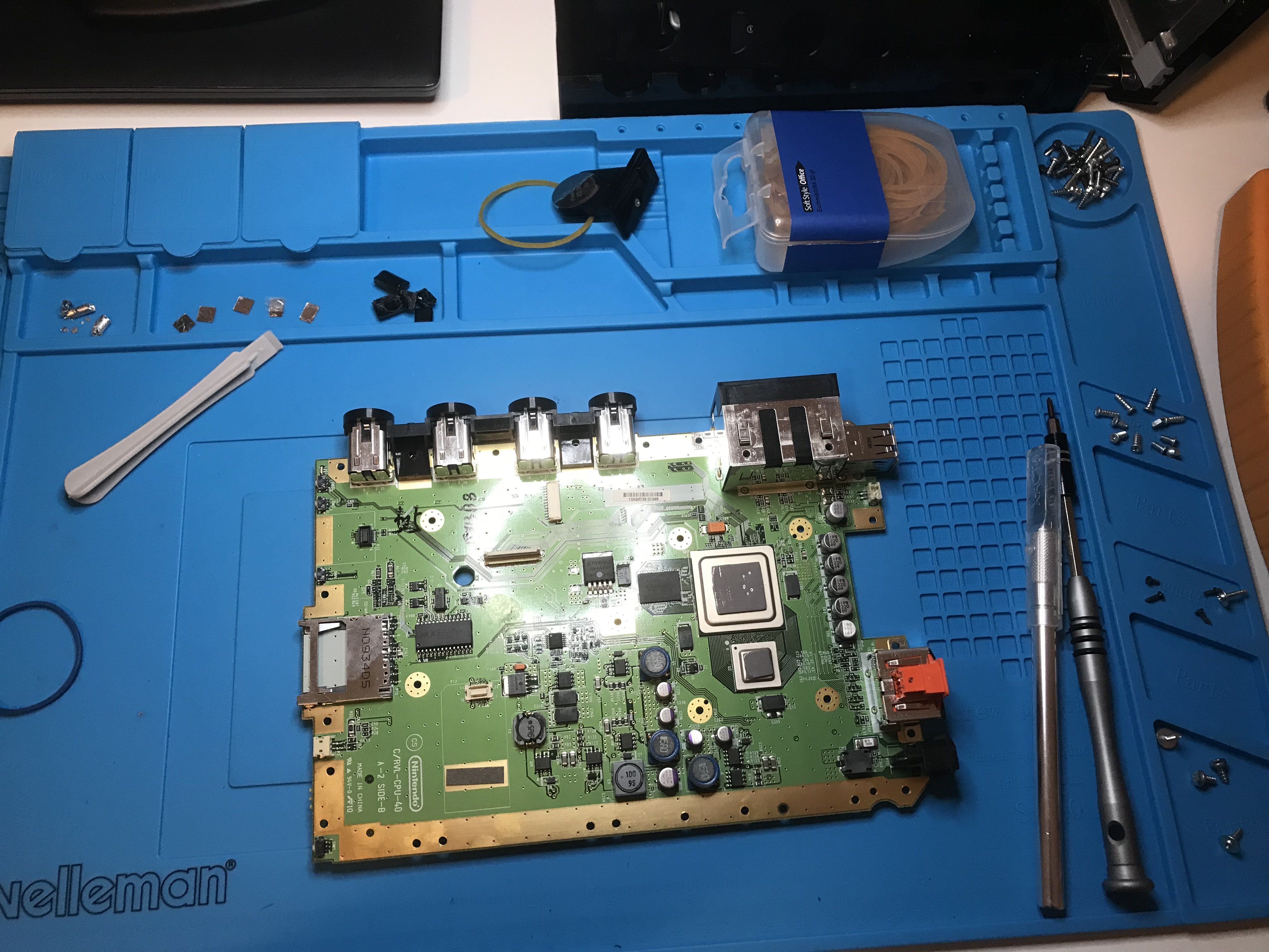

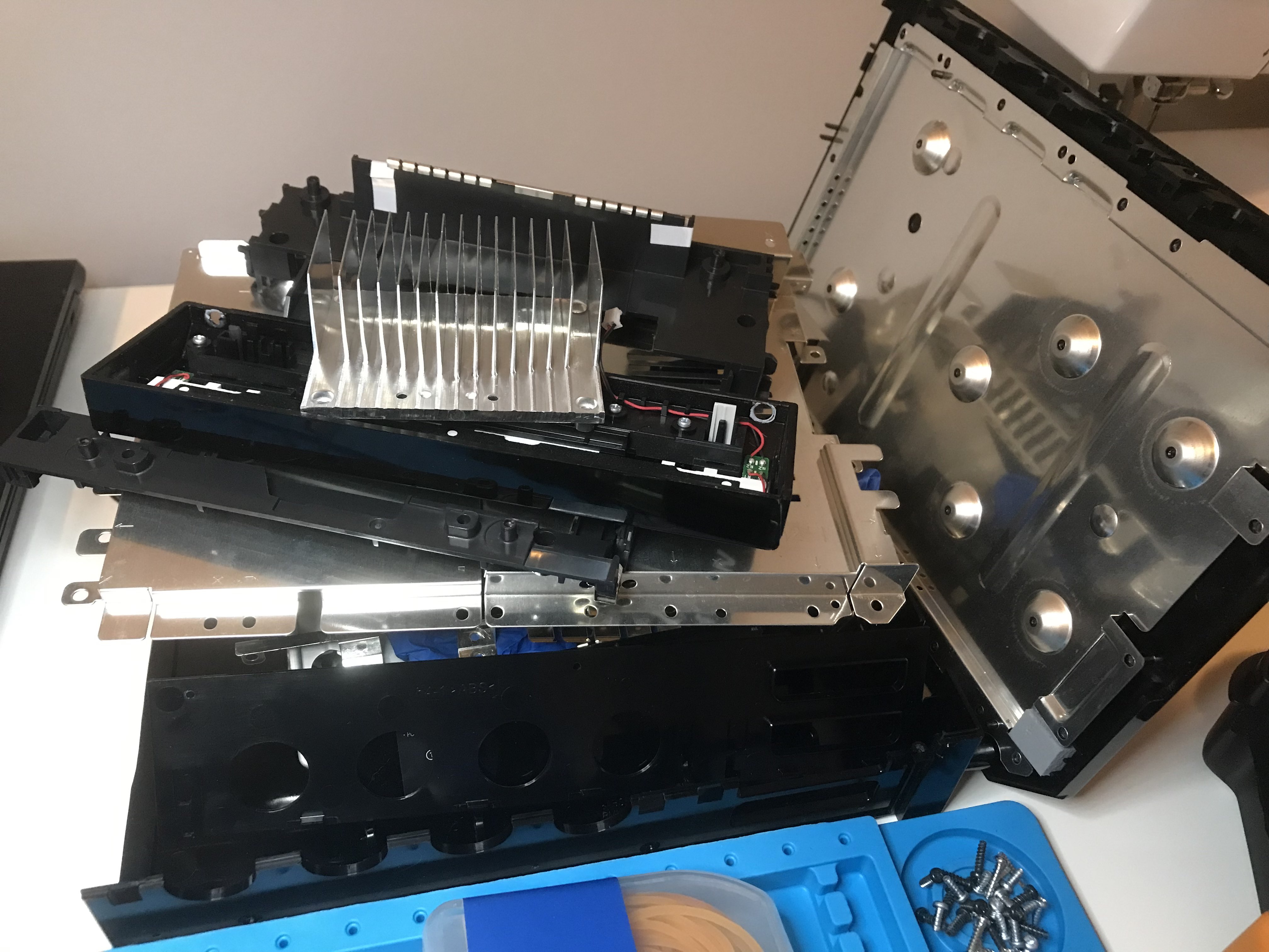

I took apart my Wii to ready it for trimming.

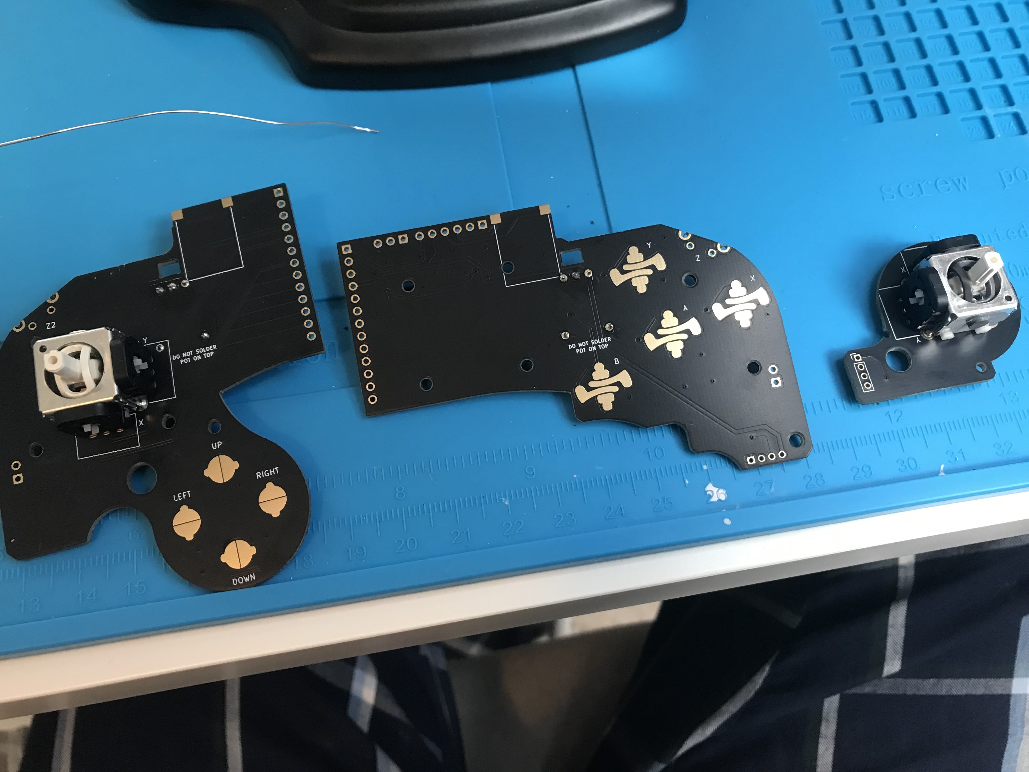

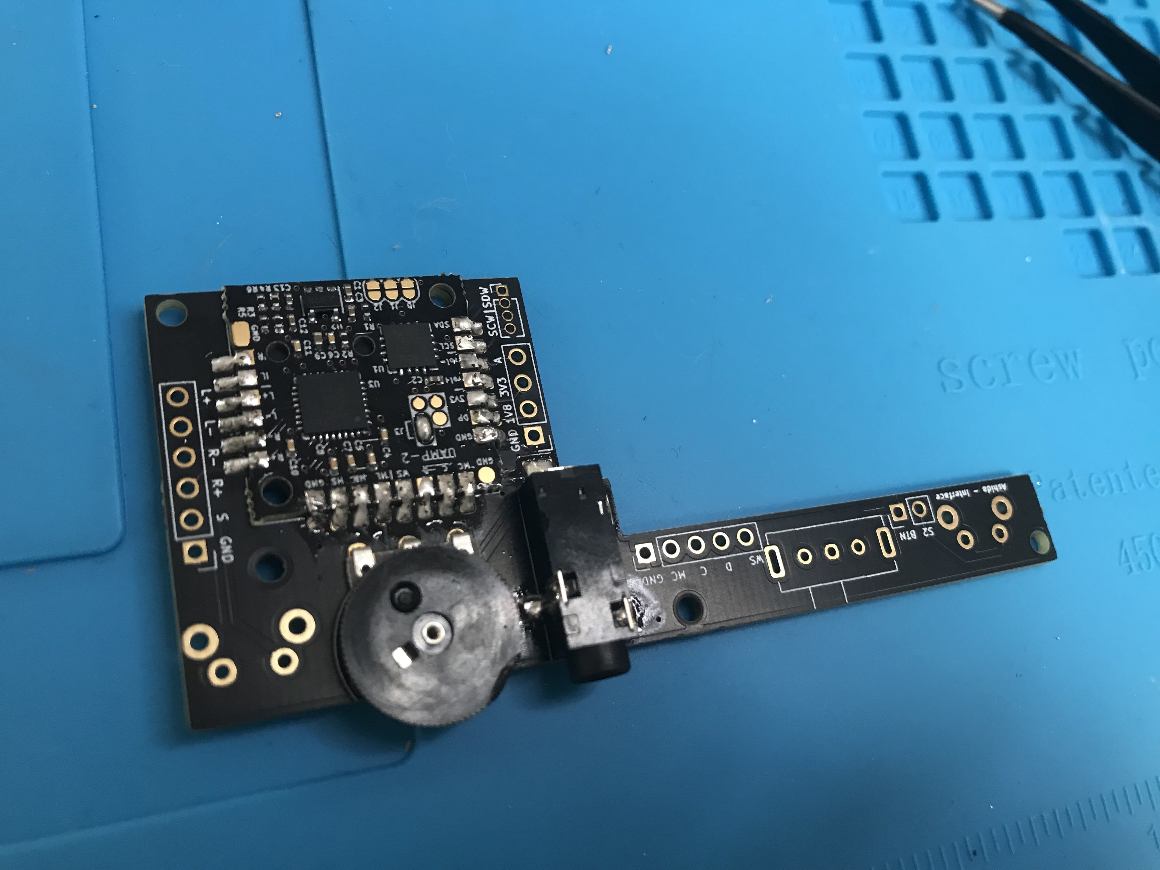

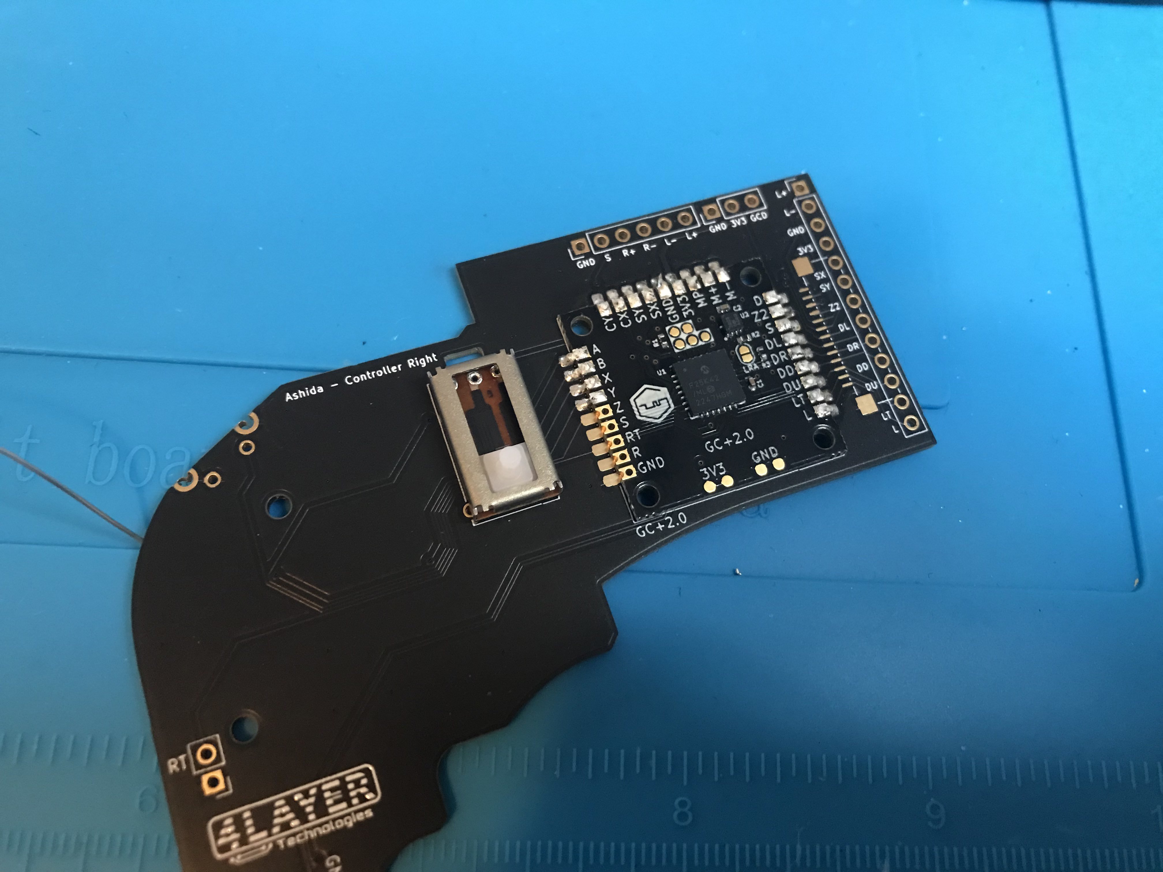

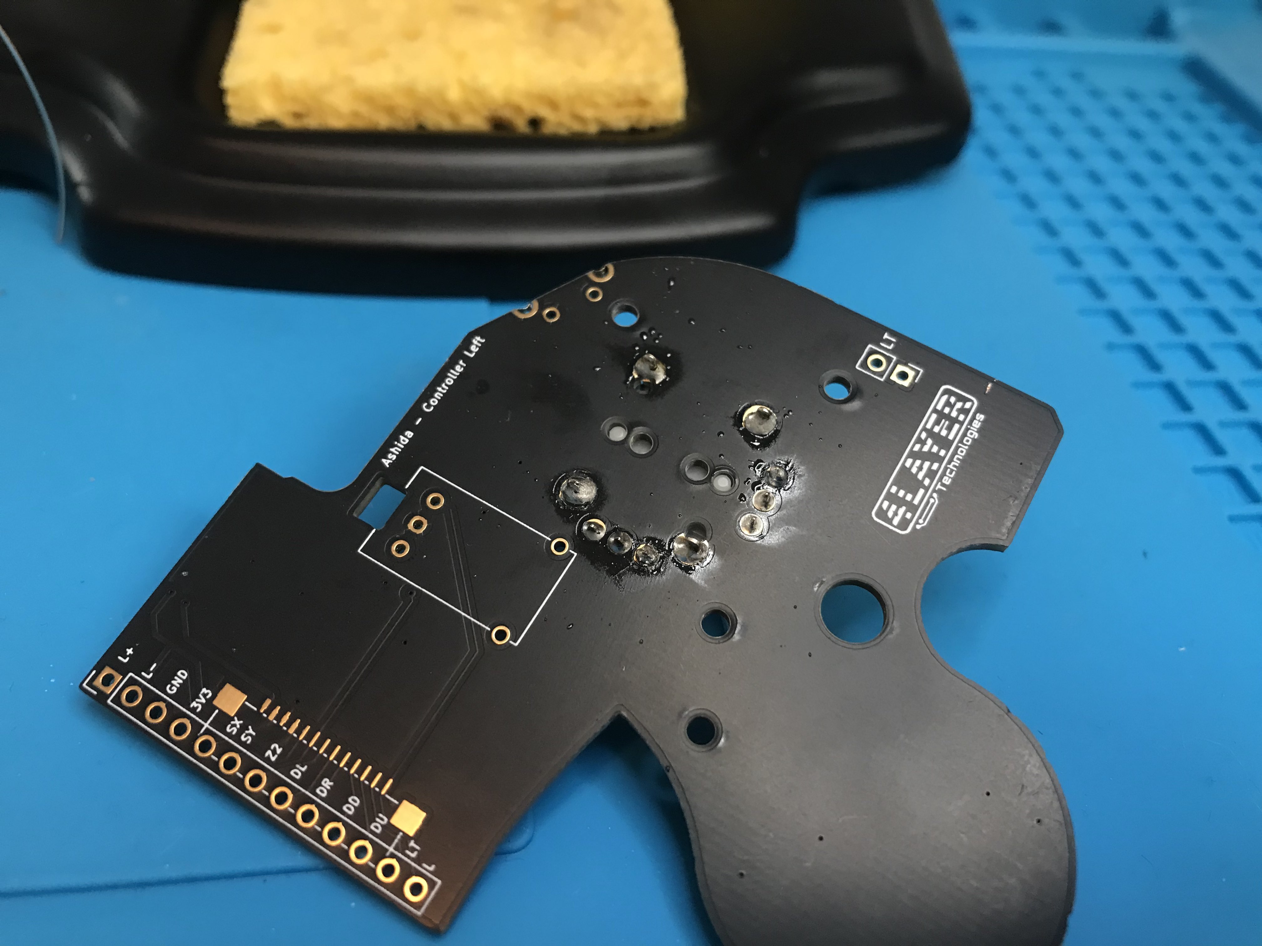

I started by soldering GC controller parts, UAMP2 and GC+2 to the Ashida PCBs.

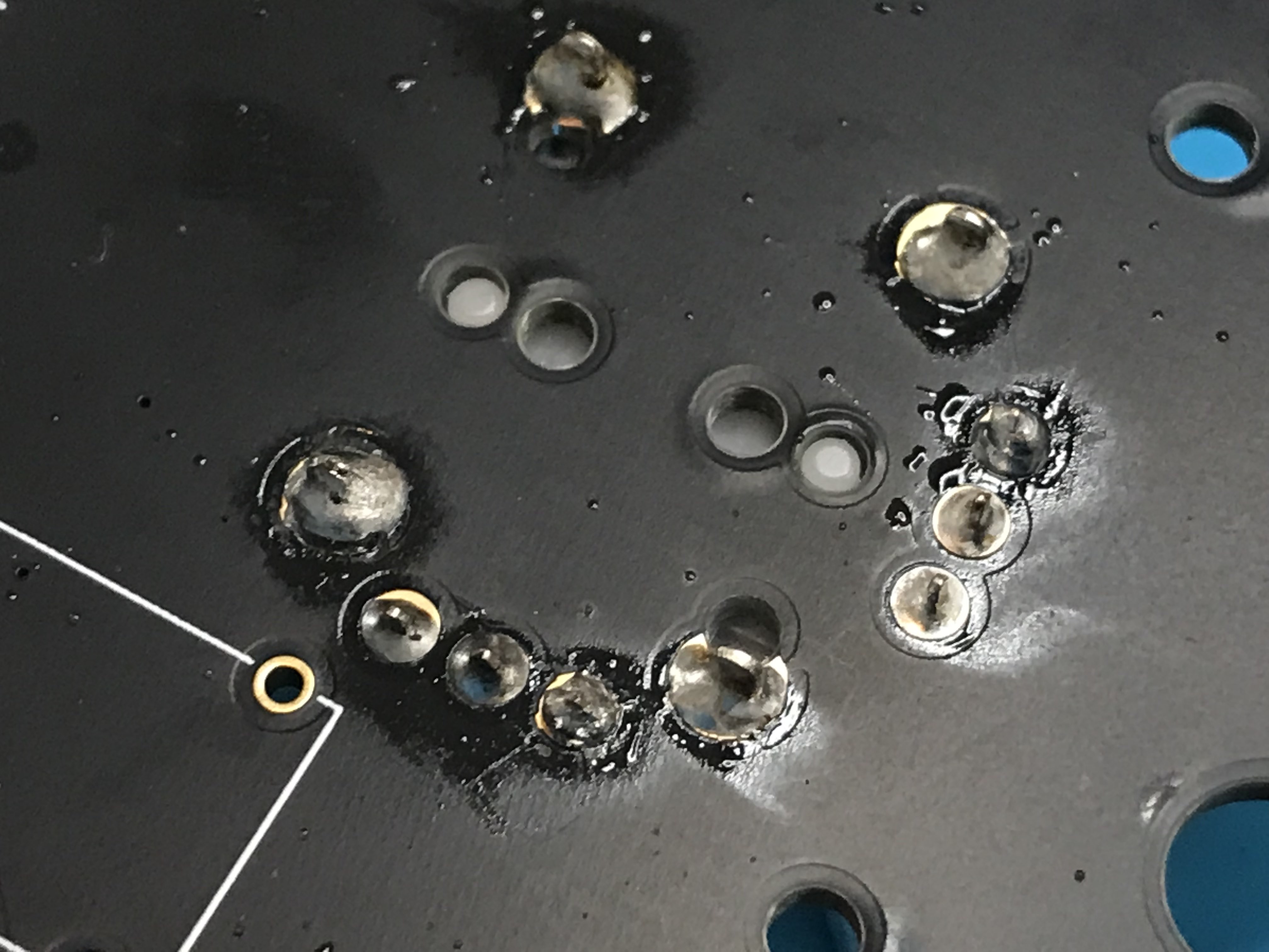

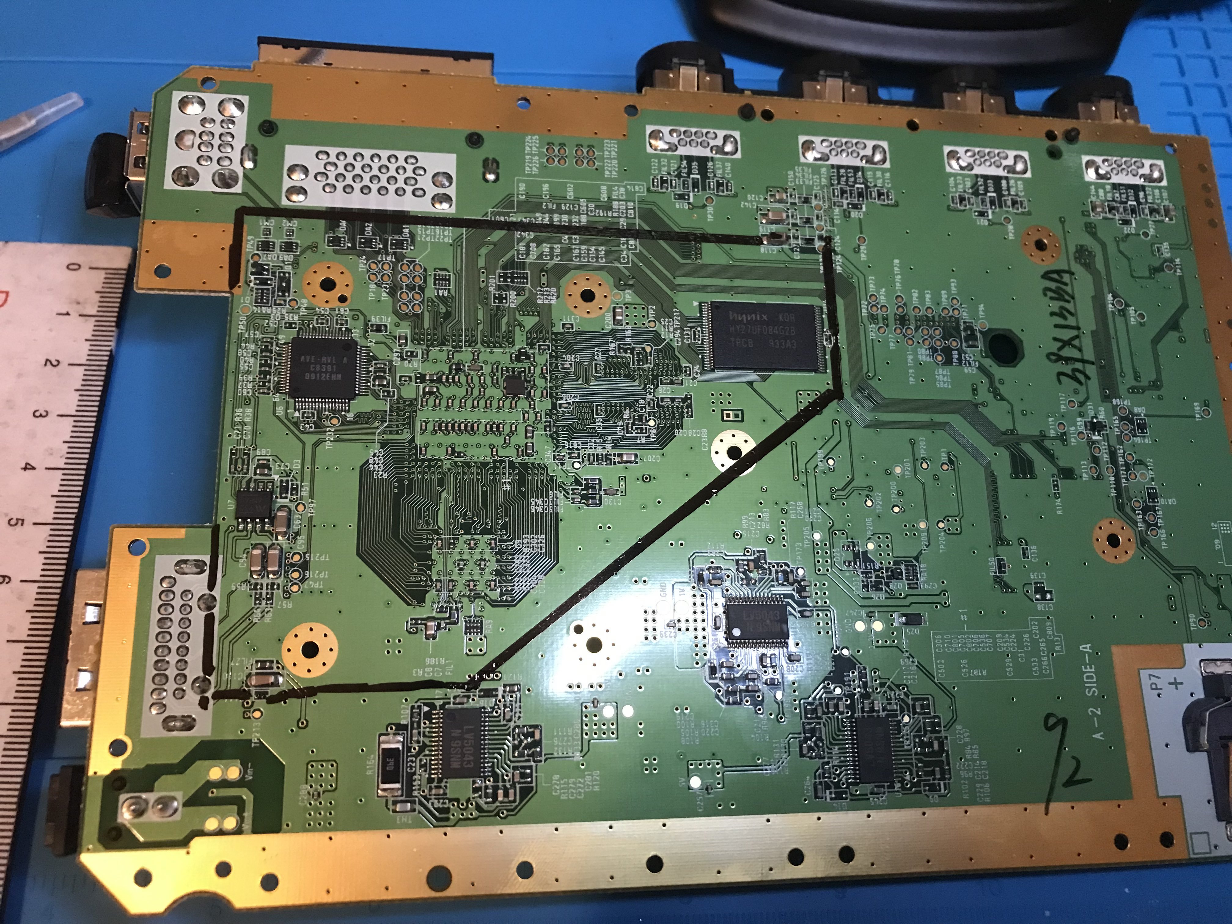

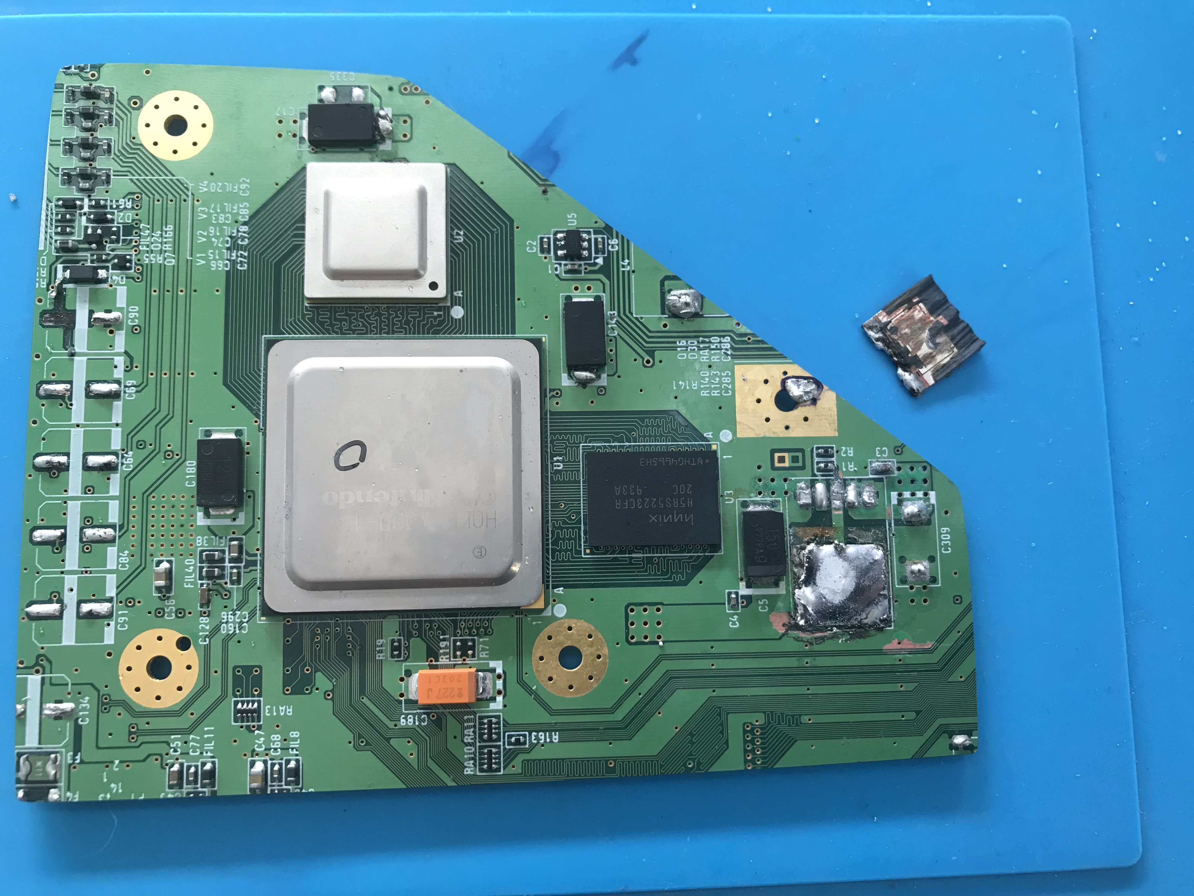

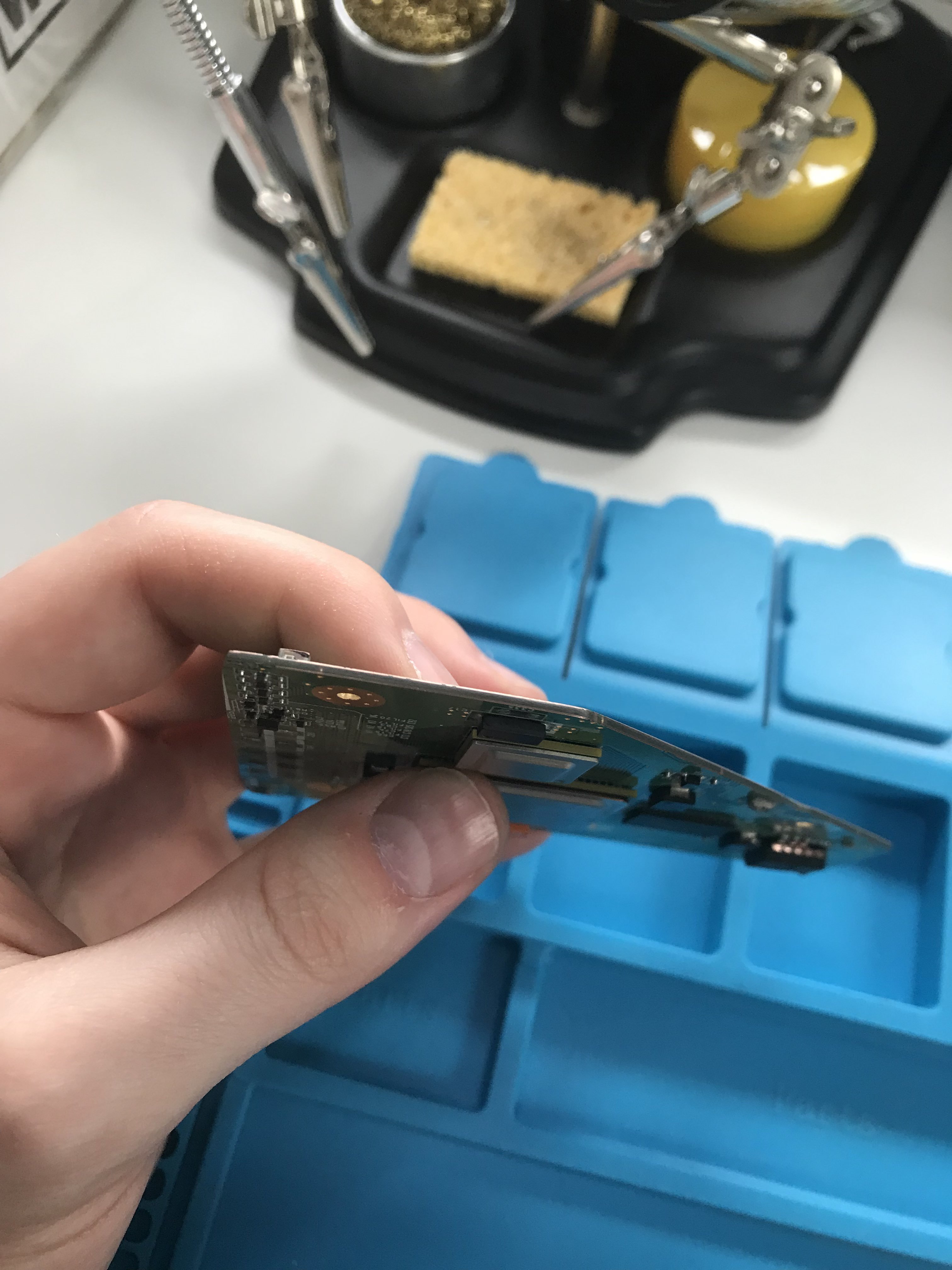

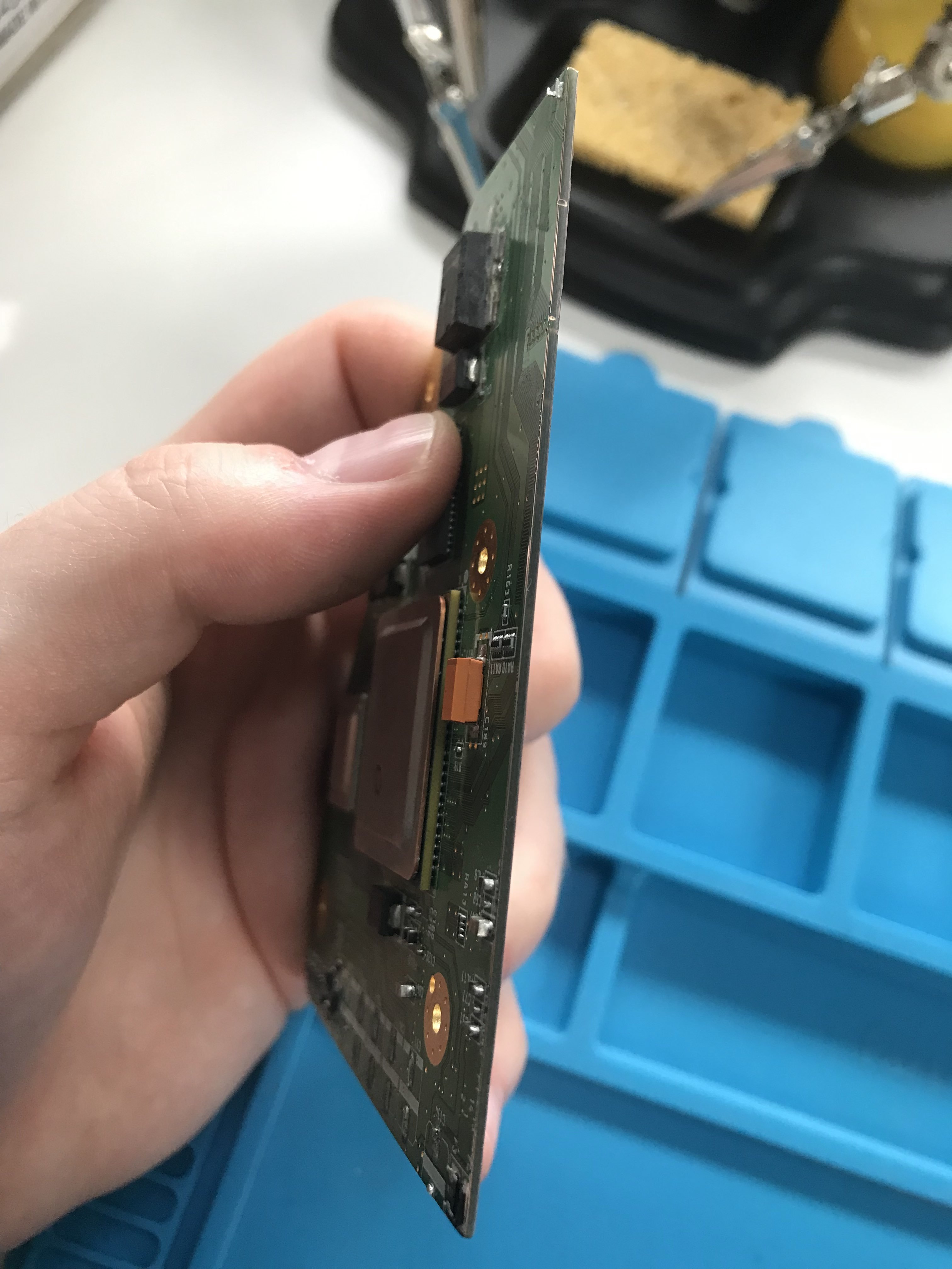

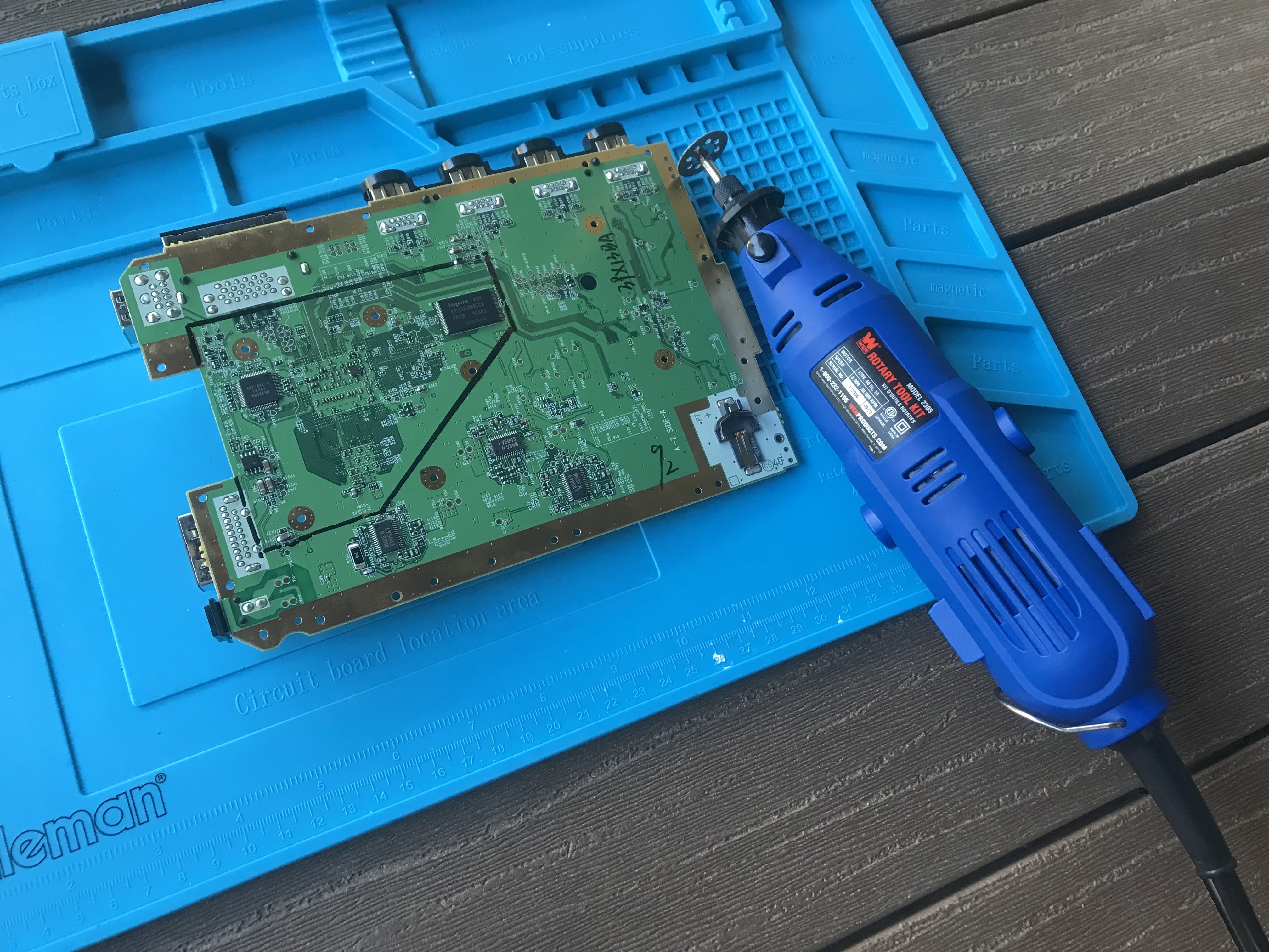

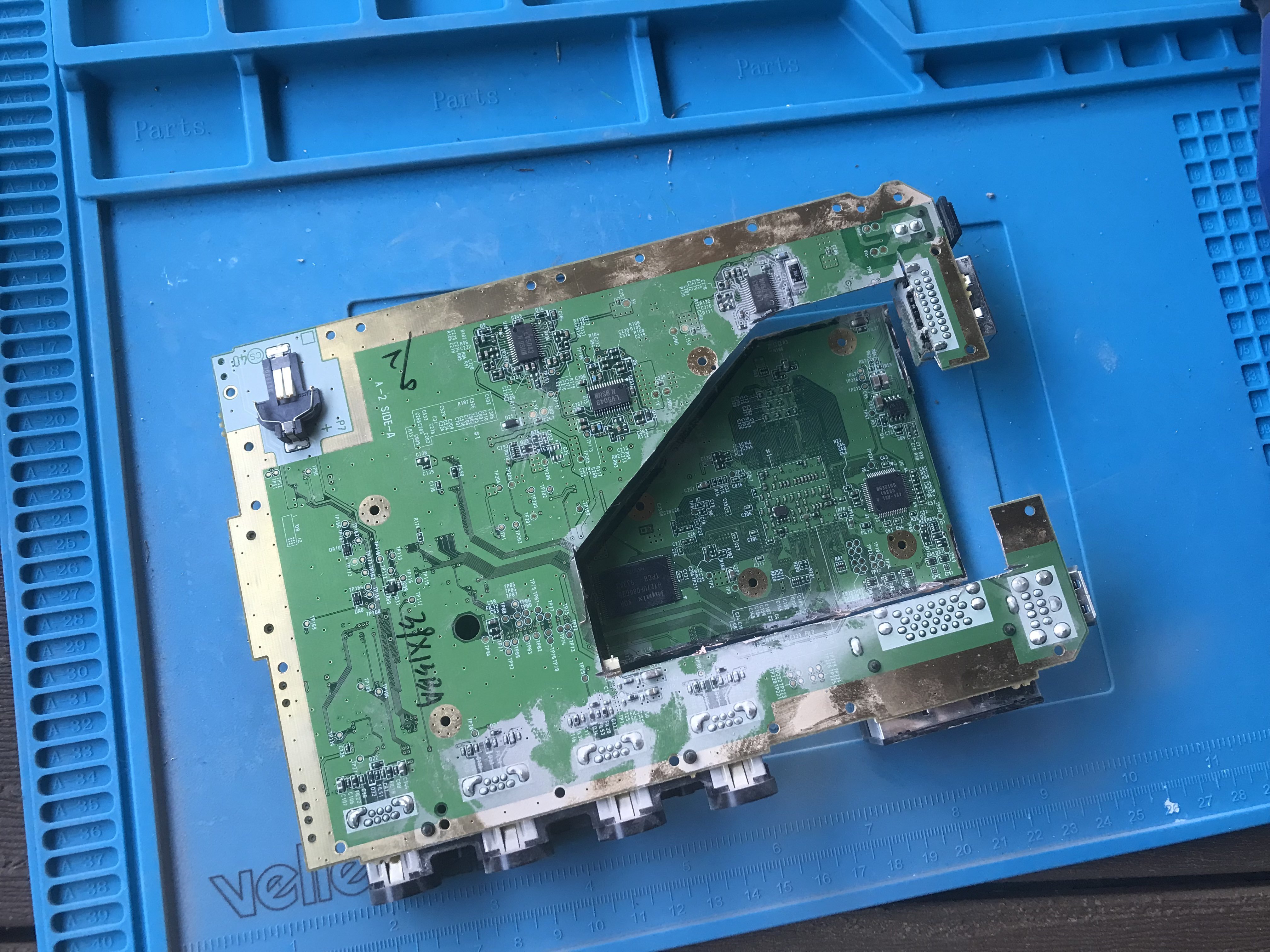

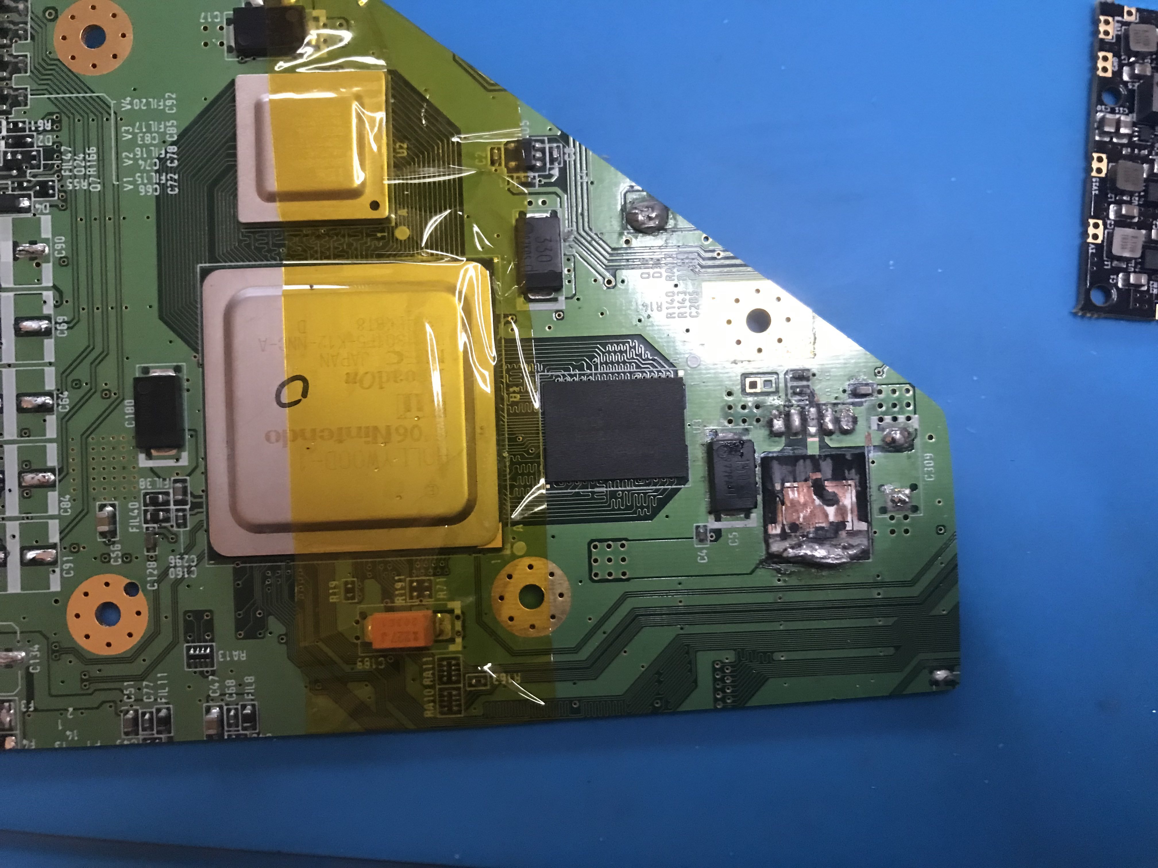

Removed capacitors and trimmed my Wii. Had some issues with the wheel slipping, but it looks like it went well. I sanded as well as I could using K240, K800, K1200. Resistances were good according to the table. I will say I noticed my Multimeter behaved weirdly when checking 3.3V. It has an auto-range feature and it ranged from very high to around 16K ohms. According to another user on this forum whom experienced the same it was fine and their Wii booted. So I will assume it's fine, but I have not tested turning my Wii on yet.

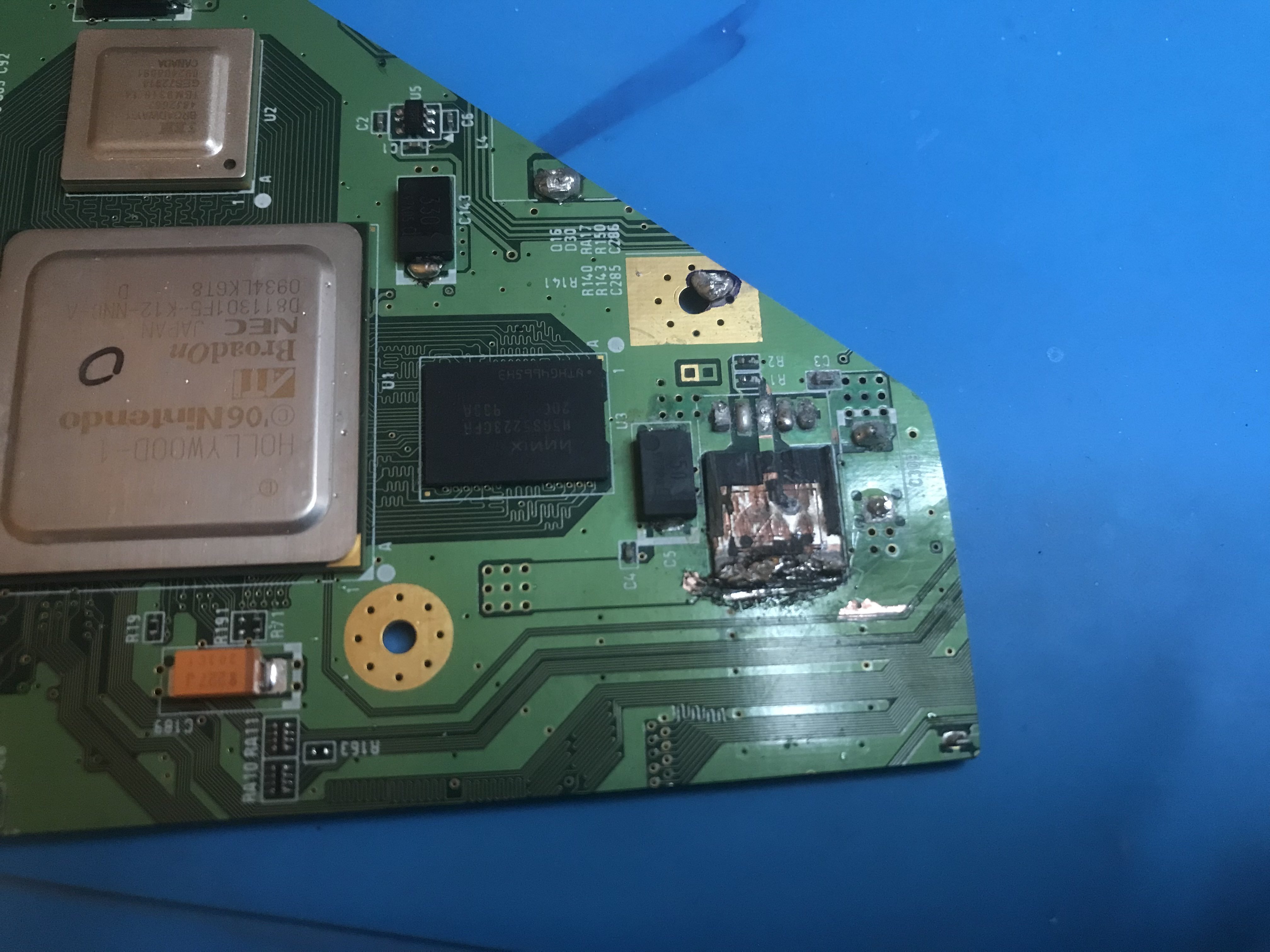

Notice the bottom capacitor? When I ripped it off the pad came off. Will this be a problem?

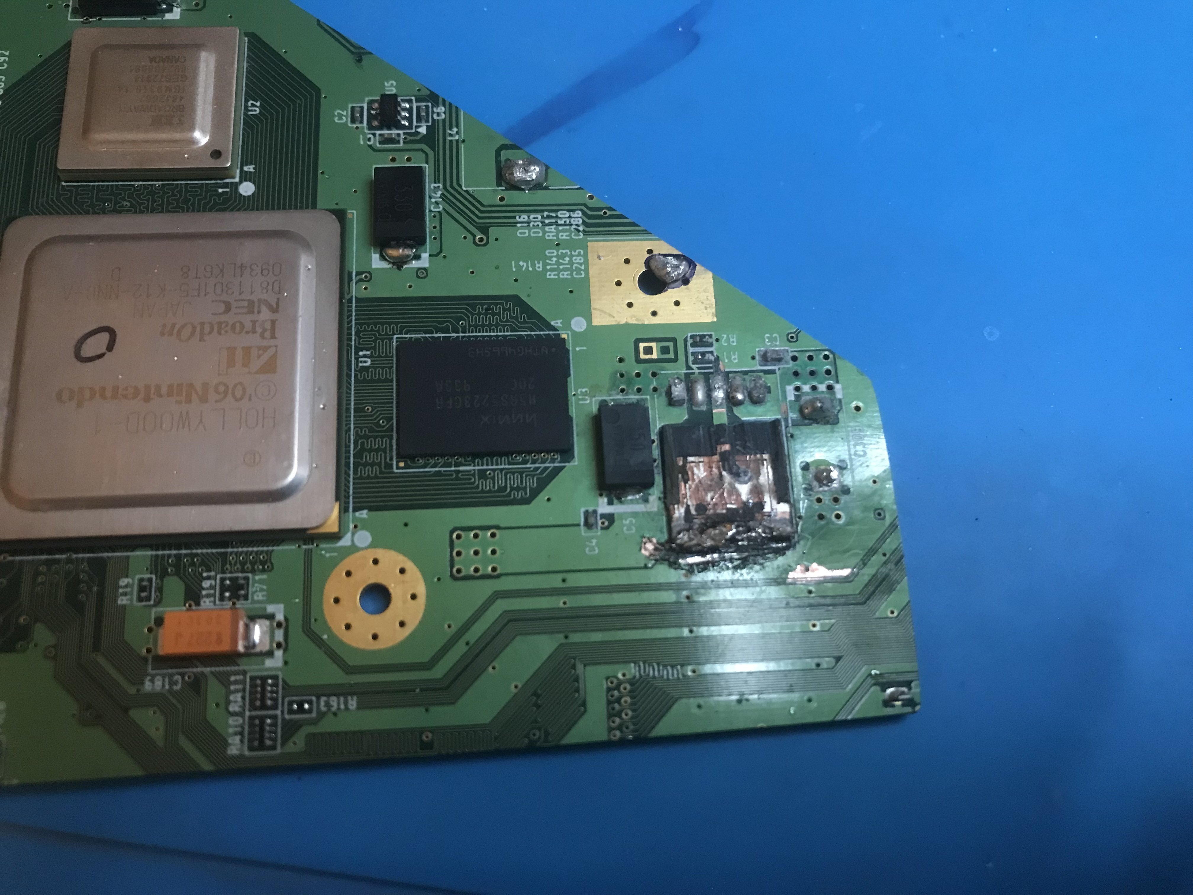

I tried to remove the LDO using Wesk method since I do not have a hot air station. But I have been unable to remove the component itself. My soldering iron runs into an issue with "Thermal Runway" (it shows that on the Pinecil). When I tried to look it up it seemed like the soldering iron is not able to hold the asked temperature, which may be because my power supply is not powerful enough. Will this be a problem or can I still use the Wii with the LDO half-removed? I checked resistance between the solder on the LDO and the 5 pads where the legs were, and they had some resistance (not shorted).

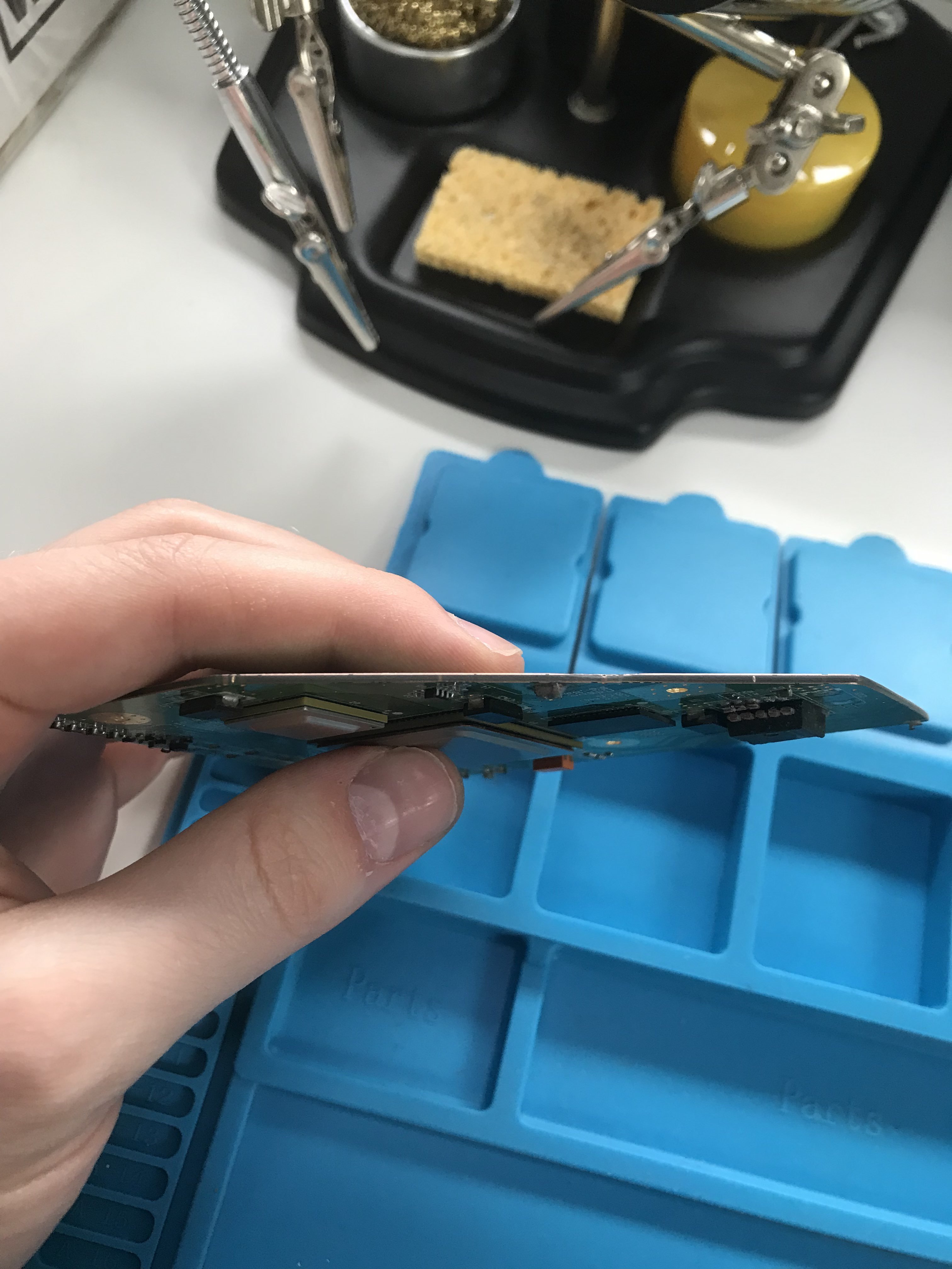

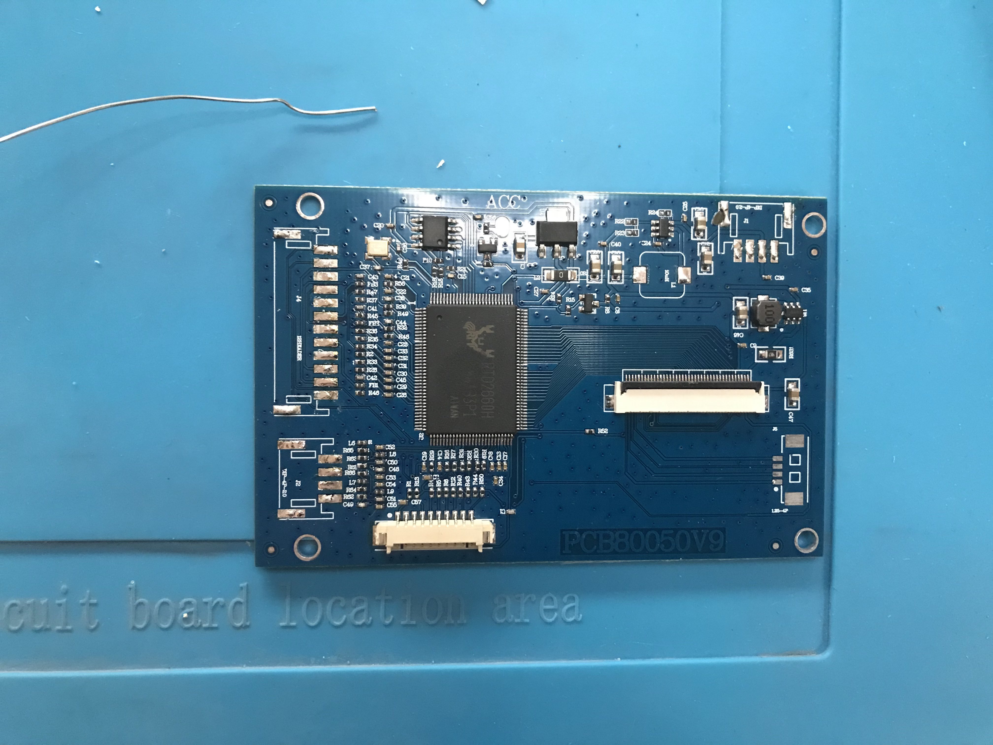

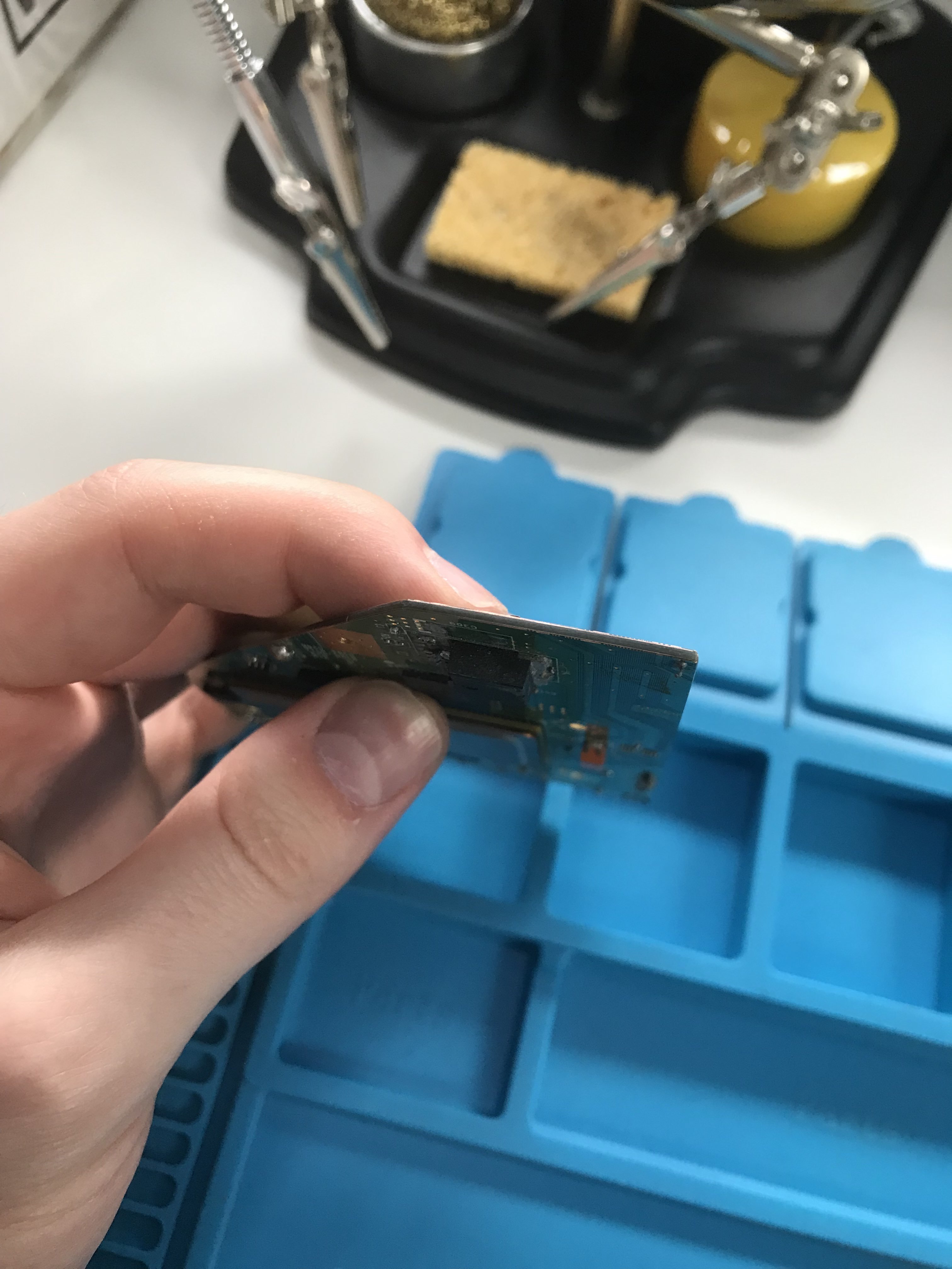

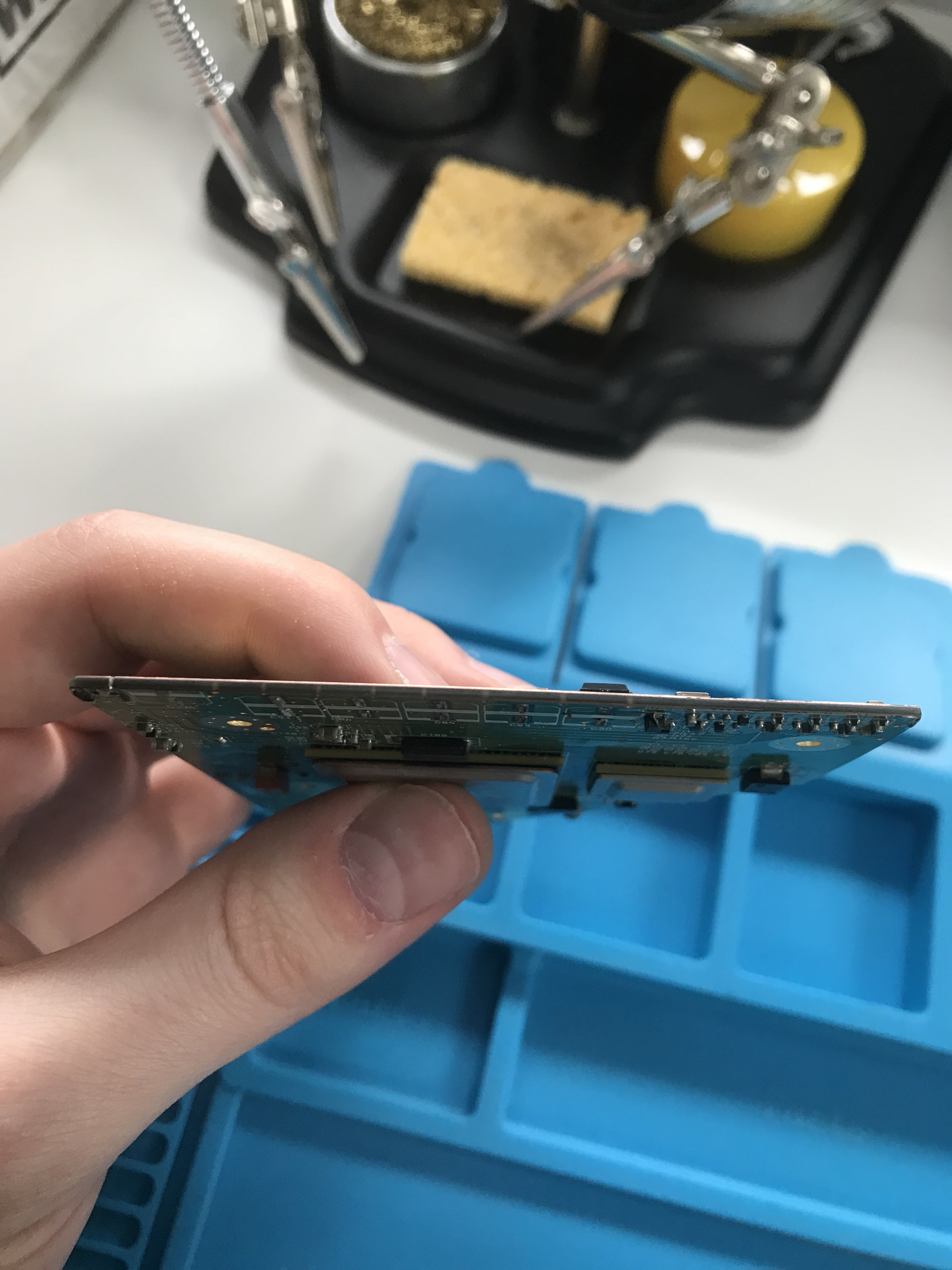

I removed some stuff from the Screen Drive Board that were not needed. They were in the way of the Ashida controller PCBs when inside the Ashida case.
See the top right connector that I removed? The pad came up when I removed it. Will this be a problem?

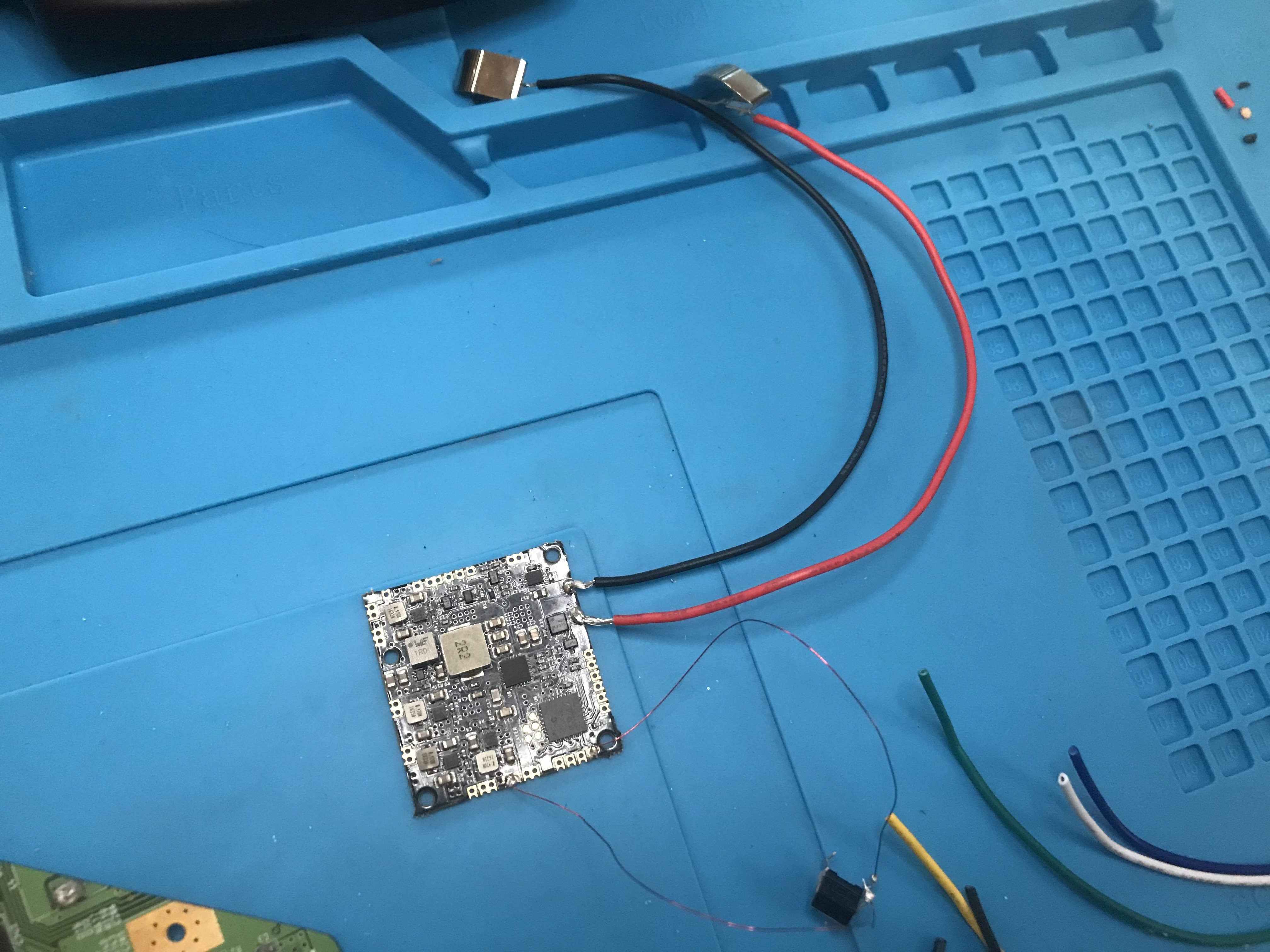

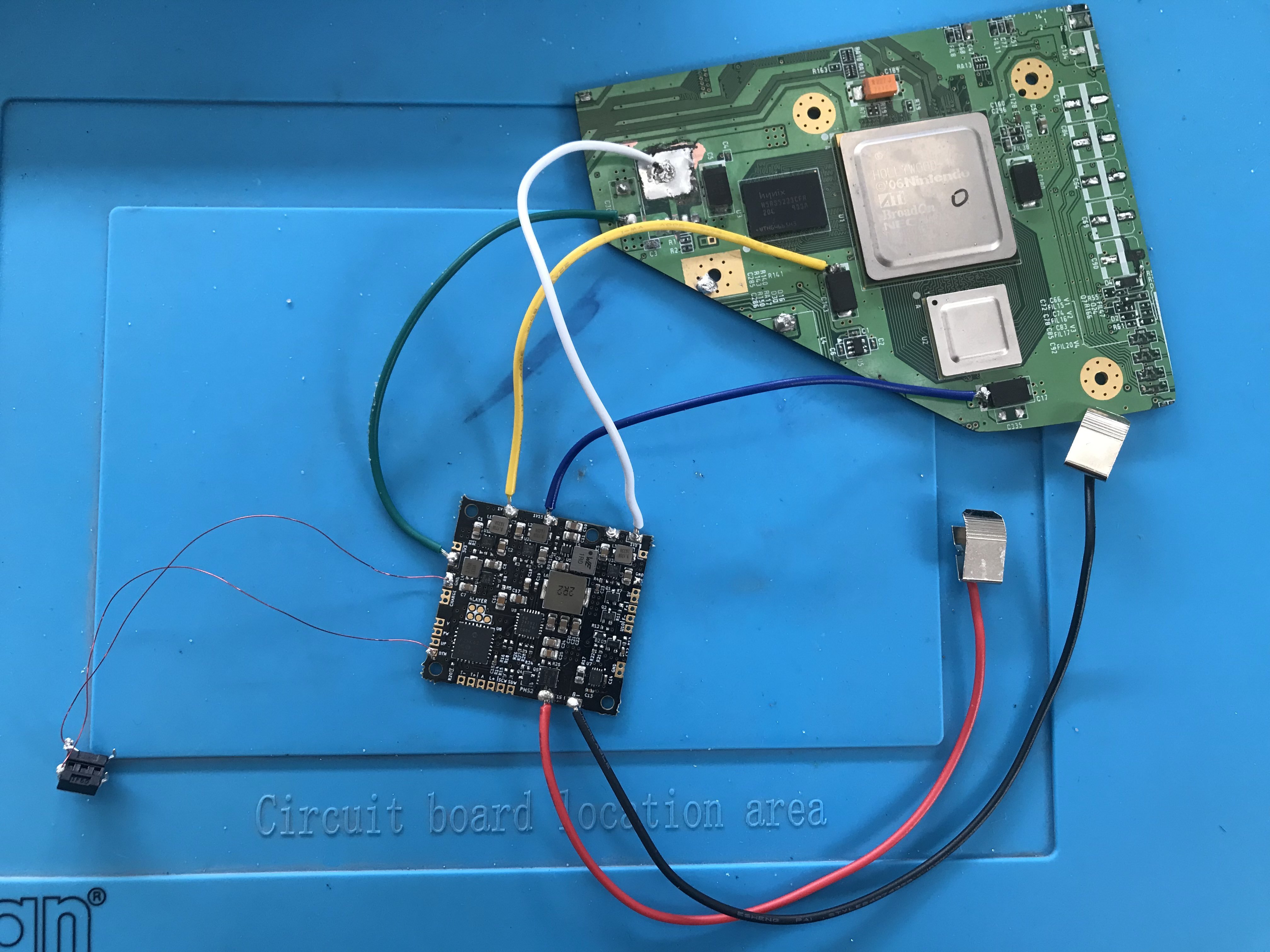

Lastly I have started connecting some wires to the PMS PD so I can test if my Wii is still alive. Still working on this.

I'm not sure if the half fucked LDO can be left there in that state, but if your Pinecil can't hold the blob long enough to remove it then I'm not sure what to suggest.
The lifted pad on the screen board is fine, it's just a ground pad.

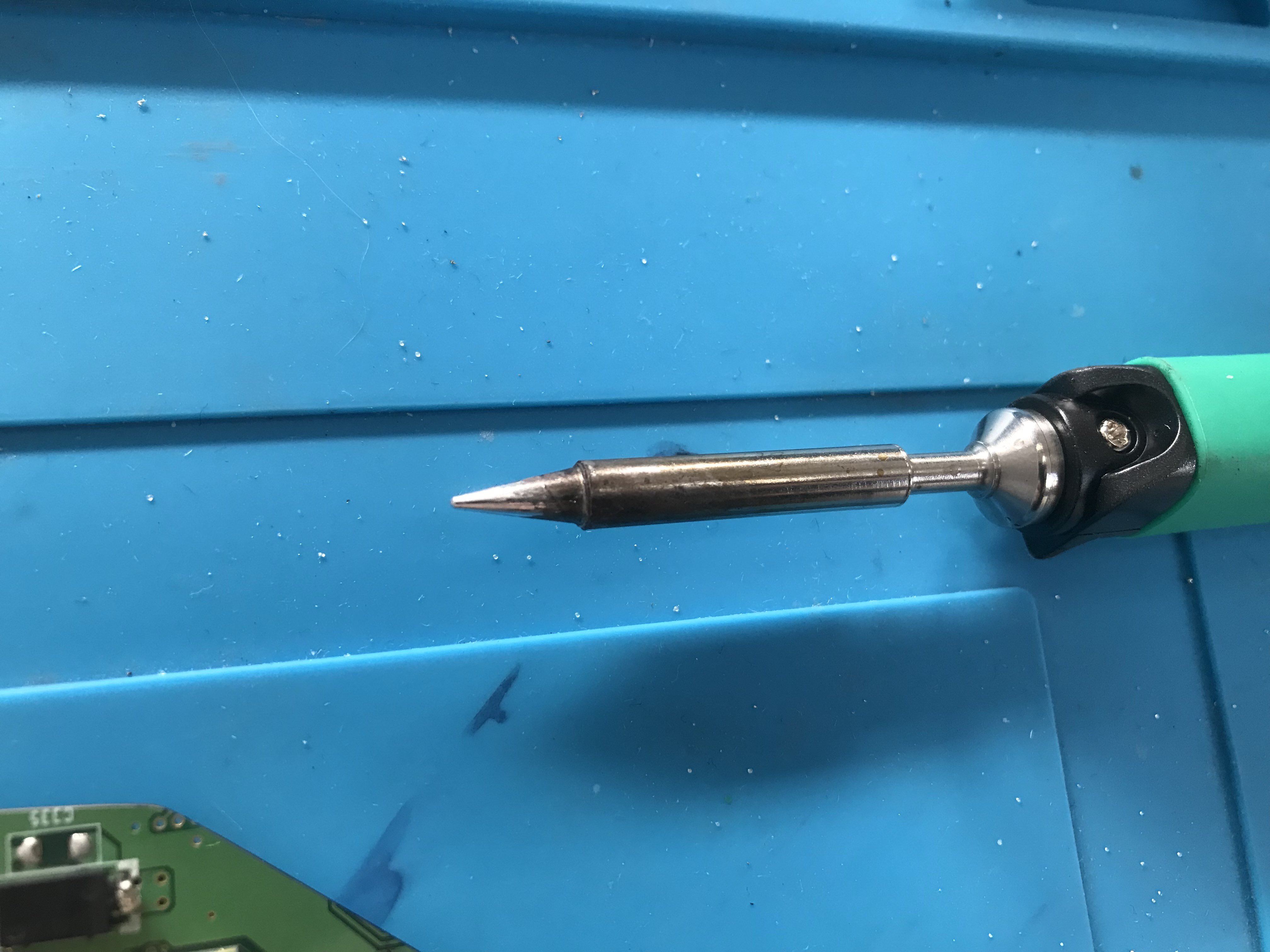

Update 31.08.2023:
I bought the Anker Nano II 65W USB power supply from a local supplier, along with a 2m "Fast Charge" USB C cable. I've seen the Anker being recommended for charging the Ashida, so I wanted to buy it anyways. Figured I could also use it to power my Pinecil.

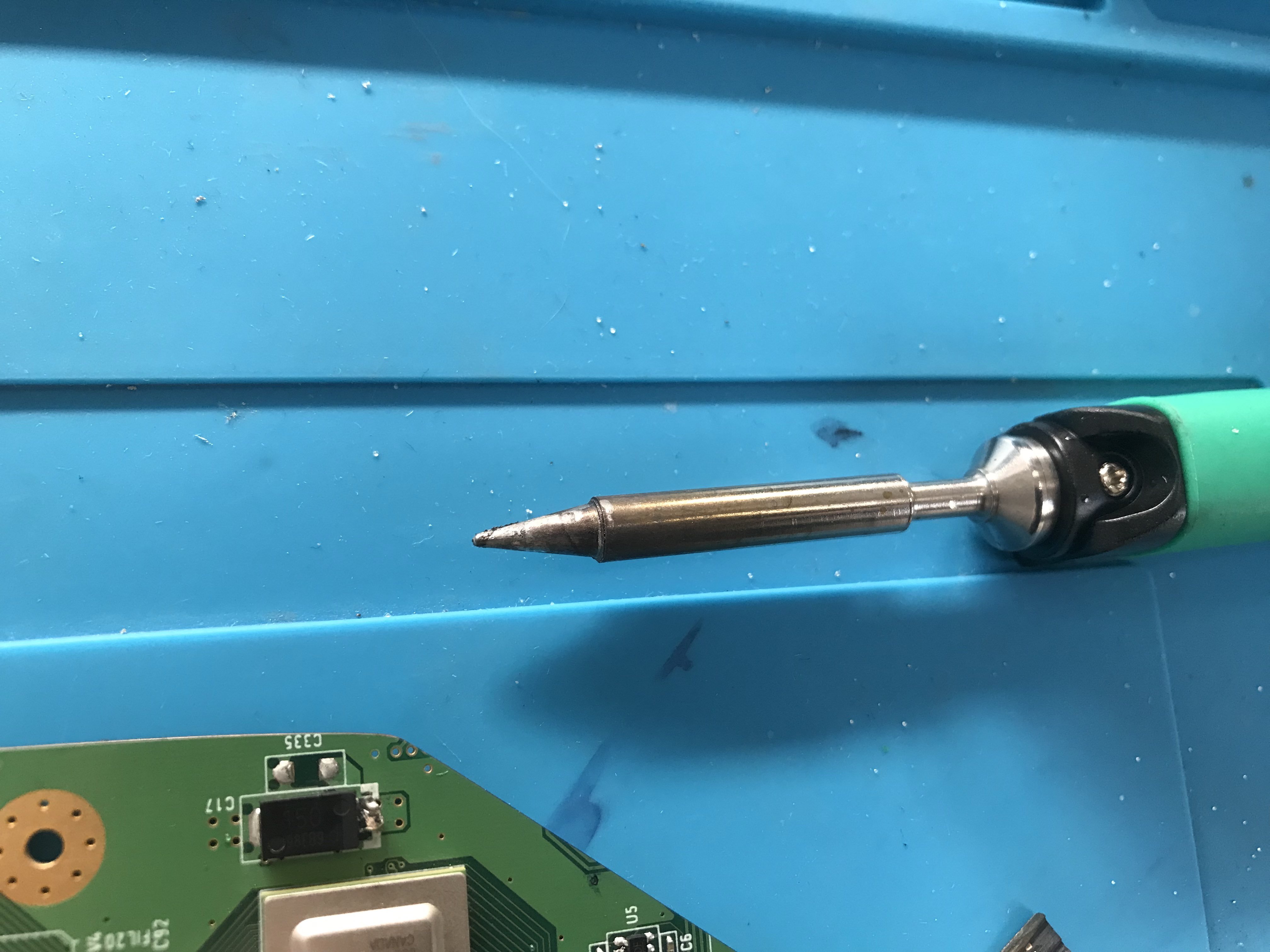

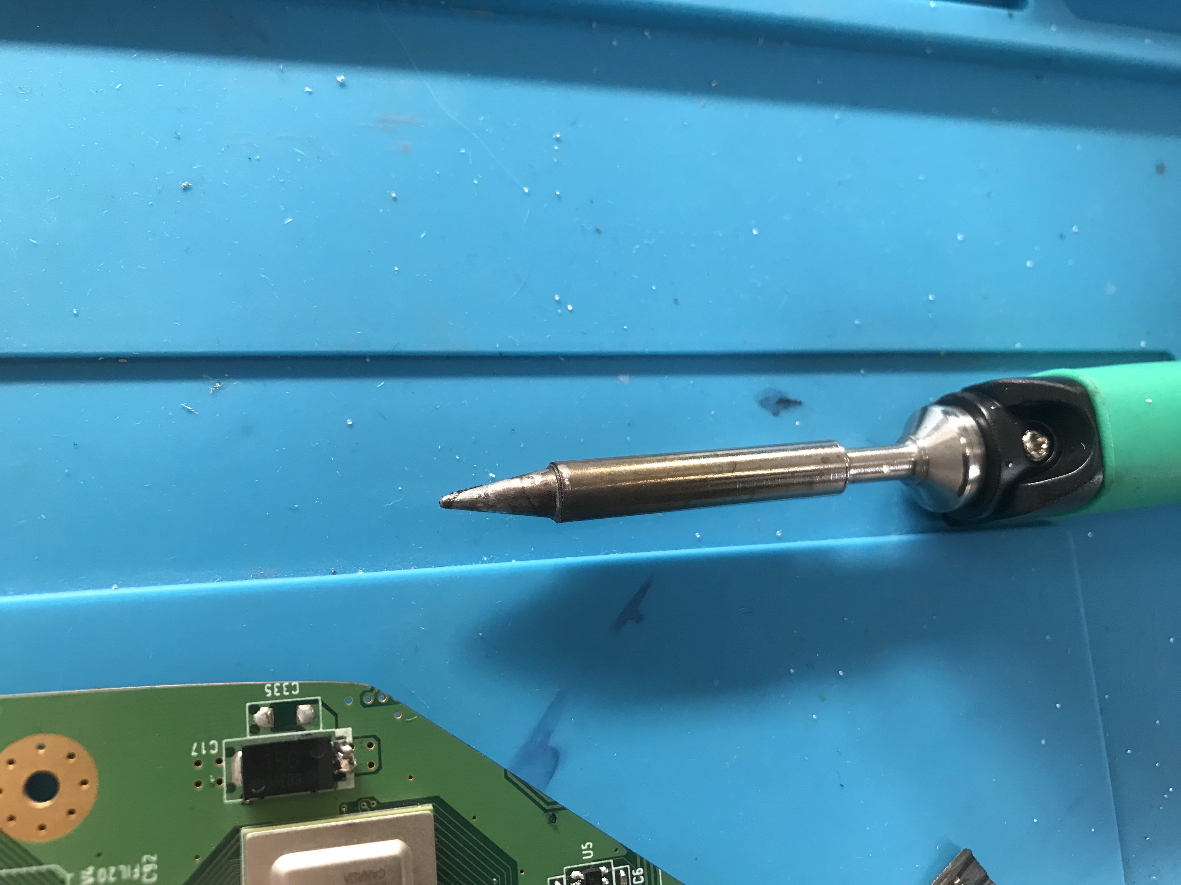

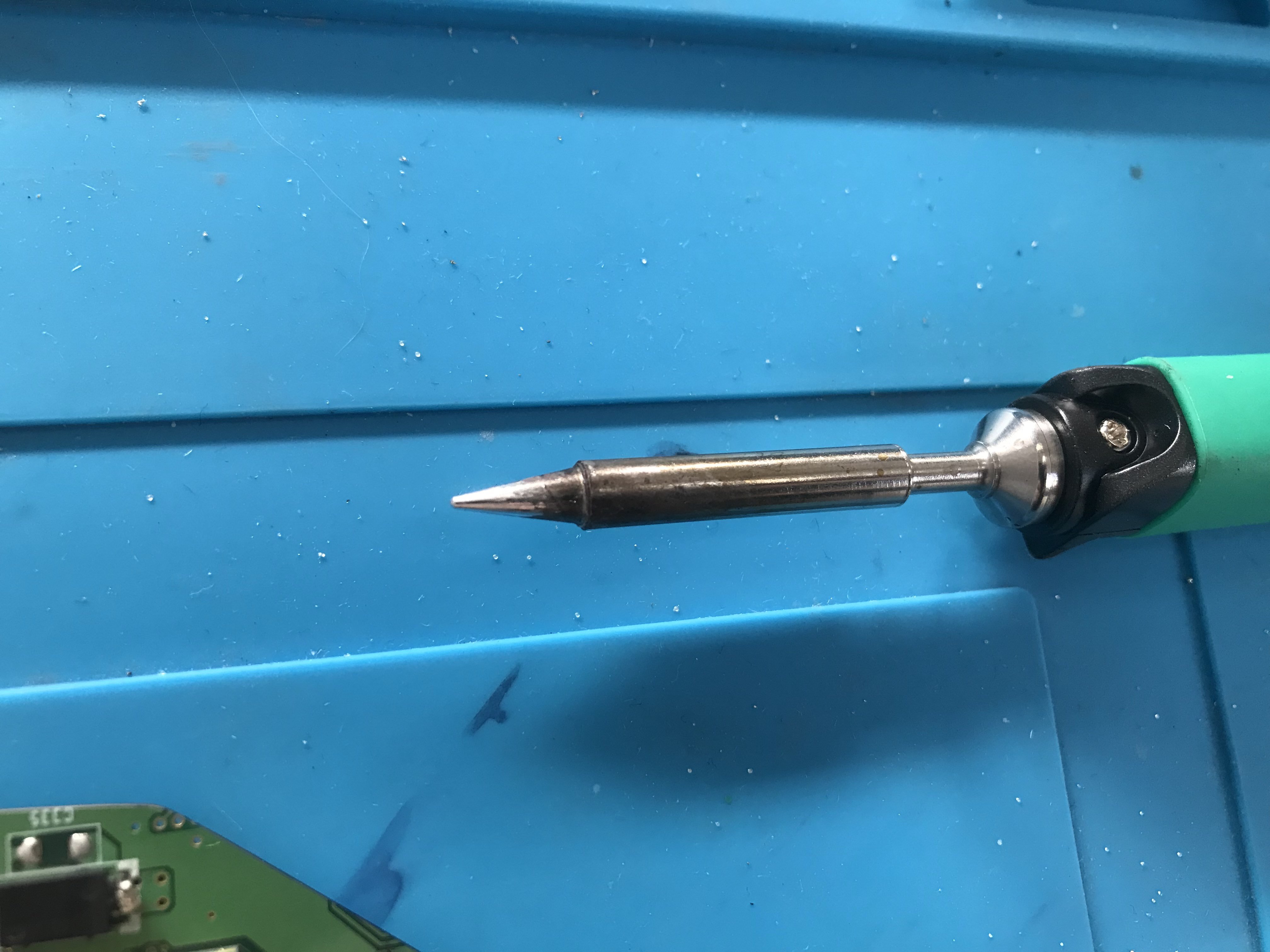

The new power supply definitely helped! The soldering iron rose in temperature much more quickly and was able to hold its temperature when heating up the LDO. Sadly, however, I felt my soldering iron was unable to really grip the solder on it and transfer heat sufficiently. This was also apparent when trying to tin the tip, as the tin would only stick at one spot of the tip. I figured the tip either needed some good cleaning or feared I might have destroyed it already by being careless. Cleaning it with damp swamp and brass wool did not help.
My tip looked like this-ish.

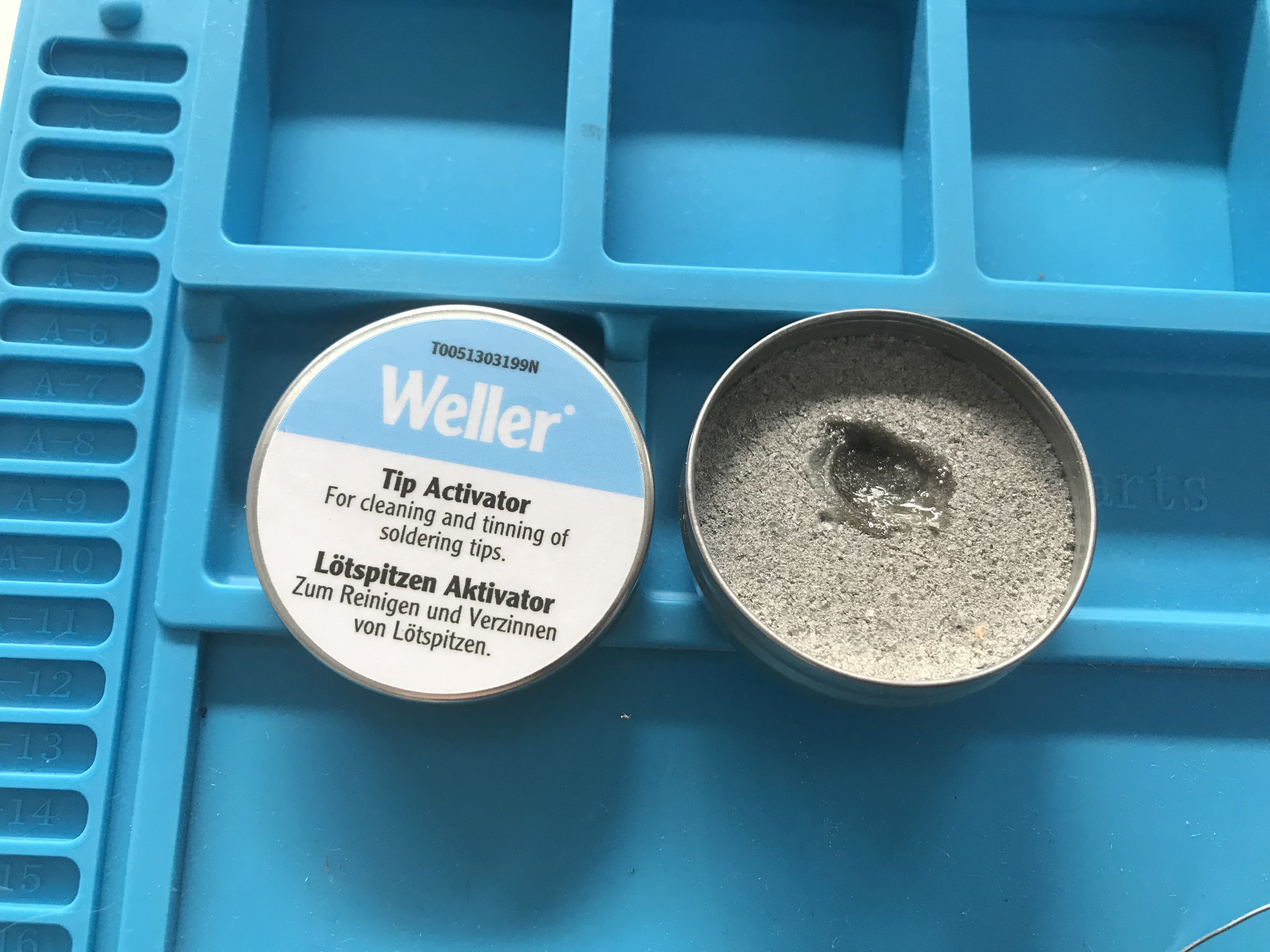

I watched some videos on youtube and saw Tip Tinner being recommended. I bought one pack from a local supplier and tried it out. Cleaned the tip with damp swamp and brass wool first, then into the tip tinner it went!
Tip after tip tinner.

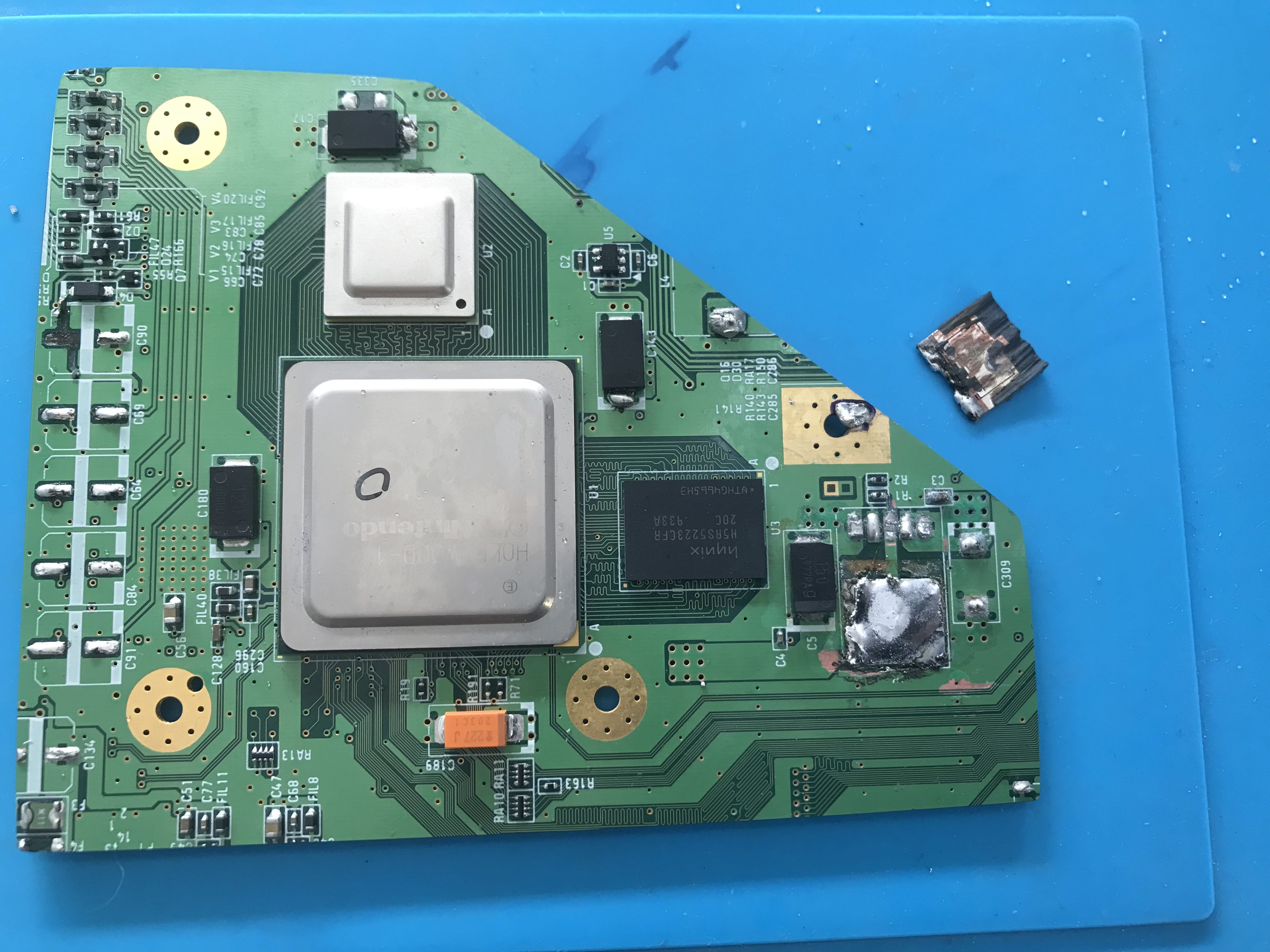

The tip gripped solder much better and with this change I successfully removed the LDO!
Before:
After:
I cleaned it up with some isopropanol and a toothbrush. Resistances are still fine according to the table. If you look closely at the part where the LDO pad is connected to a wire going to C4 you may see that I did some damage to the board there. I am worried I might have severed the wire going to C4. What kind of consequences does this have? What can I do to check if I have severed it?

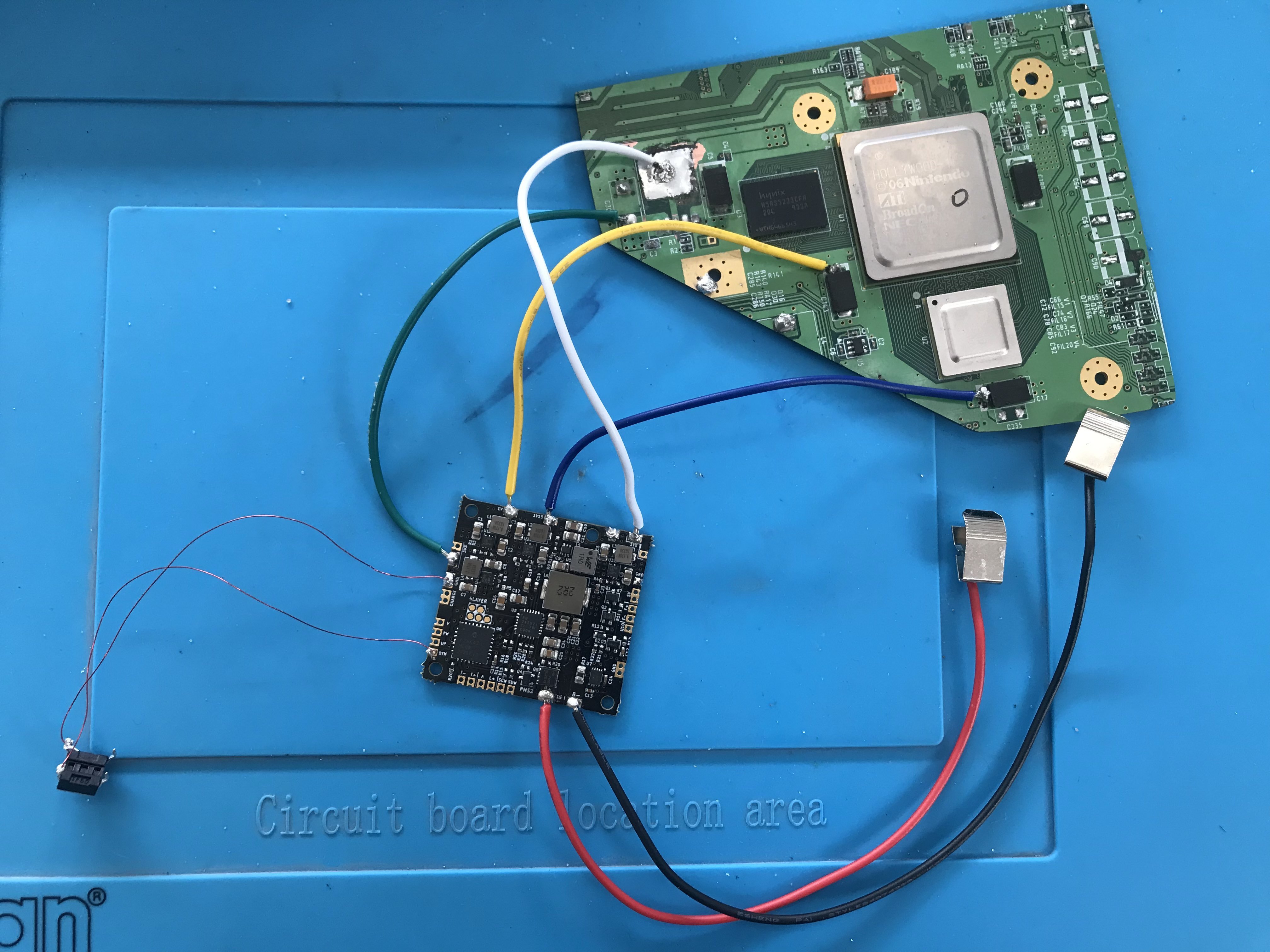

Lastly, with the LDO out of the way, I began wiring up voltage wires from the Wii to the PMS2 using 22 AWG stranded wire. I followed Ginger's Wii trim video for this. I found it somewhat hard to properly connect the standed wire to the solder blobs. It was as if they wouldnt grip the solder without a good fight. I pre-tinned the wires even. I'll chalk it up to skill, but I hope I dont have to redo these more than once...
Next step is to hook it up to the screen to check if everything works. I dont have a montior that can handle composite afaik, so I'll go directly to the screen I will use in my final build. Crossed fingers!
