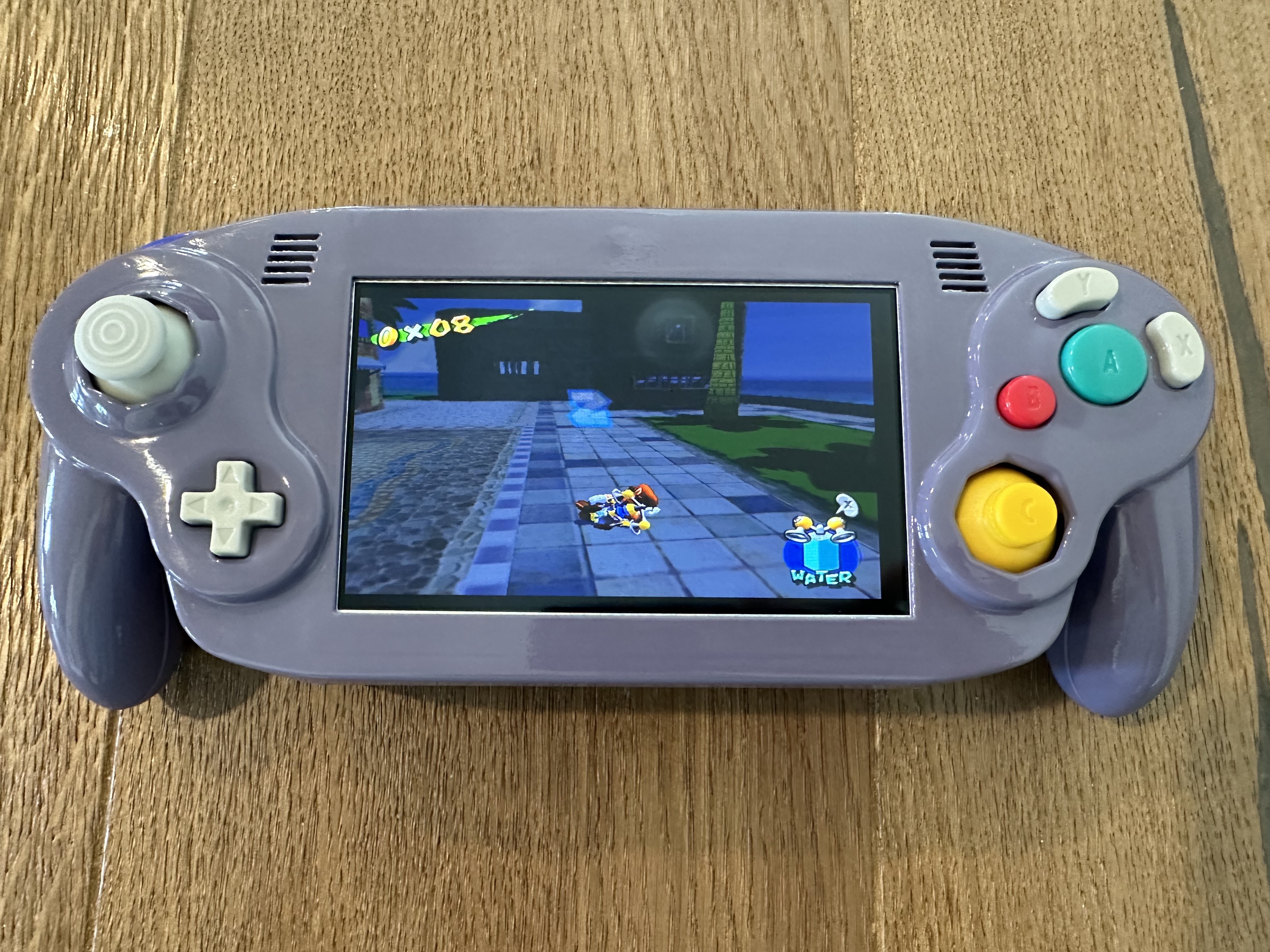

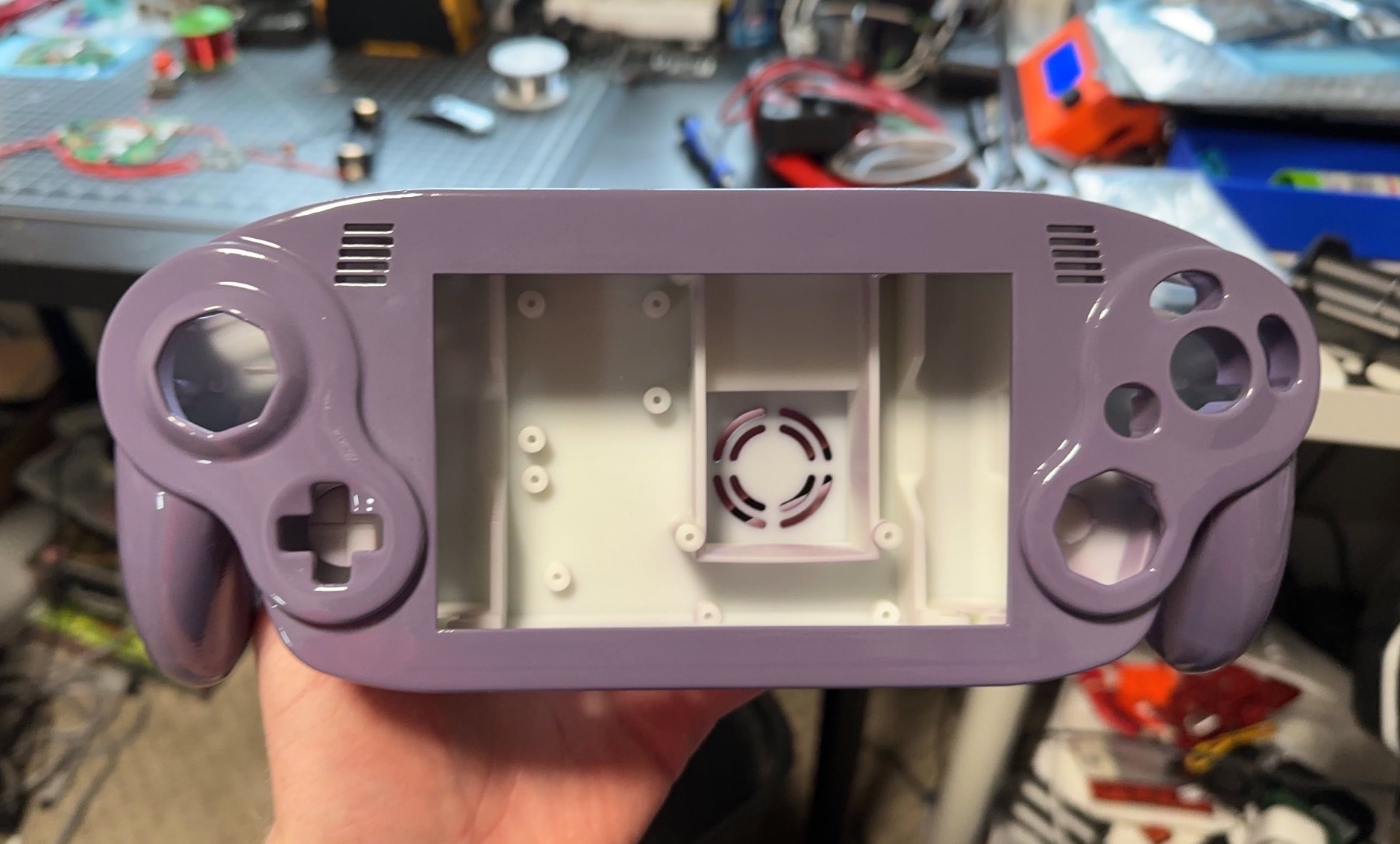

Just after finishing my G-Wii I learned so many things I could do better I decided to try out an Ashida build.
So far I have prepped the Wii and painted my case purple. I got the color as close to the right purple as I could with what my local paint shops had on hand. I think it looks pretty good!

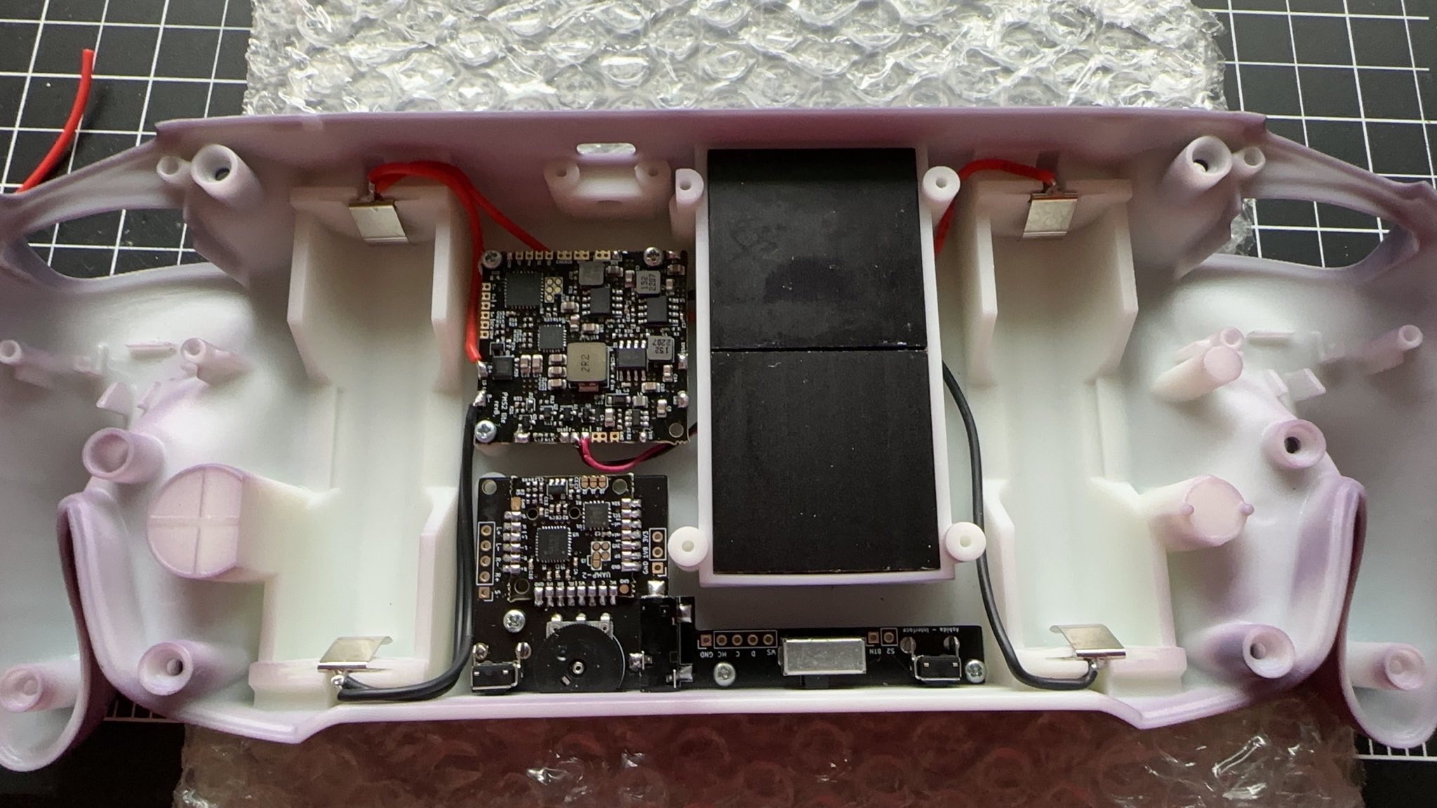

Now that the paint is done I am starting to mount the components. The Ashida is so much better for keeping wiring clean and neat.

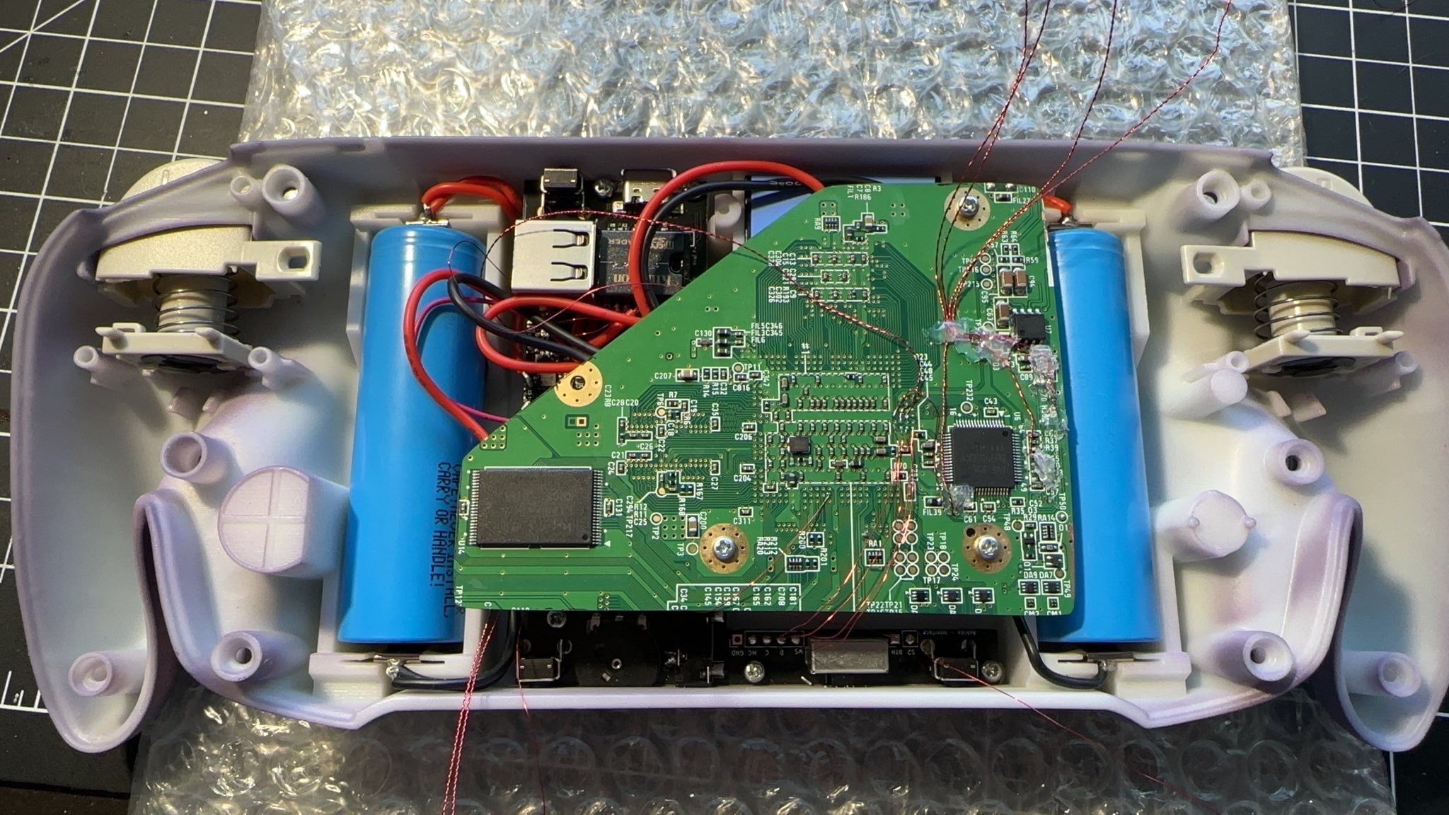

For the Ashida pcb what does the S2 line go to next to the power button?
Diagrams tab, halfway down the page -- Bluetooth module, which is optional. Presumably is for controller sync, but that's a guess.
Thank you for the help I should have checked that page again.
Yeah that's the pad for the Wiimote bluetooth sync button

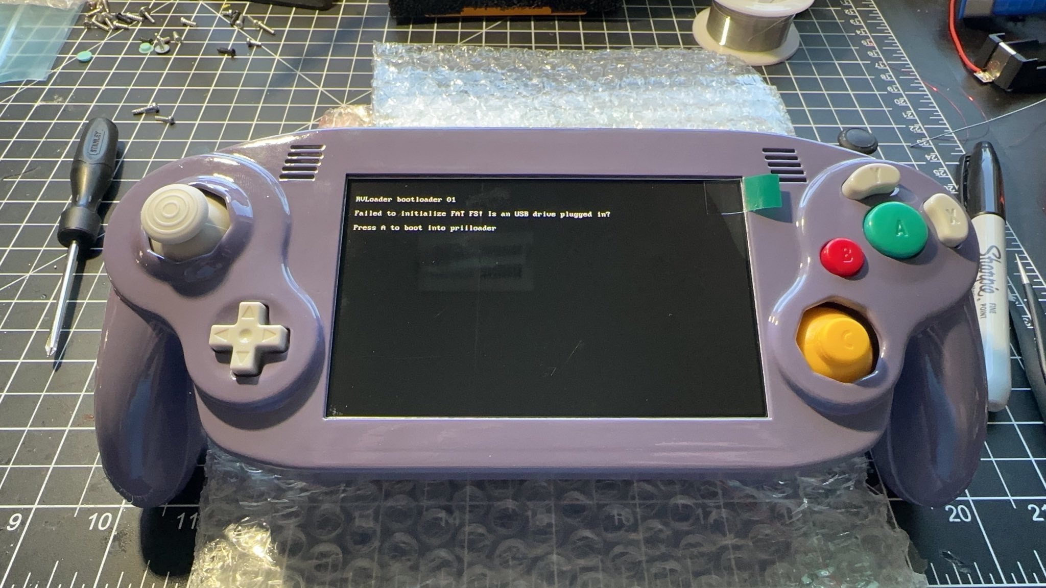

I got the wiring all done and have the Wii booting up.
I just have some issues with the current Kingston adapter I am using the filesystem isn't showing up for RVLoader to run. I'm getting a new drive today and hopefully that'll solve the issue. If not, I think I might have gotten the data lines mixed up again like I did on my GWii build.

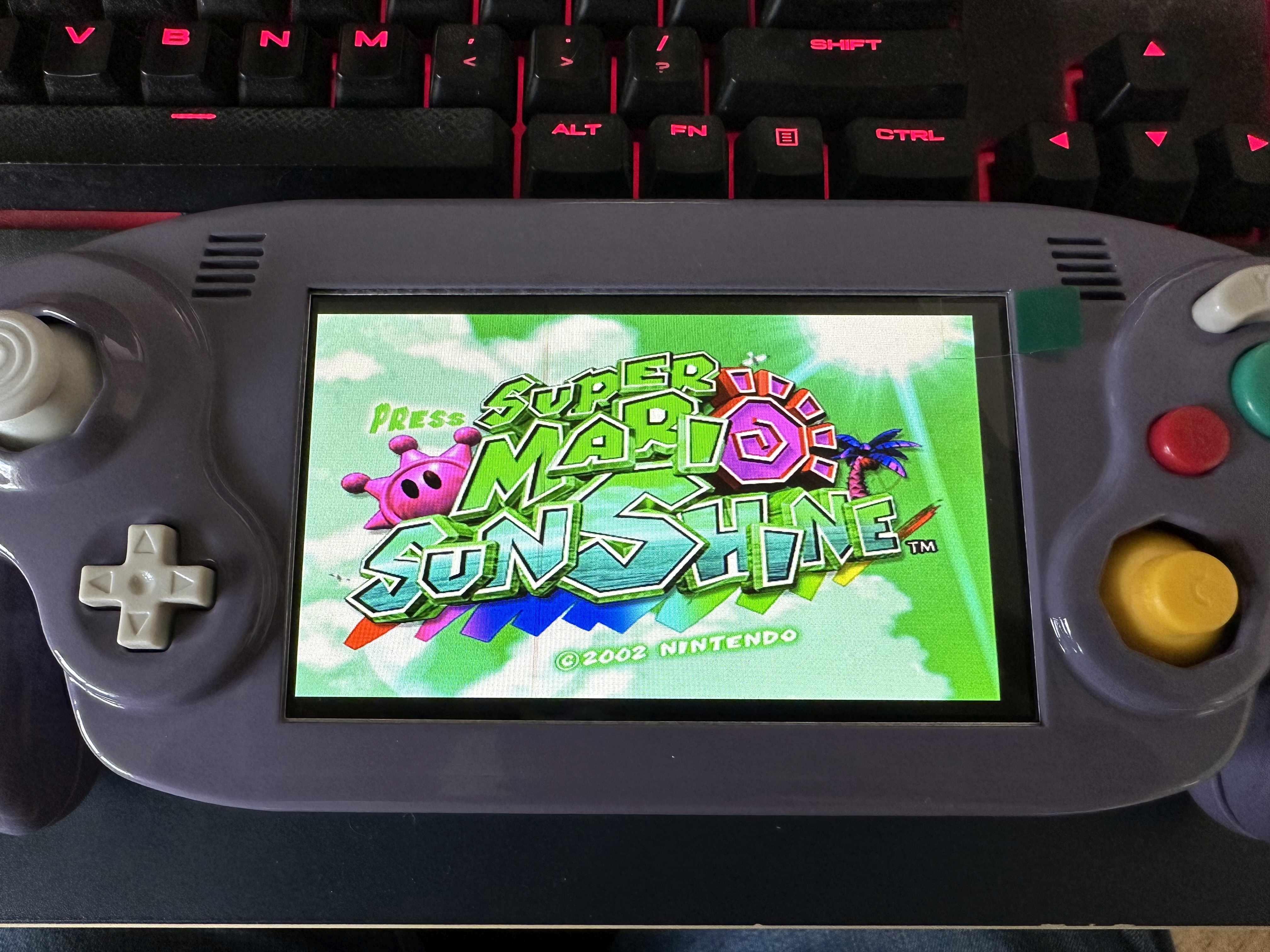

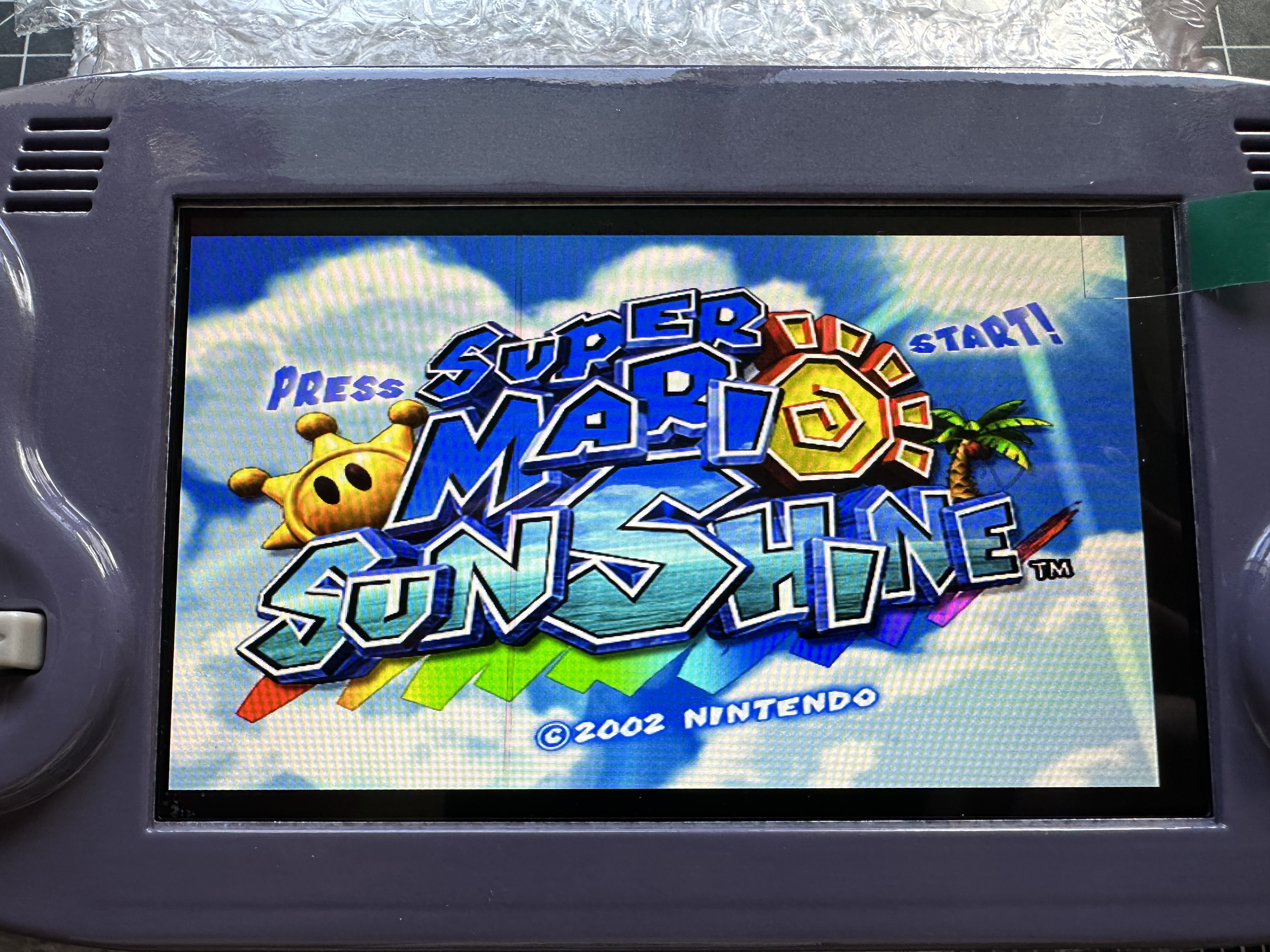

Just got the MX chip all set and finally booted up a game.
I am getting weird color issues any clue what I mixed up?
Looks like green and blue were swapped. The stars are supposed to be yellow.
red + green = yellow
red + blue = violet

New issue, my console crashes randomly after a little bit of time. It'll either give me a game error crash or it'll outright hard crash and restart RVLoader. Any clues as to why that would be?
Sounds like either a cooling issue (system is overheating) or a USB issue. What are your thermals looking like if you power cycle it right after it crashes? And how long are your USB data lines?
The thermals are good. Haven't seen them hit above 60c. The USB lines are about 4 inches long I'd guess.
Edit: Just got home and checked the data lines for the USB is about 6 inches long actually.
Where are the vias on the back of the motherboard for USB? I want to move it from the front of the board to the back and see if that makes a difference.
it's very gorgeous. I am absolutely in love with that clear coat. How did you get such fantastic results? what clear coat did you use?
I tried using rust-oleum universal clear coat and it stayed tacky forever, even after letting it dry for a week.
Thank you! I had my professional painter uncle paint it for me! It was an automotive clear coat called Upol Clear #1 (Amazon product ASIN B009LHER0M). It only took 24 hours to fully cure. I'd definitely recommend it.
