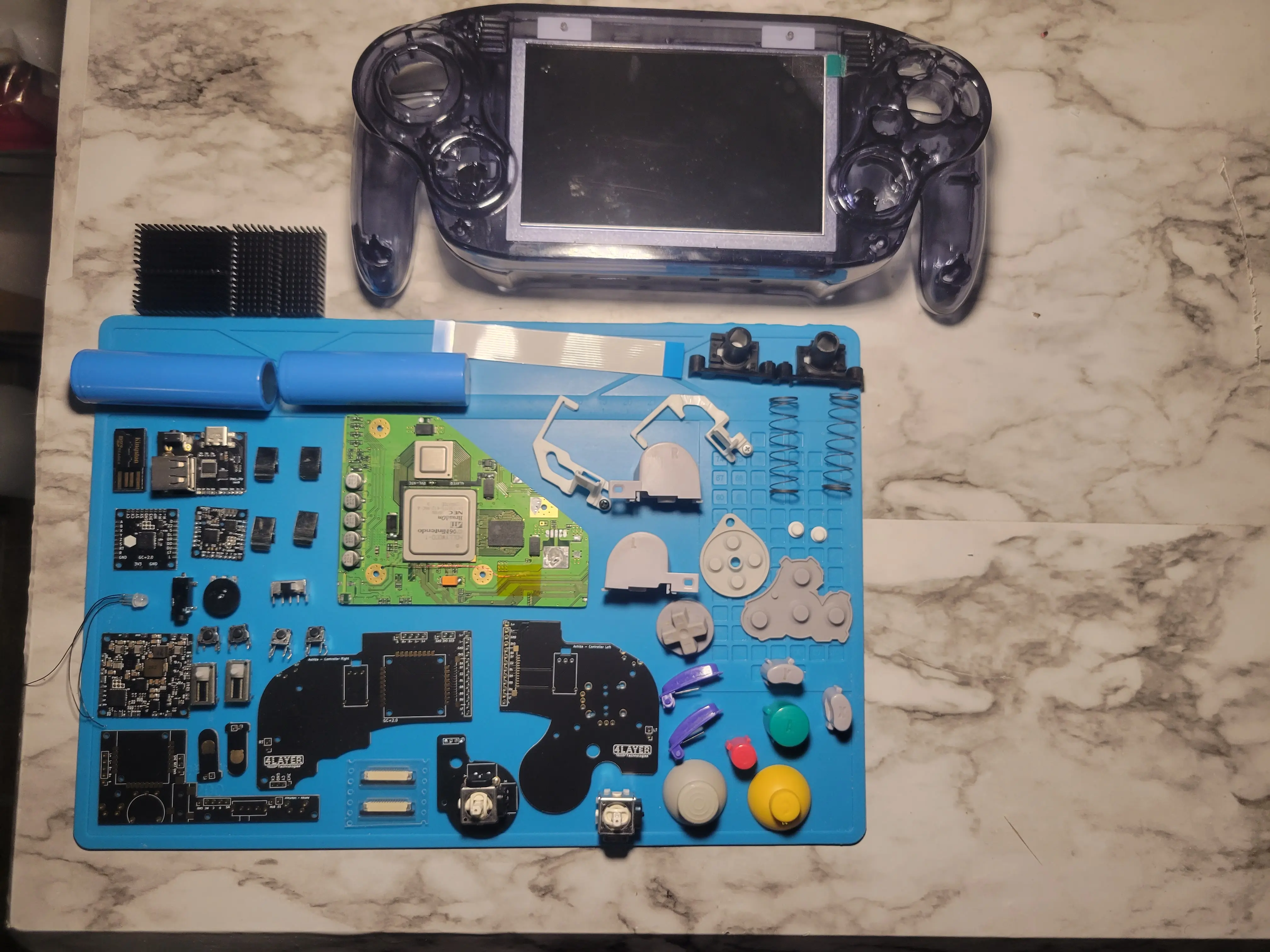

I remember when I built my first ashida, I already had a lot of the tools but still needed to buy the proper gauge wire, and ended up having to order another set of ashida PCB's because there was an issue with my first set.
At the end of the day, I ended up paying in the ballpark of around $1300 CAD to build mine. Don't be frightened by that number though, I got PCBWay to print me a transparent shell dyed purple and thats what cost me the bulk of that money:

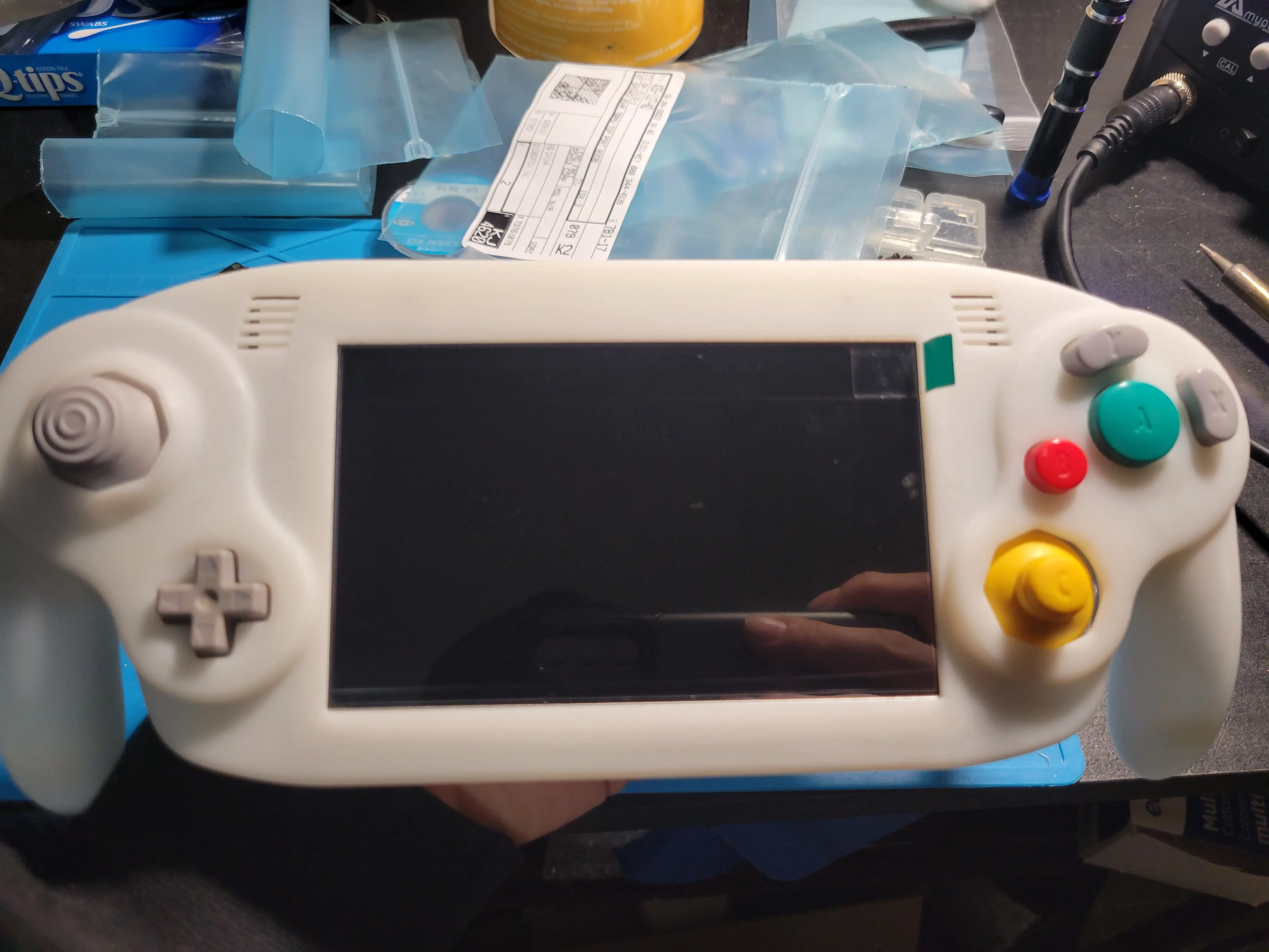

You can get away with a cheaper shell even if you decide to go with a 3D printing service like PCBWay or JLCPCB. For example, my second ashida shell only cost me $60:
