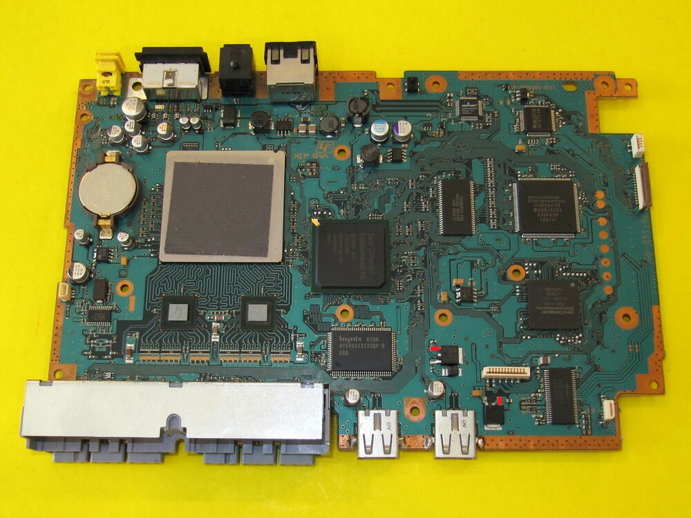

The points highlighted in red should provide 8.5 volts
Thanks mate for the answer, I thought that the MOSFETS will be my best bet, talking about the MOSFETS, which is the purpose of each one of them? I want to say if each one of them is for each USB port or one of them is for the USB ports and the other for other board component.
And last thing, about the GND for the circuit (In Line for the DC-DC stepdown and the 2 Out Line from DC-DC stepdown to the router and to the USB to SATA adapter), where I should take the GND???
Thanks again, I know that this kind of questions be a newbie's question for this forum, but I don't want to break the console because I'm newbie, hehee.
Any copper plane connected to the shrouds of the USB ports is GND, as is essentially the entire border of the board. If you have access to a multimeter you can find any voltage or common plane you want. Highly recommended tool for a newbie lol
Yes, I got a multimeter, and I know that my questions are so... stupid, anyway, finally, I've taken the 8,5V directly from the power connector (positive) and the ground from one of the shrouds of the second USB port (right port). Other thing is that after disassembly my PS2 Slim 77004 it has a GH052-51 motherboard, which is not the same that appears in your picture and have the mosfets in another locations, I commented this, because I want to know if someone knows which is the mosfet (or an alternative and better alternative solder pinout) that provides power to the DVD unit in this motherboard, because I've been searching with the multimeter and with my poor knowledgement in electronic, I have not able to do it, and of course, this is because of like I will place the SSD / HDD where the DVD unit goes, I want to use its voltage (DVD Unit) for be able to use the ENABLE function of the DC-DC stepdown.
