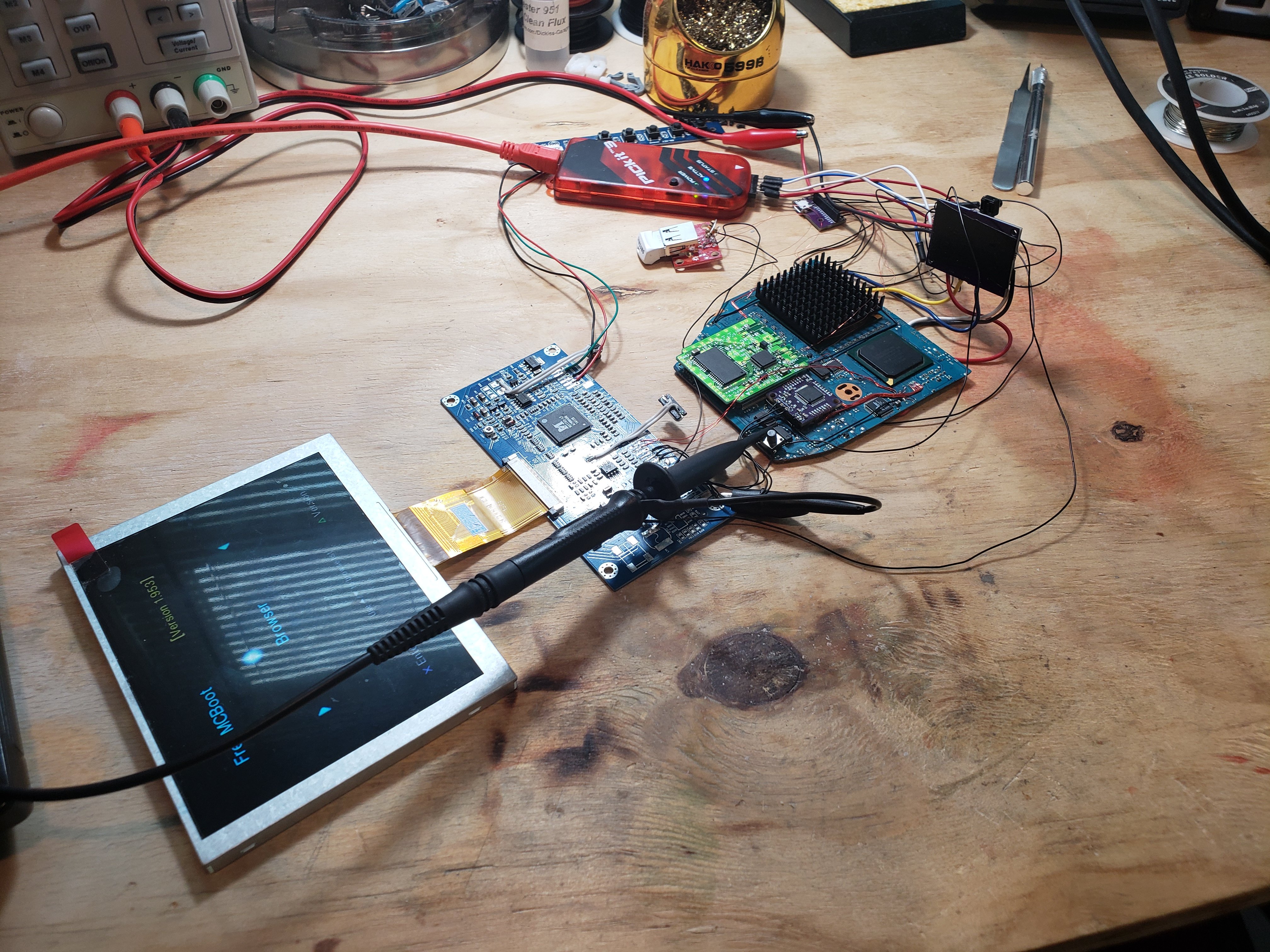

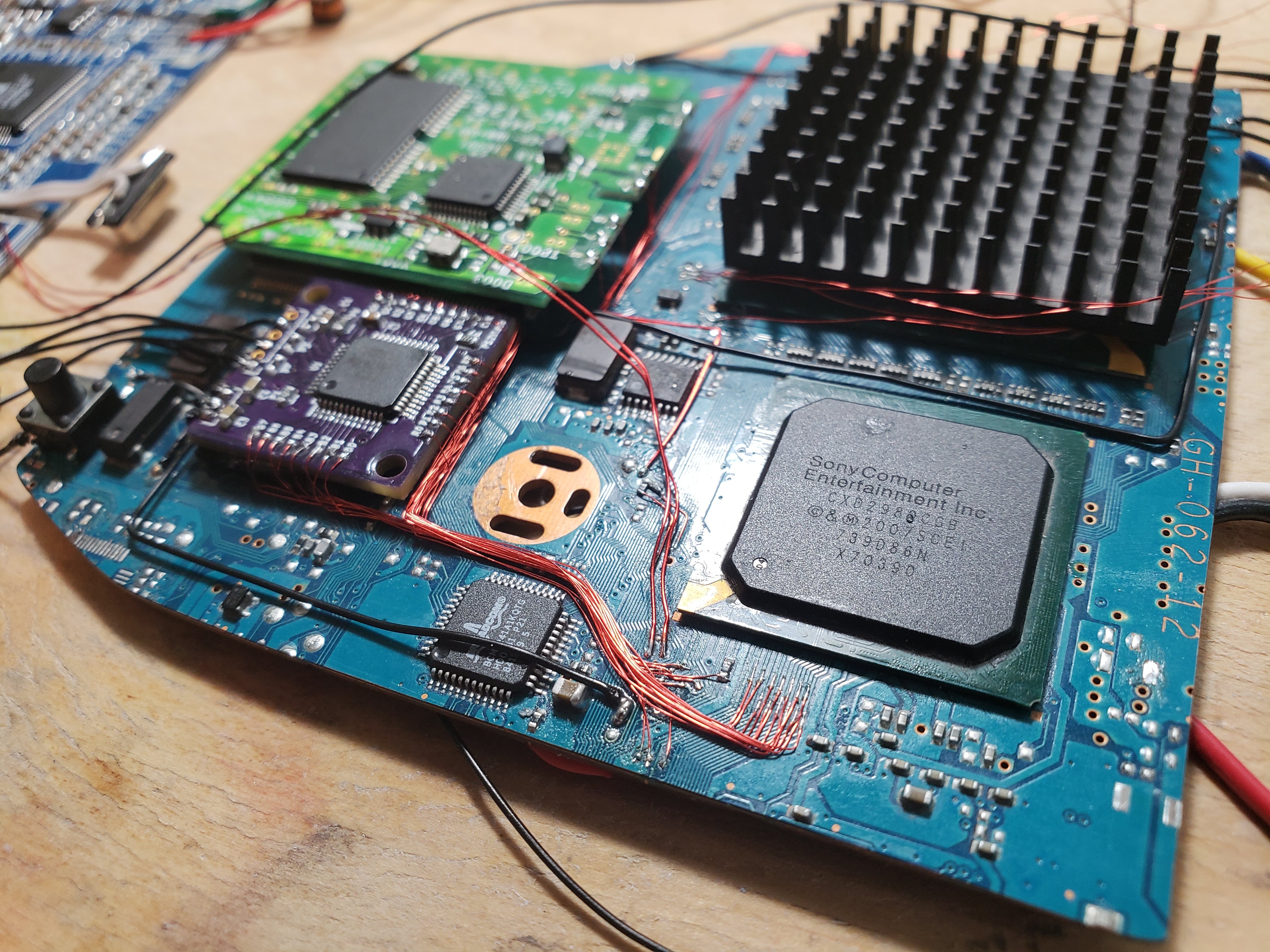

Had a weird problem with my controller pcb, so I took a break to do some wiring on the ps2 motherboard. I implemented the ps2 autoboot into PowerS2 and basically rewrote the whole code since I originally wrote it months ago and it was not good

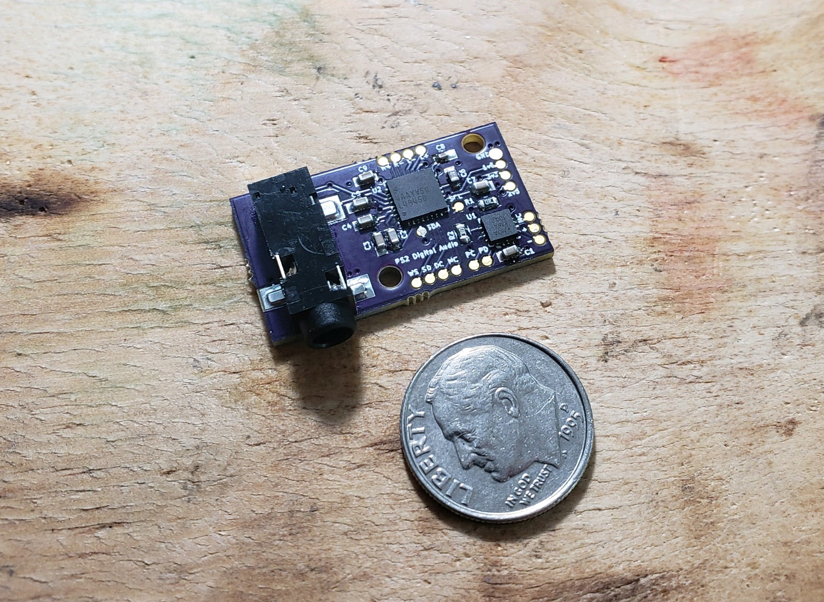

My LM49450 digital audio amp for PS2. I made this pcb as a proof of concept before I integrate it into my controller board. I am happy that after taking a few measurements from the I2S ps2 audio, and guessing on some others, the code made sound first try :awesome:
Looks great! Is a circuit you would be willing to share? Am knocking my head against the wall with the LM49450 at the moment.. If not, a point in the right direction would be great:)
The LM49450 is fairly easy to use. Follow the schematic circuit at page 2 of the datasheet. You then need a microcontroller able to configure the amp through i2c
Thanks for your reply. The schematic looks fairly straight forward. I was mainly wondering what the other chip on the board was, as I can't figure it out from the images? I'm planning on using a Rpi to configure the amp.
It's a PIC microcontroller that is only used for i2c driving. You can also use the raspberry Pi if you want (it supports i2c).

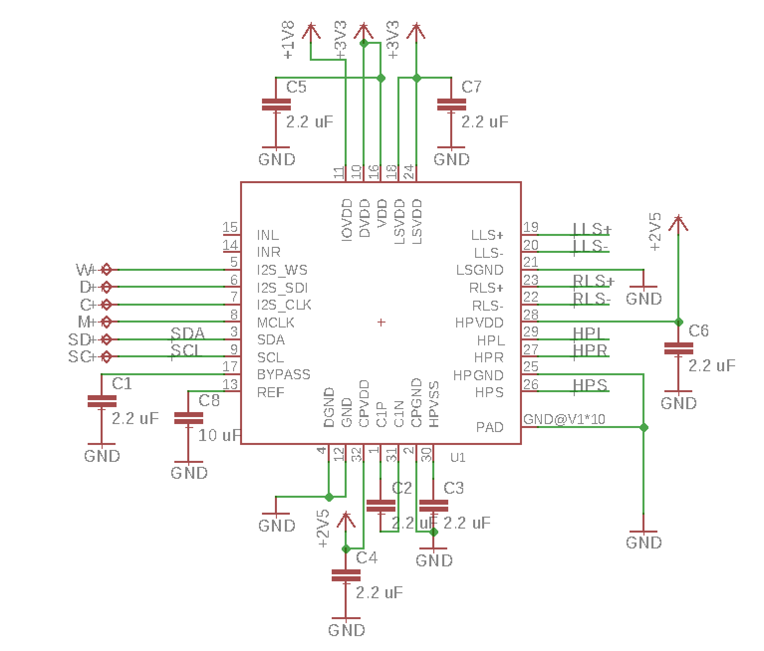

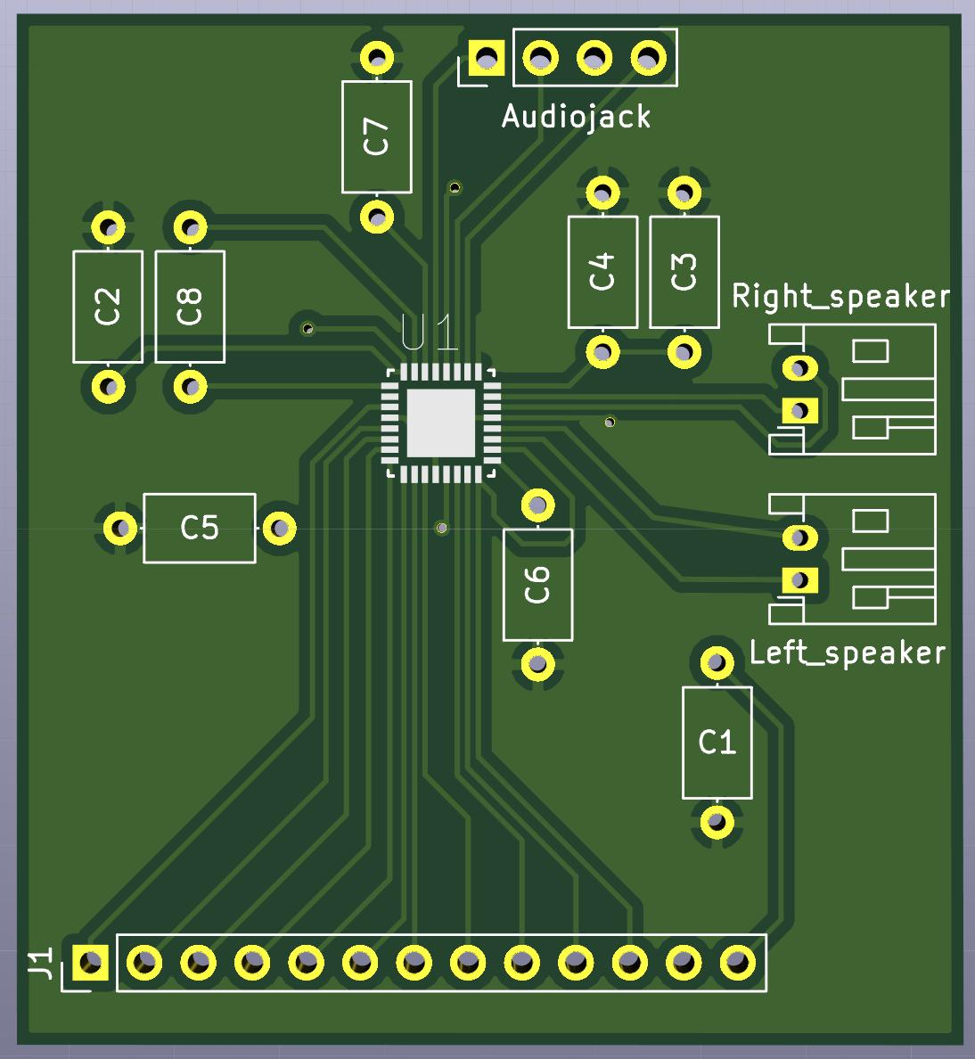

So I made up a test board for the LM. Would you mind pointing me in the right direction as to what capacitors to use? Can't for the life of me figure it out.
a>
Sure.

Would you mind letting me know which micro controller youre using? Turns out the RPI doesn't support MCLK output sync.
I thought you were using the pi only to drive i2c, not i2s (which I thought was from the PS2). Anyway I am doing everything on the Wii (both i2c and i2s).
