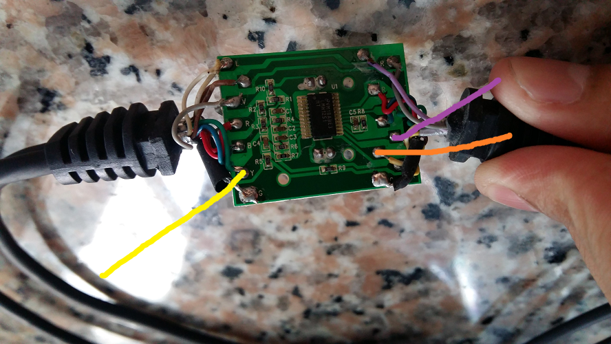

I got the PS3/Wii VGA cable today and tore it apart to get the LMH1251
So from the PS2 motherboard, I connect the
PS2: S-Video Y ---> LMH1251: Y
PS2: RGB ---> Screen: RGB
LMH1251: H & V ---> Screen: H & V
PS2: Video Ground ---> Screen: Ground
It doesn't work for me which means no output :(
Does it mean I have to buy the 5" Dalian Screen?
Or can you suggest any alternative ways to make the VGA appear cause ya know, it kinda sucks that I have to sell the screen if this screen that I bought isn't compatible for the LMH1251.
It's not a scan doubler, the vertical sync is still 15khz which most screens- if not all by now, don't support. Those Dalian screens are the only ones currently known to take 15khz and they don't sell them anymore and after an email conversation with some of their technical folks they don't have any capable of it either.
Your best bet; without making your own scan doubler, is to use component out on the PS2 and the L7009 7" screen which takes component in. http://www.volumerate.com/product/l...monitor-w-vga-bnc-av-input-stand-black-335866
It has a TTL connector so you might be able to connect an existing 5" screen to it, I'm pretty sure the MStar processor it has automatically scales but I could be wrong.

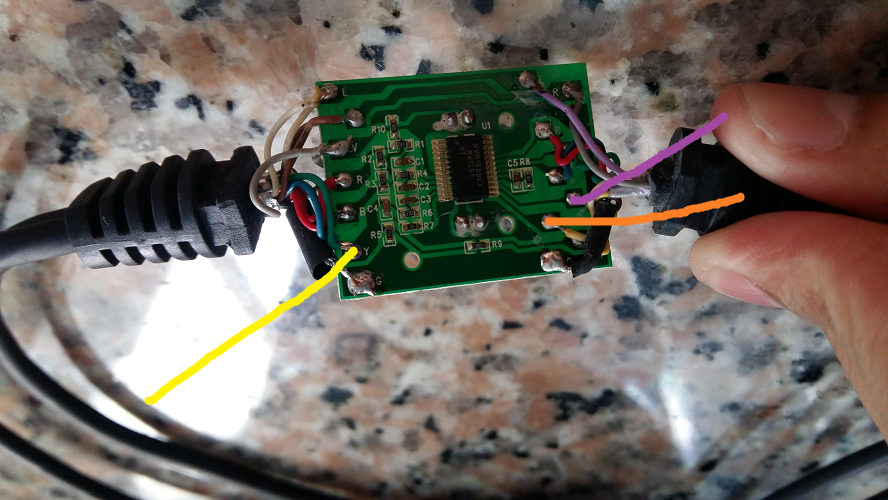

Yeah, that chip just converts the sync info to H V. You still need a 15KHz compatible screen to use it with 480i/576i video. It's written in just about every thread on the subject on MR and here.
I think, first of all, double check your wiring.
You should be using 6 points from the PS2 A/V output.
Pin 5 or 6, 8,9,10,11,12 based on this table
R, G, B (pin 9,11,12) wired directly from the PS2 to the VGA input of your LCD.
Then for the LMH1251 board, you need to have 3 wires on the input and 3 wires on the output
Input:
- 5V (pin 10) to the V point
- Composite (pin5) or Luma(pin6) to Y point
- Video ground (pin8) to G point
Output:
- H to Hsync
- V to Vsync
- G to VGA ground
Last thing is to make sure you have RGB setup on your PS2
This is an example, you don't need the resistor btw
fYW_z45pPLO9OTLXxuUpGRN47_dg0IcdKNVXzfe2G3OgNLGn4AZCotYm1gbNw-oupwTXZTEB80OmANORBLZj9uSu9m6wHxwOTdVeCqcmJH2eYUOXYyB6bzOnEsuAnqTRPRYIOq18VmHGiDKPMoDFhIv-oOH1vA1_fEDpf77eAFGE_ImlXG17RNfwwew7kzYx7FOpGkxKQzvs4KKROk1KWLfOuEuMfkYldmVaTe_xXdm3qKfI30tVj327fe-RROqJm1naY8--4C6z7QWVCIzb26_Z_-5WEMjgVVs2WJ3IaDc_2ll3pd-UPD_wU7YFZnbOQtf6qk_lGdYgmUK2jn89U9ERBlS3eAItBSPjR-j1VyJa8Urg1dk1ei4Sw0oBa9vqdQK3P-rQJA3fDvQG0x5X0SfepKfa5ieAJfl1MGFbFHLV4thtmjwI-kPpmGspVxGnzueHOuA1xBXgSulYKe1DNbNoV7EBhaoeh2qzdKXEXL3MuSjj-ZaikhjV_1nH6_NlOPeo5tPy3vw1bEKpxR_AeGTMHweRbYYjAYWDf78DIo-8l8MqTzFoMzo-M6ocSN5X-0oLKmJ7T9JhHVst82cypJHRDxj6xyu0SQKHyWsLIg=w800-h600-no
If all this doesn't work then it could be due to your screen not take the 15KHz signal and in that case a dalian screen 5" or 5.6" should work.
I got a new 5.6" a couple weeks ago and it's working fine with the PS2 input. 15KHz is not officially support by Dalian but for some reason those 2 model seem to be working which is great for us :D

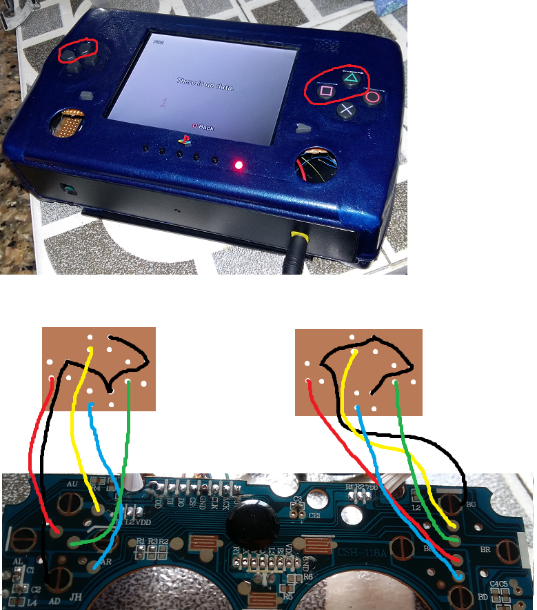

Need your help.
I'm using the rubber tact switch.
Idk why can't I press the
I recall having this same issue when I wired up that controller. I can't remember how I fixed it exactly, I think it had to do with wiring each button separately (don't bridge the common connection on each tact switch, use a wire for each). Start there and see what happens.
Are you taking the common from one of the button lines? I've hit this with the N64. Doing this means that it'll only work if the other line is open/closed depending on the wiring. That controller in particular is one that I had so many nightmares with I ordered the mini board from RDC.
Going back to the N64 the buttons should work on a shared common as long as it's not taken from one of the button lines. The controller generally uses VCC (I think) so wiring as such might resolve the issue there. It is as frustrating as all hell trying to trouble-shoot this sort of thing, and those knockoff controllers are pretty flaky too.
Wire up the analog sticks and post pictures of your wiring
how is the analog related to the rest of the controller even if I haven't wired it yet?
Shouldn't the d pad be working even without the analog sticks?
I don't know for sure about your controller, but I know that with my Wii portable if there aren't sticks hooked up, then the sticks will move in a random direction. So it is very possible that the issue is not having your sticks wired up.
centered sticks have a value that is about 50% of the range, so if they aren't hooked up the controller will probably read something like it is all the way down or so, wire them up and post what happens
It would seem you are doing something very wrong.. nothing comes to mind except for improper wiring. The red wire that is on fire is the power wire which makes sense. The wires have too much copper exposed and the soldering could be cleaner. Keep on trying, trouble-shooting is a good skill to learn.
I am working on the same controller just now and it had the same symptoms. I am fairly certain one of your problems is your analog sticks are not wired correctly. You see, the right analog stick also functions as the action buttons on the ps2 home menu.
