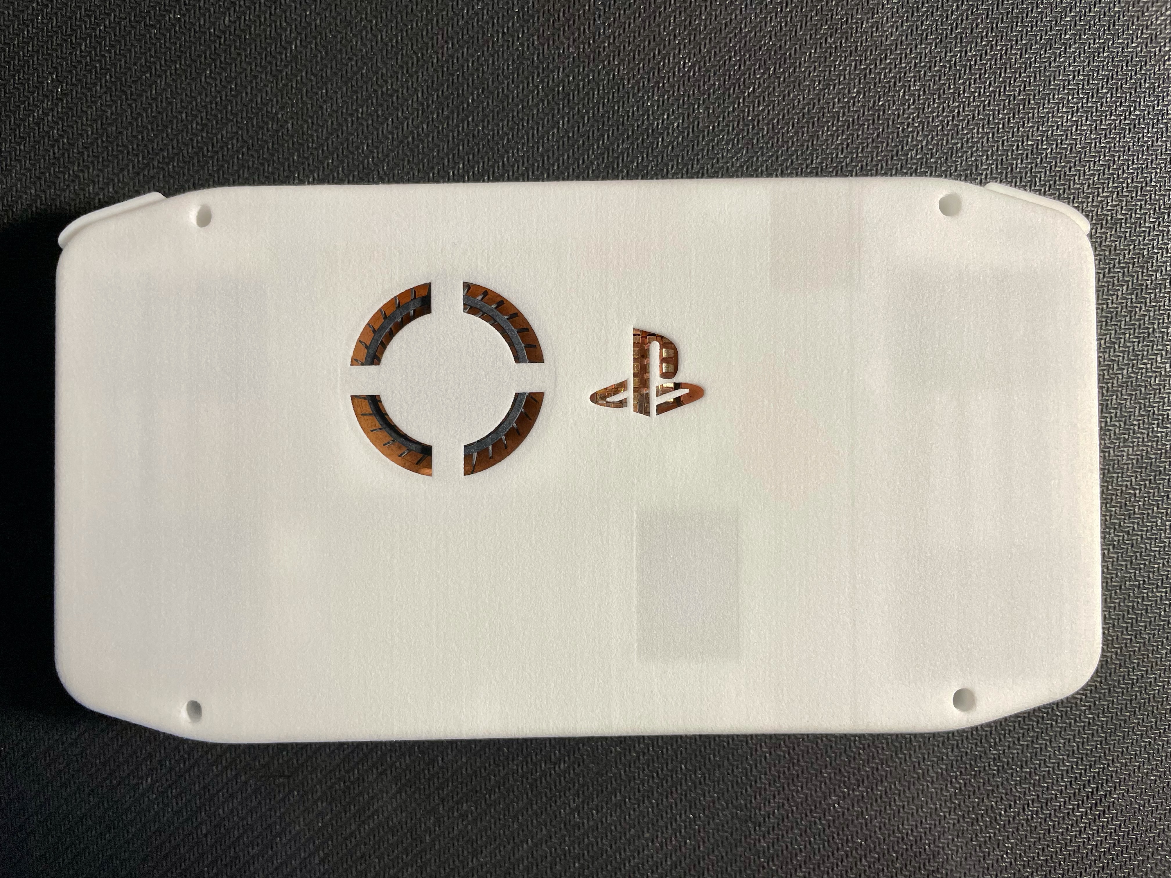

- The back printed a little weird with the rectangles areas having a little bit thinner walls inside.
- Case is slightly warped near the heatsink vent. Unfortunately arrived that way from factory. Also paid for them to sand and polish the case but they didn't do that either...

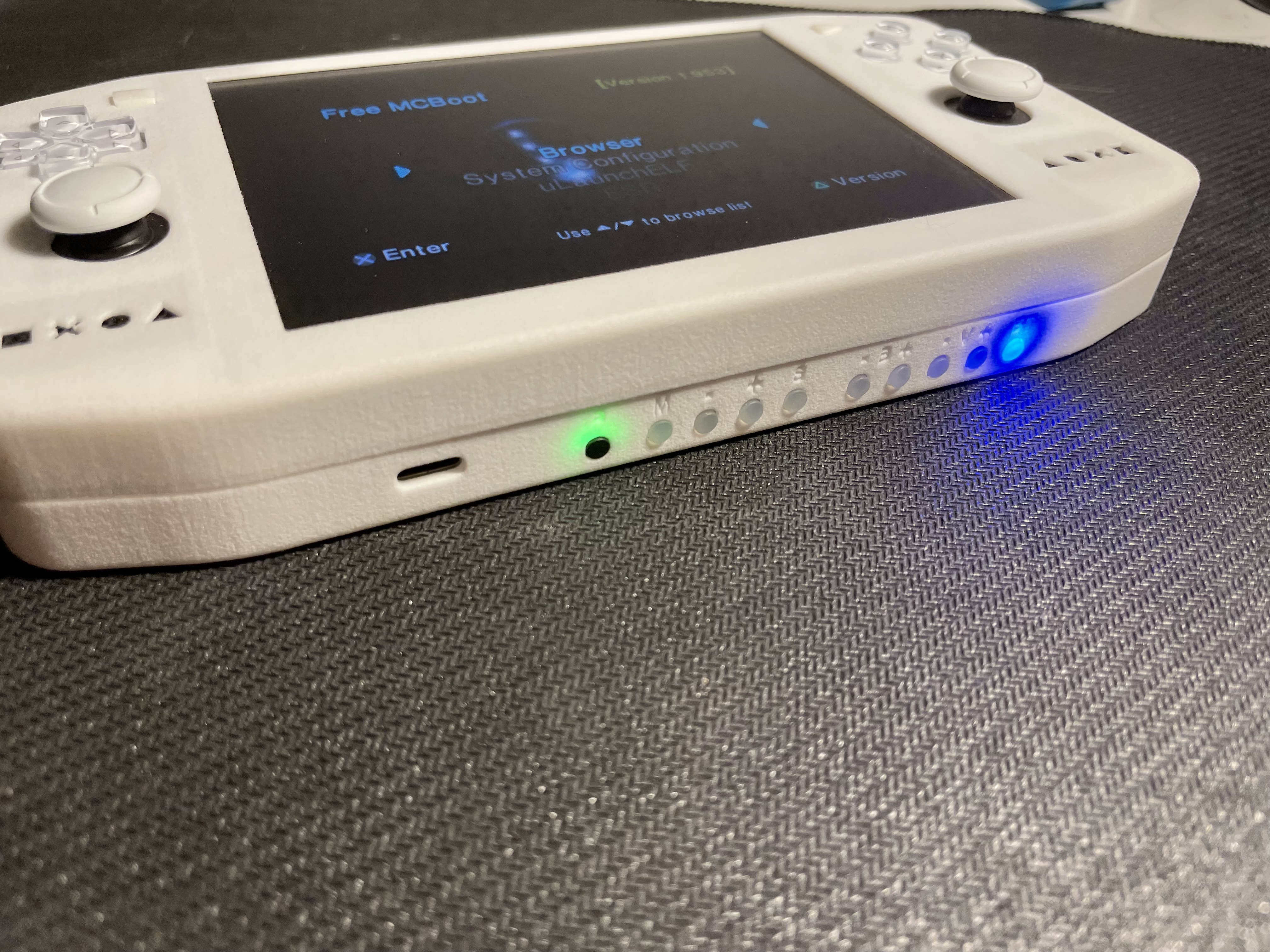

- Power Button, LED Status, Screen/Volume/Bluetooth Controls.
-Bluetooth button lights up when turned on and connected. Camera exaggerates the brightness of the blue LED. When Bluetooth button is pressed, it goes into headphone mode and cuts off the internal speakers.

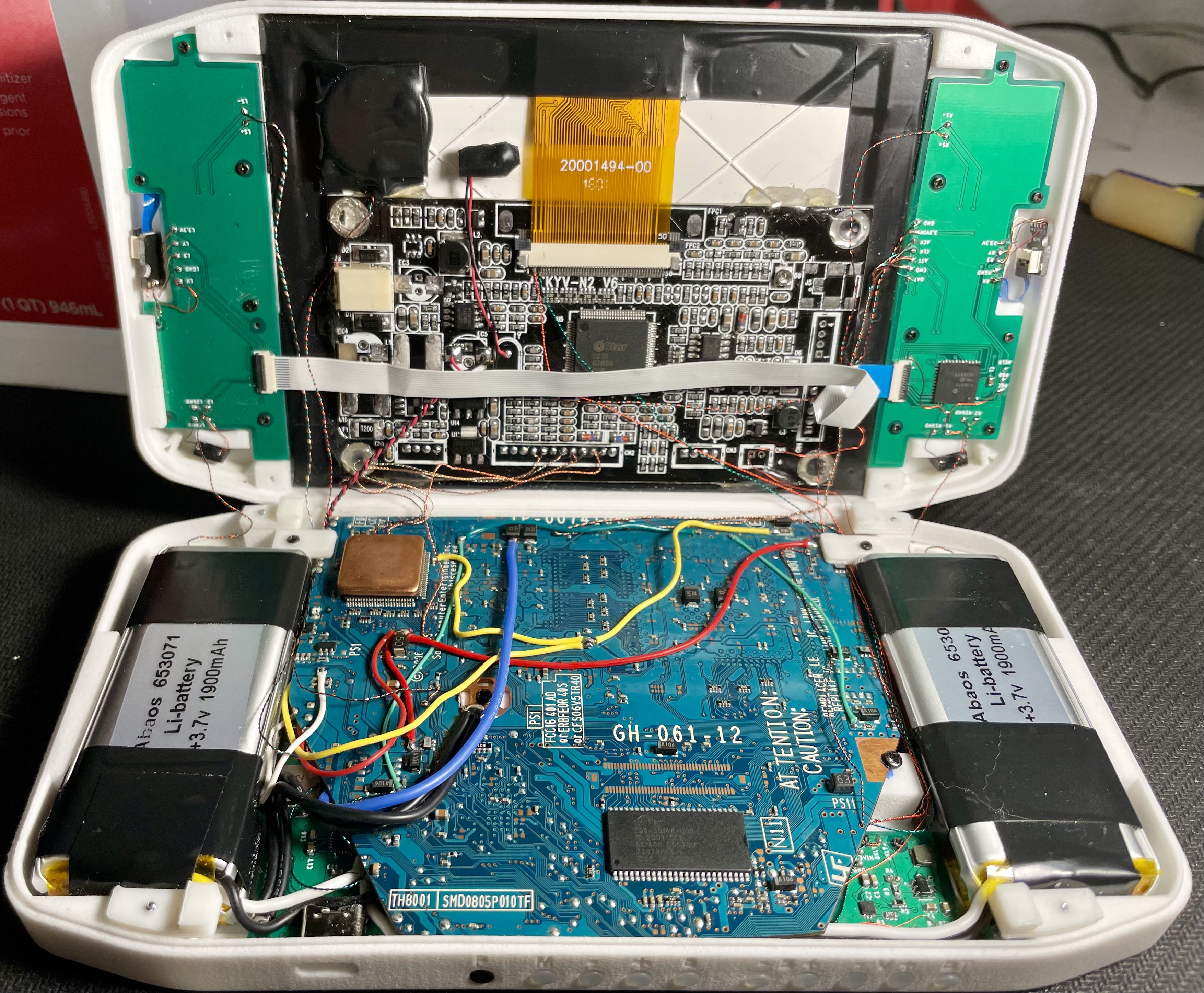

Here is a picture of the internals:
- The PS2 AV Chip gets really hot, so for peace of mind I threw a copper shim on there. I also had to bend the controller board ffc in a weird way since I forgot to swap the pinout of the ffc socket on the dpad side of the board...
Final Dimensions are 175mm x 93mm x 24mm.
