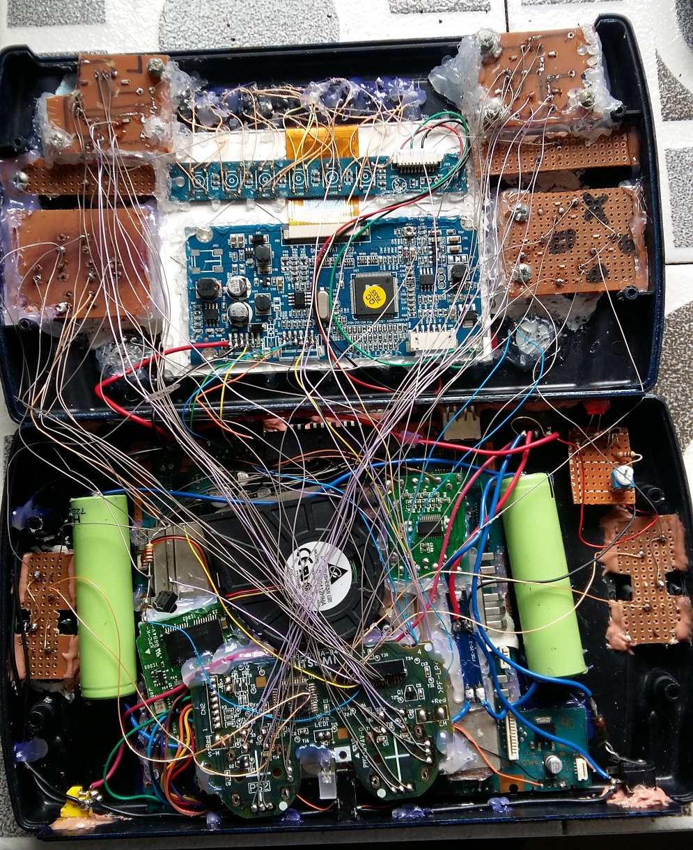

Is it ok if I followed the original position of the fan of how Sony designed it?
Does that not affect the battery life?
(the heatsink is under the controller)

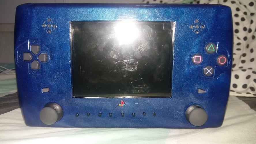

I see several red flags in your construction.
1. There is not a good airflow path between fan intake and exhaust. Hot air will fill the portable and melt all the hot glue.
2. You should use epoxy to support the buttons, the hot glue is going to fail. It appears like you used bondo as an epoxy substitute, not good idea either.
3. I see a floating resistor with long leads. You should cover with electric tape to avoid a short.
4. Next time I recommend securing the controller on the top half of the portable. The wires will be shorter and neater. You should atleast support the wire somehow, maybe some adhesive just after the solder joint. The 32awg wire will break off after several times opening and closing the portable.

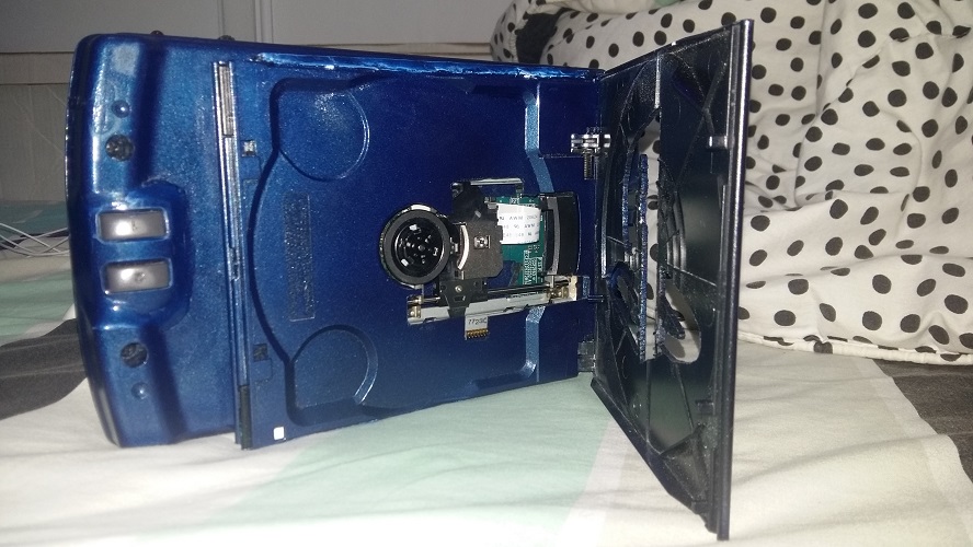

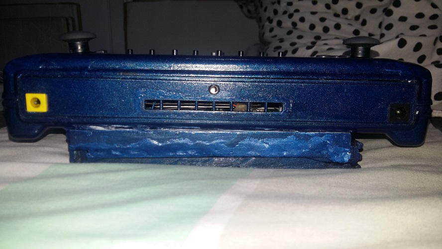

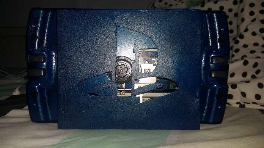

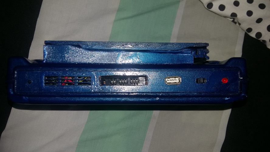

Just added a CD Drive
I just realized that not all games work properly on Free McBoot
Still not yet 100% done though
Battery is still annoying
your work is awesome! can you post a picture of how you wired your disc drive? Im working on one myself and am trying to include a disc drive as well.

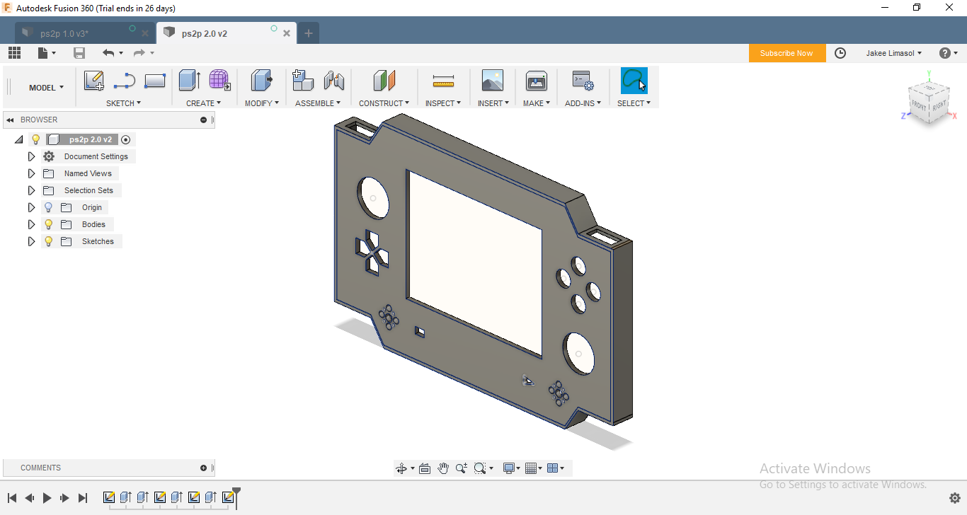

I'm using Fusion 360 (30 Days free trial)
How do I export my file for it to be ready to be 3d printed?
There's no .stl in the options
Hit make, select the object to print, and uncheck Send to 3D Print Utility it will then prompt you to choose where to save the .stl file.

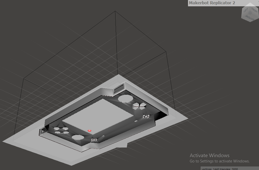

Do I need to fix the view of this?
It's currently in bottom right view
I'm worried that it wouldn't be printed properly since when I press the front view, it shows the side view of the model
When you bring it into cura or whatever slicer you're using you'll be able to check actual dimensions, and if it looks correct before you print it. If not, you can just rotate it before slicing.
so the view doesn't really matter if I just print it directly?
I didn't check it, after using Fusion 360, I highlighted all then export it as stl file
the angle shouldn't matter on the STL, as long as you slice it with the bottom on the bottom. I'd suggest double checking in a gcode viewer before printing, but whatever you slice is how it will come out.
