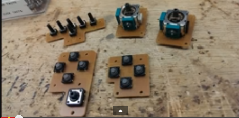

guys, what type of switch is this?
and why is there a 3rd analog?
What are you talking about? Those are rubber tactile switches (which are in gmans portable parts list)
The taller ones are just standard tactile/momentary switches. No idea what that stick is or what it's from.
Are you sure that's a 3rd analog? Or just another tact with an extra large footprint? Because I'm pretty sure I have a tact like that in my parts bin.
That big square tact switch with black rims on the bottom left is just a normal square head push button tact, it's designed to have a coloured head stuck on it. 4 way tact switches have 2 sides with 3 pins each, that one has only two pins on the exposed side.
If this doesn't answer your question, could you be more specific? I only see two analog sticks, the rest are all different kinds of momentary tact switches.
Based on your comments, i did google it. I think it's a 4 way tact switch, yet I still don't understand it's purpose since we already have triangle, square, circle, x and d-pad
Odds are that it wasn't for the controller. Most people put in buttons to control their screen or sound.

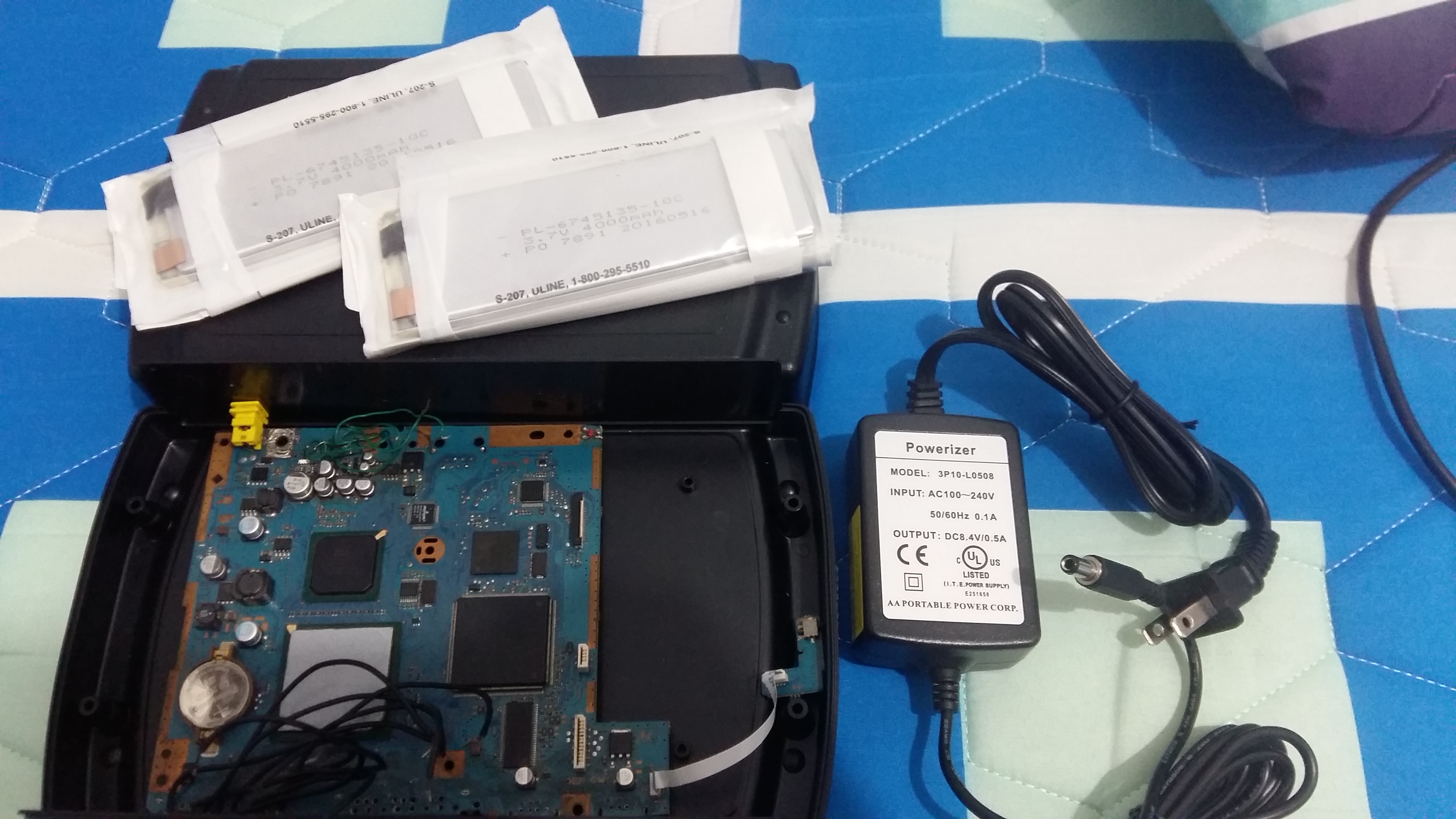

Finally got the case, battery & battery charger.
I'm about to start...View attachment 3233
