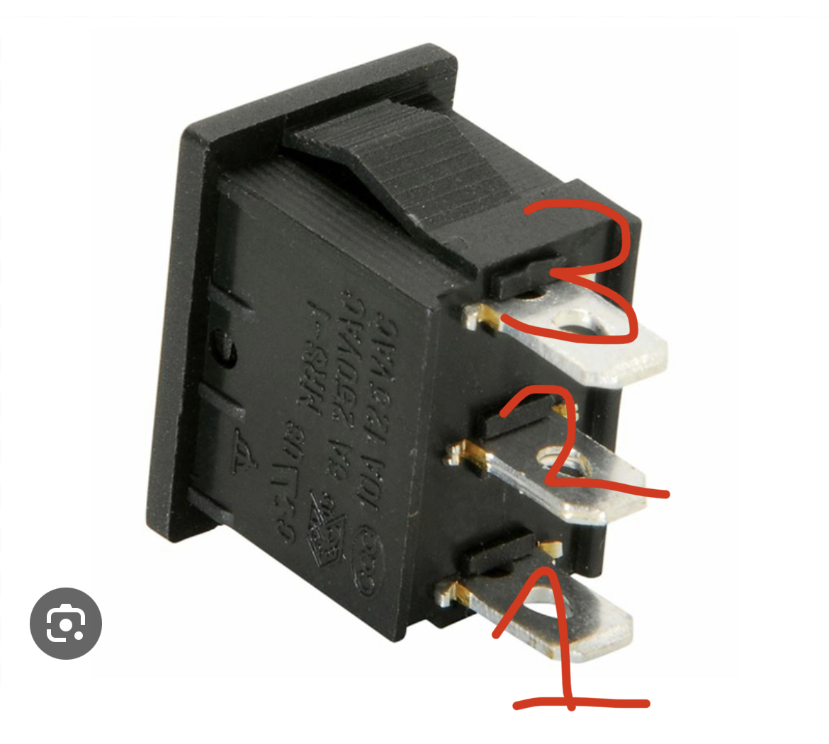

I've had issues with this before too, use a different switch and wire to legs "1" and "2"
