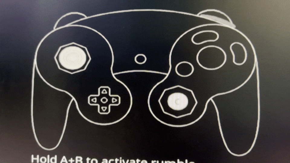

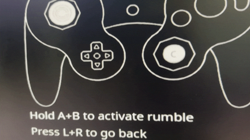

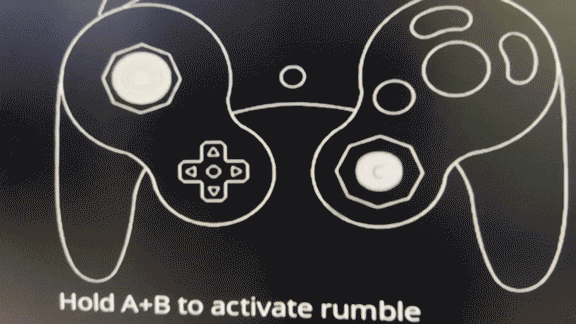

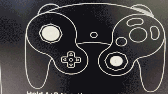

After testing the PSV2000 joystick without success, I tried reconnecting the SWITCH joystick for control. However, I found they also malfunctioned, only responding when I pressed down on the joystick connector with my finger. So, with doubts in mind, I conducted a thorough test. I used a wire connected to GND to touch the solder points to simulate button presses.
I found that when powered on, the left joystick constantly trembled.
When I connected GND to CX and CY, it triggered both joysticks.
When I connected GND to SX and SY, it only affected the right joystick.
Additionally, when GND touched L, it also triggered both joysticks.
The other solder points tested normally.

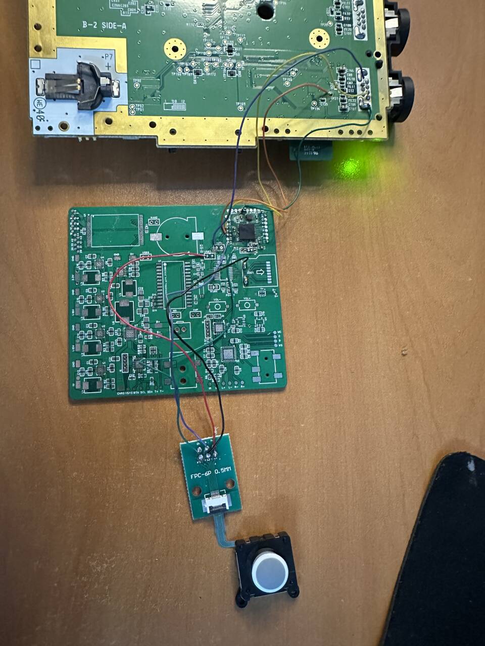

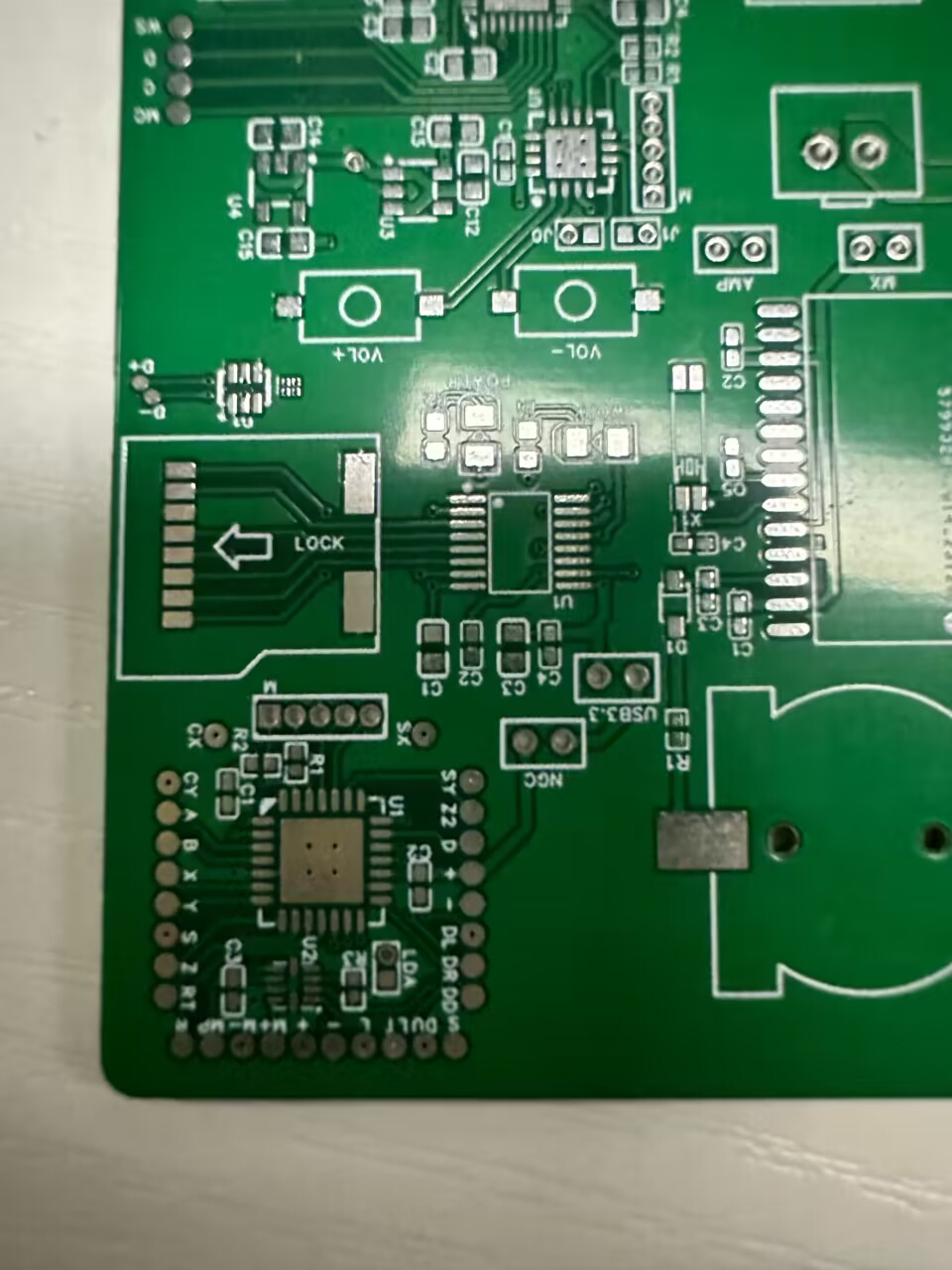

I copied the GC2.0+ onto a board that includes the power supply, MX chip, and USB card reader. I have compared it repeatedly and it seems there are no errors or missing connections and components in my replication. https://bitbuilt.net/forums/index.php?threads/gc-2-0-documentation.3228/
I am confused about why the joystick isn’t working properly and why there is this cross-reaction.

Thank you very much for your response, my friend. I combined the GC2.0+ with a USB card reader and a PD power source into one board without making other modifications. After flashing the firmware, I started testing and encountered this issue.
