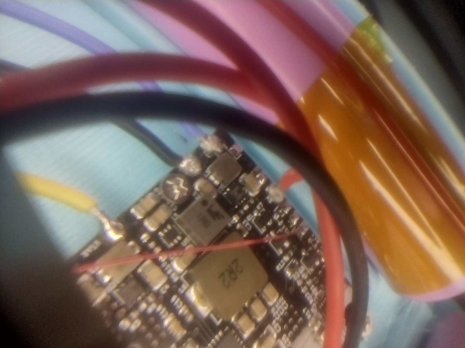

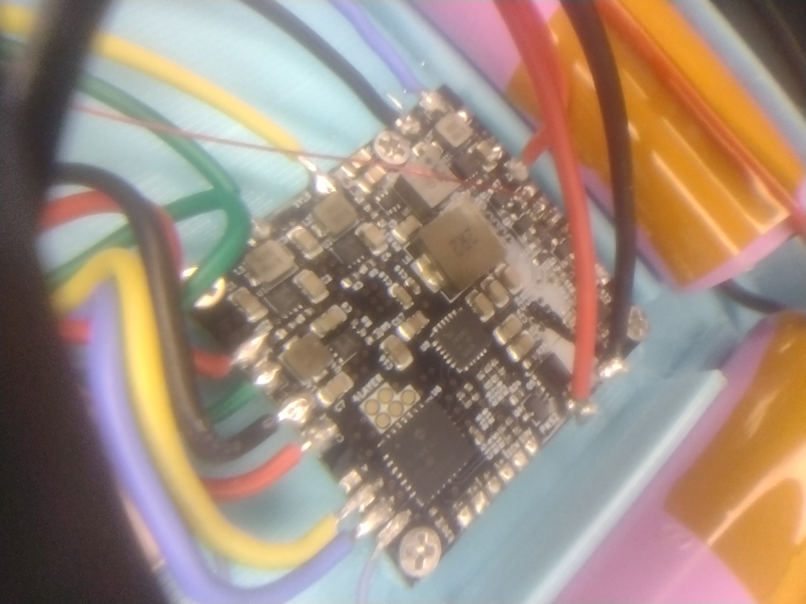

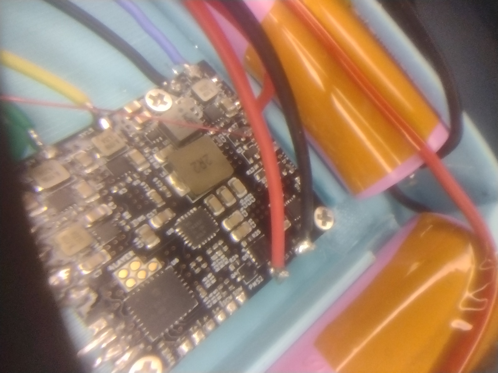

I just tried to test my trim and battery connections, but when I soldered the wires to the PMS, it instantly turned on and would not turn off when pressing the power button. My first thought was that the btn pin was shorted to ground, but this is not the case, as I tested and got no continuity until the button was pressed. These are the best images I could get, sorry if they're not very good.
UPDATE:
I just took the PMS out of the case, desoldered everything, and connected only the button, batteries, and screen (as a power indicator) and the exact same thing happens. It turns on immediately when the batteries are connected, and will not turn off at the press of a button. This is really strange, as I know for certain that everything worked perfectly fine when I initially trimmed the Wii, so the only difference now is that I have a 2s2p battery config instead of just a single battery
UPDATE:

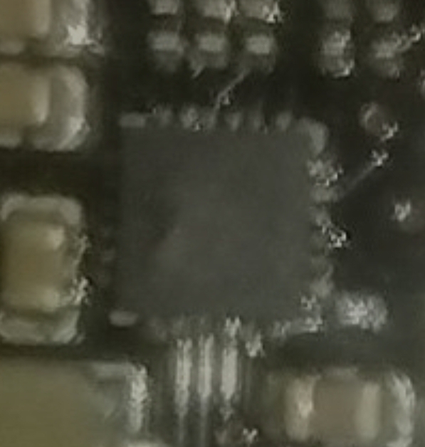

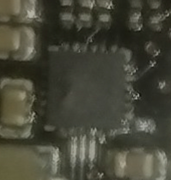

Looks like a kaboomed BQ to me. 2S will do that! No PMS revision (from 4Layer or Gunnar's original) supported 2S. Gotta follow the 4Layer wiring diagrams!
Take a close up pic of that chip, it's likely blown.
If it turns out that the chip is dead, will I be able to buy a replacement chip, or will I have to get a new PMS? Regardless, when I get home (currently on day-trip to beach), I'll reconfigure the batteries and hope. The PMS did still give correct voltages, but also after a minute or so of trying to figure it out I did notice some magic smoke. Immediately desoldered batteries but then retested a few minutes later and it still worked. The magic smoke is disheartening, but the fact that it still worked regardless does definitely give a little hope. When I inspected, nothing appeared blown, but again, I'll check again when I can. Thank you for the information though!
Yeah, magic smoke definitely means something is busted. If the BQ is blown, DM me, I'm no stranger to replacing blown BQs!

As suspected, BQ is definitely blown. I searched the part, but kept getting multiple different results. Is there a link or part number that I can look up for a replacement?
When I looked that up, I got BQ24292IRGER and BQ24292IRGET. Do you know if there is any real difference between the two?

These are the best I could get. Had to take them through my station's magnifying glass for anything to even be visible, but here are the best I got.
And when I say "no life," I mean there are no voltages anywhere but b+
